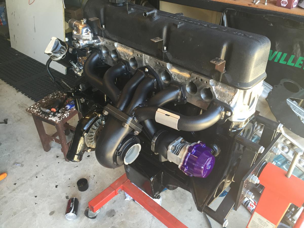

Started reassembly this weekend.
Unsure what to do about inlet manifold.
I know it's a fairly big restriction and it's ugly as hell....
I just don't want to wait any longer to put it in the car but I'm kind of torn at wanting to do it right the first time.
Posted (edited)
Change the inlet manifold.
Mod the factory runners and put a bigger plenum and throttle body on it.
Ideally you'd start from scratch and fab up something real nice, but the L28 inlet manifold can be welded nicely, just preheat it before you weld.
Theres enough meat in the manifold to open it up a bit and match the inlet ports.
There is even a casting line along the manifold wich makes a great cutting line and leaves the injector bosses untouched.
Just bear in mind you'll have to get it retuned to suit the new plenum and throttle, but it'll be fairly close if you dont change much else.
Edit, Just to really tempt you.
If you mod the factory one you'll have it running while you save a small fortune for the awesome looking gear that gets custom made by CPC

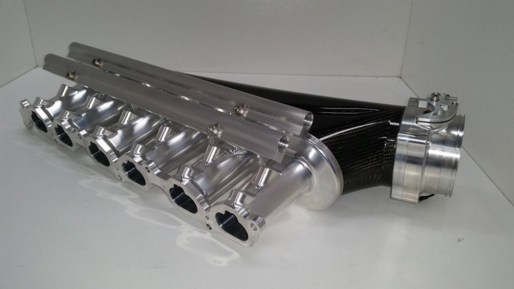

http://www.customplenums.com/

Yeah had already contacted them as i was interested in the carbon intake manifold ( its a theme on my car ) but they wont do the carbon for the L28 due to the heat of the exhuats under it effects the glue.
And there Billet ones start at $4000.00 so i figured i can probably make something 95% as good for about $1000.00 so plans are to do that.
