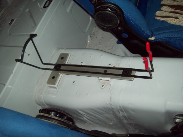

PeterAllen Posted September 11, 2016 Posted September 11, 2016 I'm thinking on installing 2lb+ extinguisher on the floor in front of the passenger seat. My only concern is if the seat ever needs to slide forward. I could do a temporary install to see what access and egress issues arise, if any. It would also be easy to mount on top of the transmission tunnel (I have no console) and, again, I could do that as a temporary measure. I figure any poor connections, etc, created during the build will identify themselves on the first long run - trying to make 'Speed off the Street' at Wakefield Park on 21st. If nothing has caught fire in the first six months I could do a permanent install. Any thoughts? Quote

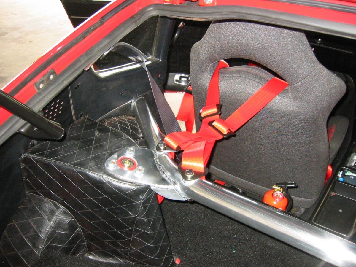

ScottyD Posted September 11, 2016 Posted September 11, 2016 (edited) Hi Peter, Mine is located behind my passenger seat . Edited September 11, 2016 by ScottyD George 1 Quote

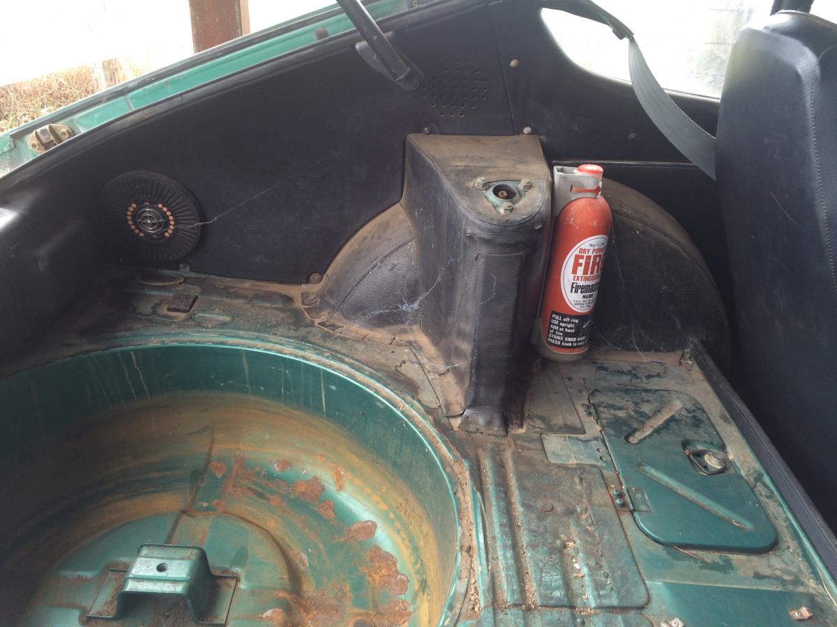

AndBir Posted September 11, 2016 Posted September 11, 2016 Hi Peter, Mine is located behind my passenger seat. sorry having trouble uploading a picture, will try again tomorrow. On my recently acquired 260z it is mounted as shown in the picture below - not sure if I will leave it there however it should be easily reached by the driver if required. Quote

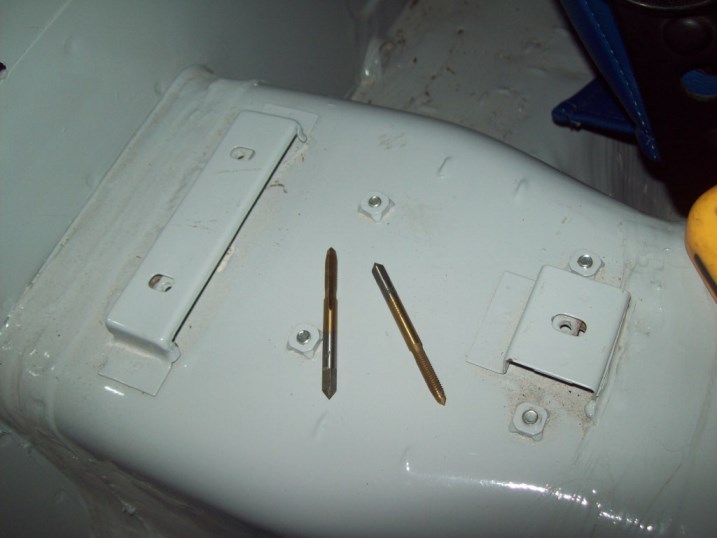

PeterAllen Posted September 16, 2016 Author Posted September 16, 2016 I wonder if someone can remove a screw and check the thread on these three captive nuts securing the console (I think)? I have 5 x 0.8 and 5 x 0.9 taps but neither seems to be the correct pitch. The interior was sprayed with 2 pak and there is some paint on the thread but I don't want to run the wrong tap through. Thanks. Quote
PeterAllen Posted September 16, 2016 Author Posted September 16, 2016 Good stuff. Thanks. As you would expect, every screw and tap except... Quote
Cozza Posted September 16, 2016 Posted September 16, 2016 Got one. Will drop it in over the we. PeterAllen 1 Quote
PeterH Posted September 17, 2016 Posted September 17, 2016 (edited) Peter...if you're referring to the three captive nuts, I just had a look at mine and they are M5 X 0.8 Edited September 17, 2016 by PeterH Quote
PeterAllen Posted September 17, 2016 Author Posted September 17, 2016 Peter. Spot on. I figured I didn't have too much to lose taping under size but that paint was tough and really made a big difference on such a small thread. 'RetroZ' I think you may have been sizing the four nuts holding the handbrake cantilever bracket under the tunnel which look 6mm. Thank you both for taking the time to reply. Quote
PeterAllen Posted September 18, 2016 Author Posted September 18, 2016 No worries. Just be thankful your name's not Peter, it's somewhat synonymous with inexactitude. Quote
