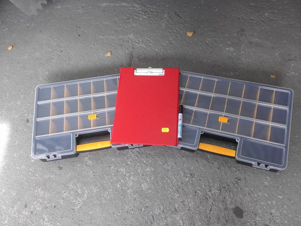

Scoota G Posted July 1, 2016 Posted July 1, 2016 These are my Weapons of choice for tear down. Buy four containers one for each area (Interior, exterior, engine bay and under carriage) gav240z 1 Quote

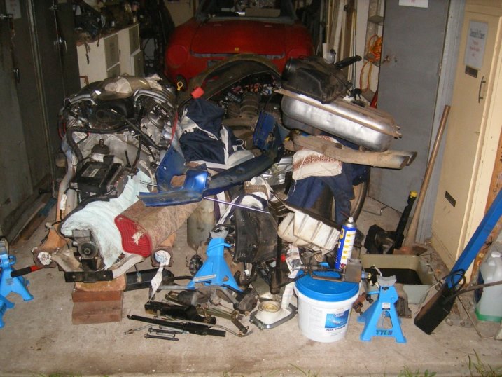

PeterAllen Posted July 1, 2016 Posted July 1, 2016 (edited) Don't over-complicate things. Just keep it all in a neat pile and if you can't find something just buy another one, it's much faster overall. By the time you do find what you were originally looking for, the car is on the road and the bit you've found has tripled in price. It's a win-win. Edited July 1, 2016 by PeterAllen gav240z 1 Quote
Administrators gav240z Posted July 1, 2016 Administrators Posted July 1, 2016 I have often bought the same part twice forgetting I had it in the first place . Quote
