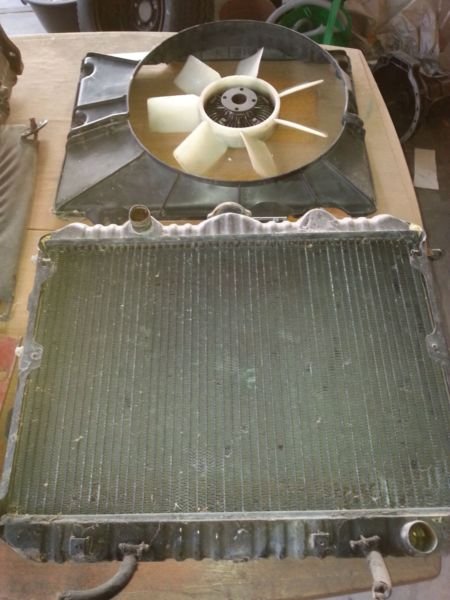

sydney mike Posted August 19, 2015 Posted August 19, 2015 I think Iceberg means the whole plastic one like below: Quote
C.A.R. Posted August 19, 2015 Posted August 19, 2015 I'm after one as well - as per Mike's photo^ Quote

Administrators gav240z Posted August 20, 2015 Administrators Posted August 20, 2015 I was surprised you could get them from Nissan. So not surprised to find out they can't get them for you. http://www.ebay.com/itm/78-DATSUN-280Z-RADIATOR-SHROUD-126355-/371062929866 Half of 1. http://www.ebay.com/itm/Datsun-260Z-280Z-radiator-fan-shroud-OEM-used-/381354026685 Quote
YosemiteZed Posted August 20, 2015 Posted August 20, 2015 the first option is the correct unit This one below is not the right one for a 260z Half of 1. http://www.ebay.com/itm/Datsun-260Z-280Z-radiator-fan-shroud-OEM-used-/381354026685 Cheers Quote
