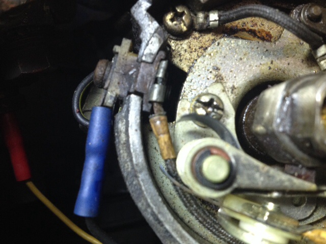

Moderators PB260Z Posted September 24, 2014 Moderators Posted September 24, 2014 And the problem ? Broken points spring Quote
jasonmac Posted September 24, 2014 Author Posted September 24, 2014 Big thanks to PB for coming out to help Quote
oldmates260z Posted September 24, 2014 Posted September 24, 2014 Good pick up, have never seen that one before Quote
Moderators PB260Z Posted September 24, 2014 Moderators Posted September 24, 2014 Good pick up, have never seen that one before Nor had I, but spring steel + Hot, Cold & Age = fatigue Quote
jasonmac Posted September 30, 2014 Author Posted September 30, 2014 I installed a new contact set, rotor and distributor cap and she kicked straight into life Quote
