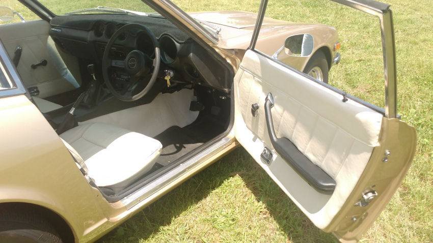

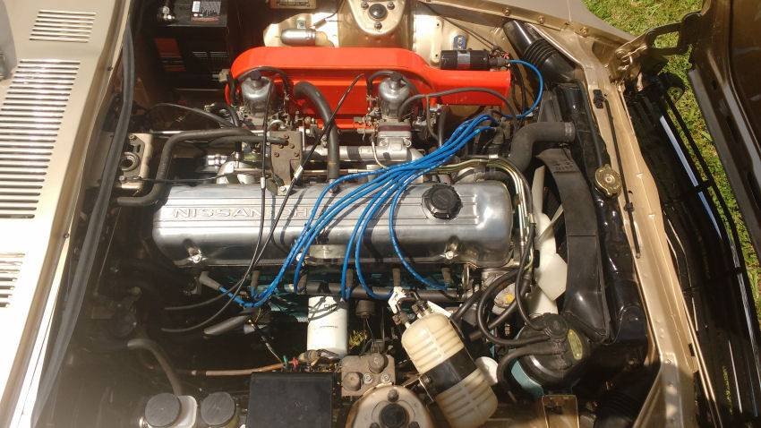

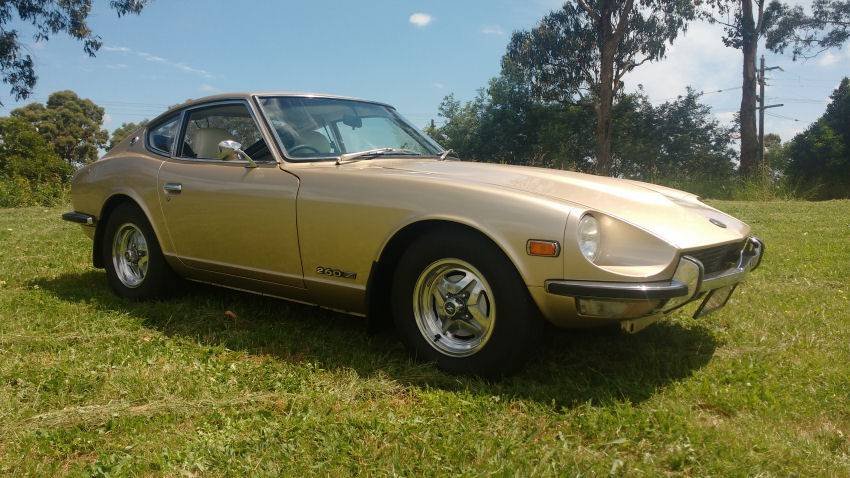

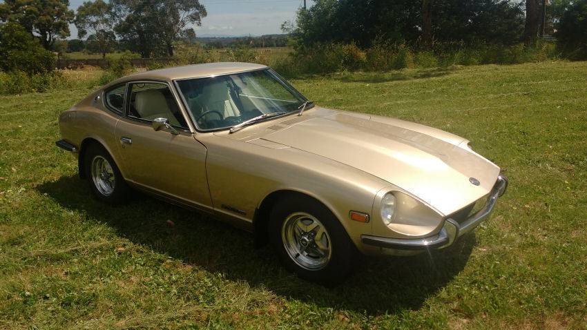

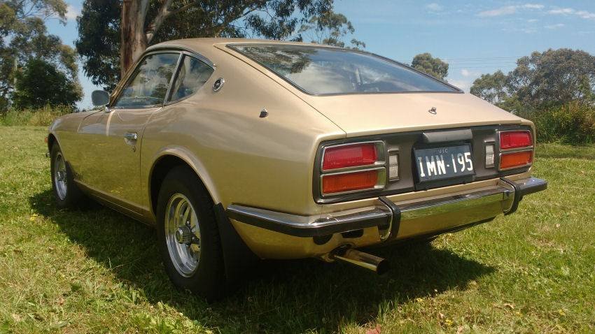

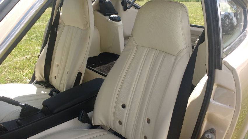

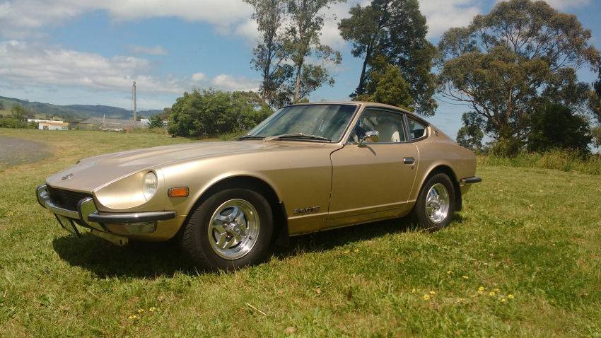

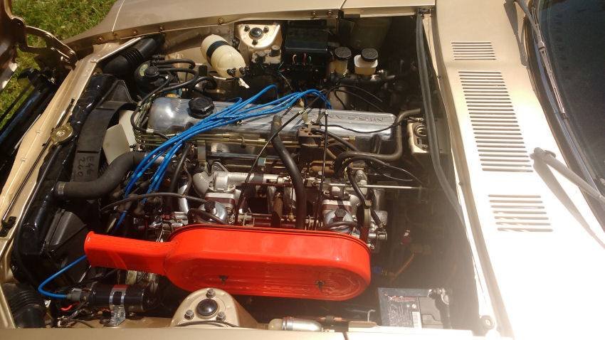

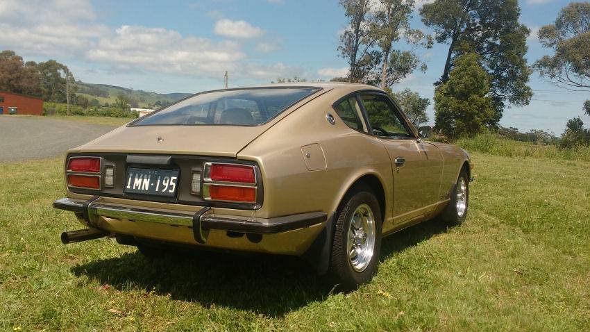

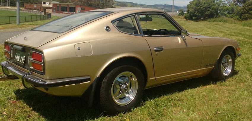

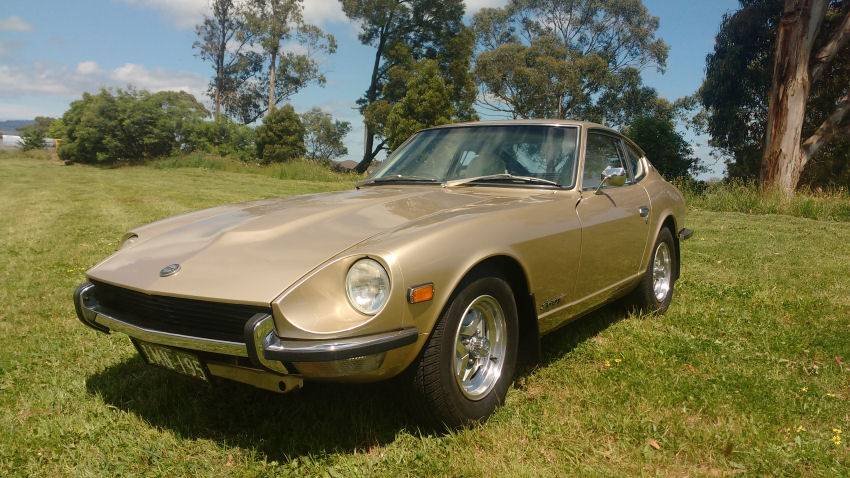

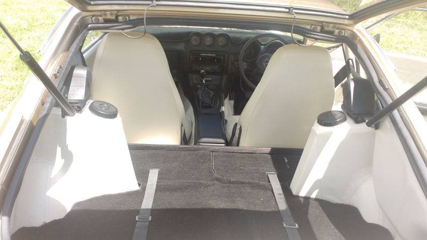

C.A.R. Posted November 29, 2016 Author Posted November 29, 2016 (edited) Time for a long overdue update! Vic's 260Z is now basically finished, with some very minor works to be done. It's been a great project & I'm over the moon at the result - I think it looks amazing in gold with the white interior Biggest headache with the build was fitting it with air-conditioning, as it wasn't fitted with AC from the factory. Thanks to Pauly_Adams for the AC parts - however it still required a new pump, evaporator core & TX valve and receiver drier. And thanks must also go to Peter (PB260Z) for helping out with the AC install & procuring a replacement Fuel/Volts gauge. And Vic's pretty happy with the outcome as well! Edited November 29, 2016 by Lurch ™ andyk_79, lightmaster240z, Ponyo240z and 1 other 4 Quote
Moderators PB260Z Posted November 29, 2016 Moderators Posted November 29, 2016 Time for a long overdue update! Vic's 260Z is now basically finished, with some very minor works to be done. It's been a great project & I'm over the moon at the result - I think it looks amazing in gold with the white interior Biggest headache with the build was fitting it with air-conditioning, as it wasn't fitted with AC from the factory. Thanks to Pauly_Adams for the AC parts - however it still required a new pump, evaporator core & TX valve and receiver drier. And thanks must also go to Peter (PB260Z) for helping out with the AC install & procuring a replacement Fuel/Volts gauge. Mate, it does indeed look great - the photos don't do it justice. Insofar as helping out - was great to catch up and have a beer or three. Would do it again. Cheers PB Quote
