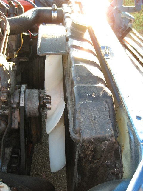

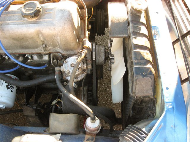

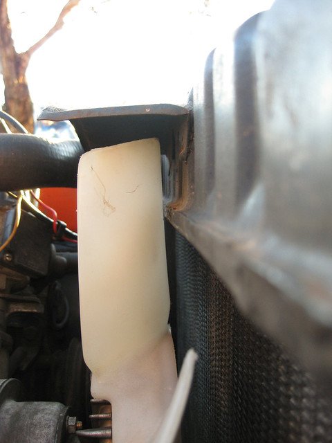

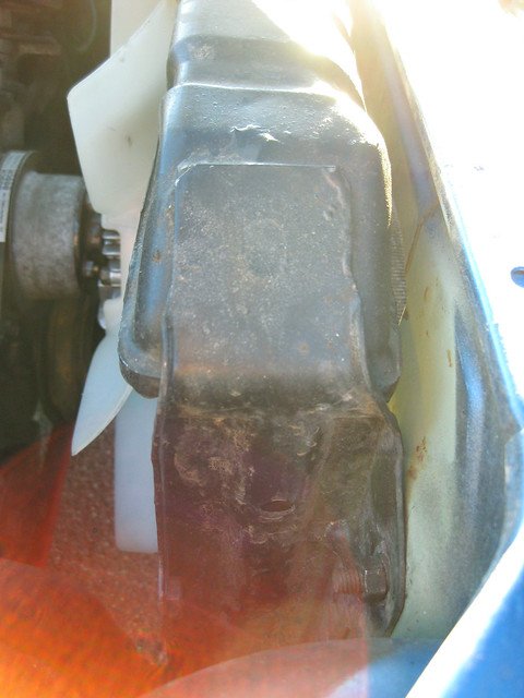

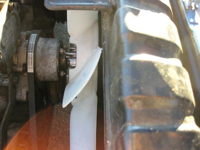

fufu Posted April 21, 2011 Author Posted April 21, 2011 is the crossmember tight?? id also throw in a set of electric fans.. stock one is annoying and noisy!! and robs a couple of horsies Thanks Ben. I'll check over the weekend. In the mean time here are some photos just to get the right context across. Quote
benny Posted April 21, 2011 Posted April 21, 2011 that seems super close... somethings not right im sure!! Quote
MaygZ Posted April 21, 2011 Posted April 21, 2011 Any chance you have the engine mounts either on the wrong sides or they are back to front?? Quote
lightmaster240z Posted April 21, 2011 Posted April 21, 2011 Are we going to see this at the next BBq ? Quote
fufu Posted April 21, 2011 Author Posted April 21, 2011 I had the suspension guys tighten the engine mounts, gearbox mounts and diff mounts. my suspicions are now on the crossmember as I did not instruct the suspension guys to tighten those bolts. Sunday is my next available day to tackle this problem. I'll be occupied until then with my cousins wedding. There is huge movements about 2 centimeters of travel from front to back. If I park on a slope it sits further back. If I slam the brakes hard... it pretty much moves forward and gets intimate with the radiator. Quote
benny Posted April 21, 2011 Posted April 21, 2011 my bet is still on the crossmember ... dont think you could have mounts wrong way etc as it make it really hard to bolt things on and linkages dont line up etc... Quote
fufu Posted April 24, 2011 Author Posted April 24, 2011 OK, So my findings are as follows: Tried rocking the engine, nothing. Tried putting the jack on some key crossmember points. No movement either. However... going back to my previous post about a missing bolt/nut for the gearbox. I'm missing the main nut for the gearbox to the gearbox crossmember (gearbox mount). The gearbox crossmember is solid. My prediction is the gearbox not being fastened down to the gearbox crossmember would allow the gearbox weight to move the whole engine-gearbox a good 2cm on hard braking? Which could cause my fan to make love with my radiator core? The mounts don't look to nice either. They look more like they are moving forward. I whacked the jack under there and it does look like the gearbox moves a bit. I'd very much like your input into this matter. Also if anyone knows what the nut profile/specification/details are so I can get a replacement, if you could forward this info onto me that would be great. I'll have a look for nuts lying around the garage. But considering its related to transmission I'd most probably be best to get a Grade 8 nut for this, I assume. Cheers, Fu *EDIT It's a M10 1.25. Good old tap and die kit. Why didn't I think of you before. Quote
fufu Posted April 27, 2011 Author Posted April 27, 2011 Hello all, Looks like I found the issue. Turns out I had the original 240Z 2 core automatic radiator. Yes it's that wide. Weird. However the key problem was the fan unit. I have the wrong fan unit. The replacement unit is a lot bigger/taller than the original. Which put the fan a lot closer to the engine. With the small rocking of the engine it allowed the fan to hit the top end of the radiator causing it to bend and then rooting the radiator core. The rocking was also caused by the gearbox being insecurely mounted to the gearbox crossmember. This allowed the gearbox to bounce up and down causing the top of the fan to touch the radiator. I've since secured it. But with the bigger/taller fan it still rooted the radiator care, sits way too close as the photos show. So what went wrong with the first initial fan. Turns out my mechanic friend Ben which I contracted to change the water pump didn't tighten the fan at all. Which led to the fan to become unsecured and unbalanced and ultimately rattling itself to the front and causing the same result, hitting the top end of the radiator and then rooting the radiator core. I've since ordered a few parts from the U.S. a new aluminium radiator with the same dimension, shroud and some electronic fans to help out with the cooling. I'm in the process of purchasing another fan unit from a fellow AusZcar member to temporarily fix the issue until the new aluminium radiator, shroud and fans arrives. I'll be lining the aluminium radiator mounts with some rubber and some new stainless steel bolts to avoid the aluminium radiator getting in contact with the steel body. Trying to minimize the sacrificial metal (theory) from happening. But I'm glad this was identified. It solved quite a few issues in the process. Thanks all for the input. Quote

fufu Posted April 27, 2011 Author Posted April 27, 2011 Hi Fu, Just reading the posts, and have to say that I also ran an auto trans radiator in mine and never had the problem with the fan as you described so I'm a bit lost as to why this is happening. Hi John, I think its a number of contributing factors which led to the result. First being the unsecured gearbox mount. Which would allow the rear of the gearbox to lift up, when bouncing around, and angle the engine down, which would mean the top of the fan would be angled as well, allowing it to hit the top end of the radiator. Second mounts seem to be slightly worn across the engine. This could be a minor contributing factor. Third being the radiator doesn't seem to be flat across the flat section facing the fan. Some sections seemed to be warped causing a very minor bulge to come out. I notice that it is those areas in which the fan snags on. Once a fin clips that, the only direction for it to go is into the radiator core. But judging by the picture it was sitting fairly close. It was my own fault for not checking the fans side by side before installing it. No one to blame but myself. But lesson learned none the less. There is a slight difference which i noticed about the radiator. My one doesn't seem to have a tap. I did a bit of google search and some of them come with taps. John did you have a tap on your radiator? Cheers, Fu Quote
