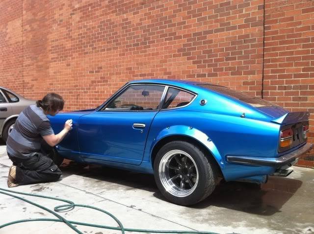

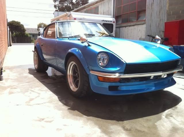

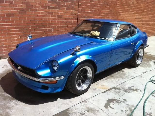

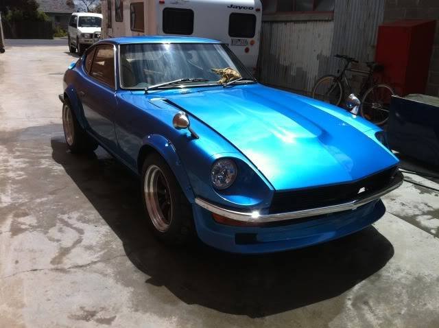

fufu Posted November 7, 2010 Author Posted November 7, 2010 Update: Car is finally done at my friends panel beater. A few things got in the way such as a few motorbikes which had to take priority as it is leading up to riding weather. Issue 1: If you've been following closely I had a slight rubbing issue with the rim/tire combo that i was running. This has now been sorted. It was as simple as tightening the tension control rod. Good thing this was spotted now rather than 20 kms down the road when the strut takes off whilst driving. Very annoyed that this was found. It basically meant durring the time the car was at a place close to Geelong, when it had its front rack reconditioned. It wasn't fitted back properly. DANGEROUS!!!! Upon tightening of the tension control rod the whole strut can be seen being pulled back about an inch. Which totally cleared the turning circle with the new rim/tire combo. Issue 2: I had the doors taken apart and rust proofed on the inside as this step was missing from the first panel beater. At the same time i had the doors aligned and window mechanisms aligned to work properly or open and close properly. Issue 3: Various parts installed, new front bumper bar, 280zx rear calipers as the maxima's were leaking. Issue 4: Had the bottom quarter of the car repainted as i noticed certain uneveness to the paint. Some sections i could see primer. We ended up also masking the angles and stone guarding the bottom properly. Another issue linked to issue 1, where the restorer failed to do a proper job. Which comes to the phrase "I'll treat the car like as if it was mine" which was quoted to me. Yea right... your car must have been sh*&house if this was the quality you did on my car. Whats next? Plan is to get the seats reupholstered. Followed closely by a roadworthy and registration. Hopefully before the year is out. Quote
