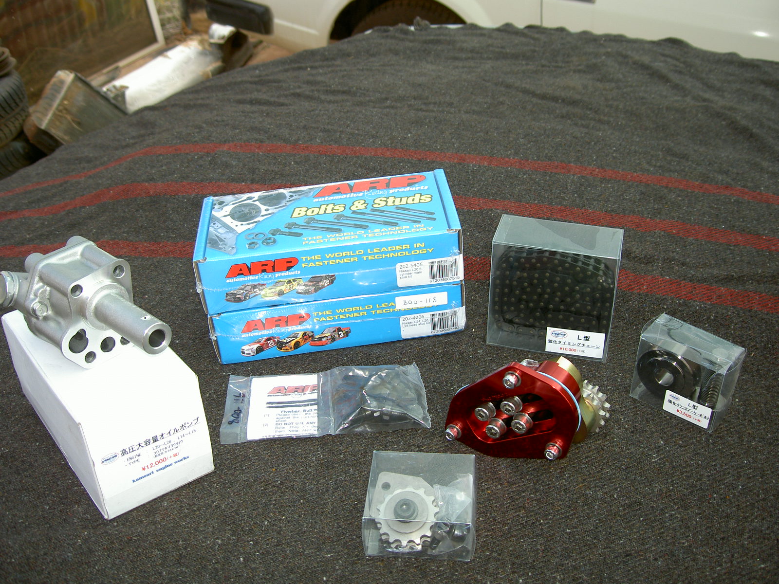

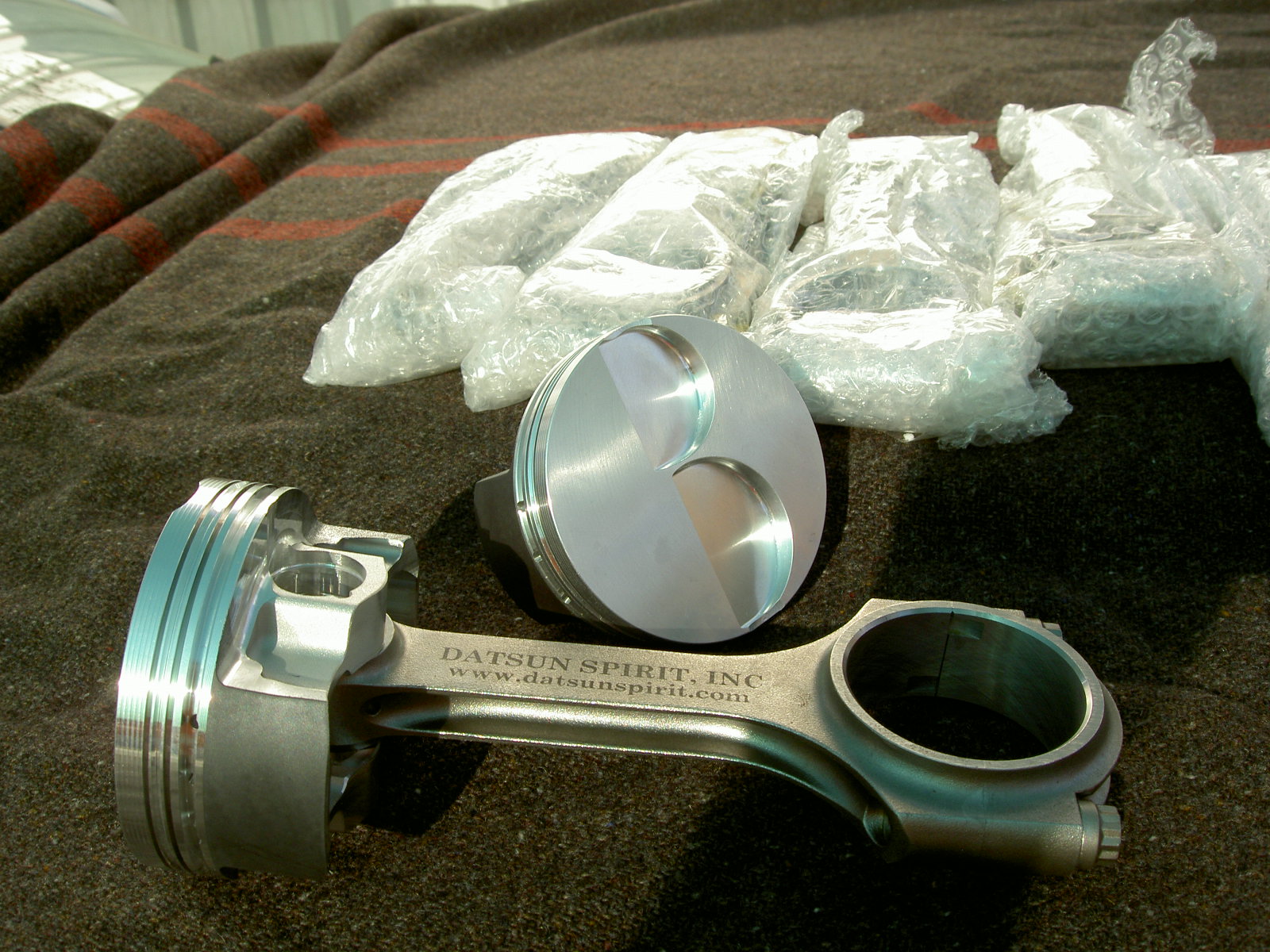

Enzo Posted May 18, 2014 Posted May 18, 2014 Hi Guys, It seems that a lot of people are building new engines at the moment, so I thought that I would share my plans. I have been sourcing parts from various suppliers in Australia, Japan and the USA over the last couple of months. I still have a few purchases to make and some parts are in transit at the moment. It will still be a few months for completion, but I'm in no hurry. I initially came across the Datsun Spirit web site (Eiji Hosomi) after reading about his car on Auszcar. I sent some emails and things started to progress, I ran him for a chat. I liked what he had to say and this gave me a starting point for the new engine. This is the plan. L28 N42 block. Forged 88mm short skirt 29mm pin height pistons. Forged "H" beam 139.5mm conrods with std L28 crank. (This gives a 1.77:1 rod/stroke ratio). BHJ Damper with lightened 12lb Forged Chromoly flywheel and 240mm Carbon/Kevlar clutch. Block will be ultrasonic tested, oil gallery plugs drilled and tapped, all machine surfaces radiused and block interior smoothed. (usual stuff). All rotating assembly balanced and blue-printed. N42 Head. Polished /ported/ Chambers welded. (James Flett.) Datsun Spirit Proprietary camshaft. ( .560" lift -300 Duration ) Big Valves ( Longer for the high lift cam) Rockers, valve springs and chromoly spring retainers. Kameari twin idler gear. Kameari timing gear. Kameari hi-volume oil pump. Kameari Damper bolt. ARP Mains, Head and crank bolts. Mallory Unilite Distributor Mallory Coil MSD leads made for the Distributor This will give you an idea of my plans. As it progresses I will post some pictures. Cheers David. Quote

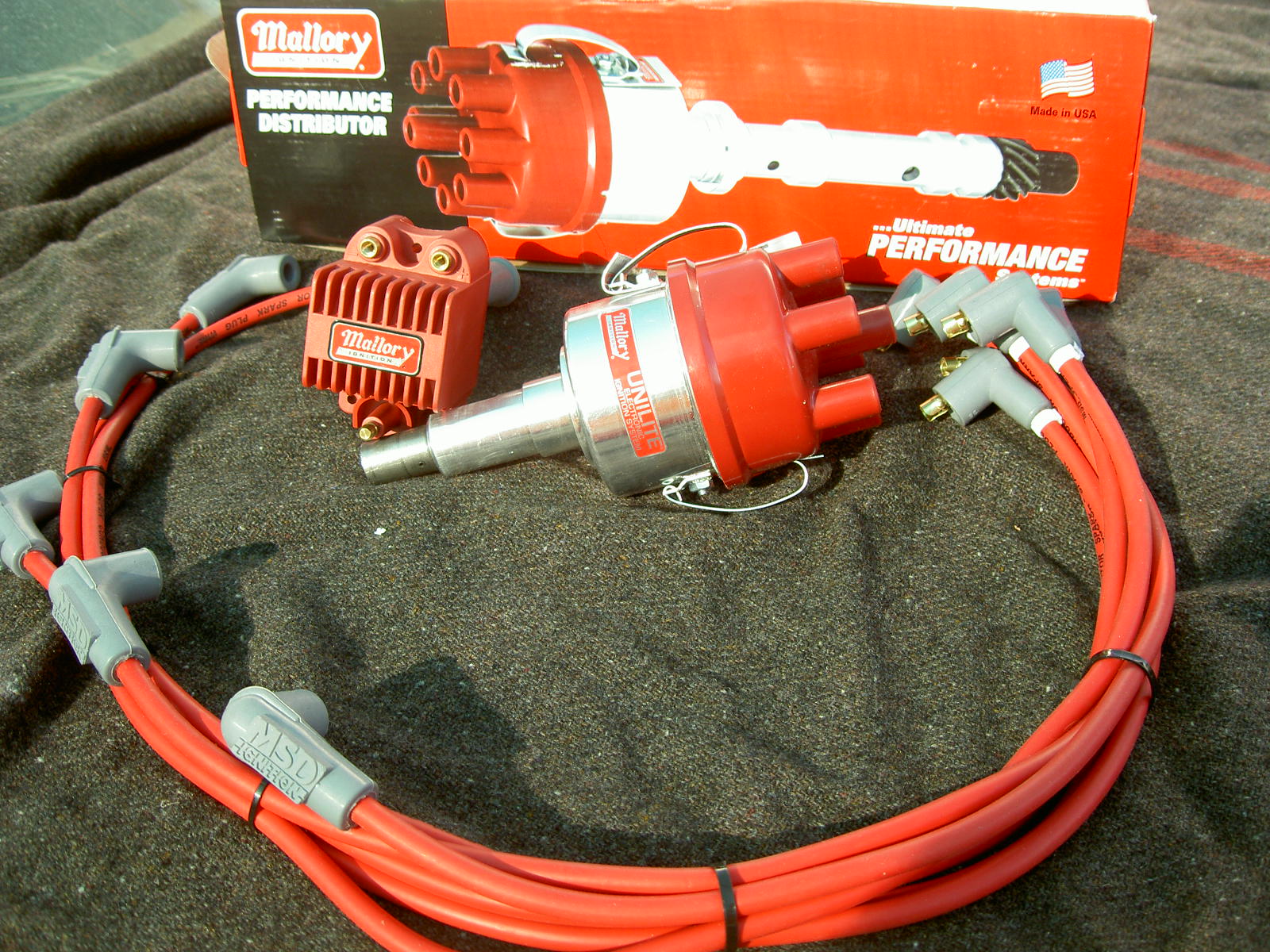

C.A.R. Posted May 18, 2014 Posted May 18, 2014 There are a few issues from what I can see in your build plan David, but IMHO - by far - you should piss all the Mallory / MSD stuff off. It's US junk & fails quite regularly. Get a proper re-manufactured electronic Distributor (from Performance Ignition or the like) & Bosch coil - it's all an L-series needs. Quote
dat2kman Posted May 18, 2014 Posted May 18, 2014 Those dollars are about right. By time i have the engine all together, in, and running right, about $15,000 I worked on the Murphy principle,,,,, i had two f them done, the second is in Ready To Assemble stage, in case the first lets go. It hasn't! It did get a full top end Les Collins/Pete Mac refresh. (I got two sets of the Spirit rods, very good quality) Quote

dat2kman Posted May 18, 2014 Posted May 18, 2014 The timing chain setup, gets rid of the curved slack side guide, which wears, and loses hp. It utilises two idler sprockets, the bottom is oiled via the gallery feed to the plunger assy. Their vernier adjustable cam pulley gives very fine adjustment. Very easy to remove slack due to chain stretch, via the top external adjuster. Quote
Enzo Posted May 18, 2014 Author Posted May 18, 2014 Hi Guys, Thanks for the input Lurch. I knew that you wouldn't be far away. Since I already have the Mallory/MSD parts so I will use them and if they fail then I will consider other options. I realise that the cam is big for street use but this is a dual purpose engine. Street/ Hill climbs, sprints etc. I'll just wait and see what happens. By the way. I always enjoy your posts. Gavin, James knows what is going into the engine and what I want it for, so will do whatever is necessary. I'm not interested in chasing HP or torque figures. They are just numbers to impress people or sell engines. For street use it doesn't matter much and as long as the engine does what I want, I will be happy. I actually didn't know James existed until I got an email from Peter Mac saying he was not doing any more work. After a bit of research and a few phone calls to James I decided he was the man for the job. Jason is spot on about the twin idler setup plus the cool factor. Would have bought local, but got a good deal out of Japan. Gavin, As for induction, that will be something different and will be shown at the completion of the build.( That's if it works) Cheers David. Quote

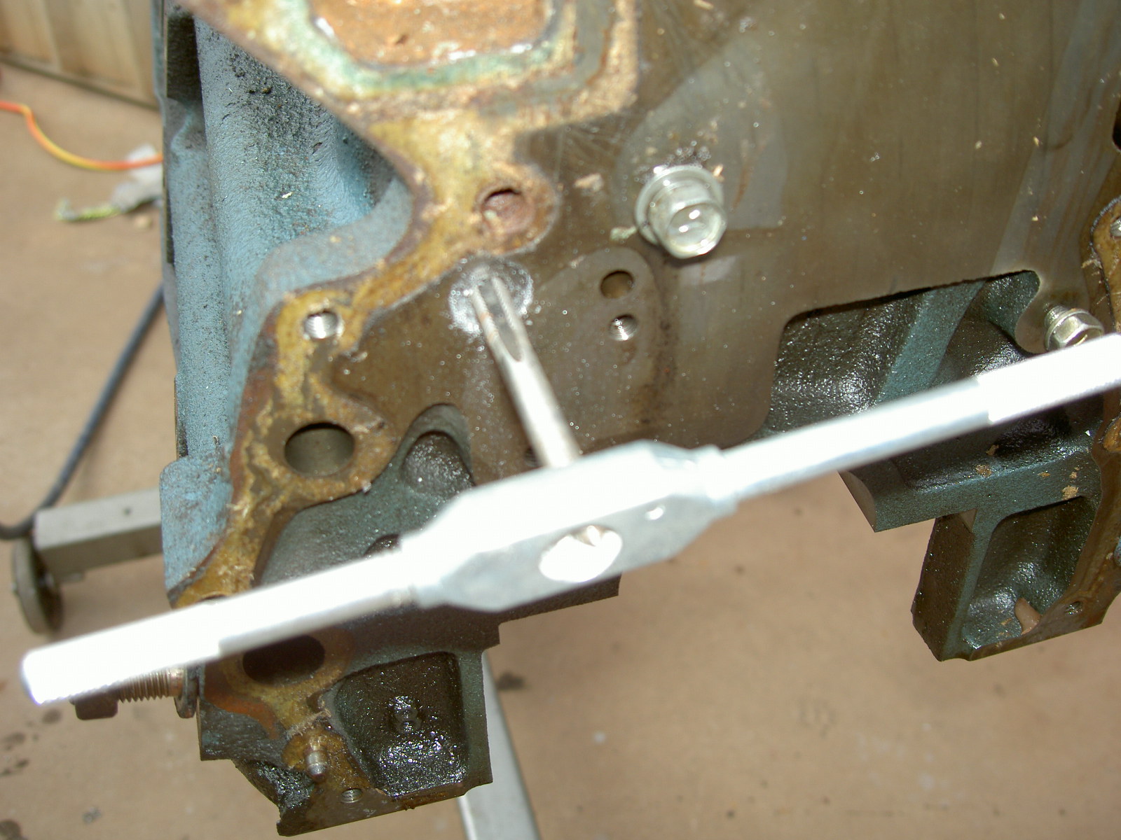

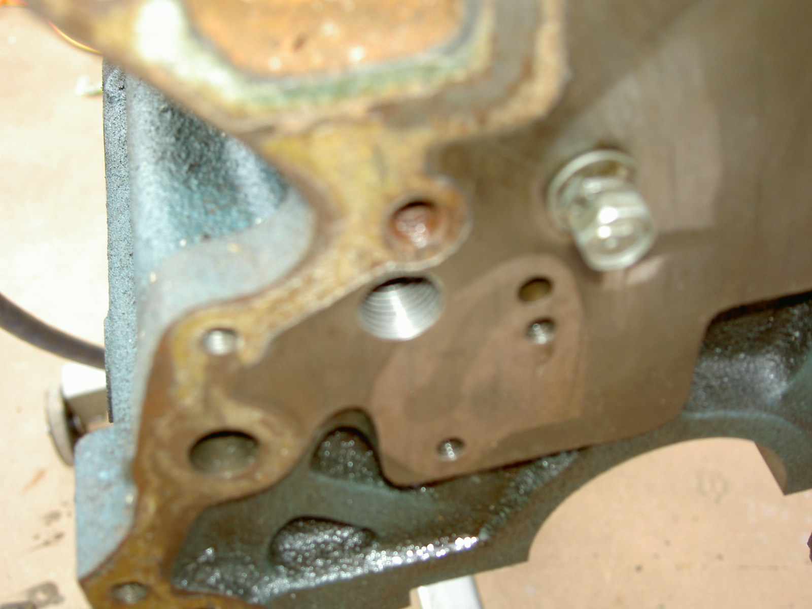

Enzo Posted May 24, 2014 Author Posted May 24, 2014 Hi Peter, Yes I like Holley, Weber, Blondes, Mikuni, Brunettes, Dellorto, OER and even Fuel injection. Some more parts arrived this week while I was away with work. Today I started to remove the oil gallery plugs and tapping 1/4 NPT threads. When I can find my air grinder I will start prepping the block with removing any casting ridges etc. David Quote

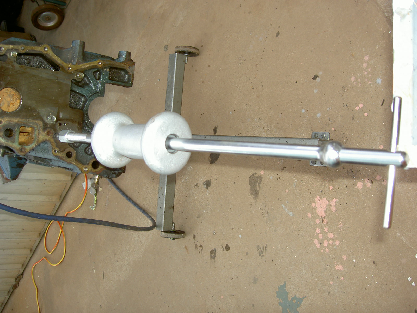

Administrators gav240z Posted May 25, 2014 Administrators Posted May 25, 2014 Hey David, Is that a slide hammer you're using to remove the oil gallery plug? I'm still not clear on why we thread and tap the oil gallery plug? Could you not just install another plug like you do with the coolant galleries? Or is there some other benefit? Quote
HKSZ Posted May 25, 2014 Posted May 25, 2014 Two benefits are you can remove the plugs for cleaning each time the motor is rebuilt and a threaded plug is less likely to blow out when using a HP oil pump gav240z 1 Quote
Enzo Posted May 25, 2014 Author Posted May 25, 2014 Hi Gavin, KKSZ is on the money. 40 year old engines collect a bit of crap in the galleries especially if they have been sitting for years like this block. When hot tanked all of the residual rubbish should come out. ( Page 13 of How to Modify your Nissan and Datsun OHC Engine). The slide hammer makes life easier. Drill and tap with a 6mm thread, attach the slide hammer and Bobs your uncle. The 1/4 NPT plugs that I bought are 10mm long, which is perfect because it is approx. 12mm from the front of the block to the No1 main Bearing oil passage. Cheers David. Quote
