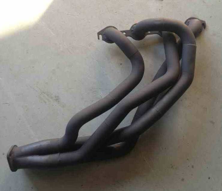

260DET Posted August 2, 2014 Author Posted August 2, 2014 Pro has finished the exhaust, pic of the R extractor below which has to wriggle around the steering shaft, clear the starter motor and a few other things. Once you have to go custom with an exhaust the cost goes ^ big time, bang for buck it would be cheaper to go for a more basic system but this should look and sound cool, have to get those priorities right Quote

tir33d Posted August 2, 2014 Posted August 2, 2014 My right hand pipes are all individual, and it is still really really painfull to get them on, don't know how they are gonna get in to be truthful. No race merge collectors? Are you going to get them HPC coated? My extractors and pipes originally cost $2200 or $2400. Since spent another $500 at a shop to go backwards, then another $700 for bits for us to redesign the rear from the extractors. Have you got a bung in one of your pipes for your o2 sensor? Hard to get equal lengths in our situation, but he really did just look for the easy route. Still another step closer. Quote
PZG302 Posted August 2, 2014 Posted August 2, 2014 Pro has finished the exhaust, pic of the R extractor below which has to wriggle around the steering shaft, clear the starter motor and a few other things. Once you have to go custom with an exhaust the cost goes ^ big time, bang for buck it would be cheaper to go for a more basic system but this should look and sound cool, have to get those priorities right But doing things right the first time is generally cheaper in the long run and works better too. Quote
260DET Posted August 2, 2014 Author Posted August 2, 2014 The exhaust is completed and in the car so it must all fit, I don't think it would be possible to do a proper four into one equal length, on the R side anyway. As long as it sounds good, is not too loud and does not drag on the ground I'm happy. 400-450WHP will do me fine so that should not be a problem with that exhaust, have now decided to just get the engine running, lay it up for a few months, then I'll be able to get back to it later with a cam change and whatever else the engine needs to reach the power target plus a dyno tune of course. Quote
PeterAllen Posted August 2, 2014 Posted August 2, 2014 ... I don't think it would be possible to do a proper four into one equal length, on the R side anyway. ... Think again! Quote
260DET Posted August 2, 2014 Author Posted August 2, 2014 Ha ha, like that would fit in my engine bay Peter Certainly an off the shelf set would have saved some money but no way in the world would those ones in the pic fit for mine. Quote
260DET Posted August 2, 2014 Author Posted August 2, 2014 For some reason or other it seems that it's easier to fit extractors into a S30 than a S130, I suspect that the LS sits a bit differently in the respective engine bays. Quote
