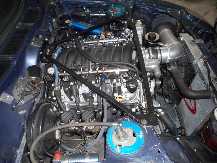

260DET Posted April 16, 2016 Author Posted April 16, 2016 (edited) Here is one pic showing the engine bay brace, bloody rubbish Nikon editor has lost the rest. Edited April 16, 2016 by 260DET Sirpent 1 Quote
Sirpent Posted April 16, 2016 Posted April 16, 2016 Here is one pic showing the engine bay brace, bloody rubbish Nikon editor has lost the rest. Zapruder would be proud. Am I reading the brace is "Bloody rubbish" or that the Nikon editor is? It would be good if that brace could be incorporated into the Caster / Camber Tower Plates Quote

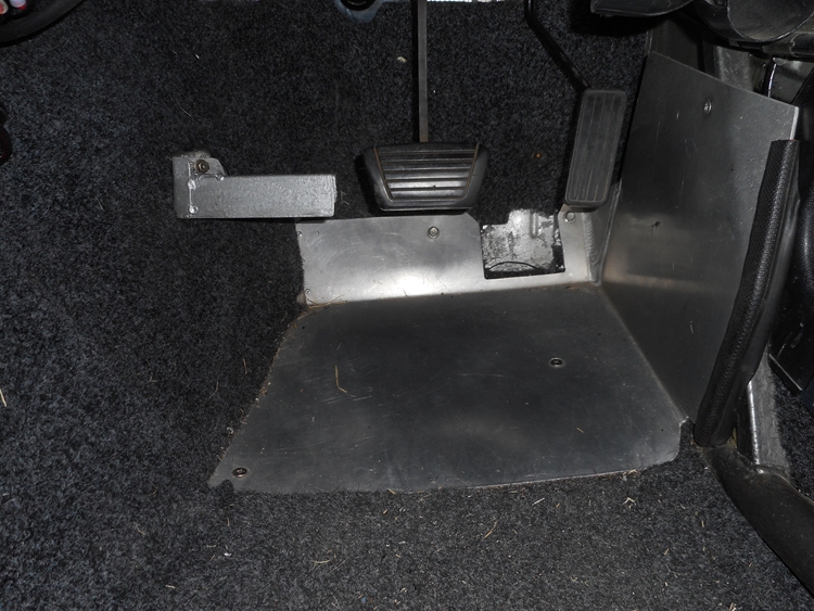

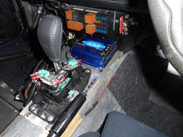

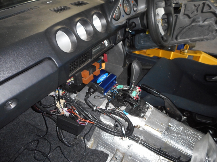

260DET Posted April 16, 2016 Author Posted April 16, 2016 A couple more, shifter bits will get a cover eventually, drivers footwell. Quote
260DET Posted April 16, 2016 Author Posted April 16, 2016 (edited) Zapruder would be proud. Am I reading the brace is "Bloody rubbish" or that the Nikon editor is? It would be good if that brace could be incorporated into the Caster / Camber Tower Plates The Nikon editor POS and they want to charge for it! Brace is fine, space limited on top and the front X brace had to go forward a bit to clear the engine without bowing the brace too much. The bracket goes down the side of the tower and is bolted there too. So bolted 90 degrees to each other, much stronger than the usual flat ones that only sit on top and even use rod ends which allow movement duh. Has a total of 8 bolts, was a nightmare to make due to it having to sit flush at all bolting points with zero clearance. Edited April 16, 2016 by 260DET Gordo 1 Quote

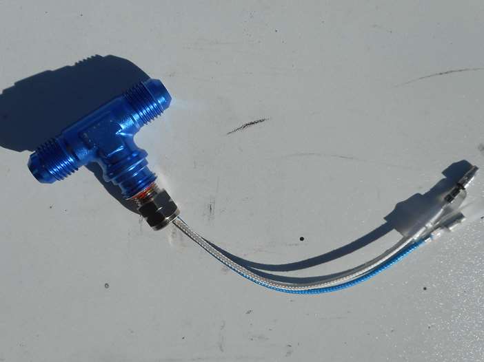

260DET Posted May 21, 2016 Author Posted May 21, 2016 Lots in the process of happening, it appears that the transmission that was supposed to be prepared for racing wasn't to put it simply. Basically the demands placed on an auto for racing purposes are quite different to those which apply to a normal street auto and here it's all about the valve body and the size of certain oil flow orifices, springs etc. Auto blokes will know what I'm talking about, manual blokes won't care. While the guru has the valve body I'm been doing some upgrades like fitting a gear number indicator, manual torque converter clutch switch and a auto oil temp gauge the sensor to be located in the cooler out line. How to do that, nothing available off the shelf, hmmmm. So I got a -6 T shaped bulkhead fitting, cut drilled and tapped it to take the sensor and yay, a rare 'works first time' mod. Pic below. Quote
