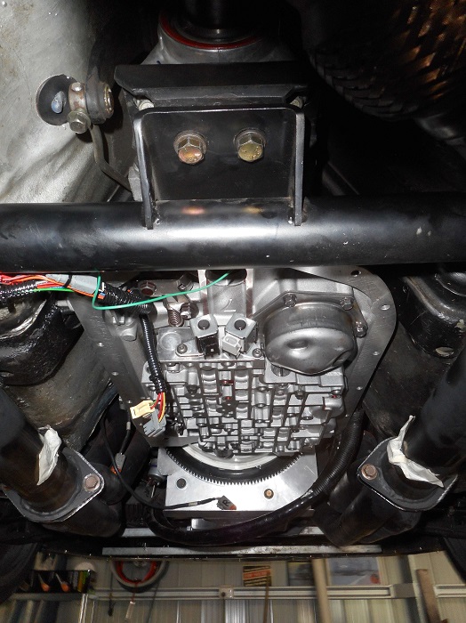

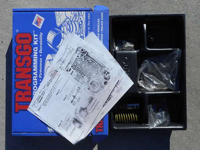

260DET Posted June 16, 2016 Author Posted June 16, 2016 Auto valve body has been removed and tweaked to improve internal oil flow volume and speed to keep up with the extra demands like full throttle shifting. Hopefully this will be it for the auto, better be because the Z is entered for the next A series sprint at Morgan Park over 25/26 June. Now in the process of bolting everything up again, fortunately the hoist helps to get the car high enough to work on properly. Have played with the rear suspension to increase the roll centre too, hopefully this will make the rear end a bit more stable under high load. Pics are of the kit used for the auto with now surplus parts, plus a view from underneath looking forward. Quote

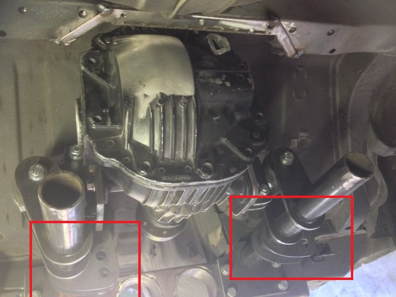

Sirpent Posted June 16, 2016 Posted June 16, 2016 (edited) Dont mean to hijack this thread but as you mentioned the S30 rear........... Well, guess we will find out one day in the future, Peter Mac suggested I build this into my set up as per the photo attached. This photo was taken with the car sitting on the rotiserie on its side before I rotated the photo, therefore the loose brackets on the left are actually hanging downward while the ones on the right are actually positioned in their true position. The lower control arms I am having made will pivot off of these brackets and can be set higher or lower. On a normal S30 set up, because after market adjustable lower control arms replicate the forward mount poistion of the originals, and utilise the body hanger points, it would be almost impossible to create a hanger bracket set up for adjustability. The LCA's Im having made step inwards at each end by 30mm meaning that the hanger brackets will allow for a HT nut and bolt set up to allow for the LCA repositioning. Cheers John Edited June 16, 2016 by Sirpent Quote
dat2kman Posted June 17, 2016 Posted June 17, 2016 John, that setup is close to/same as the AZC rear lower inner, and yes, it will give ability to change roll center, but, you cant use the stock as supplied AZC rear LCA's. They need to be lengthened, to suit. For finer on alignment machine adjstability, the bolts need to be slotted, enabling the inner and of LCA to be moved vertically up/down, thats roll centre adjustment, For the S130 and later Z31 running K frame semi trail arms, the amount f. Roll centre adjstability in the up/down is very minimal, to slight, with the ears on the rear crossmember fully slotted, correctly, the geometry is such that roll centre is in a very clse range with very little ability to raise or lower. The slotting of the rear ears on the crossmember does give much better control r rear end toe and camber adjustment, which is what will "settle" a IRS K frame rear end down, and give much better handling. Quote

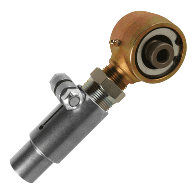

Sirpent Posted June 17, 2016 Posted June 17, 2016 John, that setup is close to/same as the AZC rear lower inner, and yes, it will give ability to change roll center, but, you cant use the stock as supplied AZC rear LCA's. They need to be lengthened, to suit. For finer on alignment machine adjstability, the bolts need to be slotted, enabling the inner and of LCA to be moved vertically up/down, thats roll centre adjustment, Richard, I’m sorry this thread is being hijacked, so this will be the last post I make here on the S30 set up I’m building. My set up is a bit different from AZC set up The tubes in my photo are fixed in place and also form part of the diff cradle, whereas the AZC and other set ups rely on the LCA tubes bolting into the chassis and the rear moustache bar drop plates. These permanent tubes replace the traditional set up and incorporate the hanger brackets that will carry the LCA's with fully adjustable rod ends at all 4 bolt points (2 at the LCA Chassis mount and 2 at the spindle assy) My LCA's are being fabricated by John Lange specifically to make up the width and length difference creating this cradle assy dictates, however as I will have 4 point adjustment, I will have a fair degree of length adjustment between chassis and spindle points. I have attached a pic of the ends I will have on the LCA's. Cheers John Quote

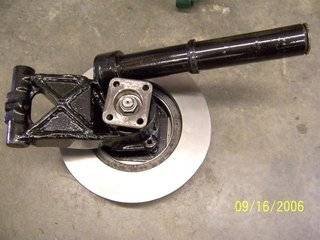

RLY240 Posted June 17, 2016 Posted June 17, 2016 I'm sort of surprised that as far as I know noone has looked at decreasing the height of the rear outer LCA pivot point on a S30 but perhaps there is a practical reason for that. Aaaagh, what the hell has this got to do with eternal project car You mean like this? No, not mine. Quote
260DET Posted June 17, 2016 Author Posted June 17, 2016 Those rod ends ^^ look the goods John, who sells them? Quote
260DET Posted June 17, 2016 Author Posted June 17, 2016 You mean like this? No, not mine. You mean like this? No, not mine. Yes, but a bit more attractive than that HybridZ effort. Quote
Sirpent Posted June 17, 2016 Posted June 17, 2016 Those rod ends ^^ look the goods John, who sells them? Synergy in the USA Used on aftermarket Jeep suspension set ups I have to put in my order in the next few days so John can build the LCA's now that I know the positioning and dimensions http://www.synergymfg.com/Synergy-Double-Adjuster-Tube-Adapter-p-19276.html Quote
Cozza Posted June 17, 2016 Posted June 17, 2016 Those rod ends ^^ look the goods John, who sells them? Yeah they look pretty and simple but at almost a kg??? There must be a typo. Quote
