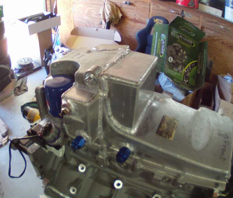

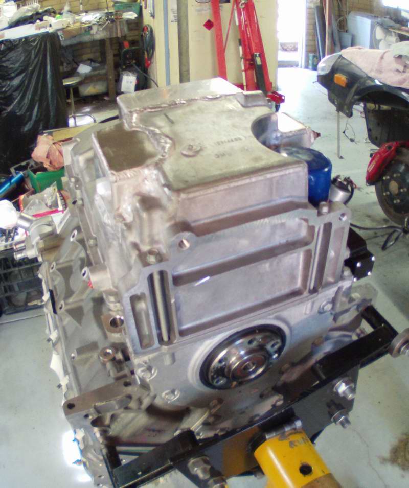

260DET Posted June 26, 2014 Author Posted June 26, 2014 OK, you want more sump pictures eh, the story first though. It was the Improved Racing crank scraper which was hitting and after several attempts to fix it gave up and put the sump on without it. Two problems with the scraper, the first being that it does not fit snug over the bolts so it's located precisely, the second is that it sits under the stock windage tray so it's impossible to see where it's hitting. We're talking small clearances between the scraper and the crank, precise location is a must in that situation, slack Yanks. Why do engine changes take longer than you think? Here is an example involving the power brake vacuum line from the engine. Firstly, different size hose which requires a reducer, try getting one of those to suit from Repco or Supercheep. Ebay to the rescue, again, together with some nice silicone blank off caps for the engine's heater hose outlets. Not those rubber ones that last six months if you are lucky. Second problem, the vacuum outlet on the inlet manifold points to the L while of course it has to go to the R. So order two 90 degree fittings and a connector, Ebay again. Saves so much time and money trying to chase up stuff on the phone when mostly if it does not come within 'make and model' so a day is wrecked driving around. Engine and box should be back in within a few days, can't beat progress that you can see. Now for the pics you have been dying to see Quote

260DET Posted June 27, 2014 Author Posted June 27, 2014 Yeh I should have resisted Jason's bait but was wetting myself laughing and after a few Friday arvo beers........... Anyway, on topic, as I explained the crank scraper was not snug on the studs so a repeatable 100% reliable fit could not be guaranteed even if the windage tray was not used. I've had enough of engine problems in the past so 100% reliability is the goal. Essentially, it came down to either fitting the scraper by itself with 99% certainty or fitting the windage tray with 100% certainty, certainly not both which was the original aim. Given that the modded windage tray is a good piece and likely to do more than the scraper anyway the final decision was easy. The lesson is perhaps don't just assume that a bought piece will fit, check it critically for fit and function. Quote
dat2kman Posted June 28, 2014 Posted June 28, 2014 Dowel them, like dowelled intake manis to heads for port matching, or the dowels std on head to block. The cast alloy L series sumps if dowelled to block in a few places gives the block a heck of a lot more rigidity. The crank scraper mount holes are bigger to fit over the threads, as shank is waisted down due to the rolled threads being a bee's pecker bigger. Yes they move, too much, hence engine building chapter 7, lesson on dowelling! What's a Matlock Marathon, is that a in joke thing for old folks? Quote

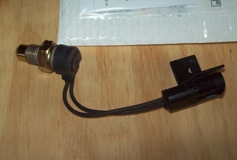

PeterAllen Posted June 30, 2014 Posted June 30, 2014 Not sure if you need a reverse light but if you do it will require a sender on which the the terminals come off at 90 degrees. Otherwise you will have to dent out the transmission tunnel near the sender for a GM unit which has the terminals protruding from the end. The 90 degrees senders came on early 00s Mustangs. Mal has them. Also, do you have the clutch bleeder extending up into the engine bay? Quote

260DET Posted June 30, 2014 Author Posted June 30, 2014 Reverse light switch clears OK Peter but there is one thing, no nuts for the two terminals And I have no idea what they are. Certainly not metric, near but not 3/16". Any idea? Would have been cheaper going with a Nissan NA V8 Matt but they don't make the power or have the power potential that the LS3 does. LS as well is light and compact, lighter than the VG and should give about 50/50 weight distribution. They have a lot going for them. Quote
PeterAllen Posted June 30, 2014 Posted June 30, 2014 Reverse light switch clears OK Peter but there is one thing, no nuts for the two terminals And I have no idea what they are. Certainly not metric, near but not 3/16". Any idea?... The terminals on the sender unit I'm using have no thread - they are push-on. Quote

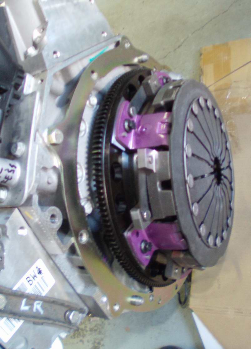

260DET Posted July 3, 2014 Author Posted July 3, 2014 Oh dear, after doing some measurements it became obvious that the big twin plate clutch would not fit due to the TKO gearbox input shaft and bell being too short to accommodate it. Looks like it fits the six speed box only so it's been replaced with a single plate job from Direct Clutch rated to handle over 500 WHP. Just hope that I can push the pedal in This clutch uses a concentric throwout which has the slave incorporated into it, see pic which shows the flexible bleed and input lines. Plan is to drop the engine/box into place next and bolt it all up. Quote

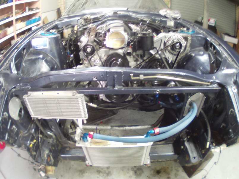

260DET Posted July 10, 2014 Author Posted July 10, 2014 Engine is in and all bolted up, Mr Fussy said that the gearbox mount had to be improved so that has been done. Lots of little things attended to, like putting earth cables onto the starter motor and engine block, made up an engine bay wiring loom for all the non ECU stuff like for temp and oil pressure sensors and alternator wiring. Everything has to be done leaving room for the exhaust which is tight on the driver's side. Hope to get the power steering pressure side line and the tailshaft tomorrow which means that the PS pump can be fitted which will allow the pre throttle body induction bits to be mounted, then the radiator etc which will be about it as far as my part goes. Pics next time when there will be more to see, cheers. Quote
260DET Posted July 17, 2014 Author Posted July 17, 2014 Just about ready to go to the pro to be finished off. All the front stuff is done except for the radiator to be dropped in and then hoses selected and fitted. No problem there, the local spare parts place will let me look through his stock of hoses. PS oil cooler hose to be fitted and one PITA thing, the alternator pulley does not quite line up with the others so I'll see if a auto leccy can help there. LS3 is a series four engine compared with the LS1 for example which is a series three. Different heads and a few other tricky differences which I've learnt about the hard way. Fitted an underdrive crank pulley, see pic, the other pic taken in artificial light in the garage shows the front - engine and PS oil coolers, Accusump, Nissan PS oil reservoir, throttle body and so on. The crank pulleys are just a press fit, not keyed, which means the degree markings on the underdrive pulley were not aligned with TDC.Bummer. Quote
