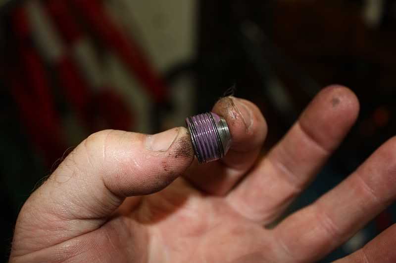

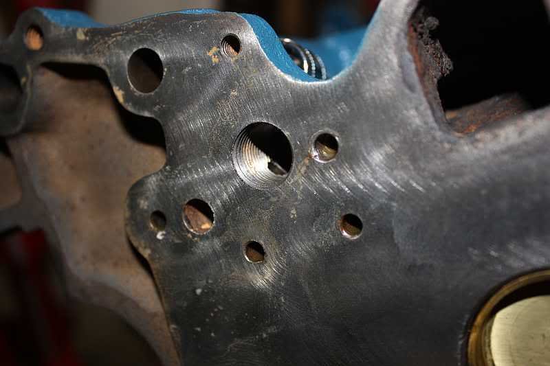

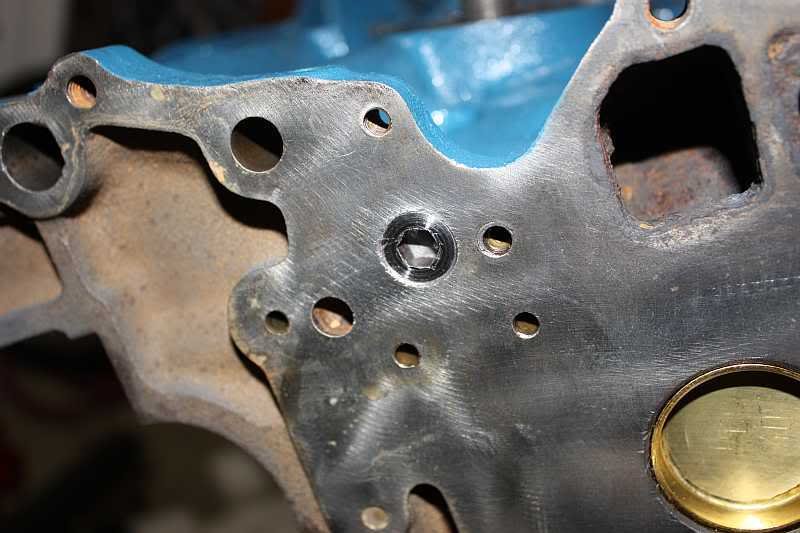

1600dave Posted April 6, 2014 Posted April 6, 2014 Oil gallery plugs are located as in the pics below, standard they are just a solid plug bashed into the block. Drill them out carefully, then tap the existing hole with a tap to suit a tapered, threaded plug (I can't remember if I used BSP or NPT plugs, would have to look at the taps). Careful with the one in the front of the block, there is an oilway intersecting the main oil gallery just inside, you don't want the plug to block this or your #1 bearing won't be happy. I had to turn the plug down in length to get it to clear. I run 10.4 compression in my L-series without dramas on 98 fuel. Quote

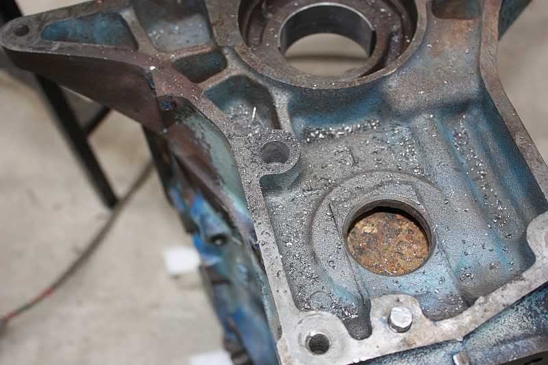

Administrators gav240z Posted April 7, 2014 Administrators Posted April 7, 2014 Sorry guys but why are we blocking off this orifice? Or are we just using a threaded screw for easier removal later than the stock plug? Since it is related any tips for removing the freeze / welsh / coolant plugs? I have tried a hammer and punch but I think mine are rusted in nicely. So thinking of drilling a hole then inserting a slide hammer to pull them out? Just want to be careful not to damage cylinder bores on other side. Quote
Enzo Posted April 7, 2014 Posted April 7, 2014 Hi Gav, Just started pulling down my L28 yesterday. The factory welch plugs have a sealant on them. Use your hammer and punch or a screw driver and hit on one side in the recess. The plug is tight so hit a few times if needed. When it starts to turn use pliers or just lever it out. David Quote
Administrators gav240z Posted April 7, 2014 Administrators Posted April 7, 2014 Thanks mate, yeah I started to do that but the punch just started to go through the plug (as in a hole in it) as oppose to push it to 1 side. Will give it some thought. Quote
1600dave Posted April 7, 2014 Posted April 7, 2014 Sorry guys but why are we blocking off this orifice? Its a hangover from the manufacturing process - they drill right through the block and then just blank off the ends with soft, bashed in interference fit plugs. There's quite a few oil galleries in the motor likes this (ie the head has a similar one from front to back, and one coming in from the side). I drilled the old plugs out so I could clean the oil galleries right out (I used long, thin bottle brush types cleaners, have heard of people using rifle cleaners) to make sure it was free of 40 years of sludge, plus the engine I rebuilt had scored bearings and cam, indicating the possibility of loose bits of metal / grit being in the engine. Without removing these plugs, you cant get in to clean the galleries thoroughly. Tapping and using a removable tapered plug is just one way to block the galleries again and is easily removed and replaced if / when the engine gets its next rebuild. I have them all through my engine, including the crank. Quote
1600dave Posted April 7, 2014 Posted April 7, 2014 For stubborn welsh plugs, I use a very large diameter punch - something like a big-ish bolt (cut the thread off, leaving just the plain shank) and hit on the edge of the lip of the welsh plug. Once it starts to spin, its easy to remove. The large diameter is so you don't risk scratching the block like you may if you use a standard, small diameter punch, potentially causing a spot that may leak. Not likely, but better to be safe than sorry. Quote

dat2kman Posted April 7, 2014 Posted April 7, 2014 Not all the oil passes through a filter, the blocks run a bypass, so yes, any crud left in after a rebuild, or other bits of "stuff" will eventually find its way between two bits of metal bearings, or, block a oil feed hole. Now, re drill and tapping the main oil gallery, take carefull note of the very small oil feed hole right at the end of the large gallery. Do not screw a full size plug in, to be flush with the block end face, as this will block THAT oil feed hole. Modify the screw in plug, file a bit off each side, you dont need a full depth Allen wrench hole. The next oil feed hole, is the one on top of block, this needs drilling out as it feeds oil up into head. Combined with the L28T high vol pump, this ensures more oil up top. Quote
ZED83 Posted April 7, 2014 Posted April 7, 2014 Hay Gav this is what you'll need to do to your block if you are thinking about building a stroker with the LD-28 crank you have. This gives reasurance the oil gallery plugs won't be pushed out under higher oil pressures. The other one you wan't to tap is the oil filter bypass ball bearing for the reason you don't loose oil pressure. So pull it out an put tap in there to. Quote
