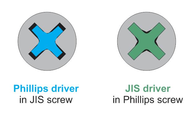

GongZ Posted May 2, 2016 Posted May 2, 2016 (edited) Out of curiosity, I tried one out on a few screws on my 2001 MX5, they seemed to like the JIS ones better as well. It seems to me that the information in this thread suggests a 'rule of thumb' that could be applied when working on old Datsuns. i.e.; Unless you are sure what type of screw you are dealing with** - try a JIS screwdriver first. (** - I have read that only some JIS screws have the punch mark) I say this because, as originally described by YoseMiteZed, a Phillips driver should not be used for a JIS screw - but a JIS driver fits a Phillips screw quite well. I created this drawing showing incorrect driver/screw combinations. Note that it is not based on any particular screw or driver size and may exaggerate the difference marginally. Also notice that the Phillips screwdriver shown is smaller (and would wiggle = backlash?) than the JIS driver to allow it to cope with the 'squarer' internal corners of the JIS screw. Edited May 2, 2016 by GongZ Quote
