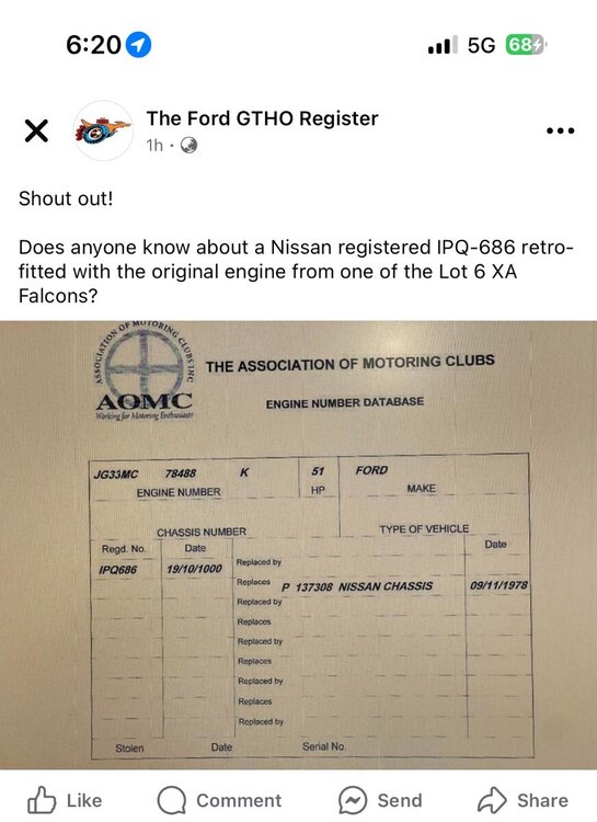

I’ve seen a 351 sitting in a Z with modified sump and pickup pipe hanging over the rack, so they do fit. As for the date on the certificate that’s the year the engine swap took place. The reg is circa 75/76 if a Vic plate, mine was first registered May 1975 with reg IEG-380 To me it seems to point to a Zed granted the P137….. reference confuses matters, then again, imagine if it’s still out there running a Phase 4 works motor……..Priceless
An interesting thread on FB there were 4 Phase 4 XA GTHO’s built by Ford’s skunk works, they were known as the Lot 6 cars. It seems one that was written off had its Phase 4 351’s dropped into a “Datsun” Could it have been a most likely candidate into a Z registration number IPQ-686 with a vague reference to P 137308 Any thoughts? If a Zed, it’s priceless if it still exists

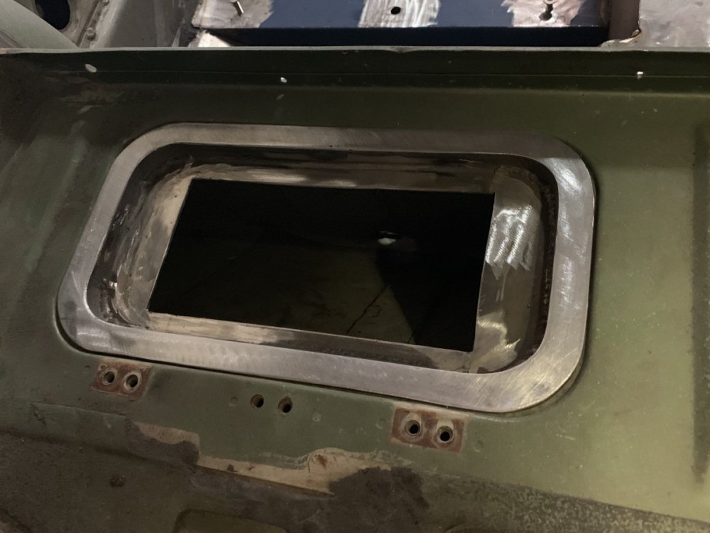

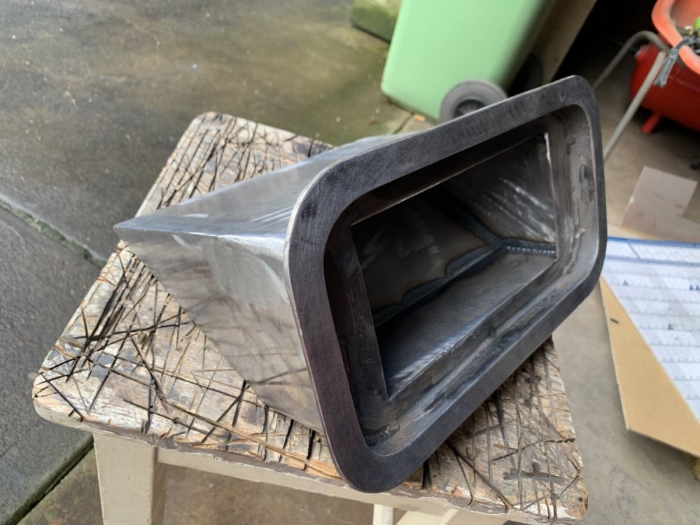

Buy CBR a cigar! correct, as the tank now sits in the spare wheel well I had to re-route it and encase it as I will be running dual exhaust and dual mufflers so this way the filler will be away from any direct heat source.

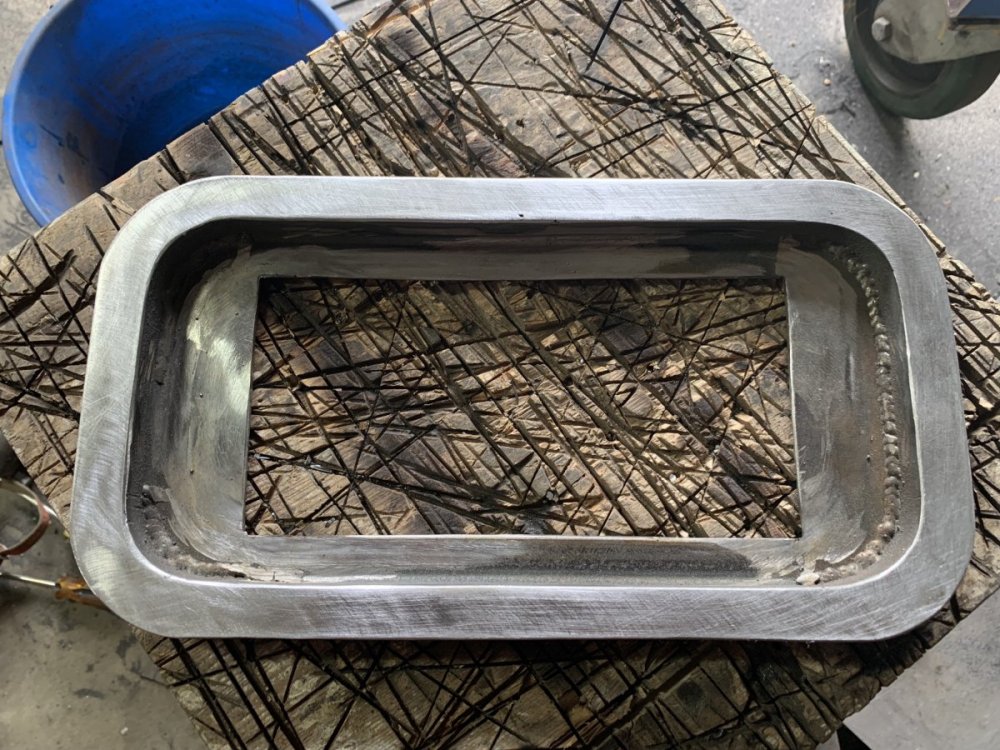

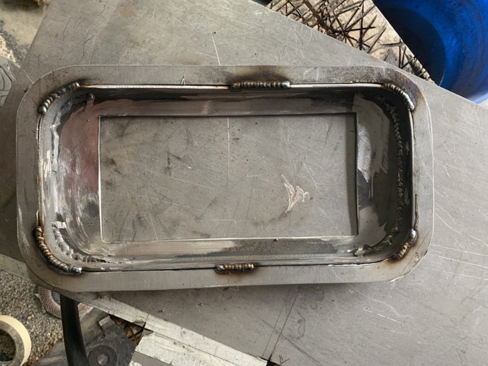

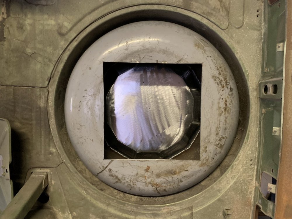

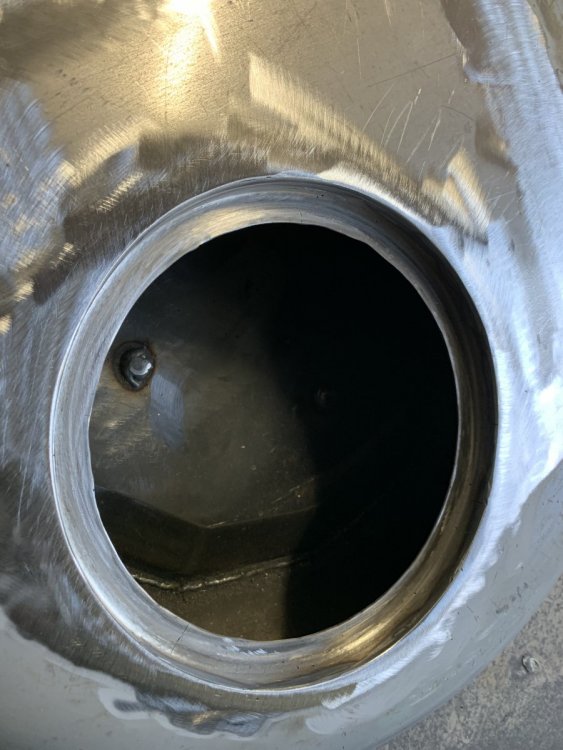

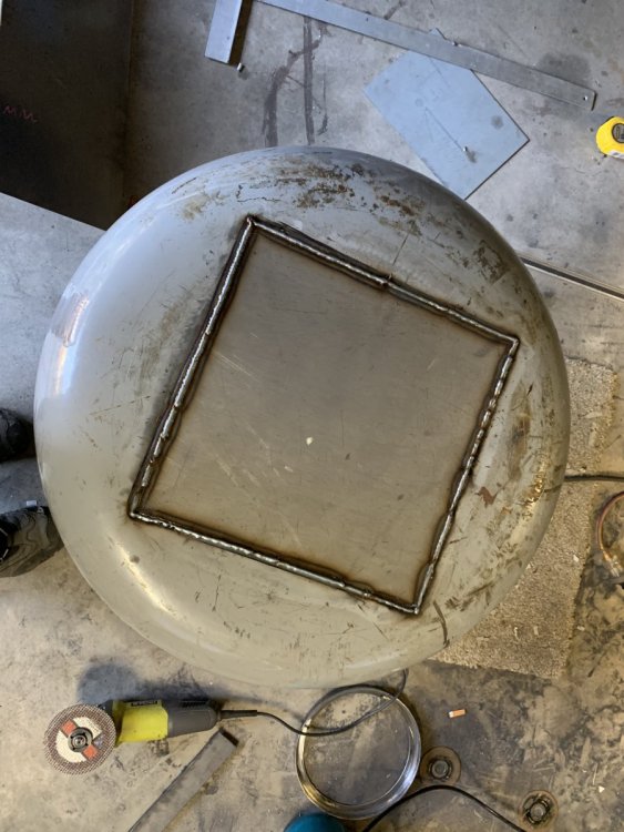

When necessity is the mother of invention Core of the tank is now complete and now to move onto all the ancillary pipes and fittings

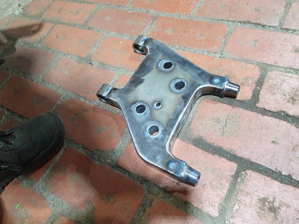

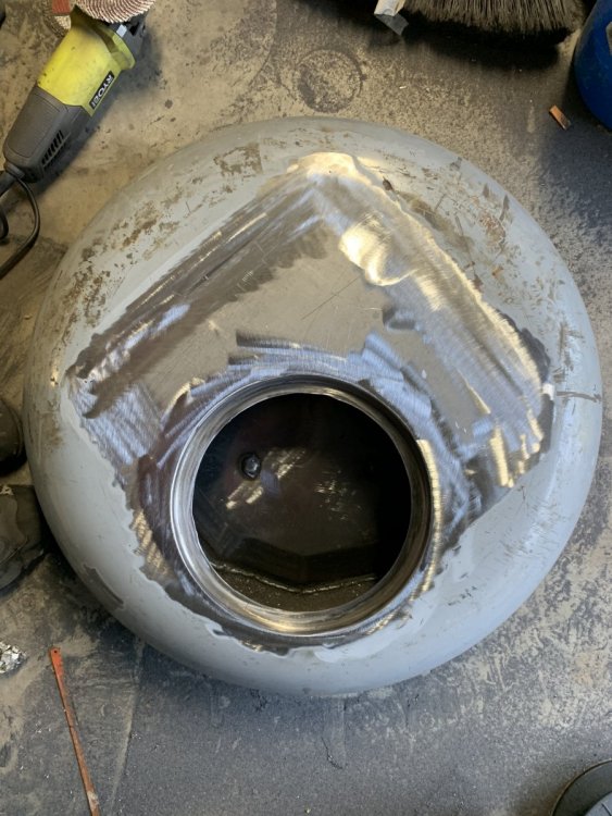

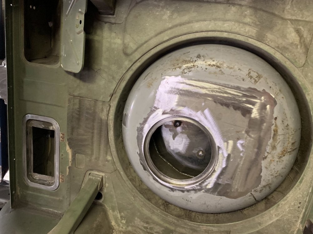

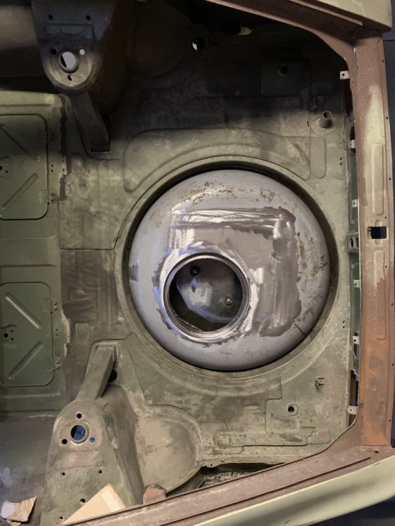

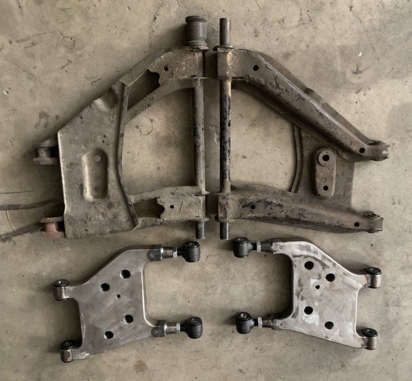

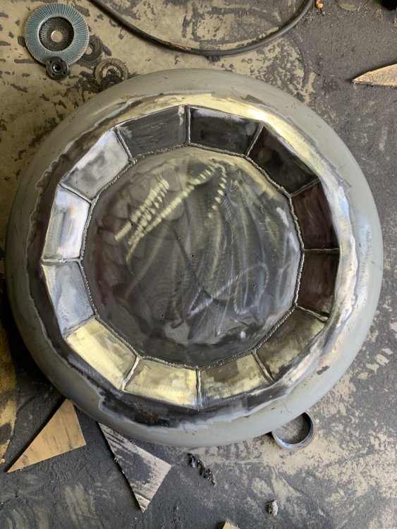

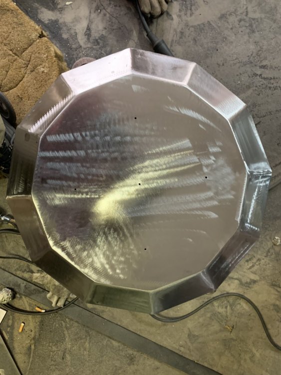

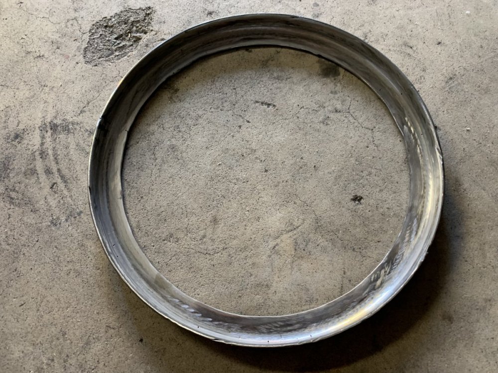

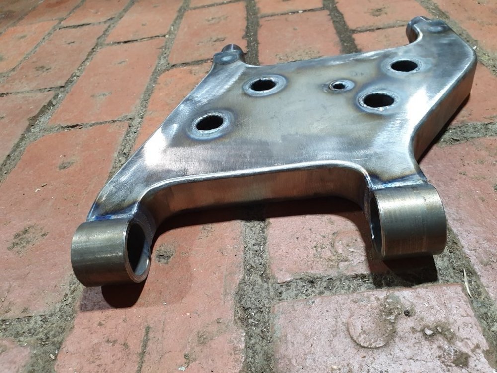

Been a few weeks, unfortunately illness and waiting for John Lange to finish the custom rear control arms have slowed me down So moved onto the rear fuel tank fabrication, using the LPG donut tank as the basis First was chopping 65mm out of the height through the centre aa well as removing the center tube section Then it was a matter of fabricating a centre rise section to clear the spare wheel well hump With the modifications, I’ve worked out it should be between 58-60 litres plus another 8-10 in the additional surge tank All in all so far a perfect fit See you all next week

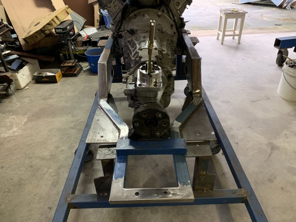

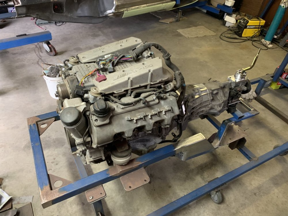

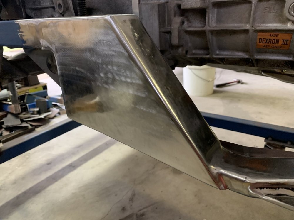

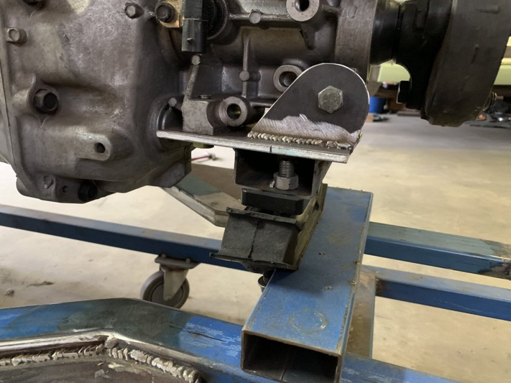

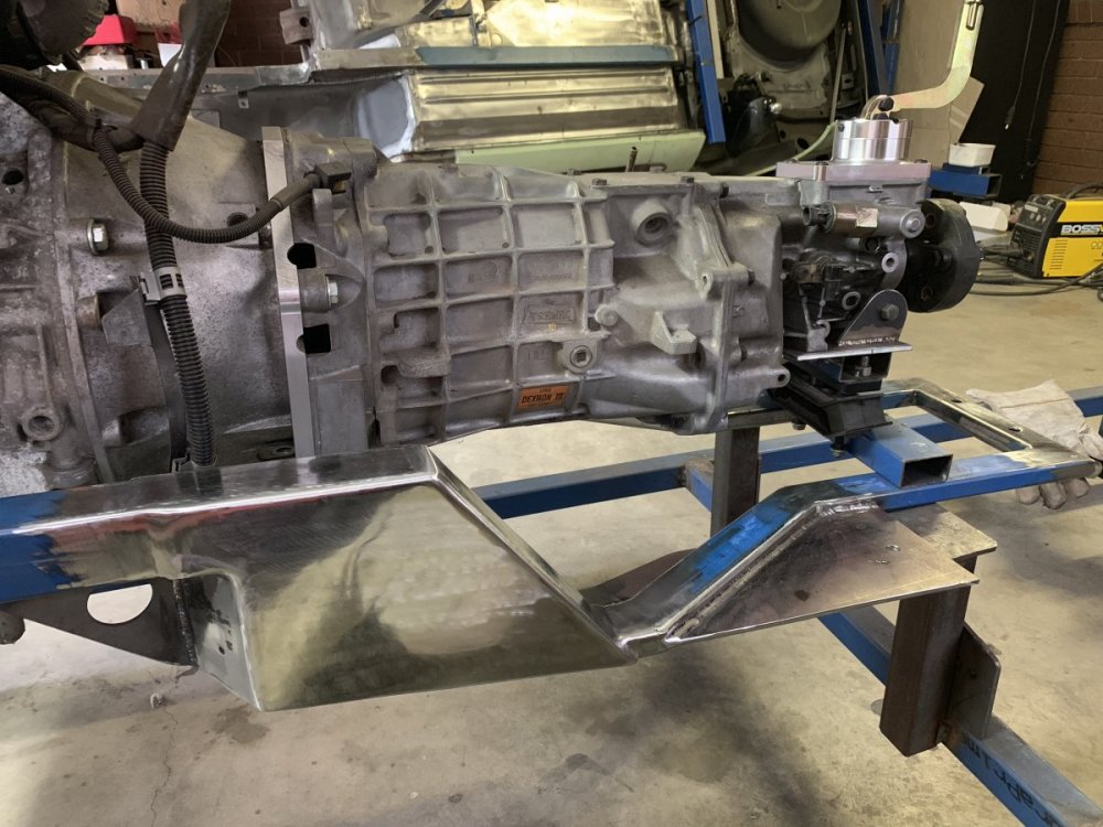

Rear gearbox mount almost done, just need to fix the height position and fab some outriggers to the cradle lots of room for the twin exhaust and will tuck inside the tunnel snd of course start of the obligatory smoothing of some weld areas and metal finishing due to my OCD
