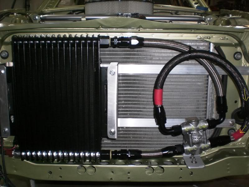

  14. Found a few prices online for a Mocal oil Thermostat with AN-10 fittings looking at around US$119 see link below. http://97.74.103.94/files/thermos$.pdf?Submit1=More+Information+and+Pricing
  15. http://www.thinkauto.com/oilstats.htm below quote from this link.
  16. ok after much searching I think I have found the same oil bypass valve pictured it is a Mocal. Specifications and installation are in this link. http://97.74.103.94/files/thermos$.pdf
  17. I guess you were talking to Hunterzed. but just go to ebay.com do not put ebay.com.au. this will take you to the american ebay site. type in "240z radiator" you will find a page or so of them there. they all look pretty similar.
  18. I was doing some research on front radiator ducting on hybridz.org and found this picture, It is described as a "high flow capacity, bypass thermostat for the oil system" looks like the answer we are looking for. I put some yellow directional arrows on the hoses as I stared at the pic for 5 mins trying to work out what was going on. (hose colours blend a bit going through radiator support) Also take note of the markings on the thermostat. Seems like a simple automatic solution. I will be doing some research on pricing and manufacturers I will keep you all posted. EDIT: After reading the installation and specification pdf that I have linked futher in this thread. It looks like the image below is plumbed up wrong. check it out yourself.

  20. how many rows does that oil cooler have? I like the fine mesh on your front grill. keeps the bugs out. I will use that.
