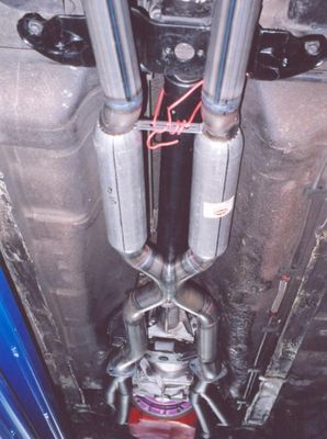

  20. You want something done like this Dave. Old shot but you get the picture. You go a single resonator and it won't go up into the tunnel high enough. You will need the clearance. If I can't break the diff brace then I think you should be safe Dave.

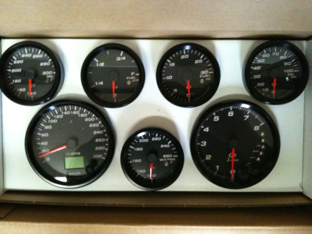

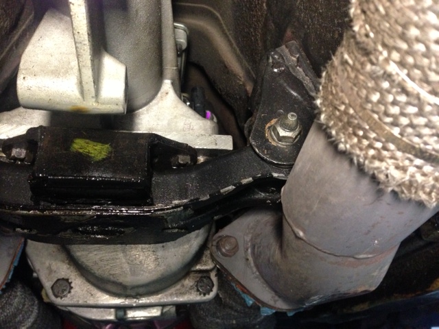

  23. Morning Gents, Thanks for the advise Daz & Nato I will have to check the front fire wall and a few other areas for cracks when next on a hoist. I am hoping no issues due to the 8 point cage. I don't have quite 600bhp but maybe one day. Ha Well I only drove the car home but managed to give it a few bursts and found the car to feel a lot better. I am pretty sure I have fixed my problem. So for those chasing their tail re vibration like I have for years this is a good area to look at. Especially since my engine was moved back so far. While this gave me prefect weight on all 4 wheels it did leave most of the weight of the engine & gear box hanging on at the tunnel. Anyway happy days and I can now move onto the next project being the oil cooler then my 7 new gauges from the states that I have been sitting on for years. Complete with Tacho with progressive led shift lights and GPS speedo to 300klms. Then I will finally know how fast I am really going when I wind it off the clock back to the zero ha ha. Ah those are the days.

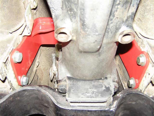

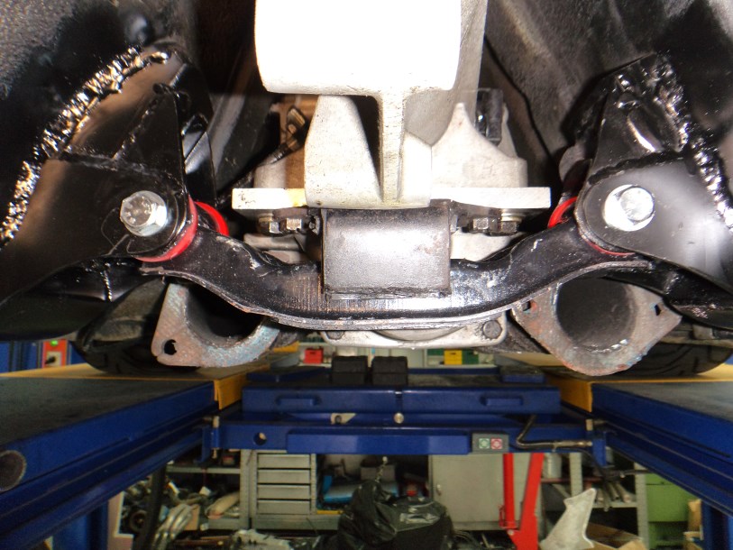

  24. Hi Peter, Well it is a sort of structuralFlex thing combined to do with the tunnel vebrating under heavy load. So everything has now been strangthened and welded in. Everything was in alignment and perfectly balanced. I guess 750nm of torque in the tunnel is to much for the flimsy sheet metal to take. So as per photo's it is locked in. I am picking the car up shortly and will maybe get a test drive in over the weekend. Remember like I said earlier if not under full acceleration I never got any vibration. Just at full throttle at certain speeds.

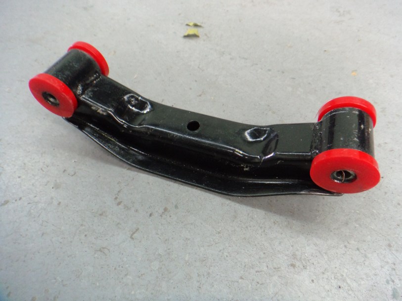

  25. No I haven't taken it for a drive yet. I may not get the car back till early next week. Then I will have to find a time and place to take it up to 200klms and test it. One other issue we addressed was the rubber in the standard crossmember (Bolt Fastening). It is next to useless for anything other than standard application. Even then I would say it is questionable given the gaps around the rubbers. So we pressed out the standard rubber ones and inserted nolthane bush's. So stay tuned I guess and all things going well I will have fixed my problem.
