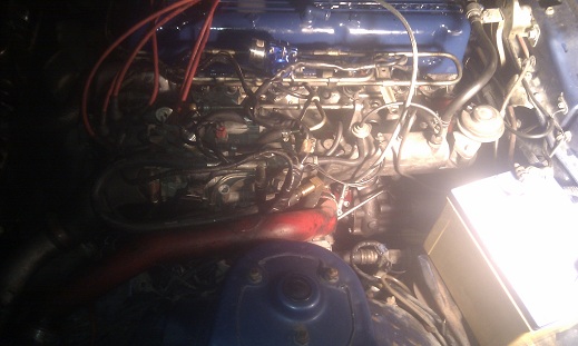

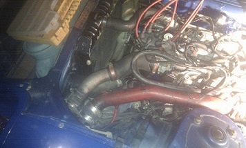

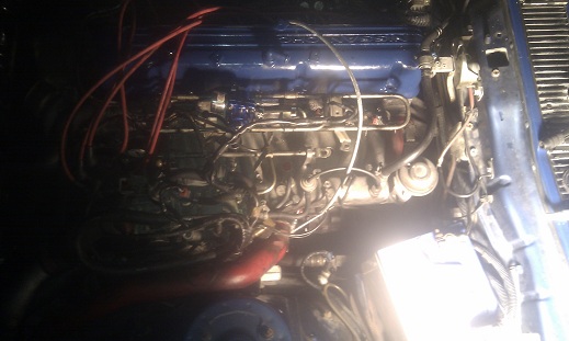

  20. sorry about the crappy night pics.
  21. well i decided after a blown head gasket to bring all the goodies out of the shed and start bolting them on, so to start. i was scrolling through the parts system at work for a head gasket and much to my excitement i also found that i could get a head shim so i orded it thinking it would be much the same as all the others at 0.2mm, it turns out i was wrong it was 1.5mm after it was compressed so after a quick inspection of my internals of the engine it turns out they are all brand new not just second hand, it has new rods bearing and 1.5mm oversized pistons and to top it all of the block has beautiful hone marks in there. so after many hours of wrestling with the engine i got everything bolted on for the first start up much to my amazement i turned the key and it ran first turn of the starter. so the current setup which is not ideal and will be fixed this week coming is as follows, fully rebuilt N42 head that has mild porting fully rebuilt F54 block with new rods and deep dished 1.5mm oversized pistons has a L28E dissy set to 5 degrees BTDC rising rate FPR running 40psi stock and 60psi at boost standed airflow meter standed injectors (these will be replaced first thing in the morning with 280cc turbo ones) turbo manifold is a F54 and a stock 280zx turbo what will be going in over the next 2 weeks z31 turbo ecu, wiring and distributor greddy ultimate ecu (piggyback system) map sensor for the greddy ecu so i dont need a maf sensor wideband O2 550cc sard injectors brand new top feed and to top it all off it will be running a Holset hx35w turbo from a cummins truck here is a small video of its first run cheers pauly
