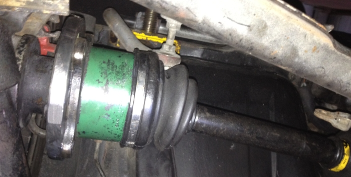

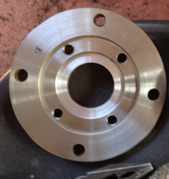

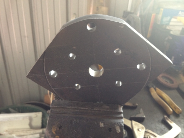

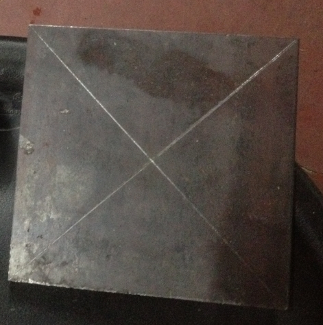

my_mad_z Posted December 27, 2012 Posted December 27, 2012 Hi all, Just letting you know that I recently finished a CV conversion in my 240Z; I used the Z31 CV's and made my own adapters. I made them out of steel, took me about 10 hours on the lathe to turn them down - took so long as I only have a mini lathe and I think it was treated steel not mild - would take a fraction of the time on a decent size lathe. I have drawn it up to scale in CAD if anyone is interested, I'm happy to share the info and email the CAD file. I've got a long nose R200 LSD ( I think it's from a HR31); the CV's are from a Z31 turbo; I purchased some 16mm flat plate (135mmx135mm) from a local steel shop and machined to size. I should have used round steel bar instead of flat plate but it wouldn't fit in my lathe . I used high tensile studs/nuts to bolt to the 260Z hubs to the adapter; I tapped a thread and then welded the rear side of the stud to make sure they never come out. I used the standard Z31 half shaft bolts/nuts to attach the CV to the adapter. Works a treat. I did the standard mods to the CV's to make them fit (reversing the bearing carrier and machining a couple of mm off the spline). The dust caps need to be removed otherwise it will interfere. Here are some pic's of the adapters. Quote
