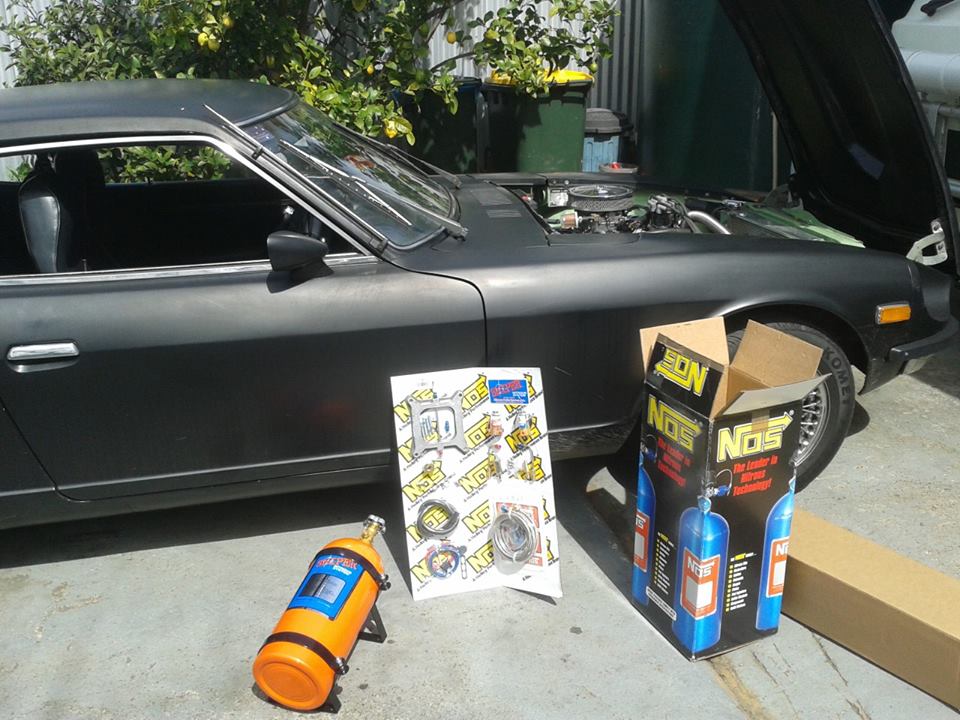

Scoota G Posted November 13, 2013 Author Posted November 13, 2013 Could be the go Wayne. I got some new tricks for the girl throwing out the Edelbrock and replacing it with a Mechanical Secondaries 650 Holley. Also there's the new hood scoop to be fitted soon and the Nitrous kit after i rebuild the engine. Quote
Riceburner Posted November 13, 2013 Posted November 13, 2013 Hehehe. What sort of hp increase does the nitrous give? Quote
Scoota G Posted November 13, 2013 Author Posted November 13, 2013 Hey Gareth, it's an adjustable unit which is entry level 100-150hp. I just want it there for the purge. Quote
KatoKid Posted November 13, 2013 Posted November 13, 2013 I just want it there for the purge. You need one of these Scoota http://www.dynotunenitrous.com/store/scripts/prodView.asp?idproduct=92 Quote
luvemfast Posted November 13, 2013 Posted November 13, 2013 How about you bring the NOS to the Xmas BBQ? And we all pass it around taking tokes, laughing our heads off! Quote
Scoota G Posted November 14, 2013 Author Posted November 14, 2013 How about you bring the NOS to the Xmas BBQ? And we all pass it around taking tokes, laughing our heads off! I thought of that but then on the bottle it says it can be fatal. But hey i'm sure Auszcar would make the national news for the first time. Quote

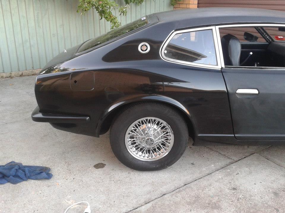

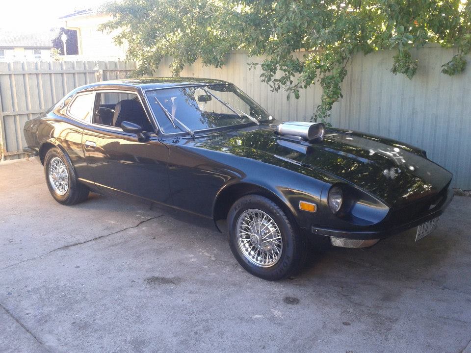

Scoota G Posted January 14, 2014 Author Posted January 14, 2014 The paint on Lucinda was starting to chalk a little so i gave it a quick sand and threw on some Jet Black on the weekend. I'll redo it again in a couple of weeks just to tidy up bits i missed. Quote
Moderators PB260Z Posted January 14, 2014 Moderators Posted January 14, 2014 Mark She looks good Quote
Administrators gav240z Posted January 14, 2014 Administrators Posted January 14, 2014 Looking a lot better mate, the flat black was cool but the shiny surface helps show the curves of the old girl. The 2+2's tend to look better in the darker colours also as it tends to make the extended roofline less obvious. Quote
Johnboy Posted January 14, 2014 Posted January 14, 2014 I personally think she looks much better with the shiny paint job. Nice work Mark. John Quote

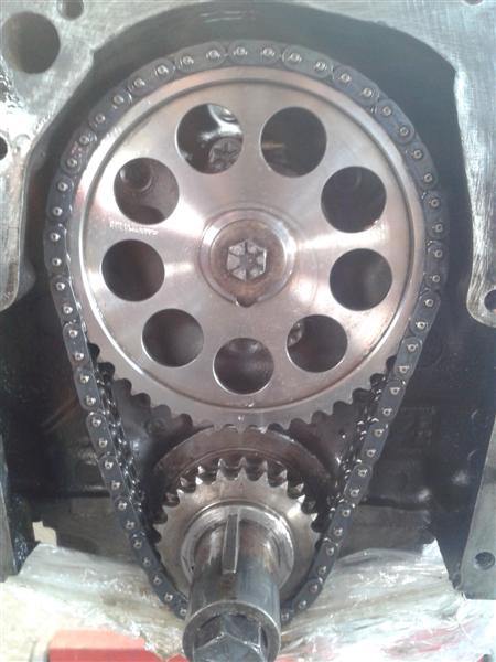

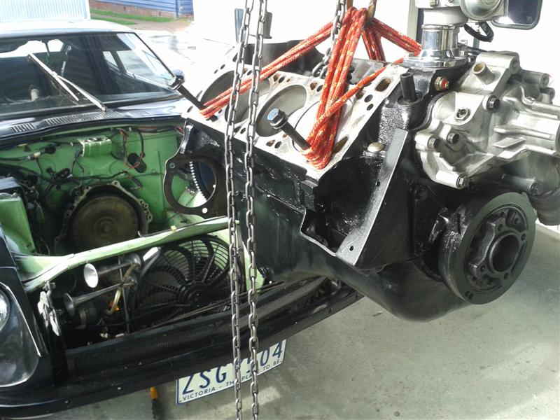

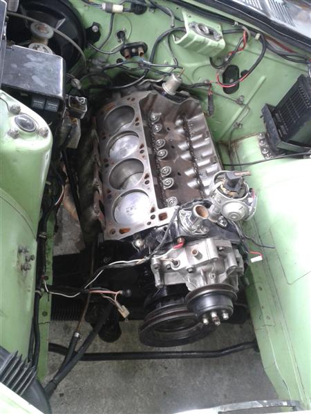

Scoota G Posted June 23, 2014 Author Posted June 23, 2014 I just replaced the engine with this stand in. I needed to get the block that the car was engineered out so i can build the Stroker. Yes, Stroker! I happened across a stroker kit on Gumtree, brand new, and made the guy an offer so i have most of the bits to start building. Quote
Riceburner Posted June 23, 2014 Posted June 23, 2014 Haha, was that 'diggity' or 'giggity' at the end of the video sounds pretty shweet, what's exhaust the system? Your neighbours must love you! Quote
