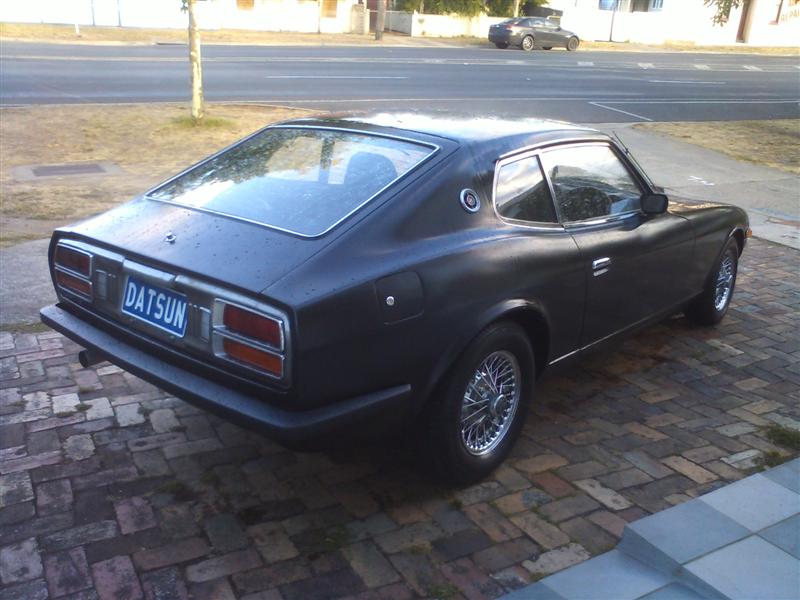

MaygZ Posted November 17, 2012 Posted November 17, 2012 Gotta take it easy with those saturday morning garage sale mob on the prowl for a "bargain". The camera shot from the windscreen put the up to date legitimate pemit just out of screen. Weird hey MaygZ! That sort of stuff is always the way too! Quote

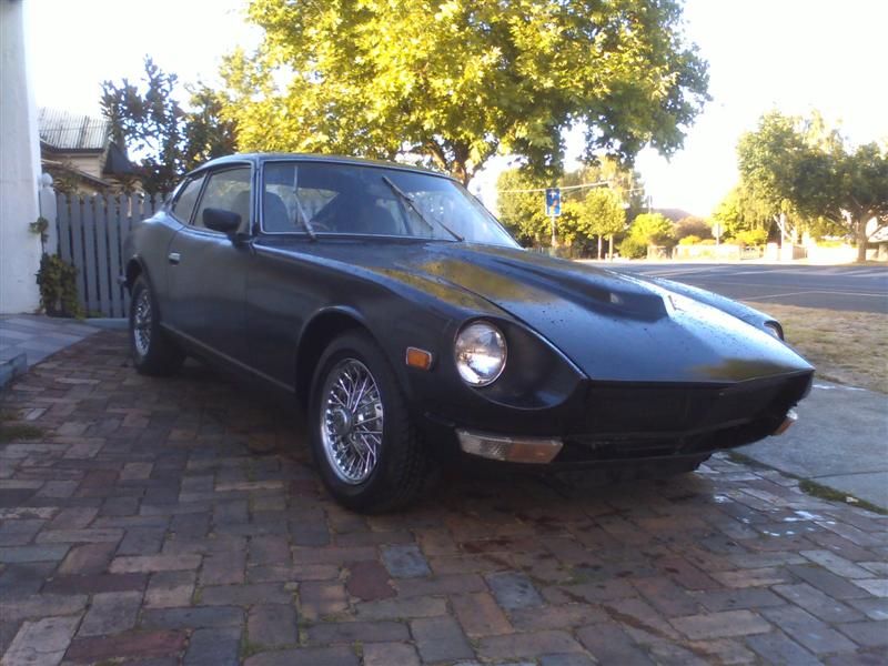

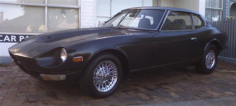

C.A.R. Posted January 31, 2013 Posted January 31, 2013 For heavens sake mate - loose the wire wheels! Quote
Riceburner Posted January 31, 2013 Posted January 31, 2013 Looking good Mark, Bonnet has turned out really well! Quote
Scoota G Posted January 31, 2013 Author Posted January 31, 2013 For heavens sake mate - loose the wire wheels! No Dice. The wheels stay! Quote
luvemfast Posted January 31, 2013 Posted January 31, 2013 For heavens sake mate - loose the wire wheels! ^^^^^^I'm with dummen Kopf^^^^^^ Quote
zzzzed Posted January 31, 2013 Posted January 31, 2013 ^^^^^^I'm with dummen Kopf^^^^^^ I'm with These two. Worst rim ever put on a car the rest is cool though Quote
Scoota G Posted January 31, 2013 Author Posted January 31, 2013 It's a hotrod and the wheels stay. Quote
Moderators Zedman240® Posted January 31, 2013 Moderators Posted January 31, 2013 Yeah..leave the wheels on the Austin Healy...I mean ZED! Quote
lightmaster240z Posted January 31, 2013 Posted January 31, 2013 Scoota did the wheel come with the car or did you acquire them? The reason is that a Friend of mine had a 260 with those rim from new. He got the car from the Kew Datsun. Quote
FuzzyDropbear Posted January 31, 2013 Posted January 31, 2013 Looks good Scoota, the boys from work commented on how good it looks with the new paint on it I forgot to ask last time I was over, are you going to do a modified grille for this one? Quote

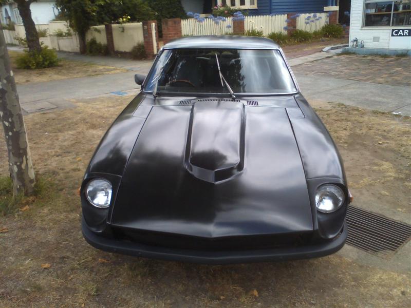

Scoota G Posted January 31, 2013 Author Posted January 31, 2013 Wow a whole page dedicated to banter about those wheels, very un impressed guys. What i should do is cancel the engineers report and spend a bunch on new wheels. Will be great to just sit there and look at the thing and only drive it up and down the driveway for the next 3 months. Then just to please everyone else i'll convert my 2 seater to manual. Scoota did the wheel come with the car or did you acquire them? The reason is that a Friend of mine had a 260 with those rim from new. He got the car from the Kew Datsun. Bruce, the wheels came off viveks car. I have had offers on them. Looks good Scoota, the boys from work commented on how good it looks with the new paint on it I forgot to ask last time I was over, are you going to do a modified grille for this one? Rob, the grille is custom made from supermarket shelving brackets and a speaker grille from a pub in Ballarat. I'm really glad i shared this with the club, thanks! Quote
FuzzyDropbear Posted January 31, 2013 Posted January 31, 2013 Cool mate, i actually missed it in the photo but I can see it now, blends in nicely. Quote
