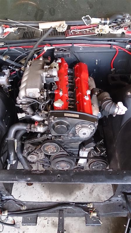

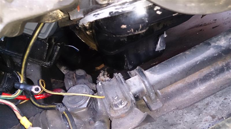

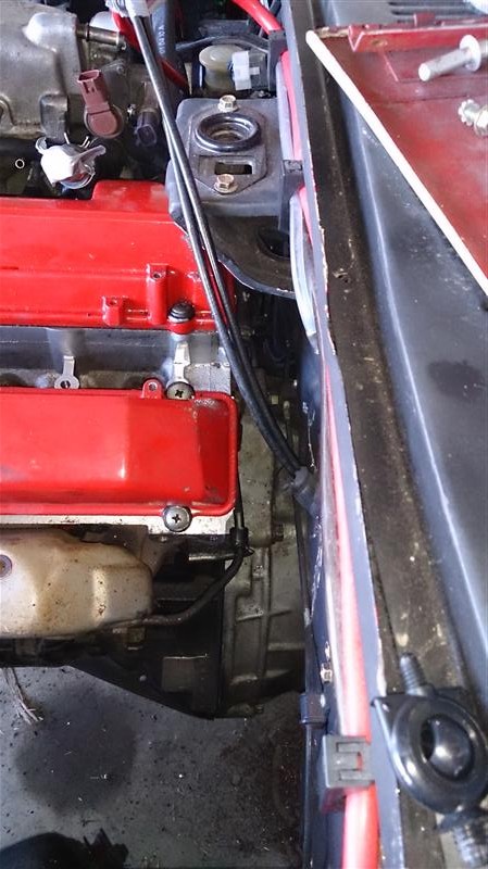

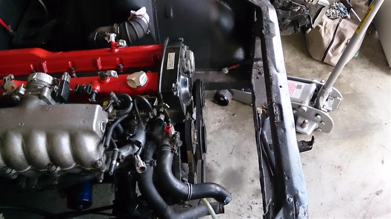

BobsYourUncle Posted April 14, 2013 Author Posted April 14, 2013 Well, after much straining and swearing, it's in. I have the best wife, she was out helping me for about 3.5 hours today. Nathan's (nat0_240_chevZ) engine and gearbox mounts put the engine in a pretty good spot, low and back near the firewall. There's plenty of clearance between the 200ZR sump and the engine crossmember. I just had to massage and oil drain line, and drill new holes for the alignment pins on the VL rubber isolators. I did scratch the paint on the firewall a bit though, so that'll need to be patched up or re-done. Quote

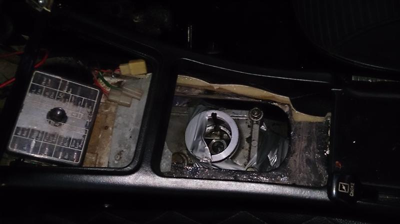

BobsYourUncle Posted April 14, 2013 Author Posted April 14, 2013 The gearbox is pretty well positioned too, although I might a bent/curved gearstick... Quote
dat240z Posted April 14, 2013 Posted April 14, 2013 Good stuff mate, itll be worth it trust me. RB z's are great. How low does the sump sit? When I did my swap it was so low i had tp revolume and cut the sump to raise it..... Quote
BobsYourUncle Posted April 15, 2013 Author Posted April 15, 2013 The lowest point on the sump is only just (maybe 10mm max, haven't measured) below the lowest point on the engine crossmember. It looks to me like it should be ok. Quote
