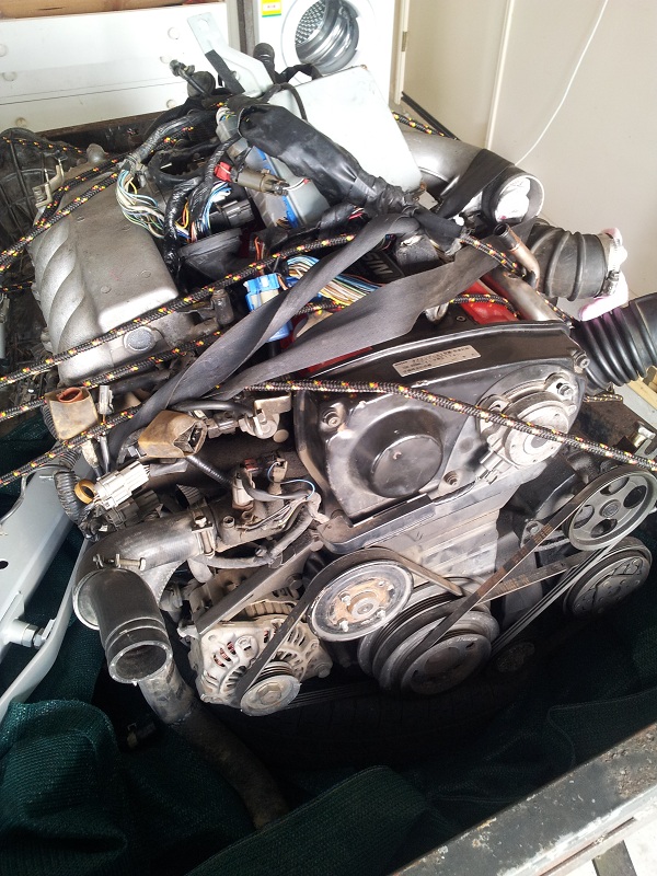

BobsYourUncle Posted December 19, 2012 Author Posted December 19, 2012 Early Christmas present for the zed - I couldn't help myself, I'm a sucker for punishment... Quote

BobsYourUncle Posted December 19, 2012 Author Posted December 19, 2012 Yeah, I'm going to go with the Ford dash green on the previous page. I'm organising quotes at the moment, but it's not the best time of the year to get things done... Quote
