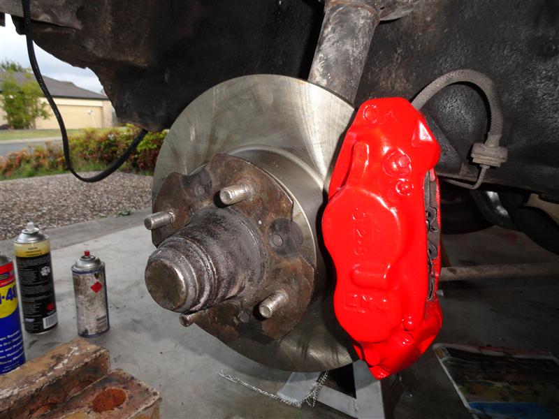

BobsYourUncle Posted October 12, 2011 Posted October 12, 2011 It's about time I started a build thread for this... A couple of months ago I bought Benny's 240z. I've been holding off on posting this thread until I'd actually done something to it so it felt more like 'my' project. I won't post any general pictures, since they're in Benny's thread. Anyway, so far I've put on a 1" brake master cylinder, and Hilux front brakes - see attached pic (although they're not bled yet). My immediate plans to get it on the road are (off the top of my head, probably missing a few): - get brake system operational (including hand brake) - move fuel tank to fit wheels properly (it's currently a too far to the left for what I want) - set up fuel system (still not decided on this one...) - fix up a few oil leaks and replace a few bushes - sort out some electrical/wiring issues - fit central locking - fit air con (going for a Vintage Air setup) - new wheels - fit front bumper (I've got a new chrome one, but I'm leaning towards a fibreglass one that I can paint) - paint (well, get painted, I think I'll pay to get this done properly) I'm not sure on fuel system - the car has round-top SUs that have been cleaned up and had a kit put through them (I believe), and I've got triple DHLA40s that I've stripped down and rebuilt, but I keep coming back to EFI for low maintenance, reliability, and fuel efficiency (to a very small degree, this really doesn't come into it. I've got the air con system pretty much planned out, I'll post some details in the next few days. In the future (when the car's on the road) I'd like to look at making up an in-dash computer with touch screen that could control the air con (looks do-able) and double as the stereo. This is a bit ambitious I think, and will be one of the last things I do. More updates to come. I want the car running by Christmas (painted and registered would be nice, but that's probably pushing it... I'm playing cricket on Saturdays and training twice a week, so time is limited). Quote

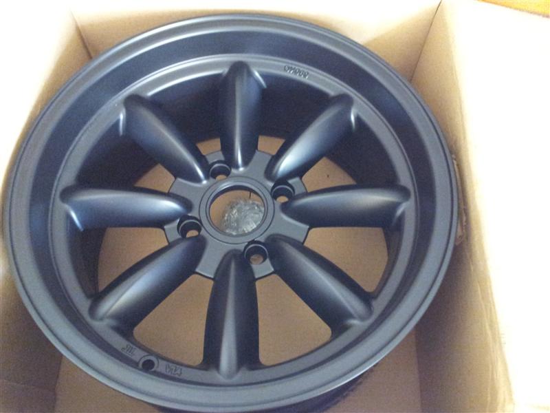

BobsYourUncle Posted November 15, 2011 Author Posted November 15, 2011 Wow no updates in a while... things are happening, but nothing major enough to warrant an update. However, pretty things have arrived... 16x8 +04, matte black. Quote
Riceburner Posted November 15, 2011 Posted November 15, 2011 Those look hot Ian! You can't beat matt black wheels on a zed, will look very cool with the paint color Quote
