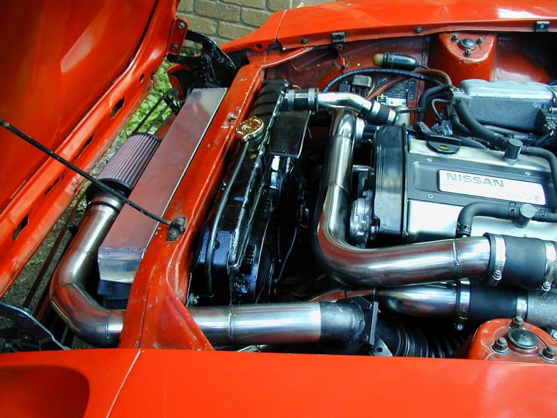

This all lead to the car currently sitting in my garage, a 72' 240Z. I found the car on carsales this was the ad-
Classic 240z Datsun project car with lots of expensive parts, but lots of work left to do.
RB20DET (2.0L six cylinder turbo) engine from Nissan Skyline with 5 speed gearbox, which has been dynoed in the car at 260 rear wheel HP.
Heavy duty clutch.
Customised engine mounts that locate engine low and back for better mass distribution.
Original engine management from r32 skyline, with closed-loop cruise for efficiency on separate wiring loom from car's other electrics.
560x300x73mm custom cored aluminium intercooler.
Stainless tig-welded inlet plumbing with large K&N air filter.
Full 3.5" exhaust with removable cat section and custom dump pipe.
Koni shocks - red in rear, yellow in front, shortened for larger 17"/18" wheel setup.
Custom licence plates (24OZT) for sale with car!
Body is rust-free, but paint and panel work needs a redo to be in show condition.
Lots of work remaining to be done on car - not in driveable condition as is. Needs work on brakes to be moving, and much more to be roadworthy.
Plenty of other datsun parts available with car, including L24 engine.
Would be great as a basis for a project car, as plenty has been bought or built, but lots of work and customisation left to do yourself.
Here are some pics-

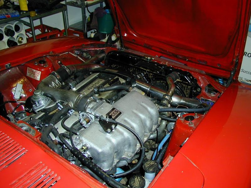

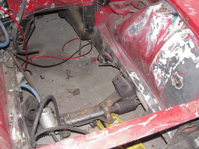

First thing i did was pull the motor and sold it it Mick (zzzzed) for his 240Z project and then purchased an l28 From him.
Before-
After-
Awaiting its heart!!

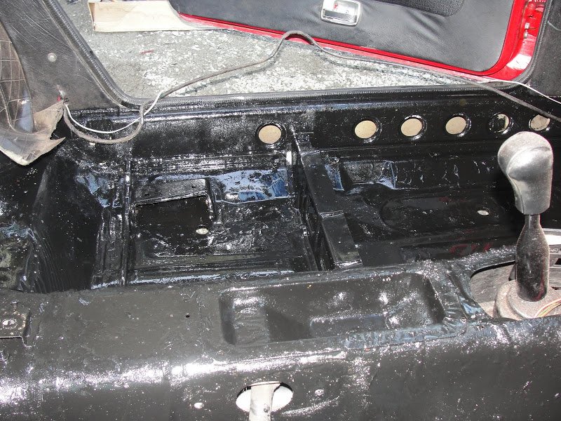

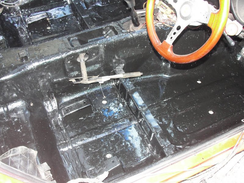

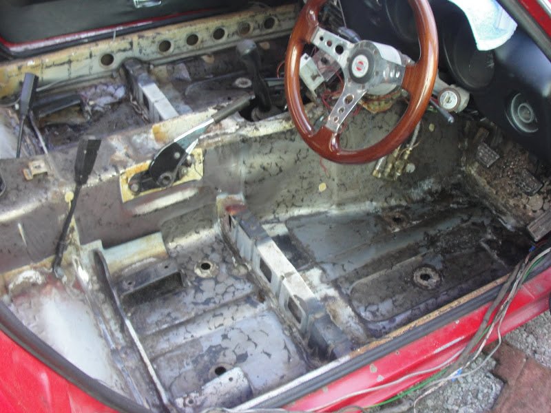

Next was the interior,

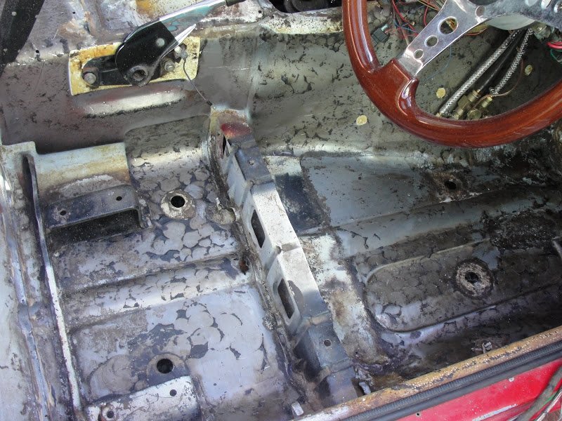

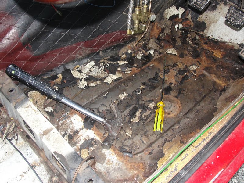

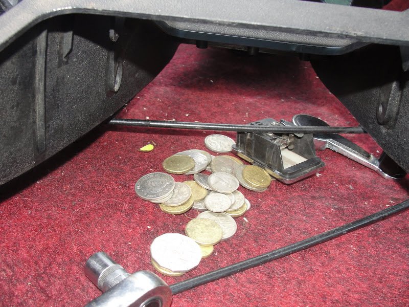

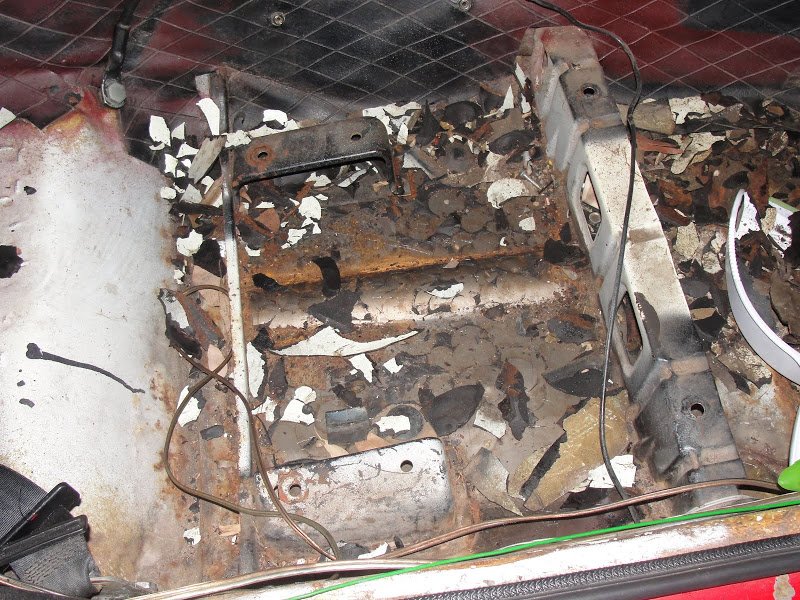

Started by pulling the seats and all vinyl and carpet found about $16.00 in the process
Then me and my little bro stripped out all of the old rubbish tar deadening
Little bro hard at it

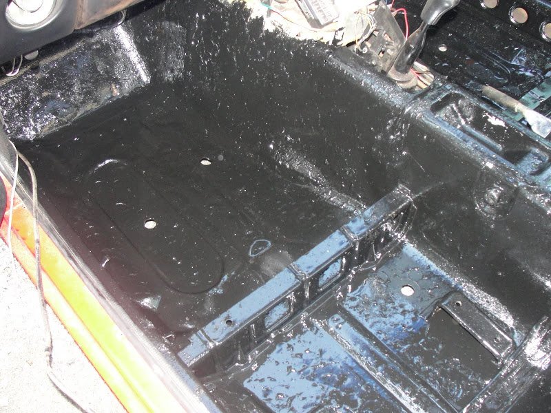

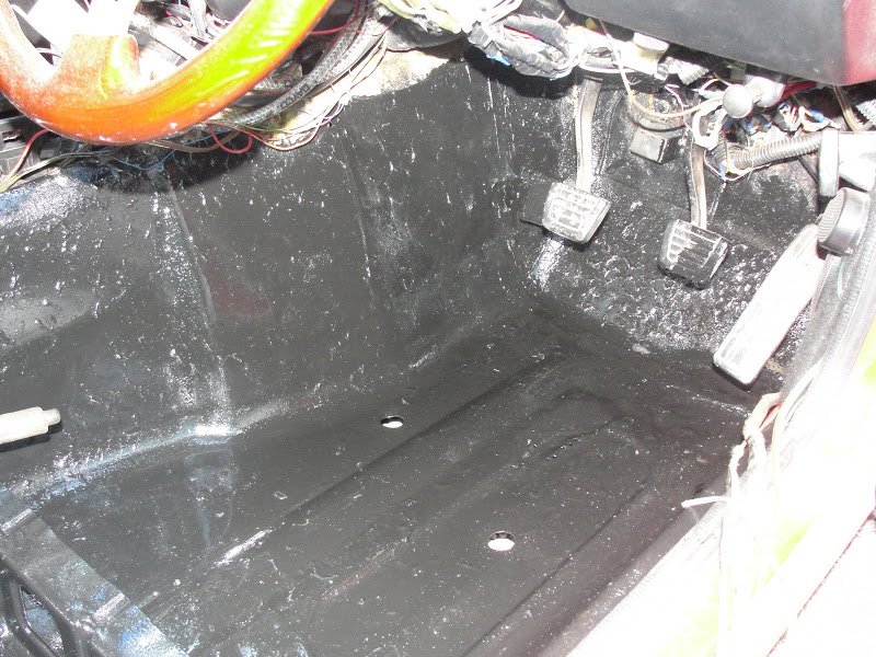

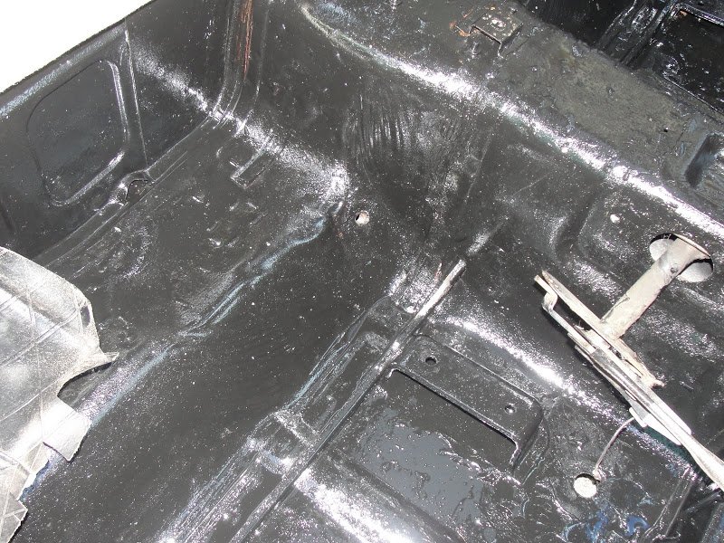

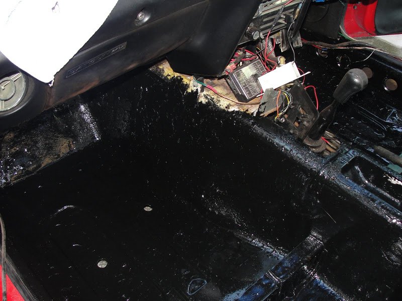

All rust converted
Then Completely POR-15'd
Have also completed sound deadened the car again with a 10mm Foil backed rubber deadening (will post up pics later)

What's the go with the brass dials in picture 2 of post 2??  :o
What have you sprayed the interior with?

brass dials were a "homemade boost controller" done by the previous owner!!
it has been brushed with POR-15 Paint supposed to be the best??
