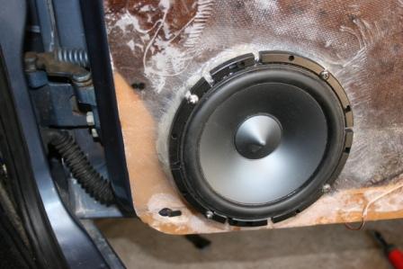

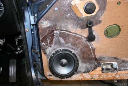

jamo240 Posted October 27, 2012 Author Posted October 27, 2012 Thankyou John....the job only took about an hour, and sorted out a problem that's plagued stereo installations on Z's forever...I glassed up the speaker mount today as well, so I will have some pics of the whole lot installed sans trimming by tomorrow afternoon. Having looked at your project post and the HUGE mods you are doing, I imagine you will be thinking of power windows and those door locks that pull themselves closed!....I sure admire your desire to create a different car altogether. Anyway, you can now route the wires nice and neatly, and you saw it first here on Auszcar!!!! Cheers Jamo Quote

jamo240 Posted October 28, 2012 Author Posted October 28, 2012 Thanks Gareth! Cake or tarts....I'm happy either way! As promised, here is a pic of the whole lot installed. The cable you can see actually connects the tweeter to the mid-range speaker, so that will sneak up between the door panel and the door trim to keep it out the way of the window mechanism. Where you can see the black texta dot on the edge of the trim is where I may put another trim clip in, but with the extra fibreglass stiffening the panel, there is no sign of it misbehaving even when you slam the door, so I reckon it is pretty good to go as-is. Cheers lads Jamo Quote

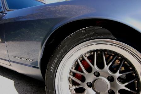

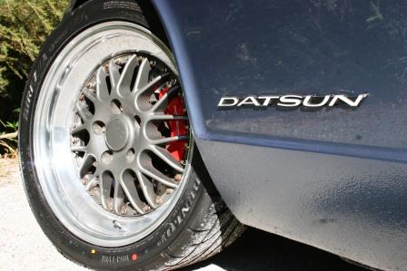

jamo240 Posted March 22, 2013 Author Posted March 22, 2013 Well boys I am now through the dreaded VASS process to make all my mods legal. It wasn't that hard really. A few issues on wheel sizes, but otherwise all i had to do was fit inertia reel seatbelts, which was no big deal....although I did have to pull them apart and re-configure the belts...many thanks to Restraint Technology Australia for that! With that done (especially the brake test which resulted in a few flat spots on the VERY old A032R tyres I had on it, I changed tyres. After a bit of research, I decided I wanted to go with the Dunlop Direzza Z1 Star Spec, which conveniently is not offered here in Australia at Dunlop dealers. Fortunately for us Victorians, Stuckey's have come to the rescue and stock them. I had them fitted today, and all I can say is Holy Snappin Duck Shiv! What a transformation. They are quieter, more grippy when cold...it actually hooks up in second gear now. But most of all, the dartiness is gone from the ride. The tyres work 1000% better on rutted roads which used to make it dart all over the place. They are a much better road tyre (ie not saying the A032R were anything but great as a track tyre, which you would expect from an R spec tyre). Anyway...all smiles now, and just tidying up a few bits and pieces before the Nationals next weekend. Happy days and see you there ladies.... Jamo Quote
KatoKid Posted March 22, 2013 Posted March 22, 2013 Good to hear Jamo. And yes your old tyres were pretty sketchy when cold! Quote
jamo240 Posted March 22, 2013 Author Posted March 22, 2013 Yes there were dodge David! About as grippy as railway wheels!!! Oh, I had a new prop-shaft built too, and that got rid of the high frequency buzz above 70mph...little by little I am getting the bugs out of it! Jamo Quote

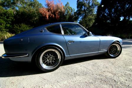

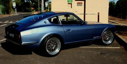

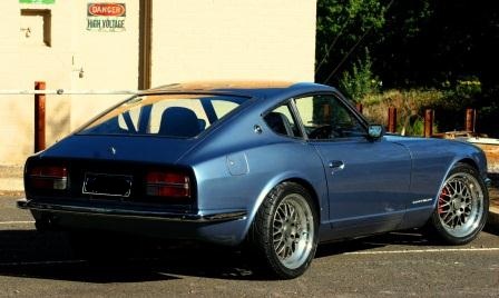

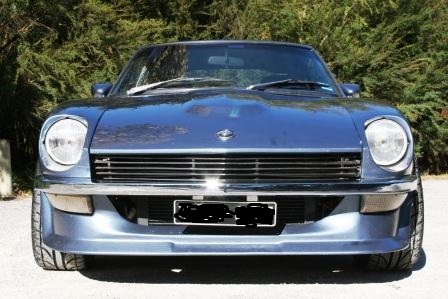

jamo240 Posted March 24, 2013 Author Posted March 24, 2013 OK lads...here are a few pics of the two fitty now that it's about done....for now at least..... Quote
jamo240 Posted March 24, 2013 Author Posted March 24, 2013 Thanks Agno....while they are never done, I am pretty happy with where it is now at. Cheers Jamo Quote

Administrators gav240z Posted October 23, 2013 Administrators Posted October 23, 2013 Looks great, I love the paint colour in particular, really works well on the Z shape. Quote
