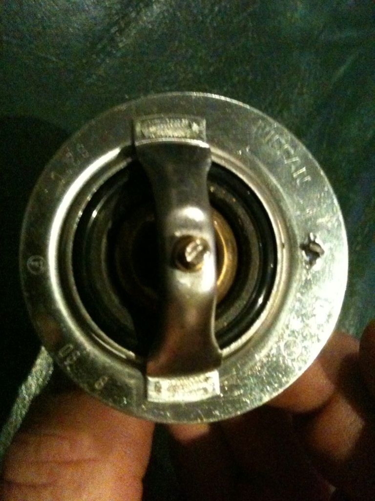

Riceburner Posted April 14, 2011 Author Posted April 14, 2011 Thanks for the explanation Mark, I'm actually going to try the don potter resrictor with a brand new nissan T/stat. They are quite an interesting shape, the Nissan stat is slightly offset and has a rubber seal in the centre to close the stat 100%. Very different to the generic replacements. It was going real hard Peter, even if it was only for 3/4's of a lap. Hehe. Quote
ozconnection Posted April 15, 2011 Posted April 15, 2011 You're welcome Gareth. Why don't you try the restrictor first, without any thermostat. The resistrictor is designed to replace the thermostat in these conditions. Using both at the same time doesn't test either component to see which one is giving you the desired results you're seeking. The little taggy thing next to the main part of the thermostat acts as a tiny bypass. The thermostat cannot close off 100% of the flow with one of these thermostats. I have experimented with one and twisted it off and plugged the hole. I did this because I could feel hot water in the top radiator hose before the thermostat actually opened! Solved that problem. I don't know if your engine has the external bypass line from the thermostat to the intake on the front cover like mine does. I believe there is an internal one too for those situations that require it. They allow water to flow around the block before the thermostat opens, keeping the head of water pressure at a manageable pressure and prevent cavitation that would drastically reduce coolant flow through the engine. They did this for the people who rev their engine hard on a cold engine! Bad luck on track day man......next time hey! Cheers. Quote

Riceburner Posted April 15, 2011 Author Posted April 15, 2011 Mark, it was just bad luck I hope. I don't have the bypass hose on mine but I have always drilled a 3mm hole through the outer ring of the tstat as recommended by Bazz from Datsport and has worked well so far. Like David says, this restrictor comes with instruction saying it must be used with a tstat which is a little confusing. Ha. David, this is the exact part I have, he sounded like a Datsun guru and Mamabears lair had quite a few very nice goodies. Have you fitted it yet, if so how does it go? Quote
