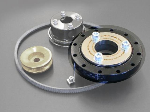

Riceburner Posted April 11, 2011 Author Posted April 11, 2011 Ha, I have a guy in mordialloc who has done all my brake work really cheap but if your offering Simon. Thanks, david + peter that makes me feel a bit better about it. I had a really good look at the track on sunday and it all looked ok, the hole was very clean. Bit off topic but I also saw a Kameari balancer for about $380, The ATI balancer is out of my budget at the moment. I might just see how it goes with the current setup for the time being, and I'll make sure I have welsh plugs in my spares bag...... Quote
luvemfast Posted April 11, 2011 Posted April 11, 2011 That Kameari balancer looks like reasonable value too. Quote
