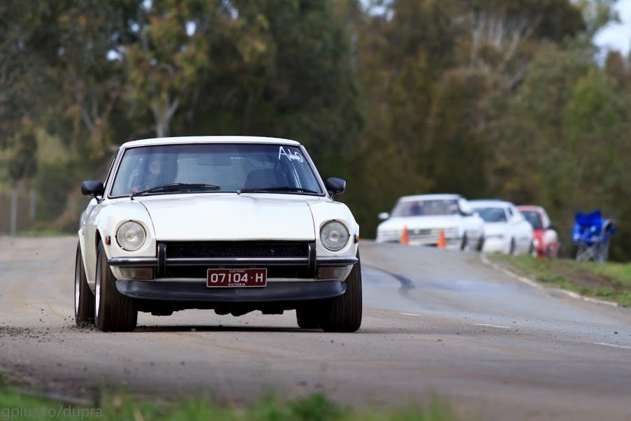

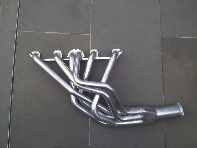

Agno Posted August 22, 2012 Author Posted August 22, 2012 some photos of the car at DECA stolen from the outer reaches of the internets: In the end I finished in 35th place. I'm pretty disappointed with that because my brother (who is my twin and is in a very closely matched car performance wise... coincidence? ) finished 15th. Damn penalties! I also got my headers back from being ceramic coated, so they will go on this week Quote
MaygZ Posted August 22, 2012 Posted August 22, 2012 Now that's a nice looking Zed! Love the amount of rubber you've got under those guards. I reckon the new headers should get you well up the order of merit. Quote

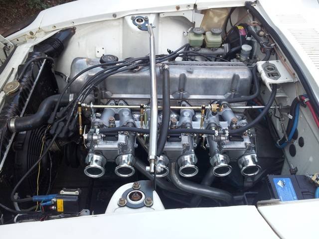

Agno Posted September 1, 2012 Author Posted September 1, 2012 So I attempted to get the triples on and running today. Started off well when I installed the new fuel pump. For the first time in a long time the exhaust is louder than the clicking of the fuel pump! But then came installing the carbs... They are all on and hooked up, linkages are perfect, everything is tight, but the car refuses to turn over and when it does it misfires . When I turn it off fuel dribbles out of the trumpets as well. They are DHLA40G with stock Alfa GTV2000 jetting, which is what was recommended to me by Gordon Dobie, it is also the jetting Ash/Rev's orange 260Z/Gareth's old triples set up was. I think it's the timing being way out, but I really don't have any idea where to start, does anyone have any suggestions? It's an L28, F54 block with N42 head, 280ZX dizzy and ignition system is all near new (plugs, leads, coil etc). Thanks in advance Quote
Riceburner Posted September 1, 2012 Posted September 1, 2012 My Peirburg is run with a relay to give constant power supply and gives 2.7 at the carbs, I also run a return line with a 2mm restrictor in the line. This is the same setup I used when I ran triples. IIRC the peirburg max supply is 2.9. Was the timing ok prior to the change? I'm not much help with these as it's been too long since I had mine. It'll be a little bit of fiddling to begin with but once you get them working well you'll love it. Oh the sound! Quote
Agno Posted September 2, 2012 Author Posted September 2, 2012 Got the fudgeer working this afternoon. I added a bit more advance on the distributor, reset the float levels and then used a combination of start ya bastard, shouting, threats and the choke wheels held on to get it to turn over the first time. After that it idled really smooth, pretty happy with how it goes straight out of the box! Now to make myself up a bracket for the throttle return spring and get it tuned. The throttle is a bit sticky so I need a bigger/more return springs. Quote
