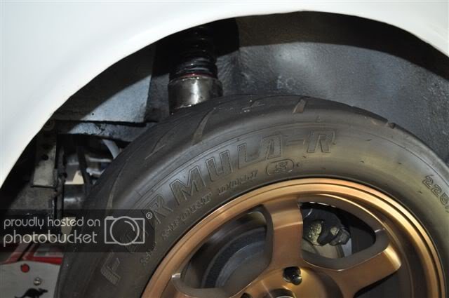

RB30X Posted July 7, 2011 Author Posted July 7, 2011 Bit hard to photograph the new rims with the sun the way it was or at night. Quote
Riceburner Posted July 8, 2011 Posted July 8, 2011 Looking fantastic! I think you've nailed the wheel color, it offsets the white very well Quote

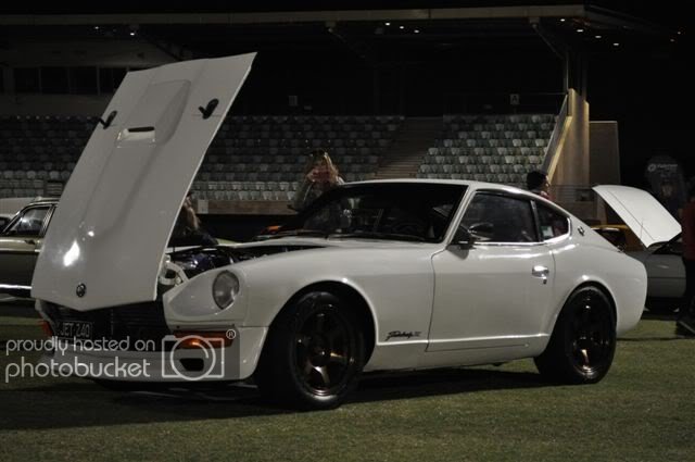

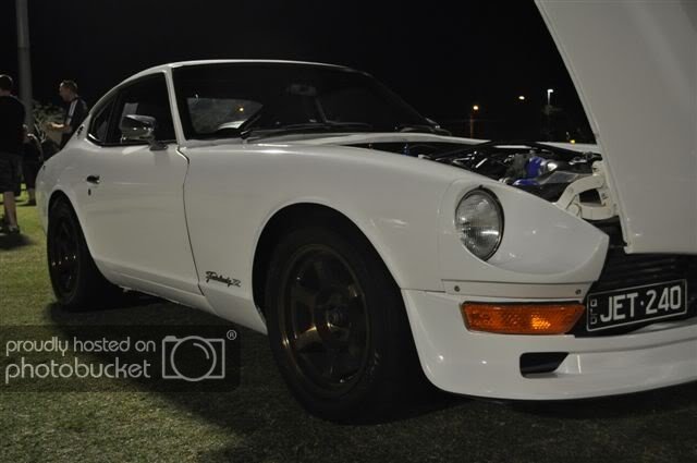

garvice Posted July 8, 2011 Posted July 8, 2011 Were they going to turn you away until you showed them your engine bay? (Looks like there are no other japanese cars there). Quote
RB30X Posted July 8, 2011 Author Posted July 8, 2011 Were they going to turn you away until you showed them your engine bay? (Looks like there are no other japanese cars there). Thanks guys. Yeah I did feel out numbered. Hopefully the will be a lot more Jap cars at the actual track tomorrow. Quote
haul Posted July 8, 2011 Posted July 8, 2011 Went and had a look last night Tim , the dark rims against the white looks good, I thought the Z stood out against the rest quite well, if I get mine squared away we may have two there next year. Cheers Tony Quote
RB30X Posted July 10, 2011 Author Posted July 10, 2011 Keep your eyes peeled on the v8 coverage this arv. All the display cars get to tag along behind the driver parade. I'll be the one in white zed, the only zed, almost the only one that isn't a Ford or a Holden. Quote

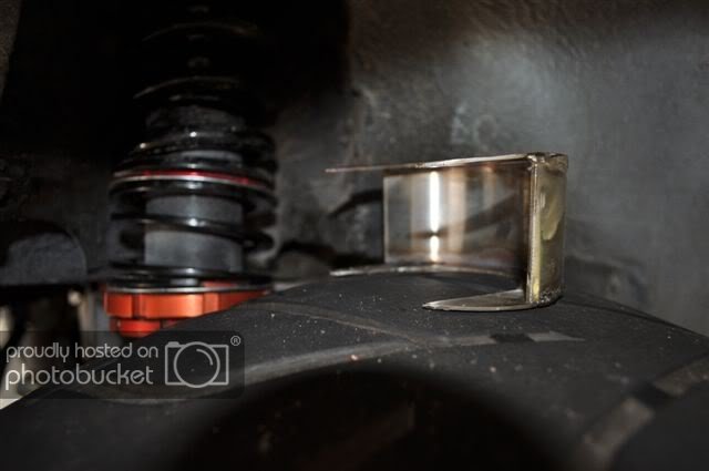

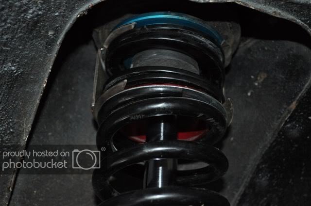

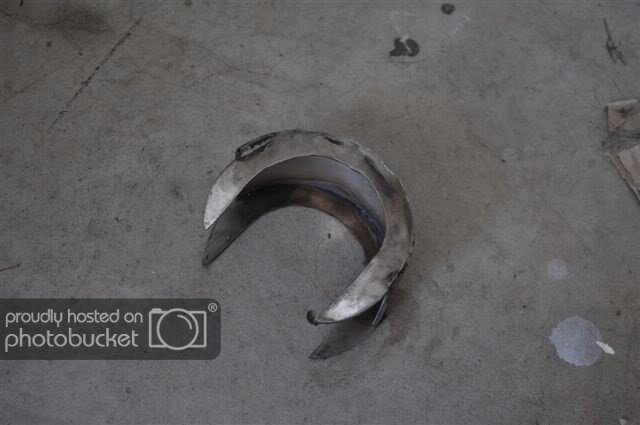

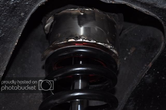

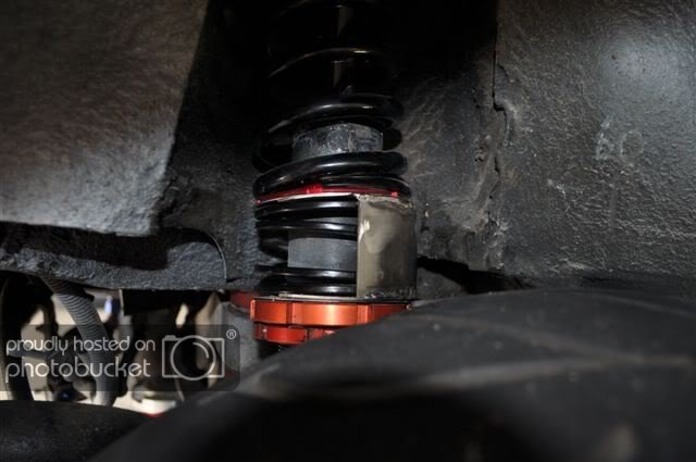

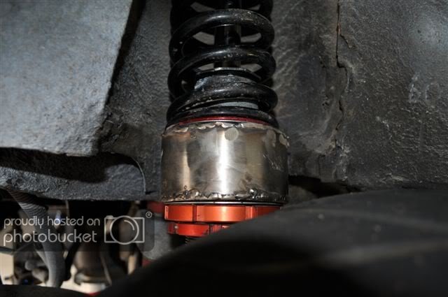

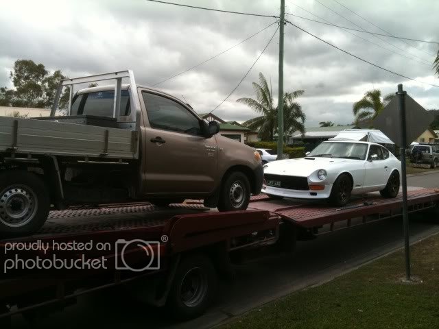

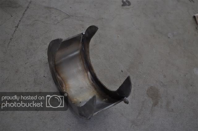

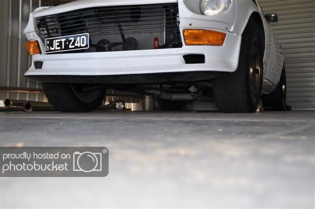

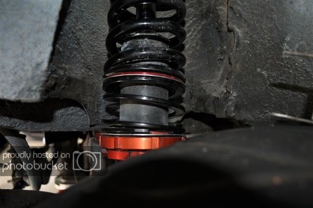

RB30X Posted August 21, 2011 Author Posted August 21, 2011 Another little project I've had to attack lately is the fact my Zed will be getting relocated on a car transporter. I asked what the required clearance was for such a transporter and the answer was 6 inches. No worries, only have to find another 4 inches and I'll be sweet. Apart from swapping in my old springs, the only other option was to make a tool that would encapsulate the helper spring and retain its 'unloaded' spring height, when the weight of the car is on it. This should gain me an extra 2 inches. Excuse the poor welding, the TIG was out of action when I made these. Transporter, here I come. Quote
C.A.R. Posted August 21, 2011 Posted August 21, 2011 Good luck with the move Tim Be very wary of the car transporters - they have been known to take cars for little drives, & returning them damaged... I'd give Peter a call about getting the heads & manifod ported too... Quote
RB30X Posted August 26, 2011 Author Posted August 26, 2011 Thanks Locky. Both he an I took lots of photos including the odometer. It's all insured but hopefully I won't have to go there. :'( Quote

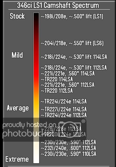

tir33d Posted October 2, 2011 Posted October 2, 2011 Careful now Tim, if you go for a big cam and you want to shave your heads you will run into PTV clearance problems ( making it necessary to fly cut your pistons). My VE ute runs a 220/220 cam, it is a nice mild cam which put 320kw to the rollers on a dyno. This cam enables you to use 6th gear down to 80-85km/h, but still pulls strongly up to 6300 and carries to 7000rpm. (Also remember VE has great heads and higher compression and 6.0L ) My old cam in the 280 was around to 228/232, was a good cam but never road driven. My new cam I believe is a 230/230 with about 600 lift (old cam had nearer tto 650 lift and we thought that was being a bit hard on the valvetrain gear.) With this new cam my mech has had it in a drift car bouncing on 7000 continously and still makes easy 300kw at the wheels. I know you love it and seem to have the funds, but unless you are going to do a mini rebuild maybe you should lower the cam specs. A torquey cam is still very driveable, and much more usable. A big cam mean you have to rev it to get it. Hills mean gear changes. If you go to big at the track you will find your changing gears more often to keep in the peak zone of the cam. I much prefer a cam that will still work down to 3000rpm say, as opposed to a cam that will only scream from 4500. Are those cam specs a TK Cam? (Turbo killer). Quote

peter mc Posted October 3, 2011 Posted October 3, 2011 the cam for street in these is tricky i like 224 224 on 112 for street it nice to tune and get the job done Quote

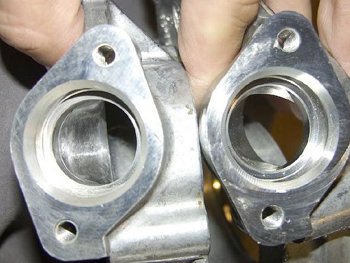

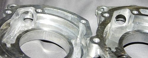

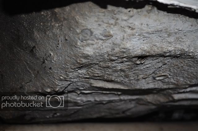

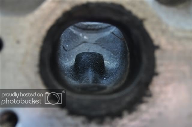

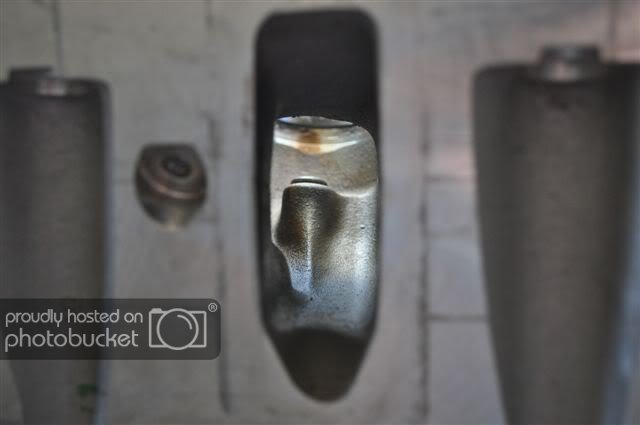

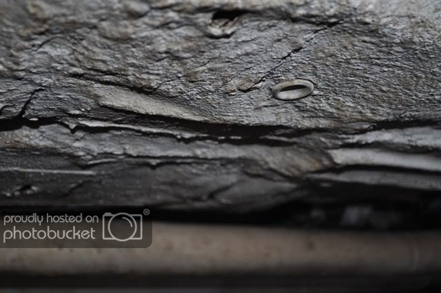

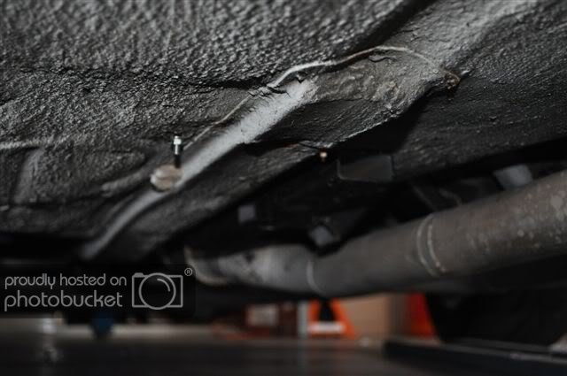

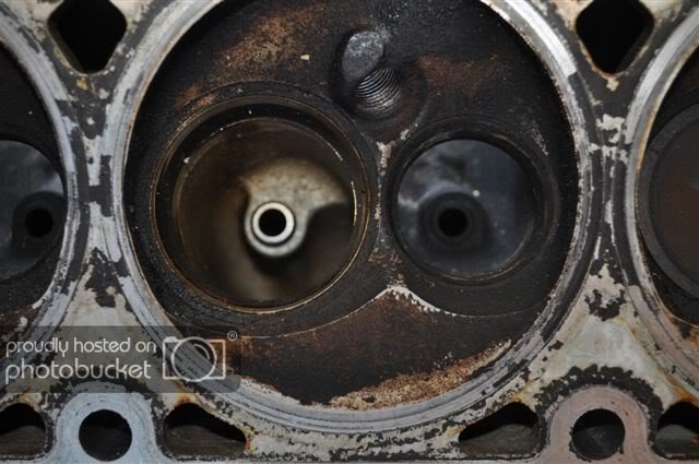

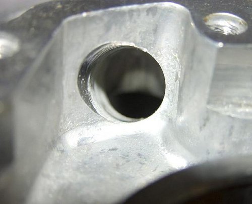

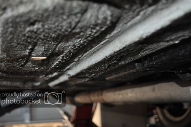

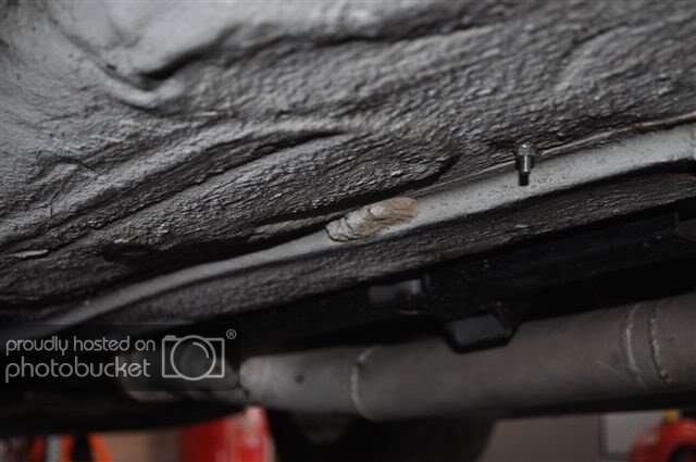

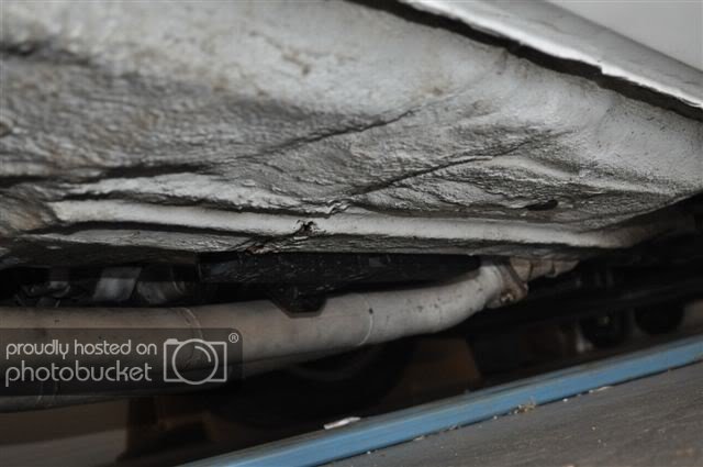

RB30X Posted October 4, 2011 Author Posted October 4, 2011 Hey Peter, cams that size are for mediumish performance street cars. With this being a weekend car, I might as well go a little larger. What type of porting tips do you use for alloy heads? NF carbid. I've got a heap of the steel cutting tips of all different shapes but they fill up with the alloy really quickly and block em up. Here is some pics of the ports. Here are some pics of under the car. As you can see there are some funky lines going on. Quote
KatoKid Posted October 4, 2011 Posted October 4, 2011 Looks like youve got some type of spray on body deadner there??? Have you scraped some off to see what it looks like underneath? Quote
peter mc Posted October 4, 2011 Posted October 4, 2011 just a hint ..use crc or wd40 in the port and on the cutting tips stops them clogging works a treat,as for the cam i have not seen big defence in the cam when u go to big they drop lots down low ,,, if you get the comp up and run a solid roller its a diffrent animal. but if wont a good increase with not lots of trouble the 224 cam with 20Th of the heads and port job they make some good power ...the ports are $1000 at Higgins cnc and work OK ,,,, if you do them be careful as the intake port is real thin in the walls ,the ex port needs lot of work they also like 1.8 rockers as this opens them much faster Quote
