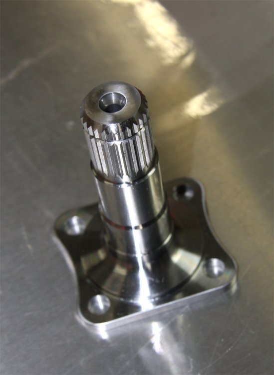

sexual_sushi Posted March 11, 2010 Author Posted March 11, 2010 Just got some Subaru WRX STi R180 Side Axle adapters from Johnc over on hybridz I got 2 sets sent over, 1 for me and 1 for Greg's Bre Car Quote

luvemfast Posted March 11, 2010 Posted March 11, 2010 Same deal here, I gave him a quick call with my details and less than 24hrs later they were posted. +1 for me too. Got my Tokico shocks off him How much were those adaptors? Look's awsome. Hollinger have a machine that can make something like that in 1 operation. Interesting to know what they're worth. Quote
sexual_sushi Posted March 11, 2010 Author Posted March 11, 2010 With shipping and the conversion ended up being $605 AUD a set. I was expecting $700+ so I was happy Quote

. Posted March 18, 2010 Posted March 18, 2010 The standard subi stub axles are still the weakest point. They snap before any breakage of CVs unless modified stub axles are used. It will be interesting to see how our imported stub axles handle the Zed. I'm not too worried about mine as I do not have high HP. But then again it is torque that breaks them. Quote

. Posted March 21, 2010 Posted March 21, 2010 Well guys, I have mine setup and ready to go in the car. The stub axles fit well and look great. I did have to drill out the bolt holes ever so slightly to be 10.5 mm This now matches the original bolts. Had a heck of a time getting the nut of the front flange. But I guess that is normal. Once the shafts are in I can not move one side without the other side moving??? I thought it would move a bit if I used all my force but it doesn't budge. Is that normal? On my Detroit locker one side moves freely until more force is applied then it locks. It will be interesting to feel the difference in the car. Although it will be hard to look past the difference in ratio (4.6 to 3.9) Quote
Moderators Zedman240® Posted March 21, 2010 Moderators Posted March 21, 2010 Once the shafts are in I can not move one side without the other side moving??? I thought it would move a bit if I used all my force but it doesn't budge. Is that normal? That's the break away pressure that is set in the LSD with shims. Some are set to around 50lb of pressure whereas others that are almost locked I think are near 200lb. The less you have the more slip and the more heat builds. Quote
