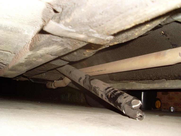

leonZ Posted September 22, 2009 Posted September 22, 2009 i reversed out of the driveway put it into drive and there was a real messed up sound as soon as i pressed on the gas, the car rolls for a dew meters while I'm thinking what the hell, then another sound my drive shaft falling out at the gearbox, pushed it home now I'm thinking the gearbox was serviced and driveline tested less then a month ago also only passed its RW about 2 months ago from kmart tire and auto. should the mechanics have picked up on this? Quote
Administrators gav240z Posted September 22, 2009 Administrators Posted September 22, 2009 Broken Yoke or Uni Joint? Looks like the Universal joint broke. This I must say is very unusual, I've never heard of this happening before. I'd be concerned if the mechanics didn't notice anything strange, especially if you have the driveline tested and a roadworthy done not long ago. Quote
aegean Posted September 22, 2009 Posted September 22, 2009 Unless you were still rolling backwards when you put it into drive and the strain just snapped it. Would still agree with Gav that some weakness should have been evident. Quote
FLEXZED Posted September 22, 2009 Posted September 22, 2009 i was thinking the same thing aegan, rolling back and then rev and dump it into drive Quote
Mr240z Posted September 23, 2009 Posted September 23, 2009 should the mechanics have picked up on this? Anything can happen anytime.....Looks good one day and the next bad. Zed's are 30odd years old with no warranty, So anything can happen anytime. That's so we can flog them, break them and send all weekend fixing them Quote
lightmaster240z Posted September 23, 2009 Posted September 23, 2009 Man my is still under its 40+ warranty form the guy I got it from at the pink pig. He wasn't jocking at the time was he . :. On a more serious note that what it all about. If it breaks you can fix it. Not some stoty nose kid with a laptop that pulgs in and tell him what wrong. That why i lov my "Z" and I sill have half of that warranty to go. regrads Bruce Quote
Moderators Zedman240® Posted September 23, 2009 Moderators Posted September 23, 2009 Not sure where the pics went that you took from the transmission end, but I think the uni bearings failed. If you look at the rusty part of the uni, seems the bearings ran dry, crumbled and fell out, then the cap fell apart and the uni was able to fall out. Lucky you weren't on the freeway when it happened or else you wouldv'e been AusZcars' pole vault champion! Quote
aegean Posted September 24, 2009 Posted September 24, 2009 Lucky you weren't on the freeway when it happened or else you wouldv'e been AusZcars' pole vault champion! They tried that on Myth Busters, but it didn't work ! Quote
Zeddophile Posted September 24, 2009 Posted September 24, 2009 They tried that on Myth Busters, but it didn't work ! Have to say I'm not a fan of Myth Busters methods, they tend to 'bust' some where in reality it CAN happen. If you do a bit of searching on youtube I'm sure there would be at least one video of a drag car launching itself from a failed tailshaft. Quote
leonZ Posted September 25, 2009 Author Posted September 25, 2009 all i know is changing a uni joint on an old zed sucks the bat hard, especially when you only use a hammer, smaller hammer, stupid F clamp from woodworking and a screwdriver with the car on home made ramps. i had no idea but the old uni must have been stealing some power from the wheels because the the car now A feels like its riding on air now and B dose higher speeds at lower revs and C the power feels alot more fluent and constant now also climbs revs faster, im going under the car with a greese gun tomorro see if theres any other losses in power from driveline friction. everyday i learn something new that reminds me just how little i know Quote
