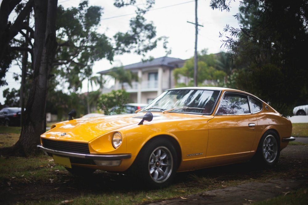

acf321 Posted February 16, 2014 Author Posted February 16, 2014 Wow, thanks George really appreciate those, they're by far the best I have. John (Sirpent) should be happy with my little fix ... Grabbed those stabiliser rods with a set of multi grips and removed them thereby returning the bonnet to very near OEM height. Reason for the photos is that George and I met up at PeterAllen's place to have a purve at the GTO. That will be nice in about three weeks when he has paint on! Cheers Adam. Quote

WA240Z Posted February 17, 2014 Posted February 17, 2014 Two fantastic photos. The Hornet looks outstanding. Quote

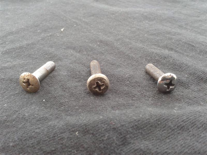

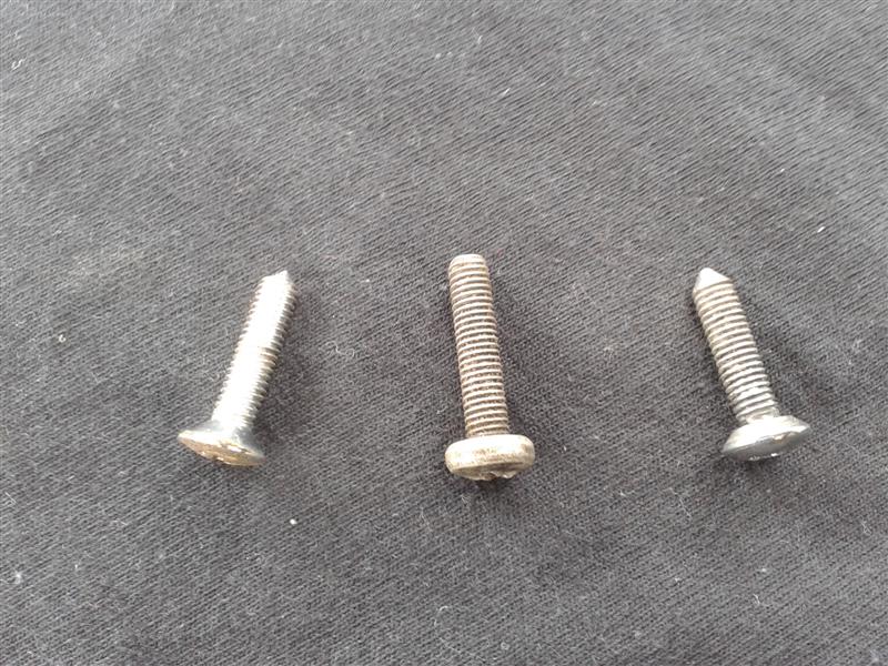

Scoota G Posted March 7, 2014 Posted March 7, 2014 Bit of an issue finding the right type of bolt for the coat hanger for this young gentleman. I ended up machining a bolt down and polishing the top for a chrome finish. Left is the original one and the center one is the base i started with, the finished one on the right. A drop of your clear nail polish (i'm not saying you have any) after you fit it will keep the chrome look. Will that work? Quote
