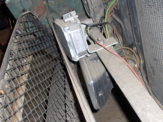

zedevan Posted November 6, 2008 Posted November 6, 2008 the previous owner of my car had a beam made up that goes between the bumper mounts under the grill, using the same bolts, and mounted some hella 150watt driving lights there. I've also retrofitted e46 xenon projectors (only low beam) into some 7" housings (pictures in a thread here somewhere), which was a huge improvement over the sealed beams - and the proper way to do HID's as the lense has the correct focal length for them, and you dont blind oncoming traffic as you do by putting hid's into reflector housings which aren't made for them. Quote

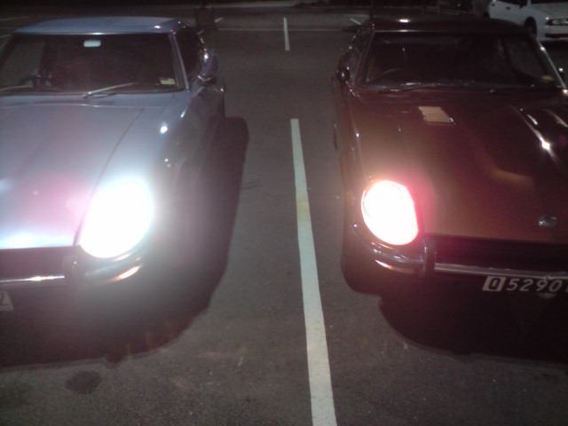

zedevan Posted January 11, 2009 Posted January 11, 2009 zzzzzzzzzed my car has the same lights but they are mounted on a beam running between, and mounted to where the bumper is screwed onto the car's body. i dont imagine the beam would be very light, but could easily be redesigned or have some of the weight taken out which is something i should do, along with mounting the ballasts for the HID's somewhere else. they aren't aimed correctly in these pics but you get the idea. the 35watt hid's are brighter than the driving lights http://www.viczcar.com/forum/index.php?action=dlattach;topic=399.0;attach=288 shows the difference between the orginal sealed beams on the right, and hid's in a decent projector on the left Quote

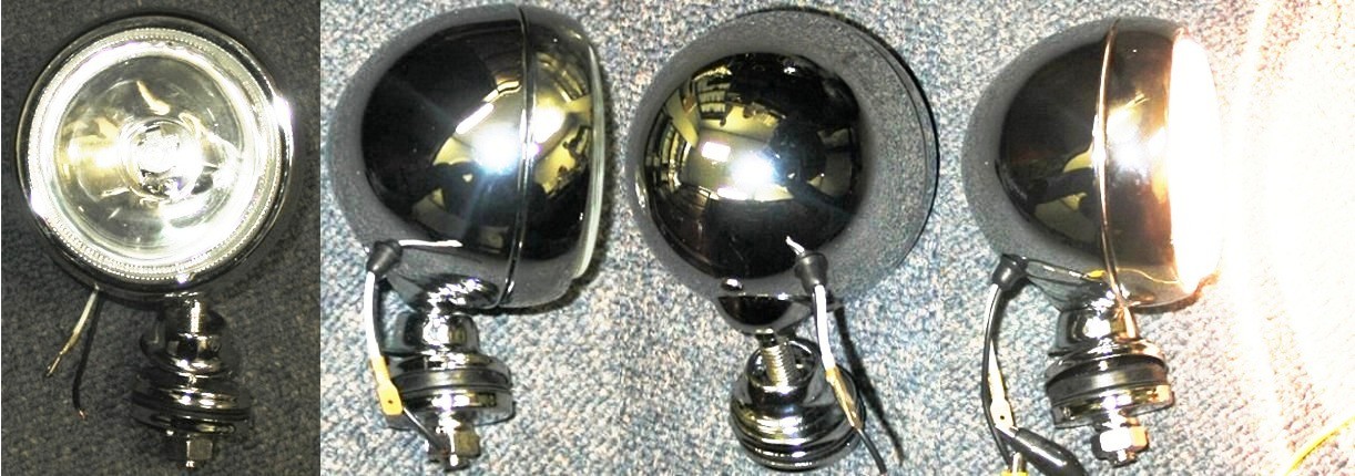

RBZ 260 Posted January 20, 2009 Posted January 20, 2009 yeah i ended up going for the smaller Mini style fog lights. 98mm diameter. should be on my door step anyday. they are stainless steel not metal and chrome that can rust and peal after a while. can't wait to fit them . it will hide my intercooler piping and silicone hose Quote

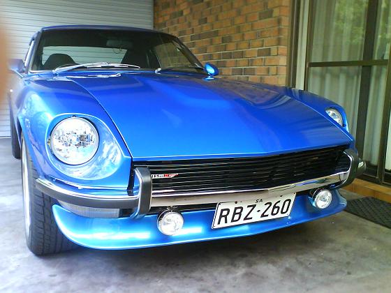

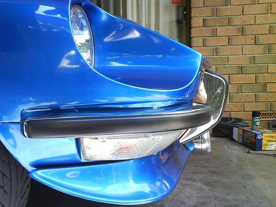

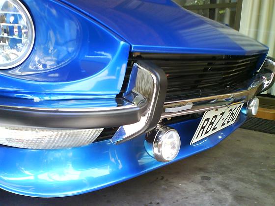

RBZ 260 Posted February 1, 2009 Posted February 1, 2009 yeah i agree light force are good but it will kinda cover 40% of the grill. not sure if i like the rally look. was doing some work today on the Z fixing my leaky air condtioner piping (didnt tighten a join on the compressor bloody retard) after retightening the pipe got the A/C regassed now i got AIR cold AIR for 40C days going home from work. so while i was allready dirty sweaty on 40C temp i thought i mount the driving/fog light on the Z as well. so after making the brackets to have it positioned where i wanted here what it looks like. what you guys think? Quote
zzzzed Posted February 1, 2009 Posted February 1, 2009 looks good these should brighten things up a bit Quote
