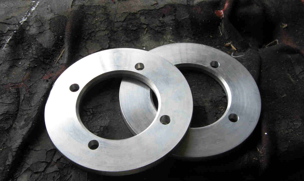

Just got a reply about availability from Silver Mine Motors: ok i checked with my supplier and they don't have any in stock. recently it has been very hard to get these parts since they come off a car that if getting to be more rare. i can get someone to go to the local gunk yard and get six of them for me then i could send them to be professionally rebuilt but that would raise the price of each master cylinder by $25. that's the best i could do right now. i'm really sorry for the inconvenience. Still seems reasonable to me . Any Thoughts ? There stage three front kit is Non Ventilated. Stage 4 might be a closer match to Lurch's set. Looks like they use 300zx 4 lug rotors which used to sell in the us for about $100.00 US a pair on Ebay ( Drilled and Slotted ) .All they need is spacers like these.(No Machining) Might ask for just spacers and rotors? and get them in the MC Order? Different size ones if you have 240z hubs. Sach ,PM me as i know a wrecker in NSW who has Calipers i think. Sell them on Ebay and gets $120 ? a pair normally. -

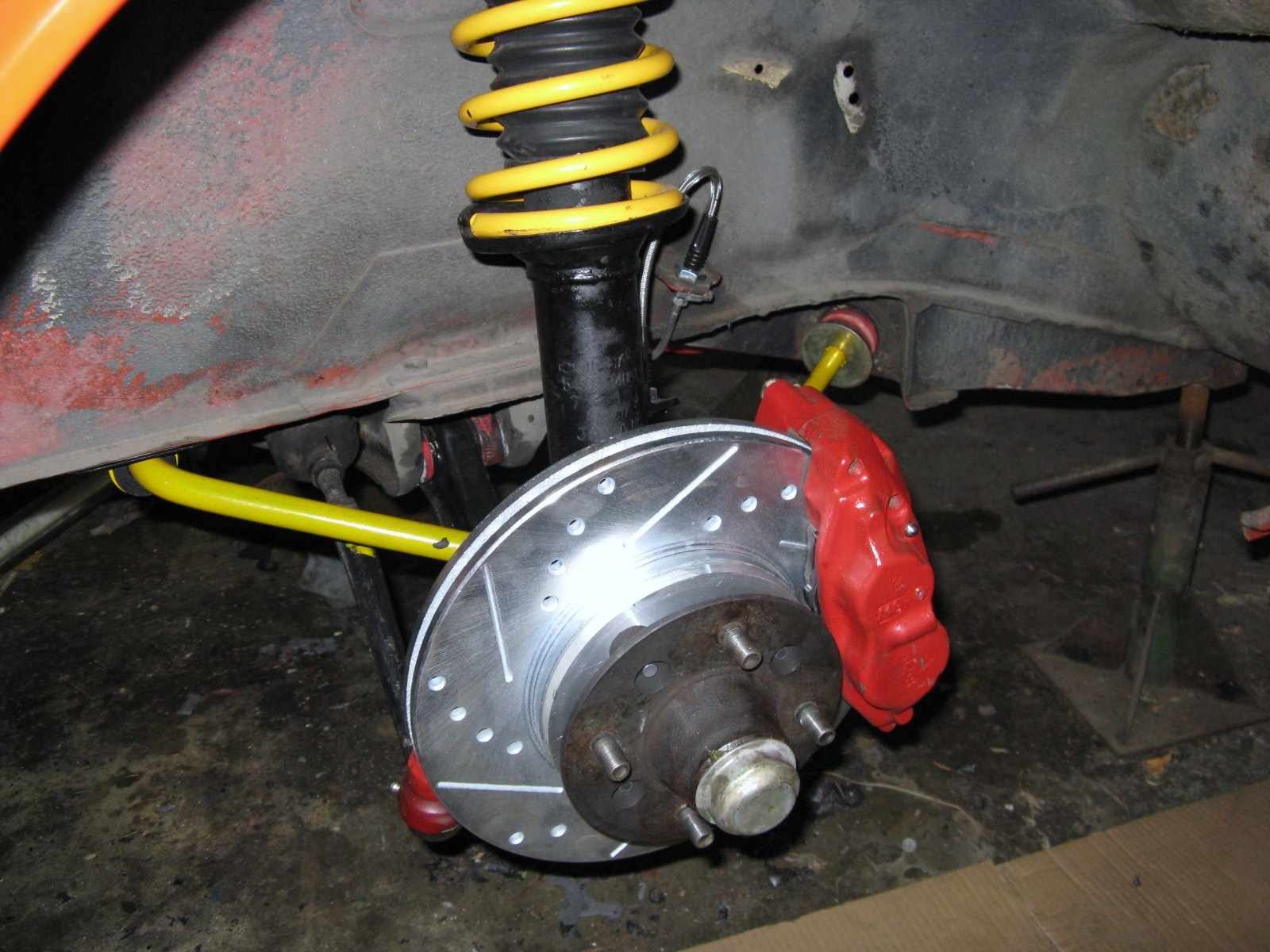

Hi Guys, I'm a new member s be nice. I have been following this thread with interest as i have just completed the upgrading of my brakes with the ventilated Hilux calipers and Silvia s13 rear capilers and 300zx disks front and rear. I have found like many before that the brakes travel is to me way to long. Just rang around a few brake and parts stores and they tell me that both 280zx and patrol 1" MC's are NLA. javascript:void(0); It looks from the part number that the Patrol MC comes from a 60 Series 77-79 with MVAC. The 4WD wreckers seem to differentiate between the model with the Break Booster and without , not MVAC. Does anyone have any idea which One. The other option is of course a 280zx MC second hand but there seem to be two different types. Series 1 and Series 2. Can source either type for $50.00. From the pictures i can find it seems that the series one MC has separate reservoirs. Am i right and does anyone have any suggestion as to which 280zx would be more appropriate for my setup. For those that have had the 280zx taken out to 1" was that done by the brake shop. Did you ask them to put in a Patrol Kit. Ant advice would be welcome. Thanks. John
