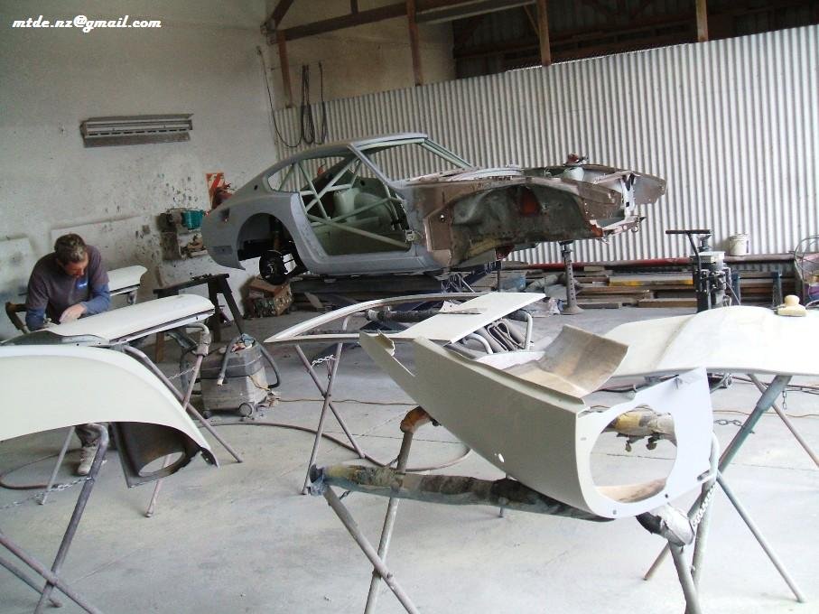

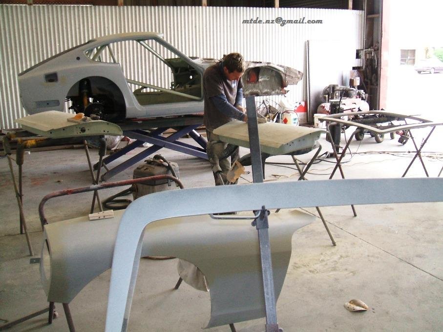

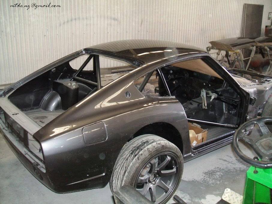

Baz called me and asked for more paint.
A good opportunity to check out the progress.
Upon arriving, my car was the only one there, they said I was an angel with my timing.
- perhaps a large hairy smelly one.

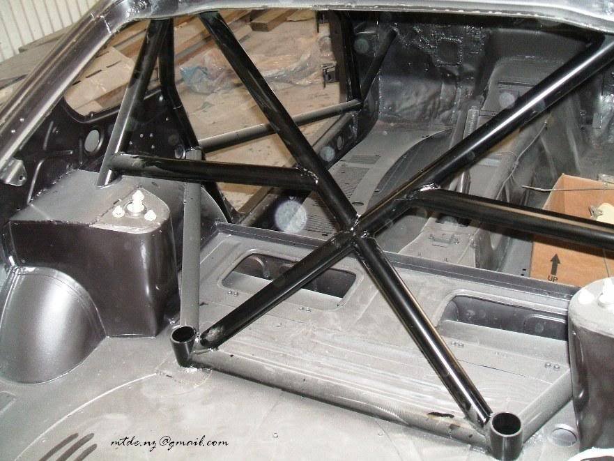

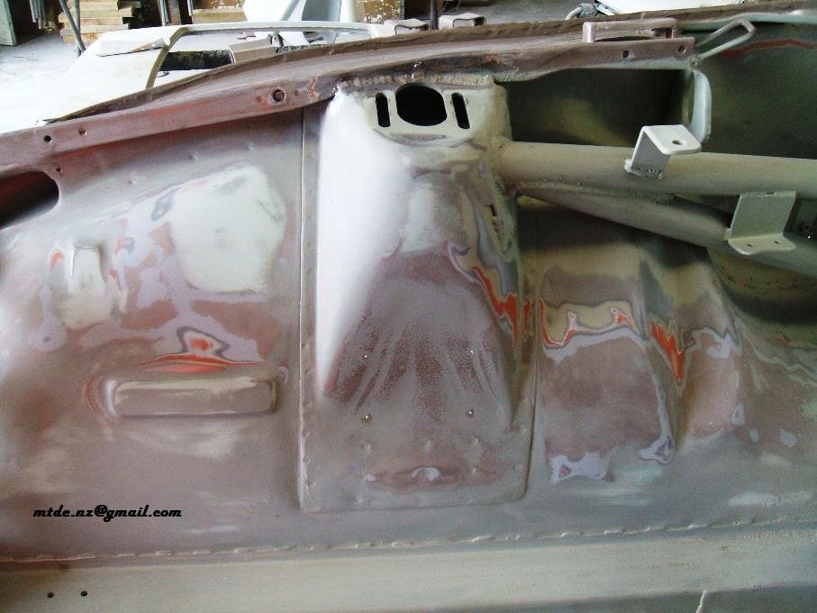

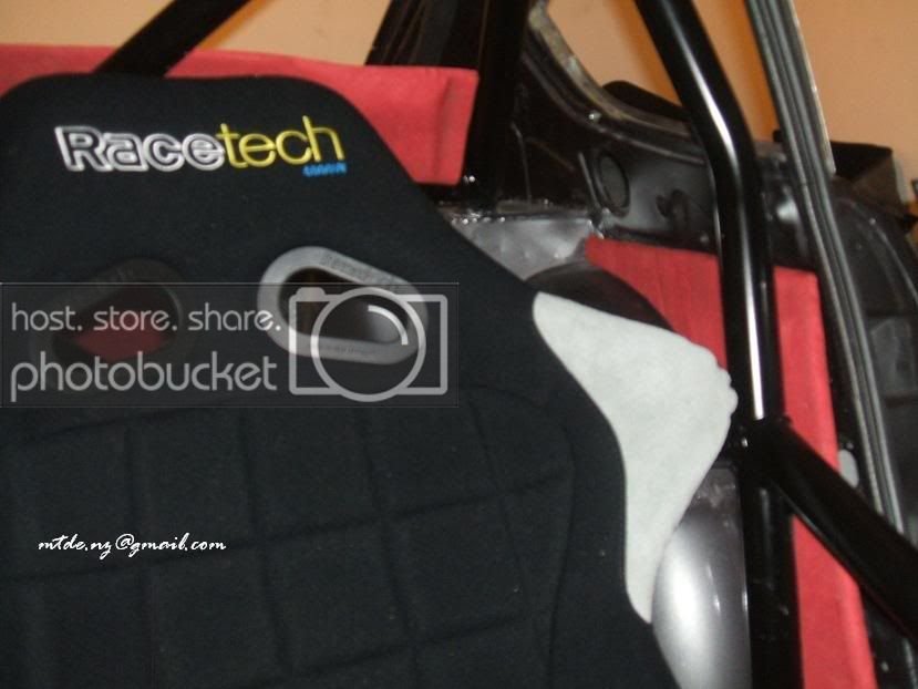

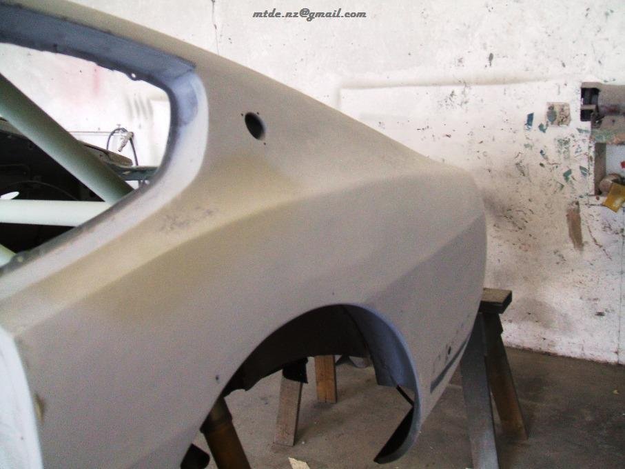

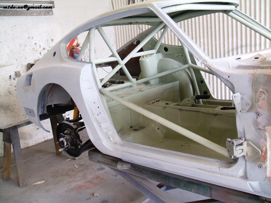

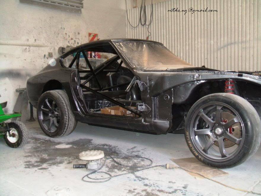

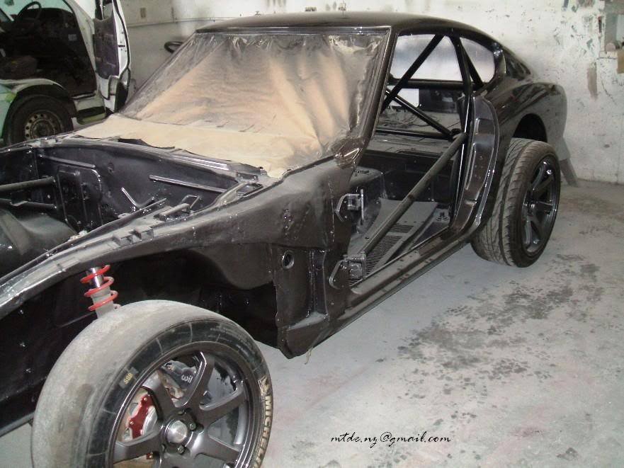

We are up to 1litre of caprithane for the roll cage,
4Litres of base colour, since I will paint all the underside, rear end, cabin etc.

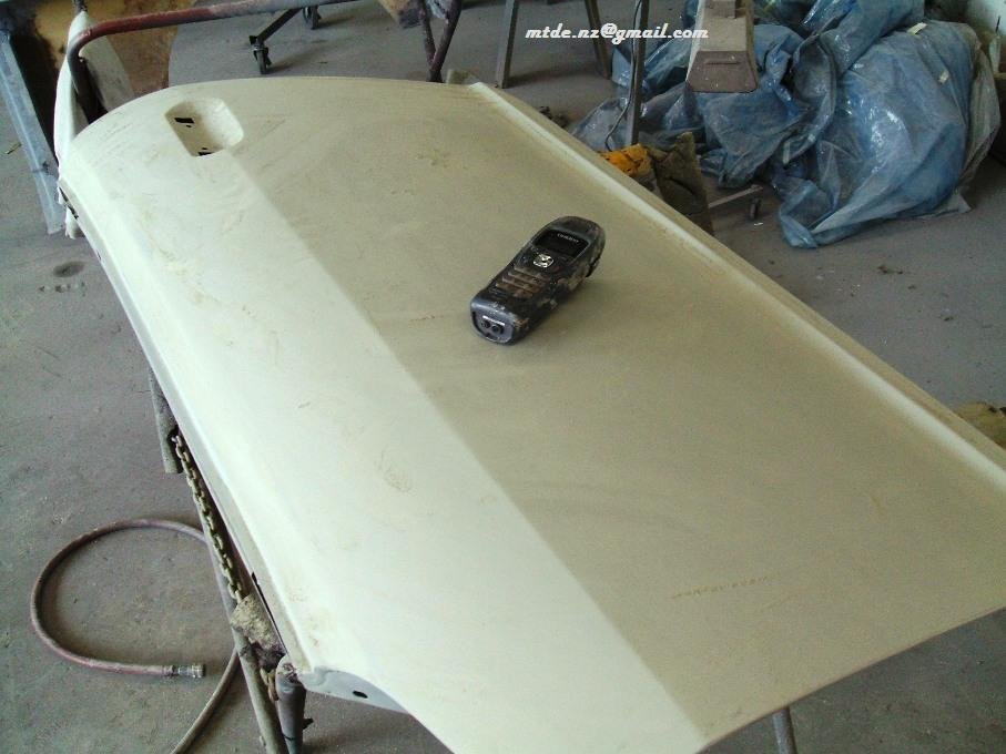

Otherwise they have blocked back some of the panels and body a few times, so its starting to get a smooth skin.
Baz and Clint reckon they are on time to get it out in another 2 weeks.

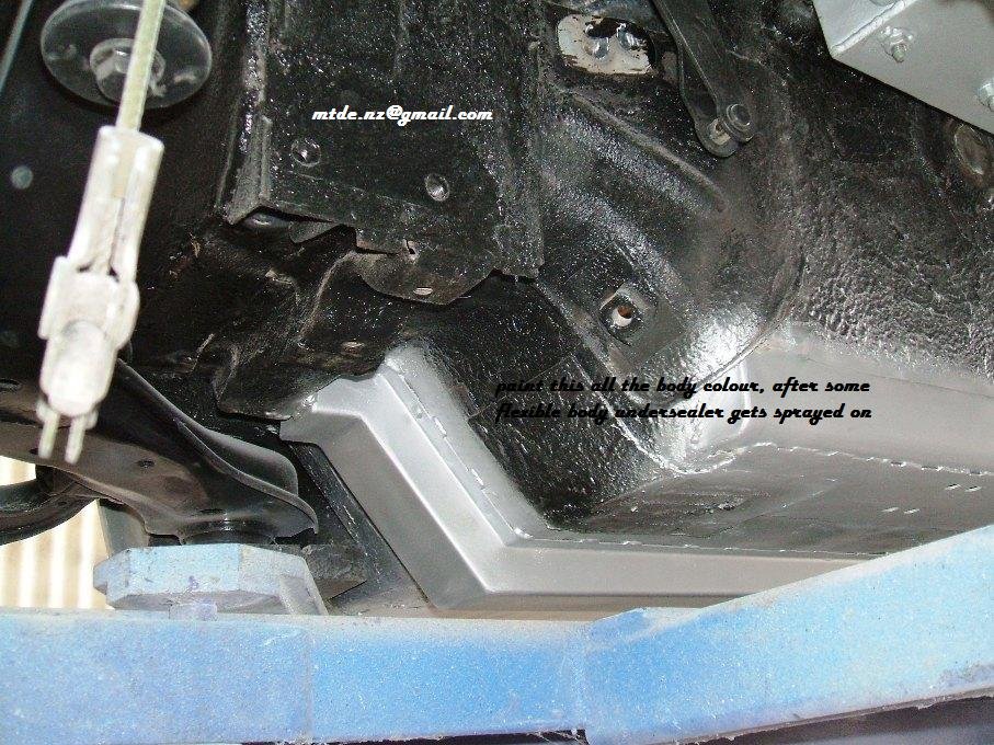

The rear subframe needs to come out to spray the rear end of the car, covering over the tar based underseal.
They will apply some more modern based underseal that is sprayed on, before the colour goes on. This will help minimise stone chip damage underneath.
The wheels, those dodgy black n red stripe jobs, are to get their rubber removed, sanded up, and painted a single colour.
Then we can vote 'the money or the bags', or perhaps the lack of either.

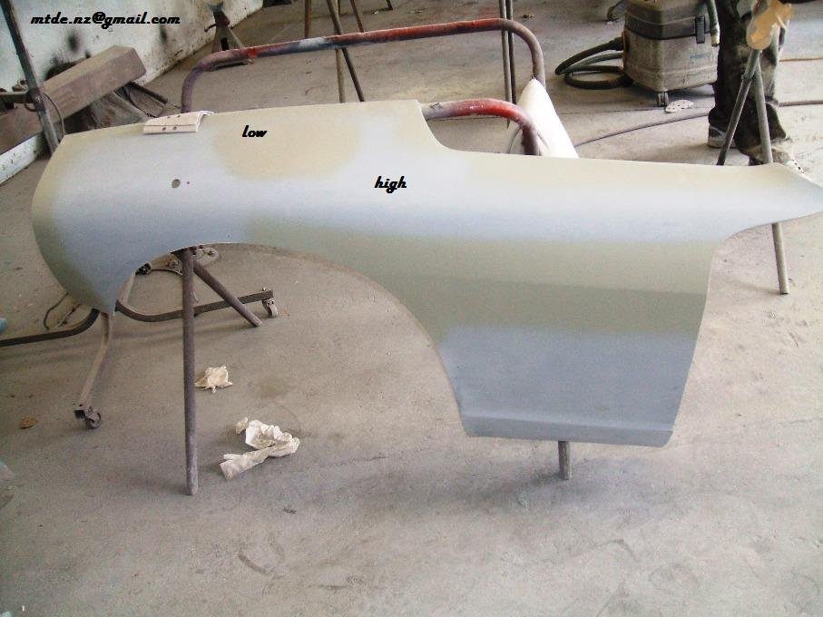

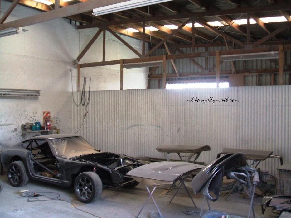

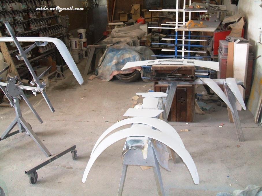

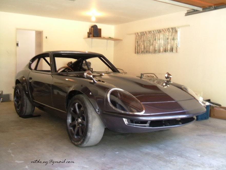

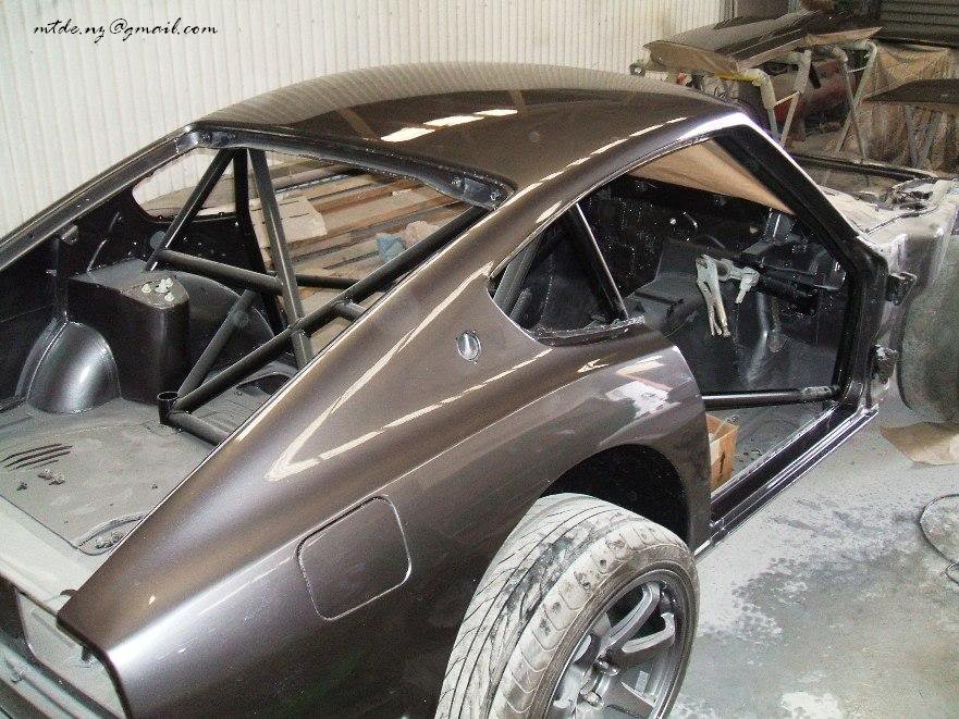

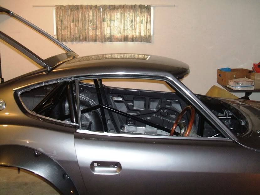

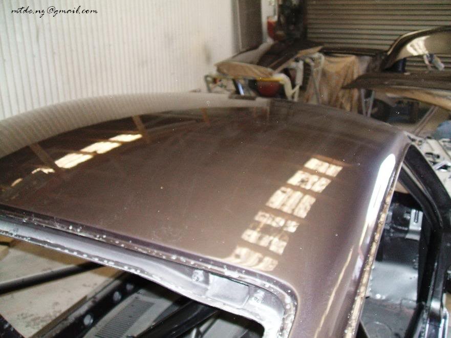

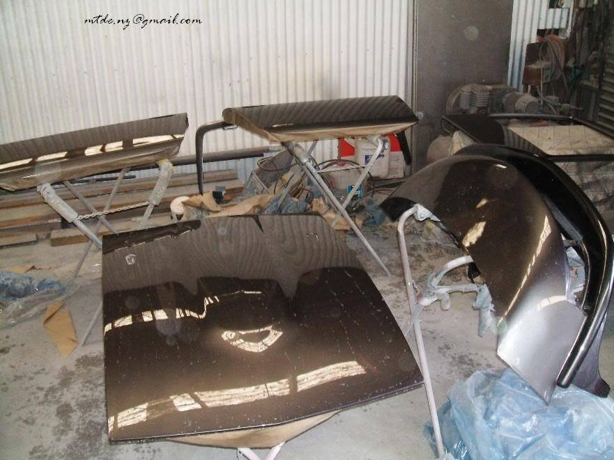

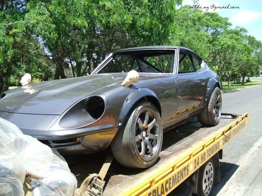

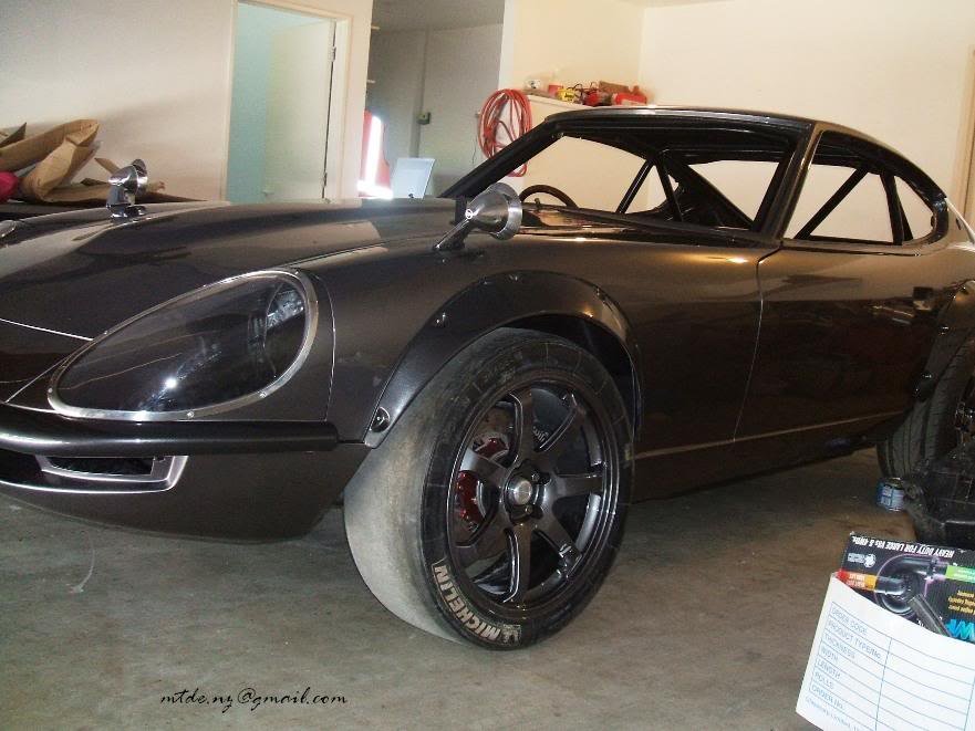

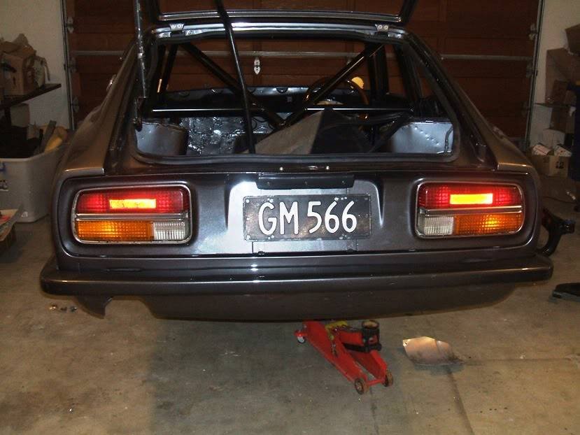

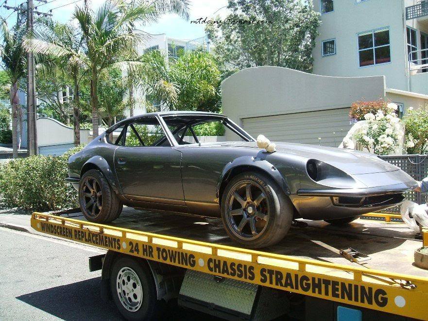

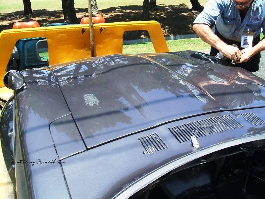

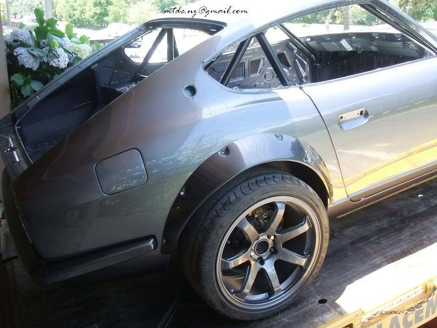

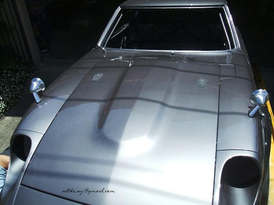

OK.
Remainder of pics from Bazs shop where the car was painted.
The shite camera makes it look brown.
Its a really straight light gun mettalic grey with darker gun grey for the flimsy bits.
OK no.2

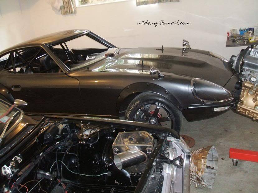

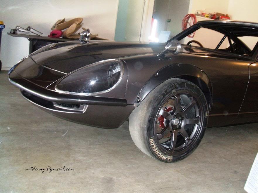

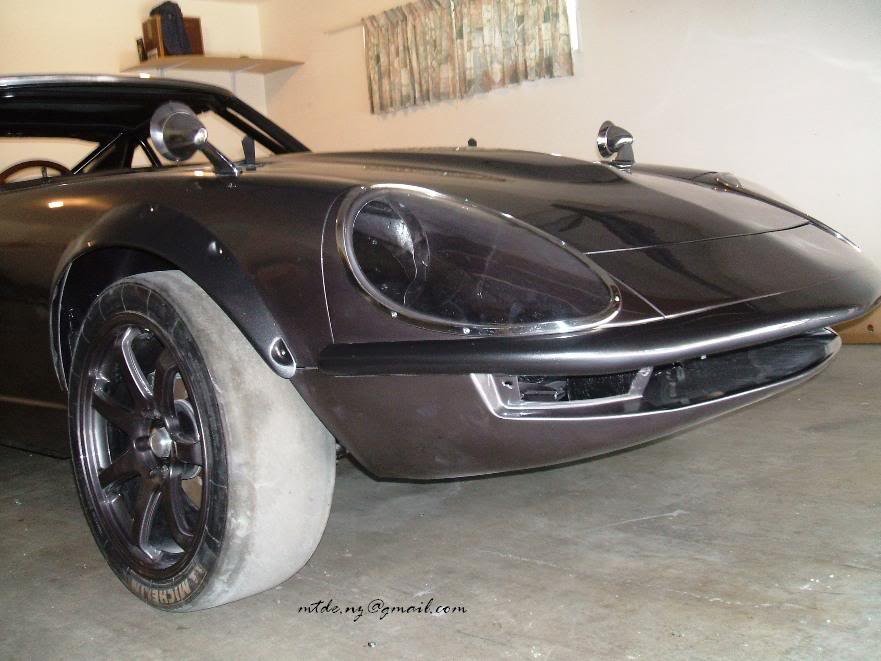

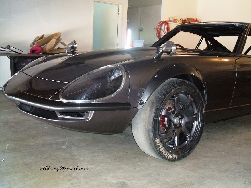

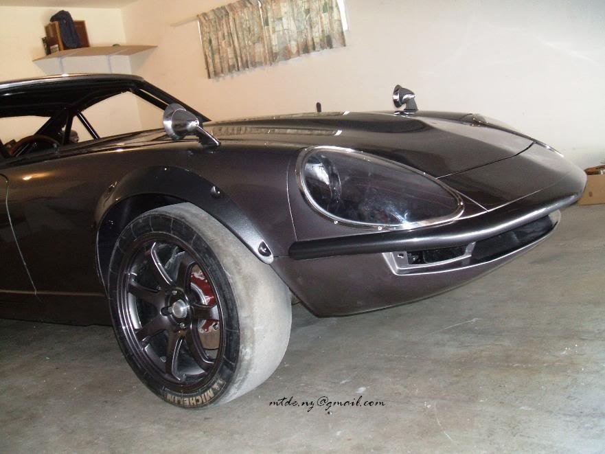

the colour seems to make the chrome work standout, which was the plan all along you see.
Ooohh..its getting closer! Excellent work yet again... Colour suits it very well and cant wait or the first start.
I just had a twinge .....
You will have excuse me for a moment.
I'll be back shortly  :-[

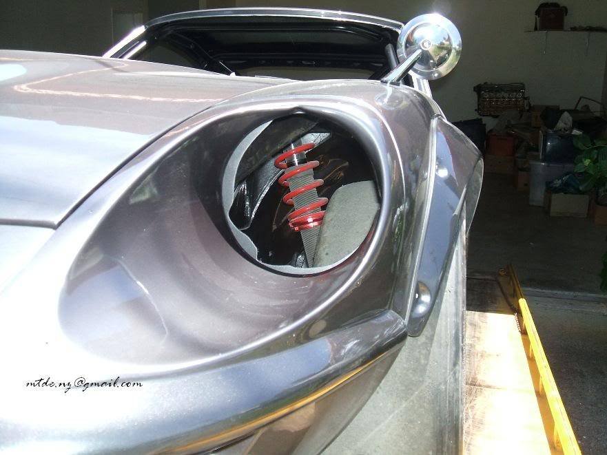

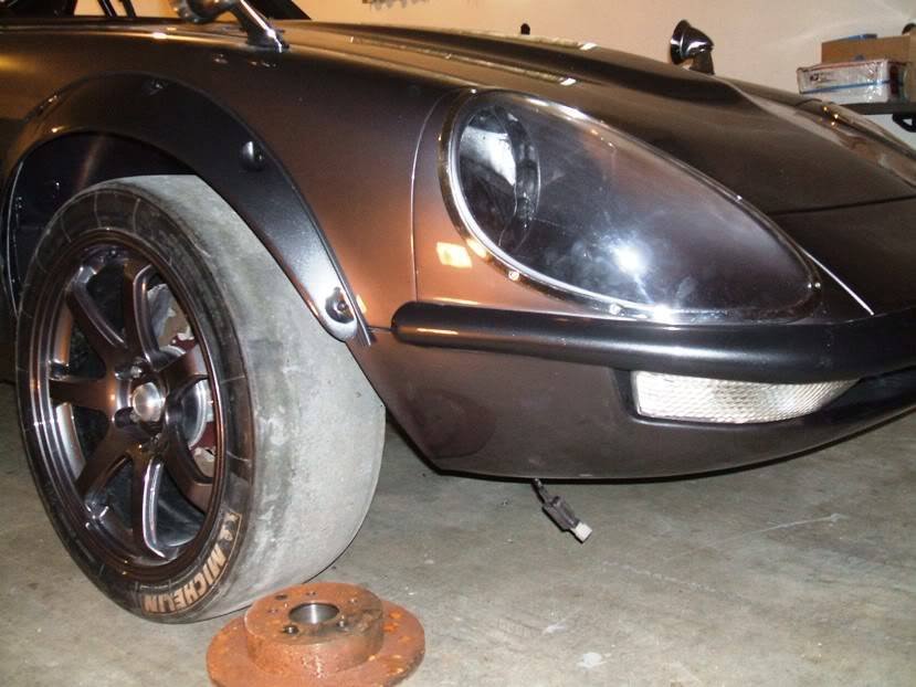

Looks nice, where did you find the headlight covers for the G nose from? Also where did you get the G nose itself from? Cheers.
Hey,
Both parts were a cash and trade deal with a zed club member in NZ here.
GNose is a single piece mould as per original one.
Headlight covers are genuine new units from ebay = $ouchee

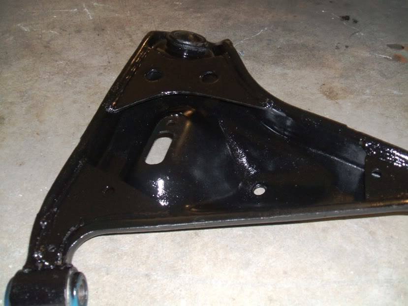

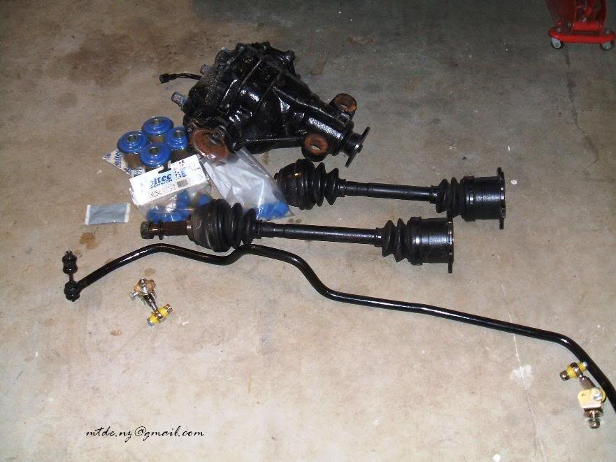

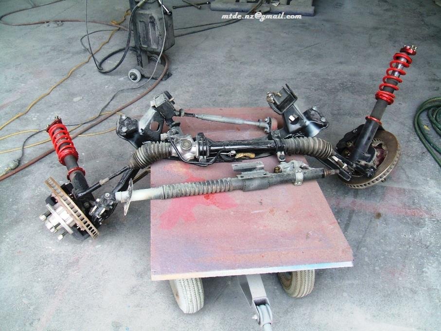

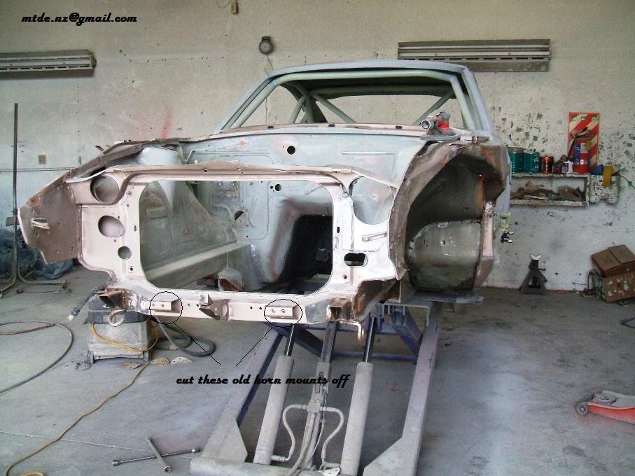

Start at the easier end for now.

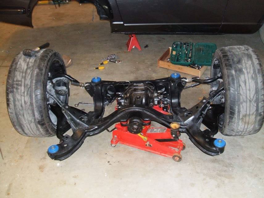

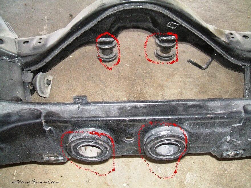

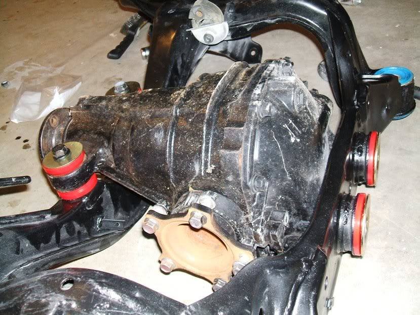

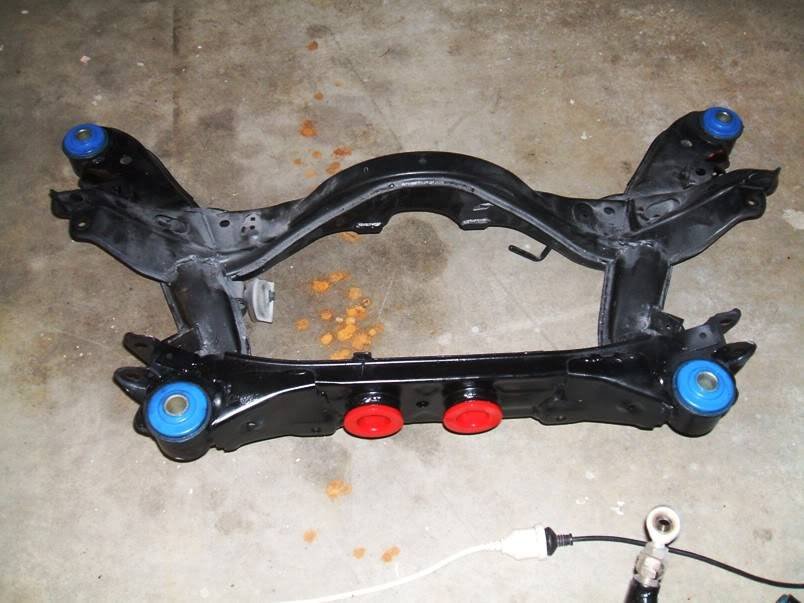

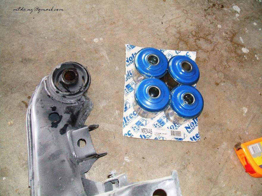

Take out rear subframe
Bushes for subframe to body need swapping over
Easiest to do them now...

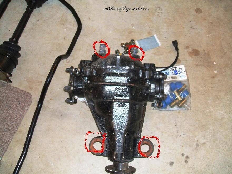

diff bushes need to be sourced and chucked in
rear brakes need completing, been rebuilt, just a quick spray and in.

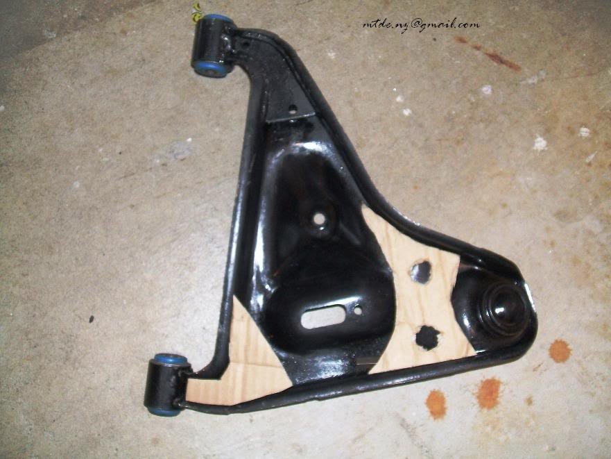

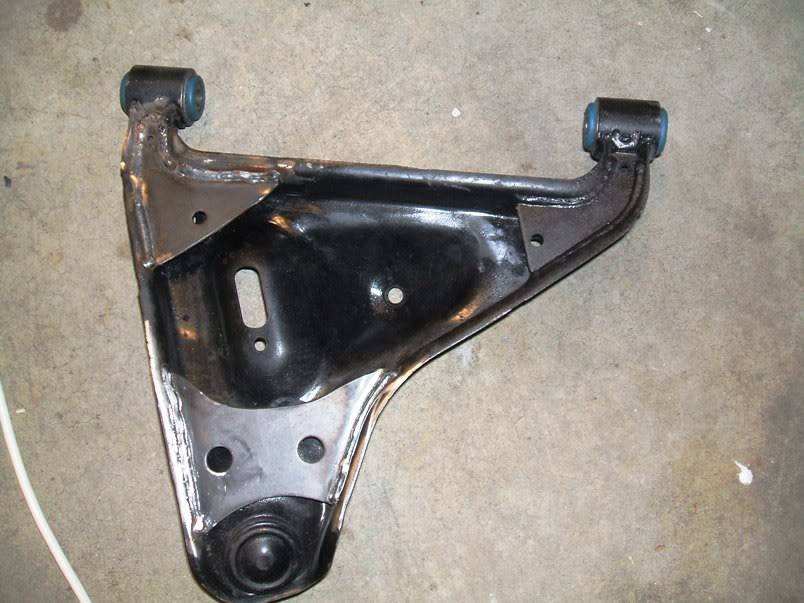

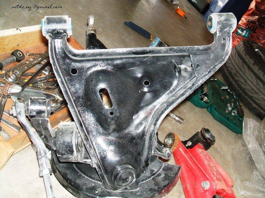

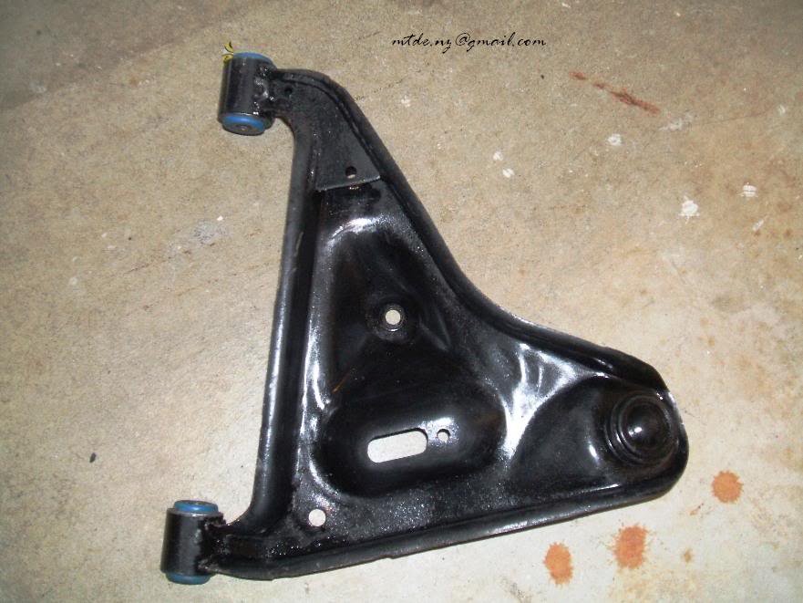

rear lower arms could do with a strengthen. Its a gaijin copy of the Nismo options. Very high tech stuff this cardboard.
Since Ill get a local engineering shop to press in/out the bushes, they can weld up some plate to the lower arms until such time as the TIG turns up.
hmm just might point out the original is a 5 piece setup not a single piece :( I have 4 of the 5 original parts for my G-Nose. LH headlight bucket, RH headlight bucket, top centre section, lower section and the urethane bumber = 5 pieces :)

Before,
sophisticated templates cut out with kids snips,
welded in using 2mm plate
paint applied
Had to press out one bush again so it didnt melt out
I believe Ive spent more on this rear end than a 2nd hand skyline complete...ergh.

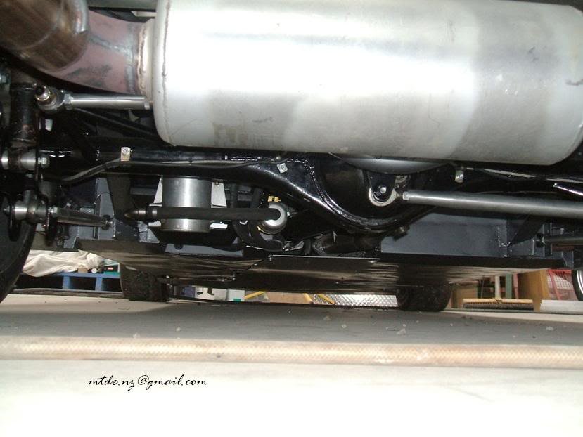

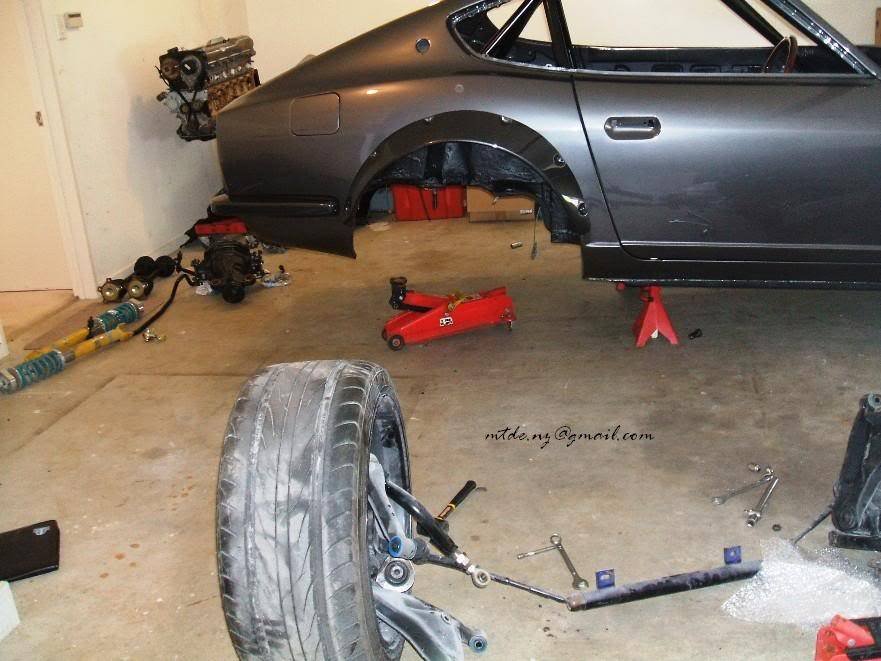

Subframe bushes in - Autolign in Carbine Rd
Good fast service, cheap prices.
Diff mounts are not listed under ER34, but S14 Silvia, but fit well.
Rear end shoved together with little love.
Some bolt threads stripped from panelbeater/painters lack of love.
Ill need to replace a few of them
Might even need to get that one camber arm the right way round, doh.

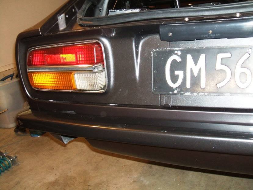

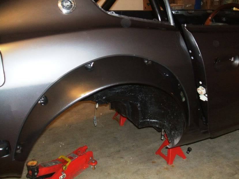

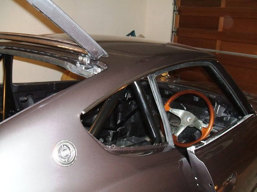

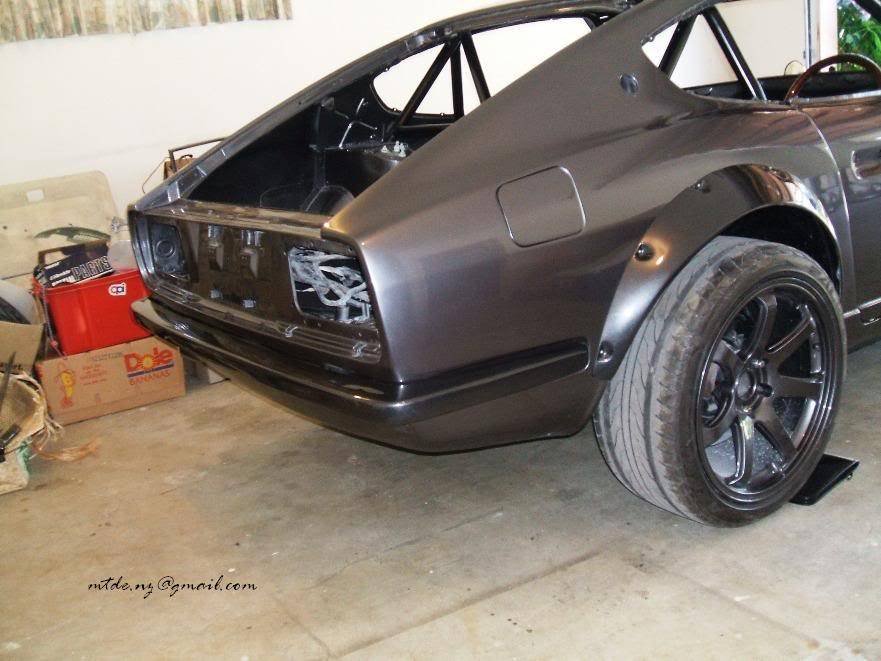

Dug up the rubber trim that heads around the FAKE super wide ZG arches and gaurds
also used the clips that cover the screws, looks pretty tidy.
Could do with a minor adjustment later.
While AUtolign were sweating over the bushes,
I mucked around with the rear end.
Need plenty of parts, rear lamp rubber gaskets, straighter lamp garnish? panels etc.
Decided to keep the original rego plates, look period.
Rego still live, smart boy...
Stainless roof channel chrome given some lovin and clipped in
Ill get some new quarter panel badges for xmas if Im lucky.

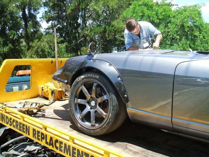

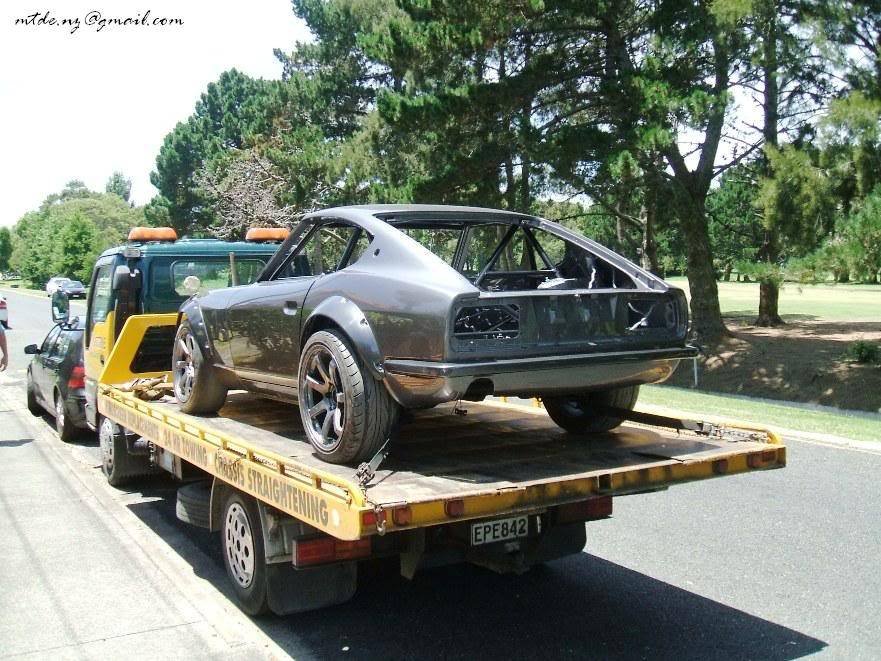

Collect TA22 0800 tomorrow.

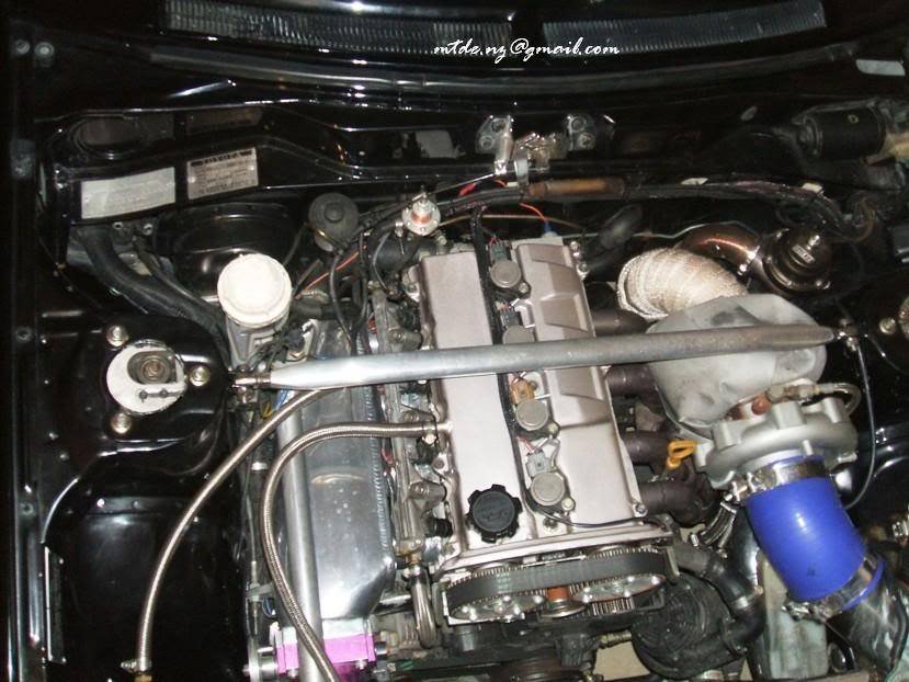

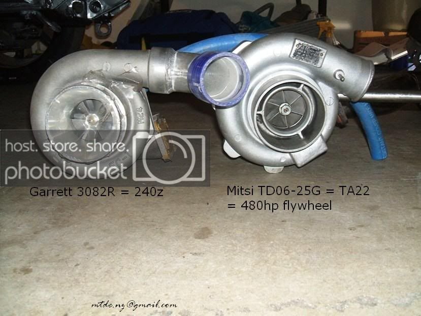

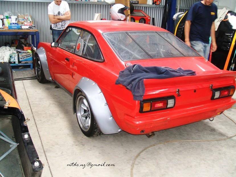

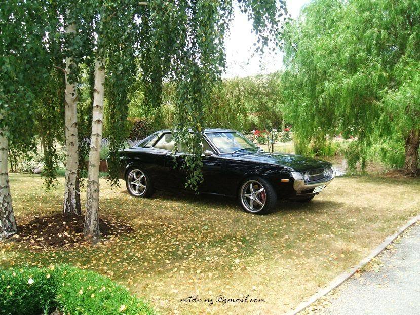

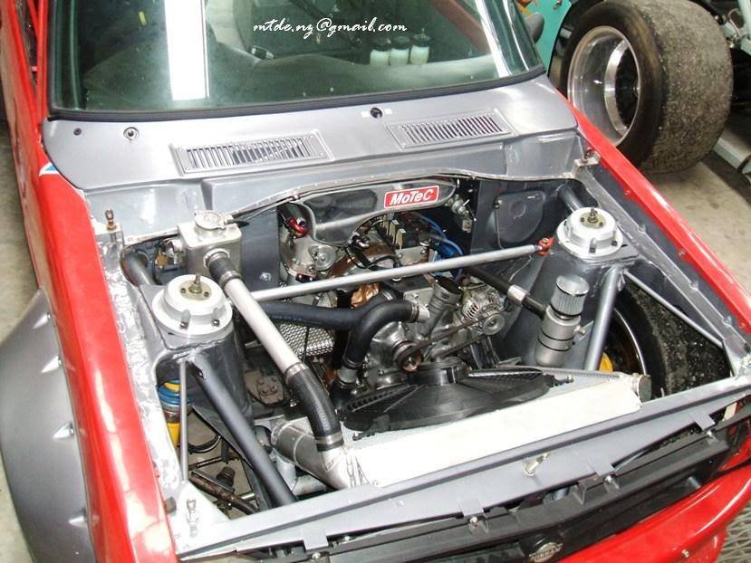

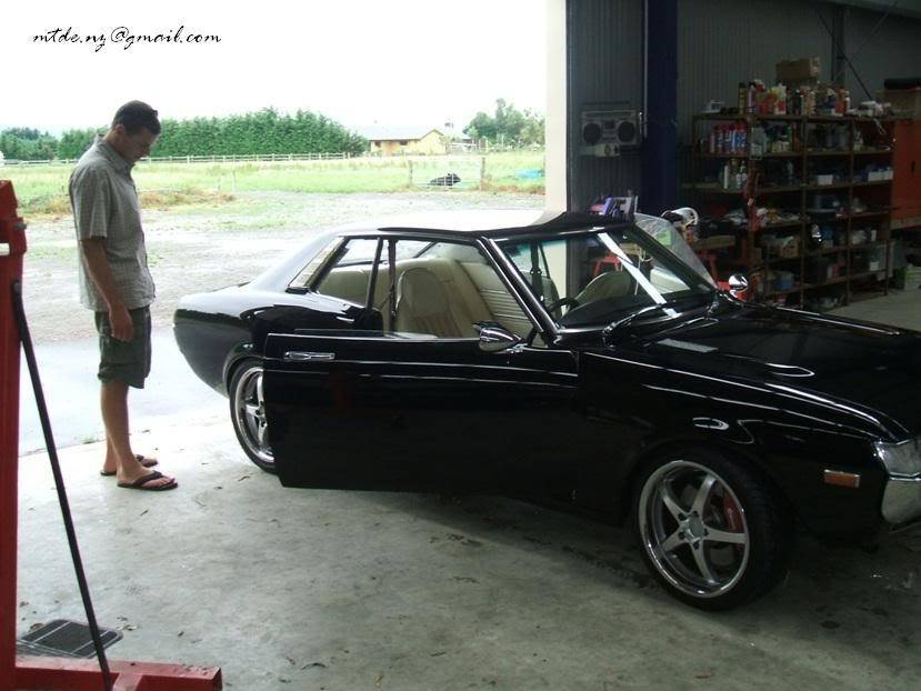

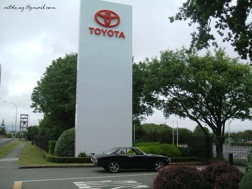

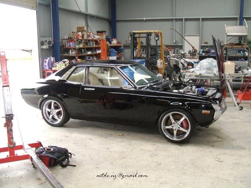

Its a 1973 Toyota Celica Ta22
It has a 4cyl 2.0l engine from a  ST215 Caldina GTT (the ugly station wagons).
Engine is totally stock internally.
All power adders are external.
The chassis has heaps of work done to it, coil overs Bilstein and Carrera rears.
Camber, castor plates, bushes, Evo 8 brakes, LSD...
It has 400hp at the rears, it weighs complete all fluids/fuels 1060kg.
TD06-25G turbo, 800cc injectors, Link G4 ECU, Elec water pump, elec boost control etc...
It will teach me plenty about what driveability Im after in the zed.
This car requires some work before Im completely happy with it.
Car is completely legal and engineered.
Collection location
Not ready for the PepperTree just yet
Just to state the obvious, I didnt build this car. I bought it as is.
I will start mucking about with it. It will be kept driveable while I put the zed together.

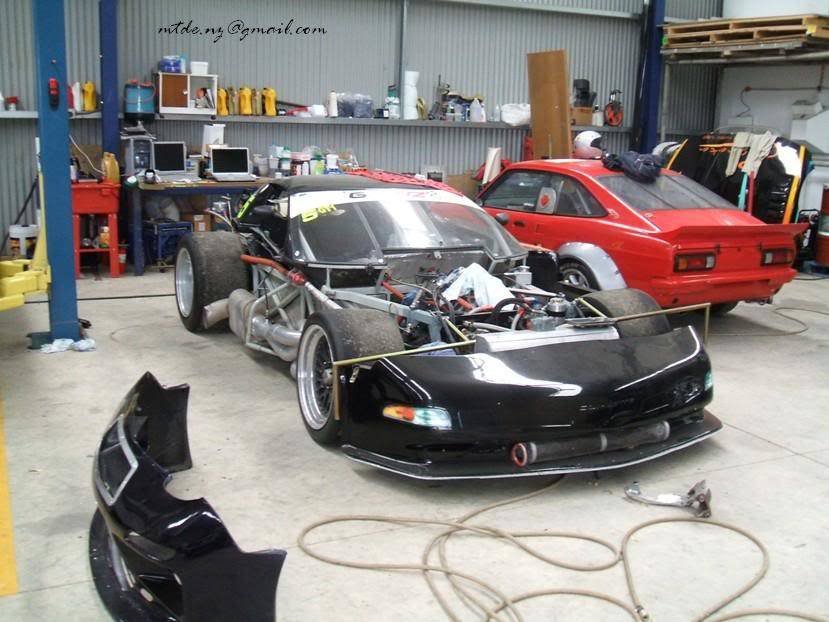

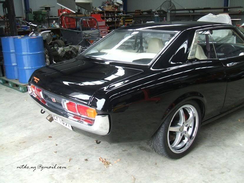

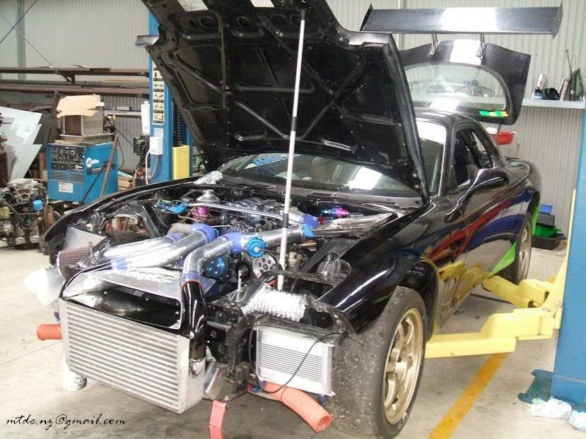

Other random car shots that were in the same location as the collected TA22,
FD3S race car 550hp @ wheels,
Corvette, engine blew up soon after purchase, go figure...
1UZFE & GT35R would work well....
To replace the love of the TA22, try a Datsun 1200 instead,
12A PP,  mid mounted, flat floor = lovely car!

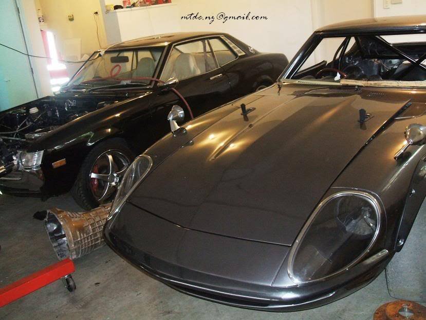

SO now that car 3 is down, back to car 2.
Now the GF has flown the coup, I have no more excuses.

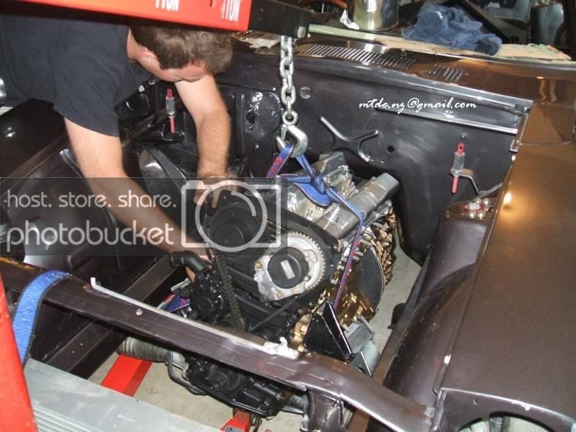

Begin then!

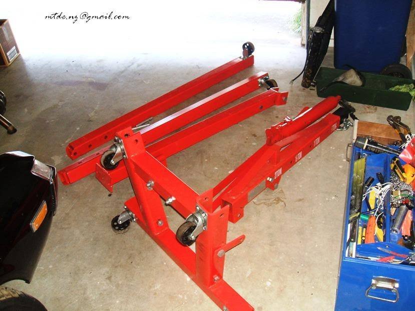

Thanks Glenn Martin for the crane ! Enjoy the vinos and the smelly nappies!

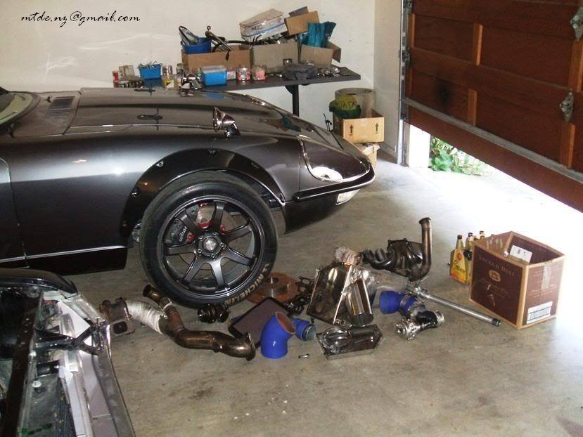

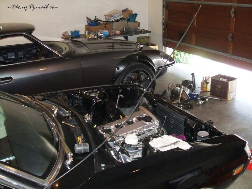

All I need in the garage that reads over 30 deg Celsius in the day

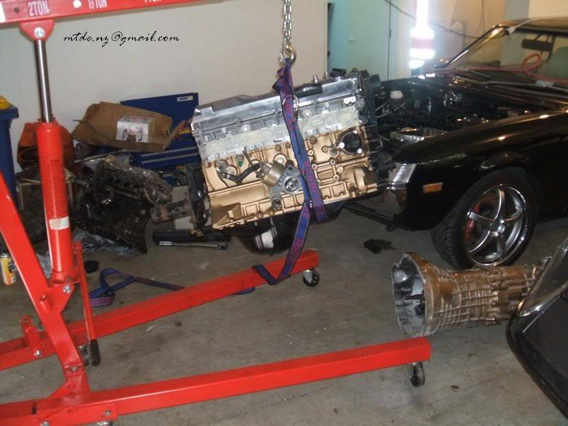

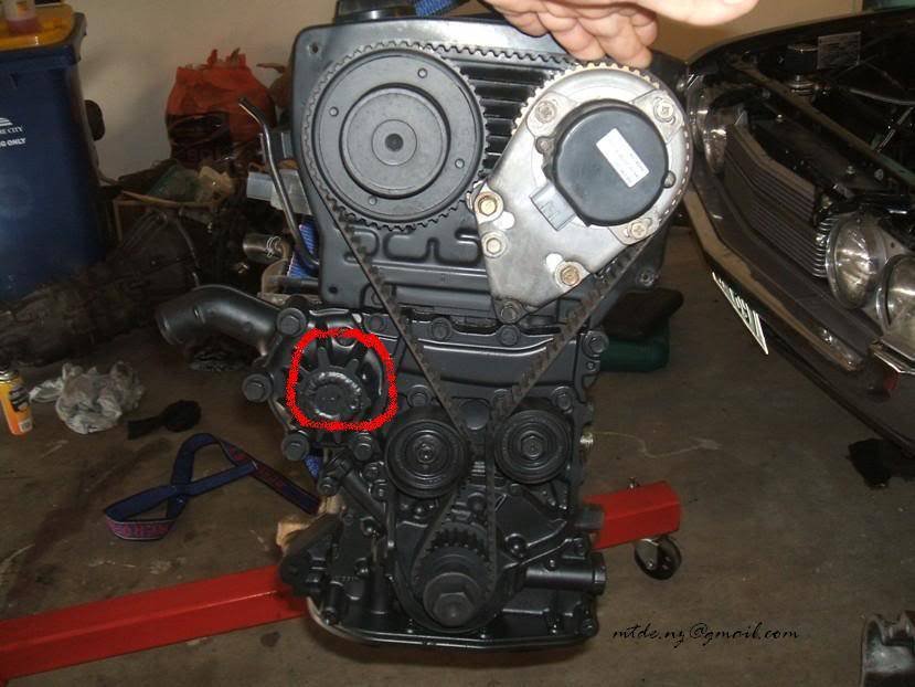

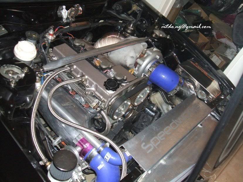

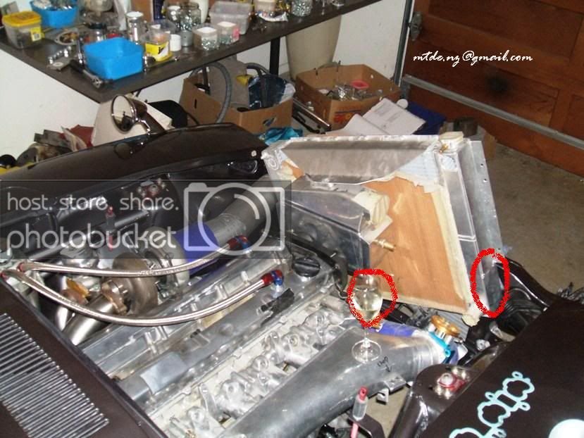

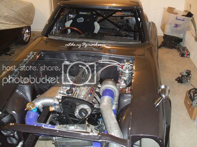

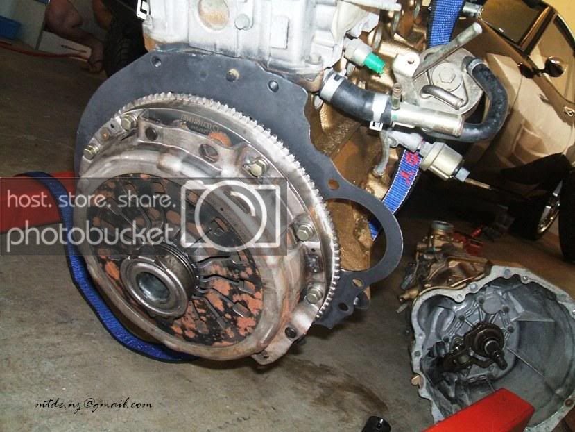

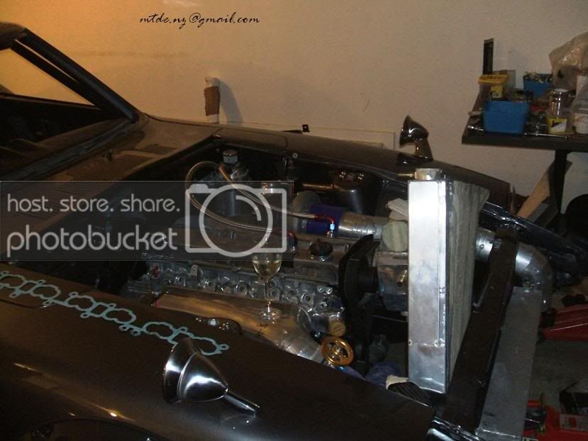

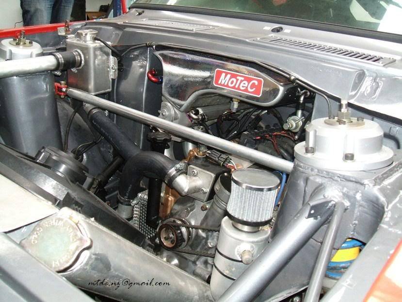

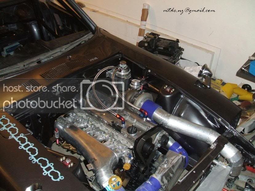

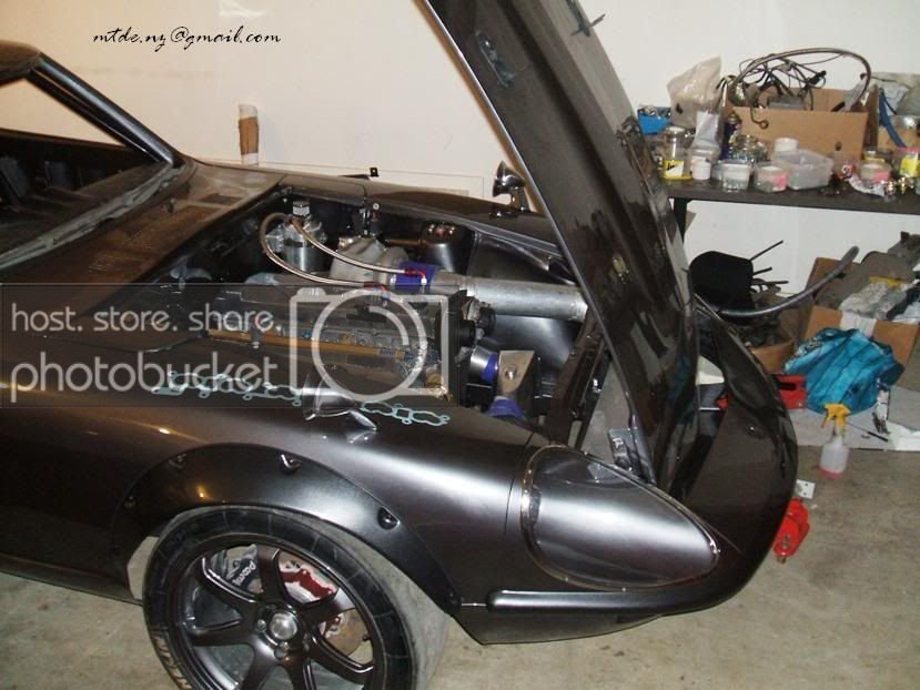

Note the welded up water pump, it runs the housing but nothing inside. The electric pump same as the toyota will do the pumping and job of the thermostat.
New cambelt, idlers tensioners etc. Timing needs looking at later.
Apparently good for 400ps, we will see about this. Copper mix, should be driveable though.

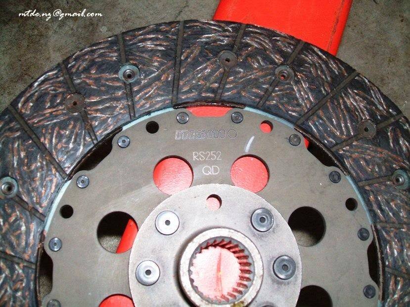

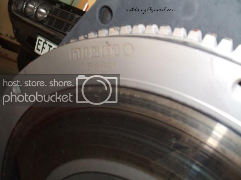

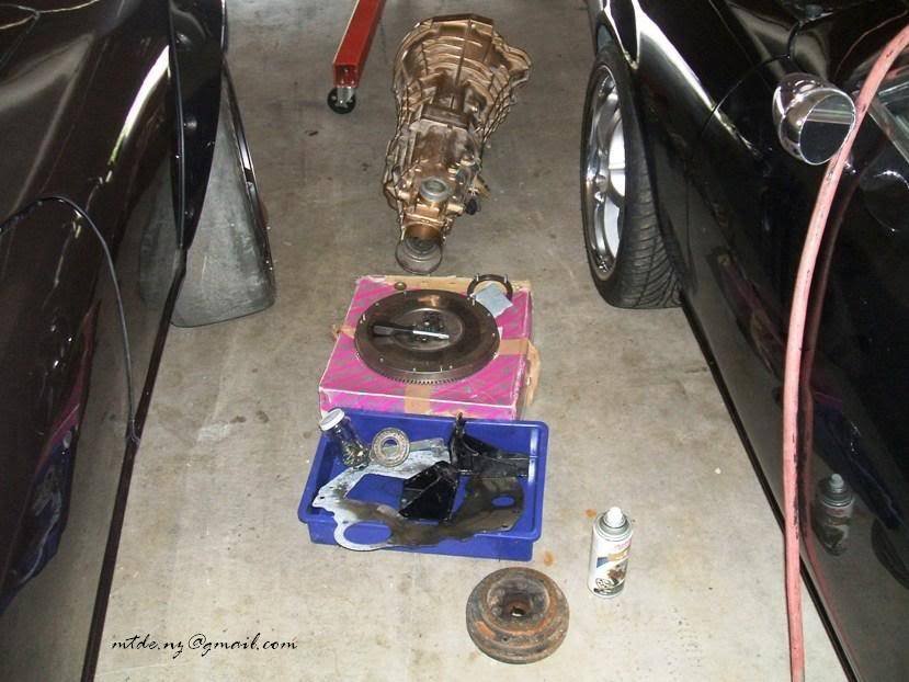

Light Cro-mo flywheel from Japan

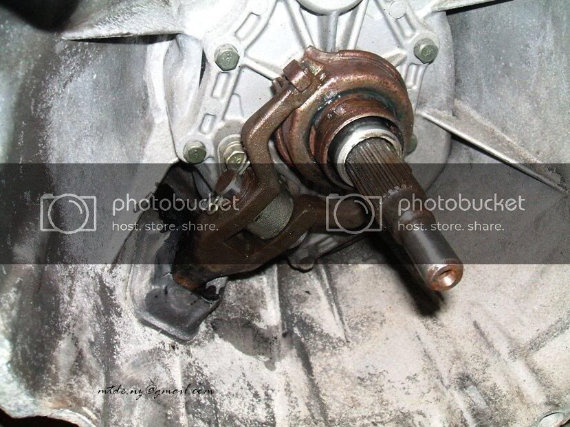

Replace and clean up thrust bearing and fork in gbox completed

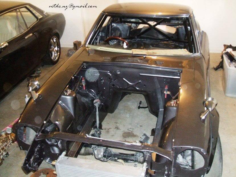

We have a problem. As per usual, change one thing buggers up everything else. Im sure I said this before. The new frame rails had a slight kink in them increasing the overall width between them. The new ones dont, so the radiator needs to be chopped and re-welded at the lower end. Thanks Hayley for the welder use approaching. More wine required.
The above shots and work were completed over a period from 8am until 4am on the zed. One long drunken shift.
The toyota will absorb some time this week when all the parts turn up so wanted to fulfill the promise of getting the engine in the zed at least before going back to work Monday.
