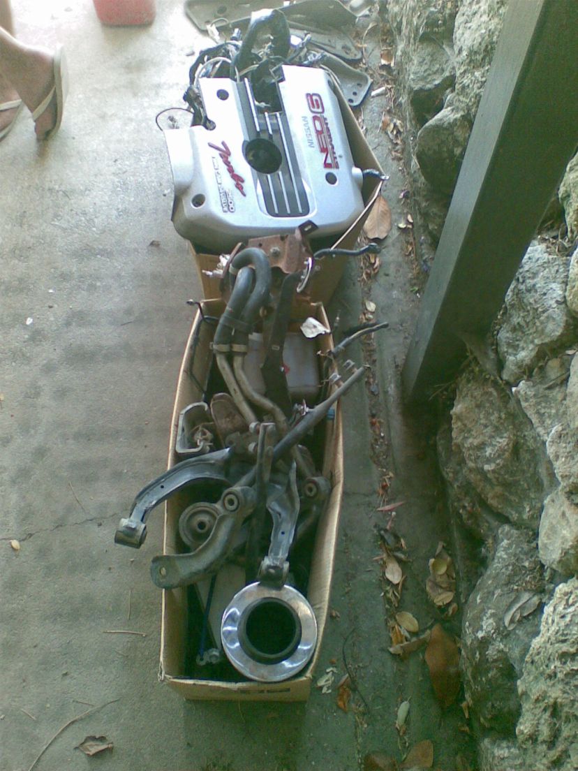

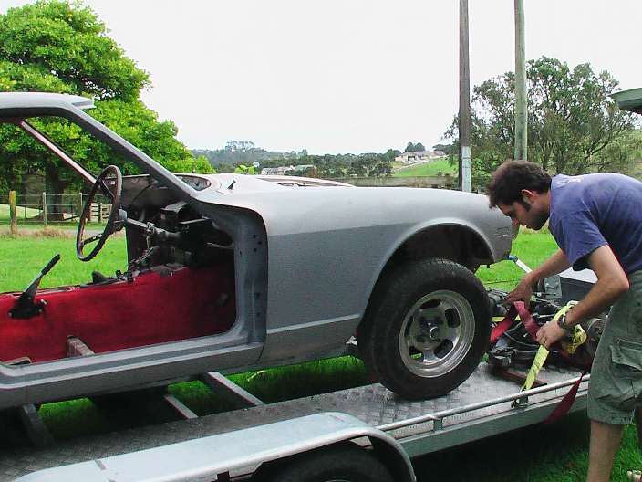

Here we have the goods being collected down South East of country.
2000 ER34 manual with 30kms on odo.
Hang on a mo, its missing parts...
- No turbo or manifold
- No clutch
Everything else is here, ECU, loom, all the brakes and subframes front and rear.
Just what can I fit into a '73 S30 chassis?
Time to find out.
Lets get this lot cleaned up, and up to Auckland.

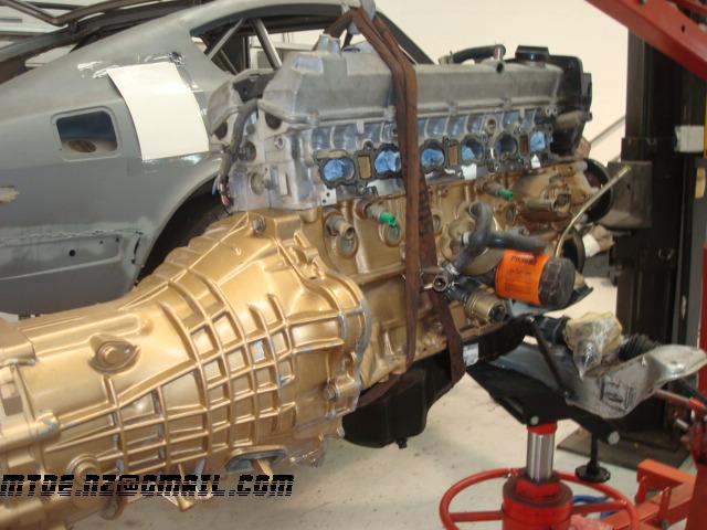

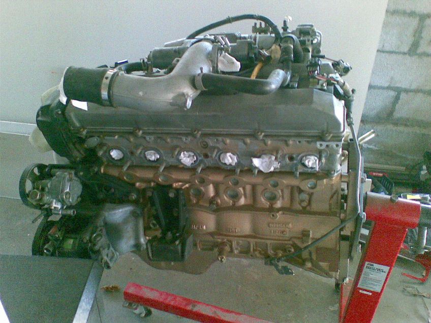

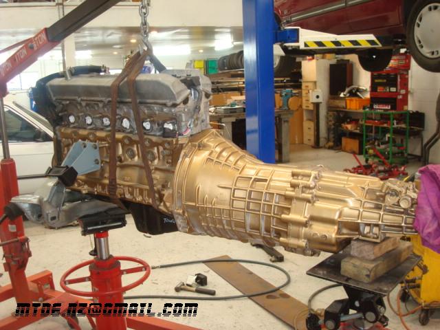

More organs.
Gbox looks a little more beefy than the stock S30 4 spd. Plenty of external castings protruding out. Apparently handles big HP. Lucky me eh.
The ex-owner of this lot, a freindly civil contractor down in the bay, had stripped a perfectly nice er34 to turn into a show car, but perhaps the finances are better spent firing bullets at stags.....good man, and thanks again Vinny.
Being the last generation of RB25's, it is different to the R33 S1 & 2 engines, because of the use of solid lifters in the head, different injectors sizes and set-up, variable valve timing, and a higher CFM & more efficient turbo, with a tidy 280ps flywheel factory. Its still a cast iron block, ally head big beast mind. The classic part of the er34 r25 turbo engine updates, is that the engine (standard) is a LOW EMMISION VEHICLE : LEV. This wont be no Prius however.

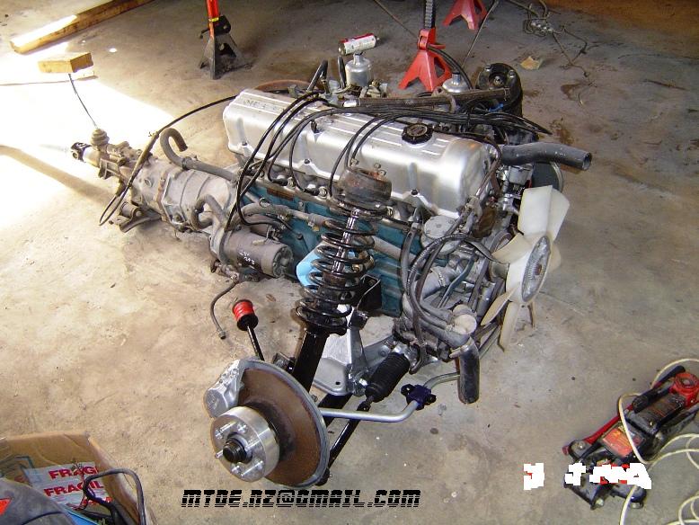

A delightful, rebuilt and ready to wimper L24 stocker/4 spd.
Now sold on. Bye bye says the butcher.

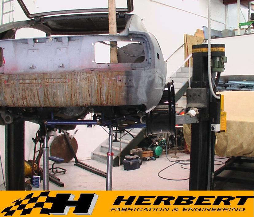

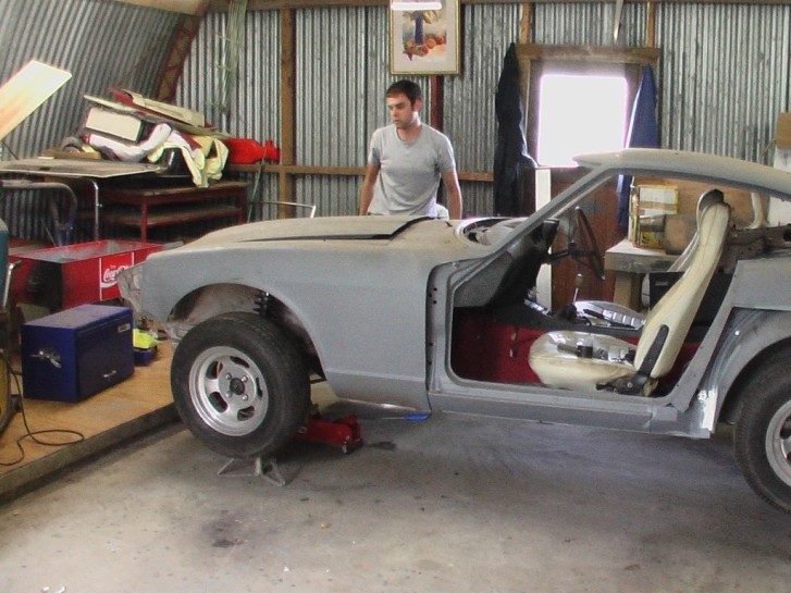

Breif to Mark Herbert:
- Get the rear subframe into the S30 chassis.
- Keep it low profile
- Not worried about cutting up gaurds
- Is it finished already?  haha
- To fit in 18 x 9.5" wheels, standard er34 offset for size, 265/35/18.
Once the rear is in, we agreed to discuss progress, make sure client/fabricator get on OK, and see if we continue working.
Fair to me.

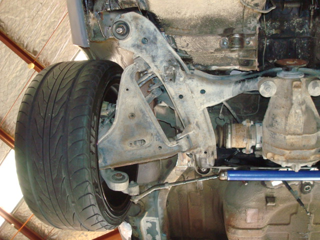

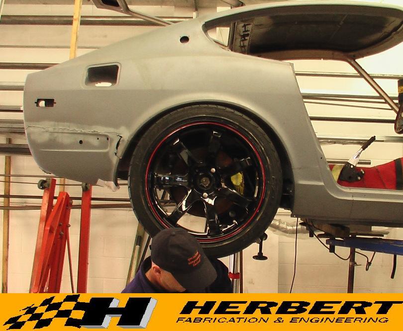

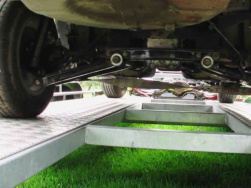

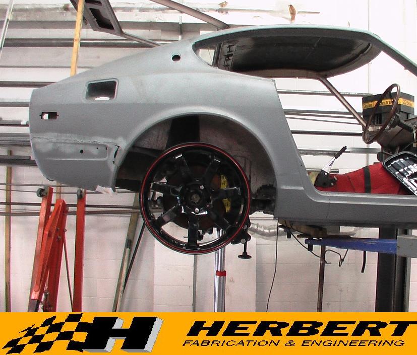

- Rear profile. Subframe not modified, ie. standard width. Circa +160mm total. I like the new width/track, lets forget about shortening this beast, would be a crying shame, just think of the lat. acceleration capacity...feeeeel the 'gs. HICAS gone using peice of steel bar.
- Sans tire, looks OK. Subframe located, but no welding just yet. Clearance checks seem OK.
- Mark holding wheel at the approximate ride height, ie. includes sag. We will look at gaurd mods later, ignore the lack of room. Will be around 120mm clearnace from chassis underside to road. PLENTY (100mm is minimum legal clearance in NZ)

Big nose checking out the extra track.
Sure makes the diff seem small.
Most of the rear end stays standard for now.
Changes planned include;
-Hicas lock - installed in blue.
-Camber links - require-rewelding due to poor welding from China? Taiwan? Dunno. Xray man said go away, even before getting the test equipment out. Grind back and TIG again.

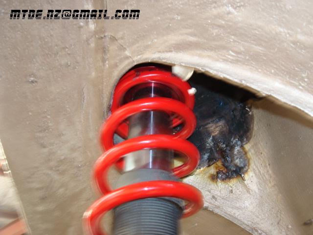

Strut assembly not where it should be,
Original strut way too long to fit, requires an off the shelf Koni/Bilstien unit or something cheaper.
Camber link also not in

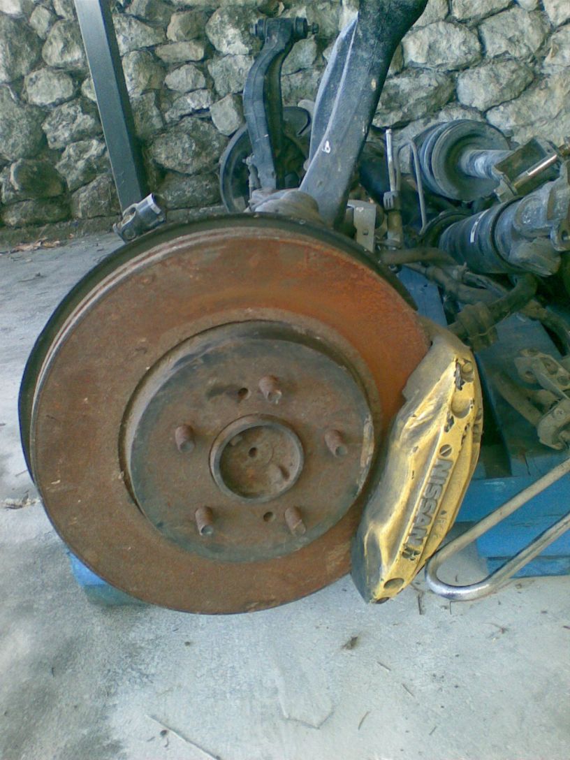

Using the z31 turbo 5 stud front hub,
8.5" wide wheel
stock er34 disc and calliper
- Fitment looks ok
- Very heavy! Reducing unsprung and rotating weight should be my target.
Going light with disc and hat, aftermarket calliper and alloy hub will make a great improvement for the money

Intake manifold will have to go

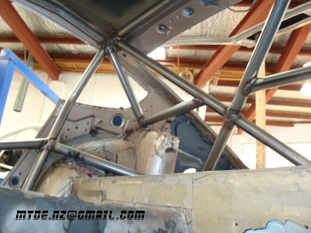

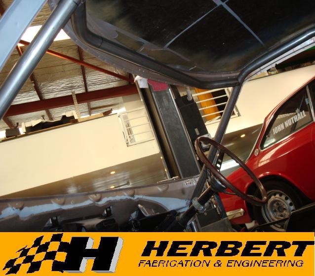

Spec is for a basic cage suitable for light track use, kept tight to lining, mild steel.
Will tie into front strut towers once car is further setup, and sitting on a flat table to check chassis is 'straight', which will be pretty unlikely.
Rear bar across luggage dept. ties the rear subframe mounts together with something more than panel steel. Pickups behind the seat area ties the front mounts for the subframe.

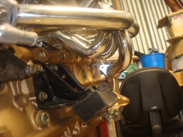

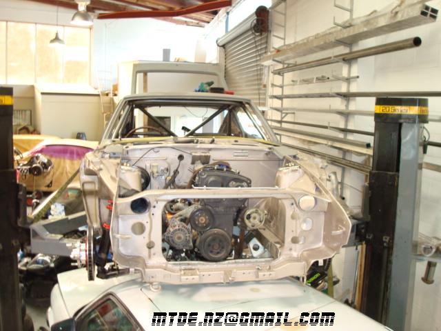

Drivetrain stripped of all ancillaries ready to slot into place.

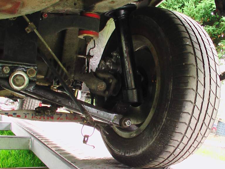

Cross member has the pretty average camber adjustment from old, inner wishbone adjustable point.
Note engine mounts completed, using stock rubber. Will give movement, but will also be good for NVH reduction. Too many fillings in the mouth to rattle out. Wish they were gold...

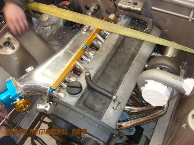

Manifold choices are OK on the market, with short list including;
- standard across the top (works fine)
- chinese greddy copy ($, casting issues, % of rejects high)
- Greddy ($$ , no bellmouths, hard to source 2nd hand or killer deal)
- Aussie fabricated stuff ($$$, too many $ for the gain)
- JP and Thai ($$, bellmouths, quality looks OK, deals available) Decided then!

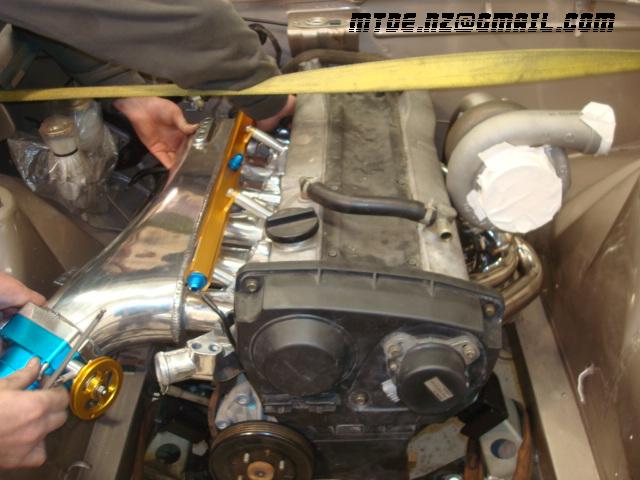

80mm TB (attempt to keep intake velocity up, better response)
SARD fuel rail (has 11mm injector holes, while manifold has 13mm. May need to open up rail diameter)
General clearance OK, TB tightish to inner wheel arch.
Anodizing is garish.
Note engine position against firewall, nice'n'tight. 15mm odd clearance there. Also the height of engine relative to bonnet catch, with the oil pan off the JDM 200zr making life easy to drop it low.
Compressor housing getting jiggy with the cam cover, will scallop out cam cover then

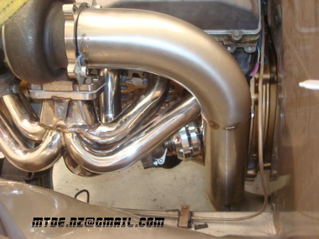

Exhaust is prepped.
I like the smooth 3" mandrel main.
Wastegate is Tial 38mm (maybe big enough, if the boost is set nice'n'high)
Position of wastegate pipe exiting manifold useless (lowest pipe in pic), with exhaust gas having to do a 180 deg. turn to exit. Hello boost creep. Will change this to improve flow to 'gate. One downfall of the 200 slide chinese unit.

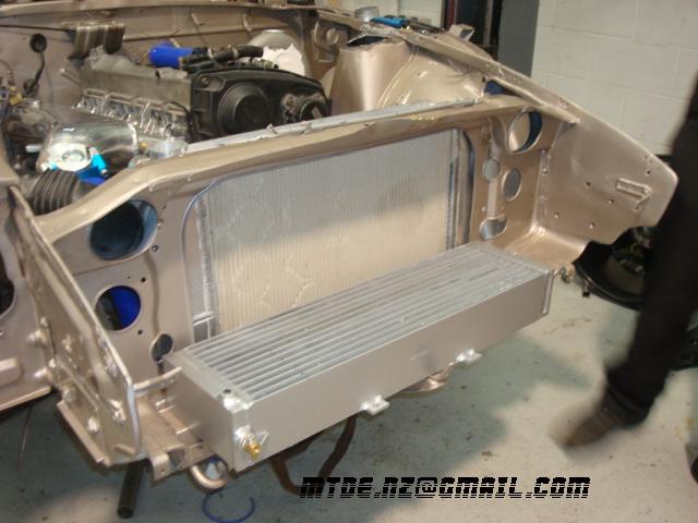

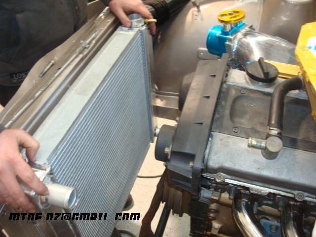

Arizona Z Car aluminium radiator, non cross flow, pipes not in the right place either, lucky the xchange rate is still OK then! Bolts up to stock mounts, but this is sans rubber mounts, which would ensure the ally welds would fail quickly. Time to apply mods to radiator then. People talk about the weight savings of ally radiators. Maths do not look good! ($/kg). Cheaper to ditch the passenger.
Note gate pipe position. Not the best place for it. Ill try once to get it working before we fabricate a new manifold.
Ill try taking it just under the flange to turbo, reduce angle change = 90deg.
Well, about time to tease those of you running carbs. (I will regret saying this)

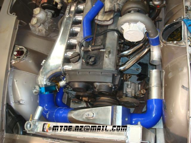

- Turbo, exhaust,gate,water intercooler,radiator into position.
Pipework has more work to clear tight spots here and there.
Modified TB location on intake manifold, to clear inner gaurd. TB running 80 degree to usual install method.
Heat exchanger out front of radiator, pumped  by bosch intercooler water pump (controlled by ECU)

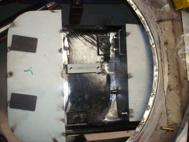

Secret fuel system hidden in back, bosch 700hp efi pump, lift pump, filters, tank increased in size (modified original to increase fuel vol, and house a surge tank), and it all looks completly stock. Beauty.
- cage fully welded up now, and completed.
- car a roller, can push between the workshop and the bank manager.
- Neil Fraser has viewed the car, and more than happy with the efforts, with regard to certification.

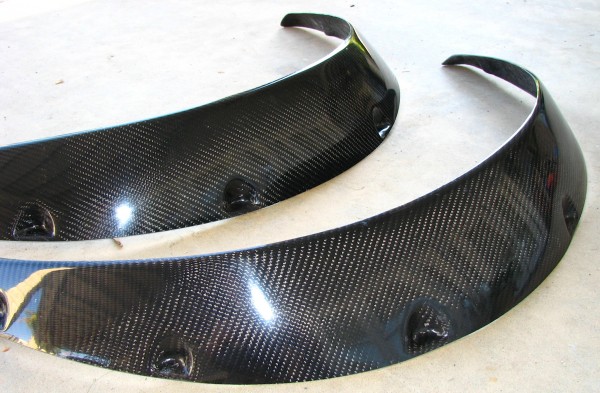

Super BAMF ZG flares are manufactured and on their way from the States (+1" wider at the front, 1.5" wider rear, than the standard ZGs seen out there)

Finally getting closer to obtaining some JDM wide spec zg flares.
This guy is doing moulds, producing in f.glass and carbon fibre.
Rears are 1.5" wider, front 1" wider.
This should easily take care of wrapping up my wheels, and possibly leave some room for a spacer, increasing the track more.

On a random point, ZGs were designed for an arcing movement of a Mcpherson strut, hence the angular shape.
The rears flares may need the extra width to take into account a relatively more up/down suspension movement (or certainley less camber change on bump)

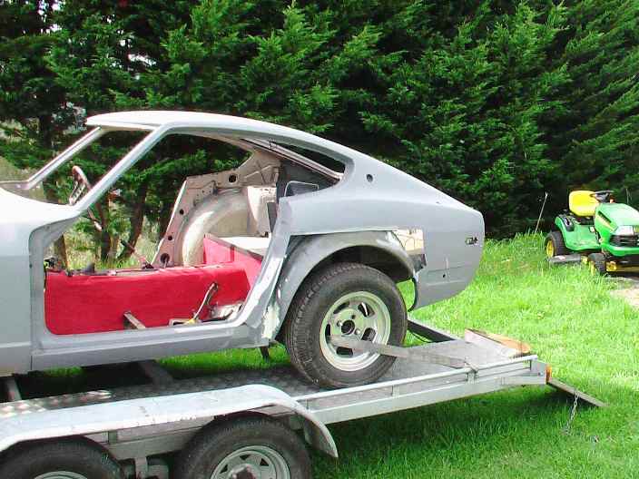

The beast is out in the light, ready for the next round.
Mock build before the panelworks.
All wheels/tires stick outta gaurds.
Nice n low
Happy with that.
