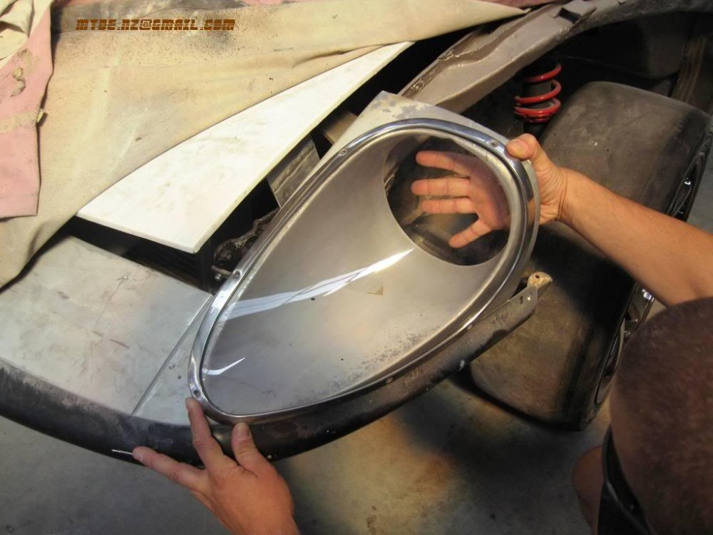

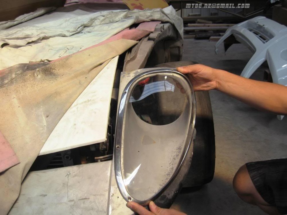

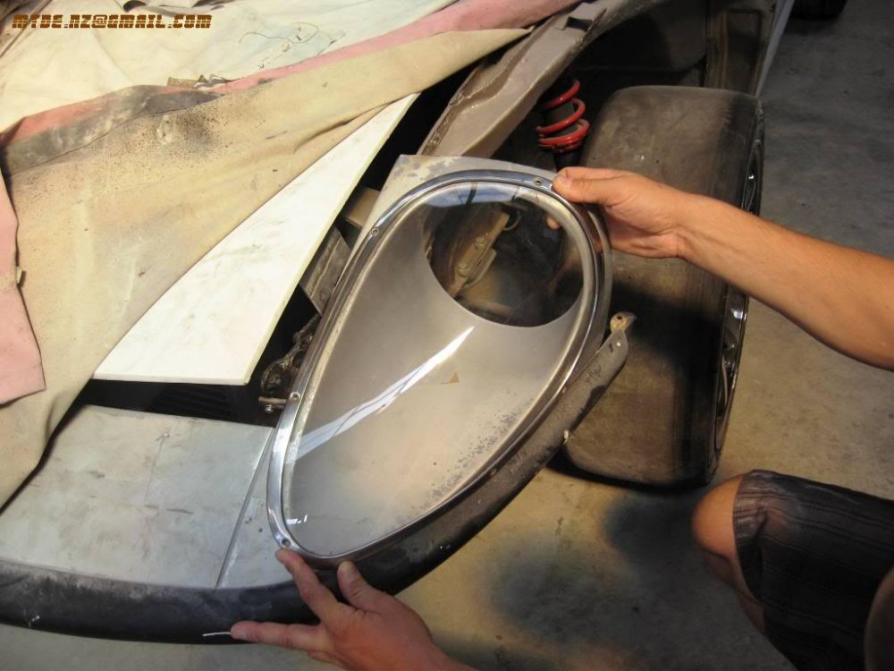

Mike again comes to the rescue for the new light covers.
Dont see these floating around too often
They are mint. Perfect.
Let the panelbeater make them fit nice.

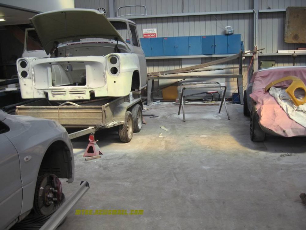

Blame the truck body for taking time - worked on by the customer, then brougt back to the shop, jumping the queue.
RUDE !
Never mind. Once the truck cab is out, Im up.
Where did you get the Gnose, what kind of mould is it 3 / 5 piece?
Gavin,
two g-nose kits were offered a while back from Mike, ruler of a clandestine Z hoarding and storage operation here in NZ.
He had a 5 peice - but incomplete in steel, and a one peice in glass. Took glass for quick and easy install, light too.
Since mods were likely to be made with/to the gnose, glass was going to be cheaper/easier to hack up.
Swapped a new front bumper for it.
He also provided the light covers. Good man!

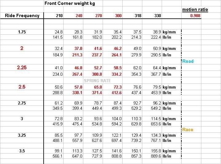

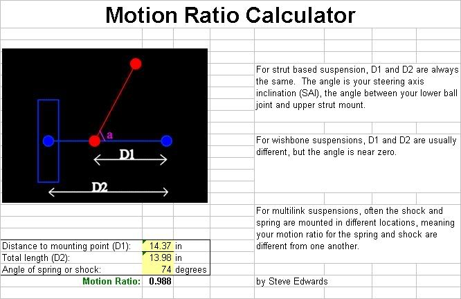

Lets check my 'off the cuff' front spring rate choice last year.....
Arm chair engineering
Motion ratio at the front is not far off standard, even with lengthened arms +50mm roughly.
Spring rate, as a function of motion ratio, corner weight and desired suspension frequency.
Could back up this pile of gobbledegook by pulling out the strut inserts and measuring the natural frequency doing the bounce test. This would include additions of bush and movement frictions. Google has the answers as usual.
Corner weights are guessing within a range, as is suspension frequency.
Looks like the current 250lb springs will be too SOFT, giving lower frequencies than desired.

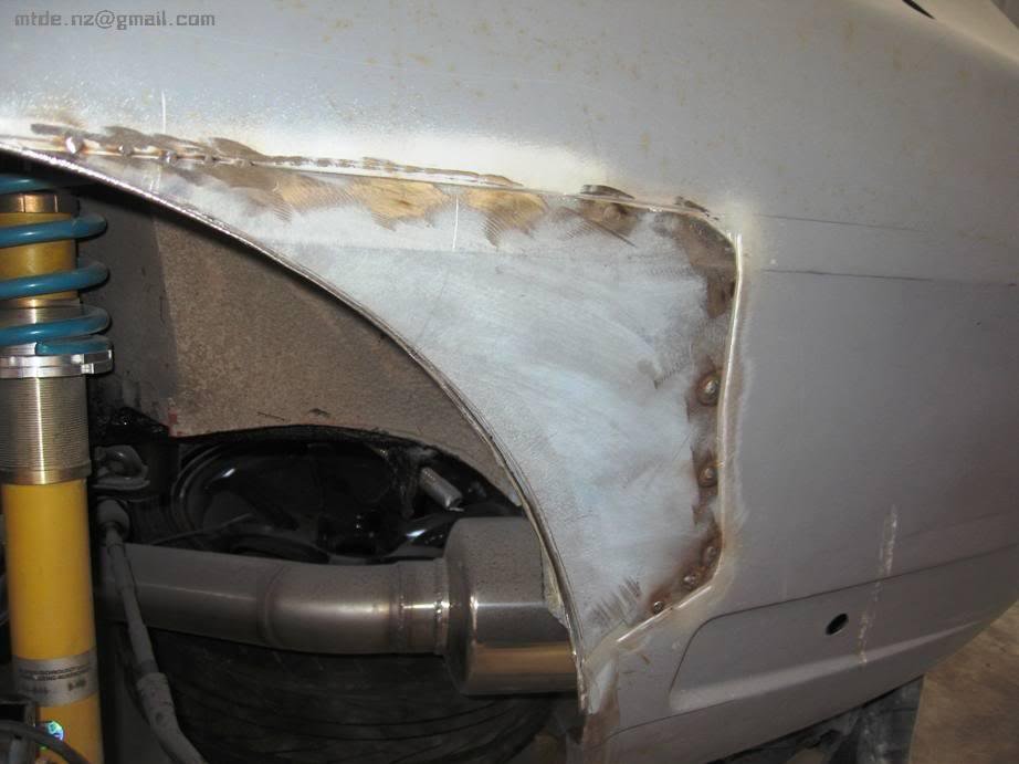

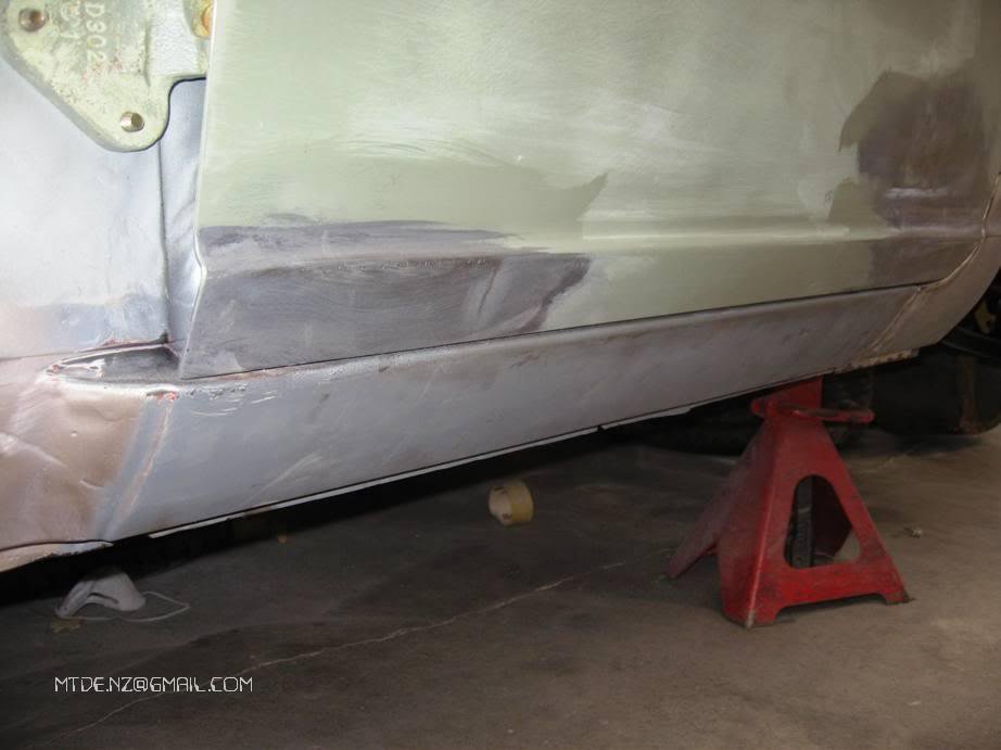

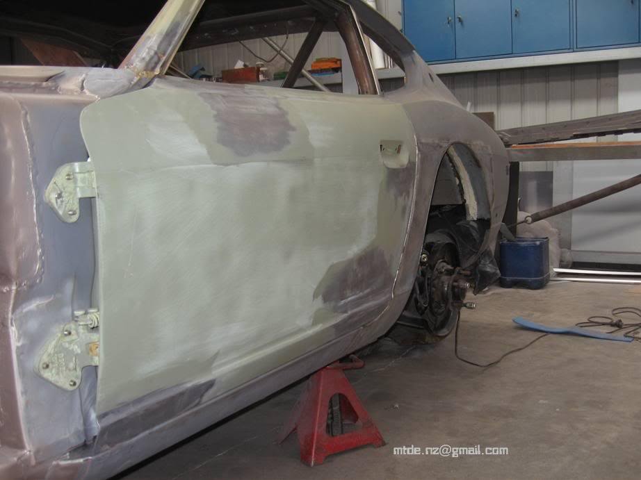

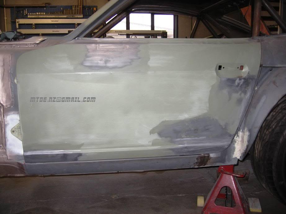

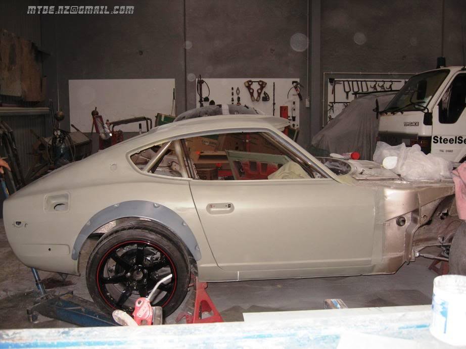

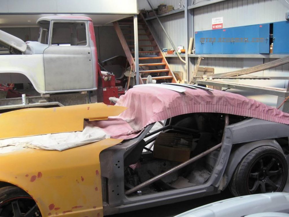

Pardon the delay, the panelman has begun some work.
Its been about 1.5 weeks work for 1.5 men roughly so far.
In no specific order.

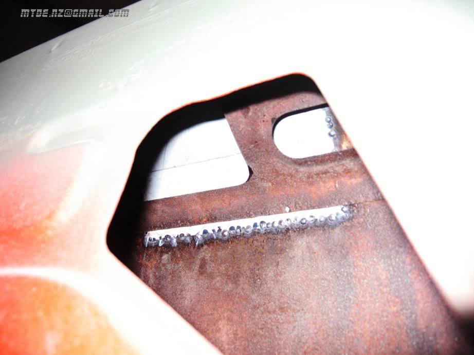

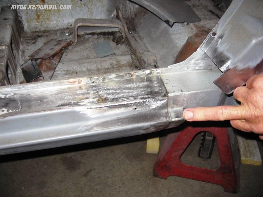

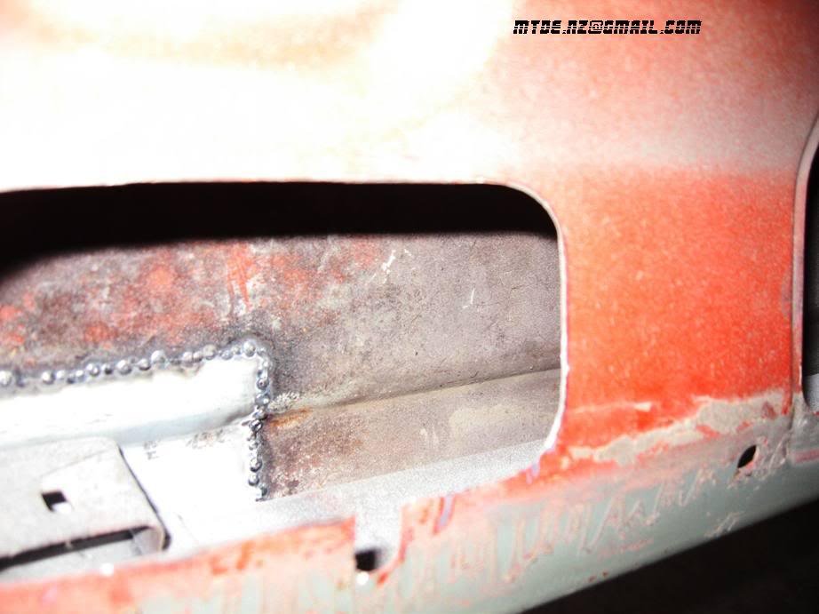

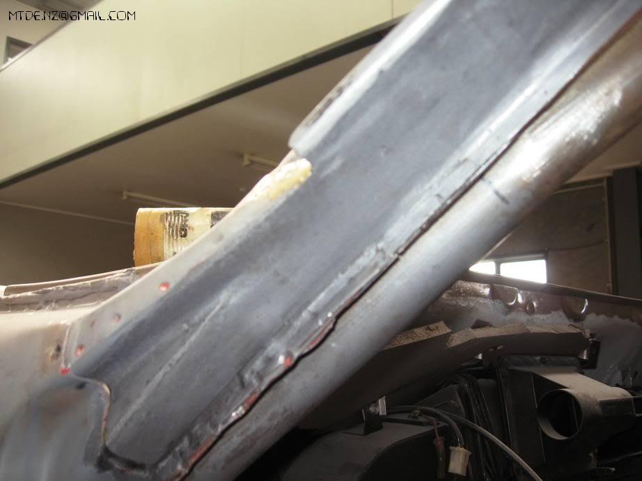

Butt welded everywhere, minimal filler rod used - (oxy acetylene)
60% metal work complete.
Few holes to recover in places, otherwise Im happy.

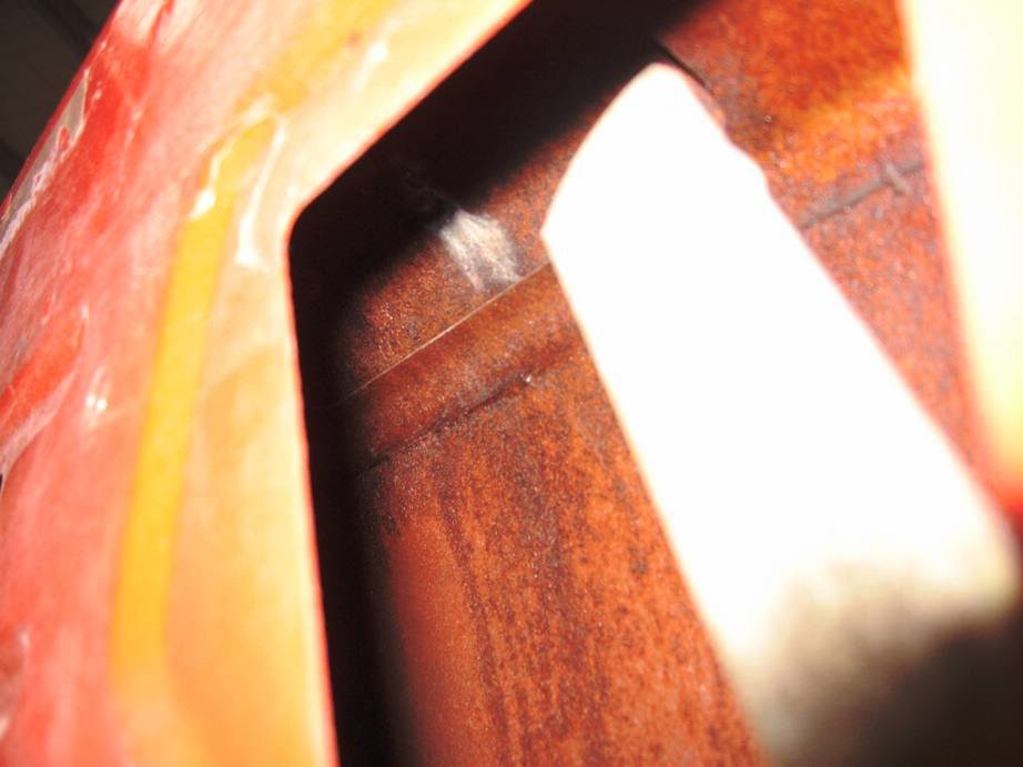

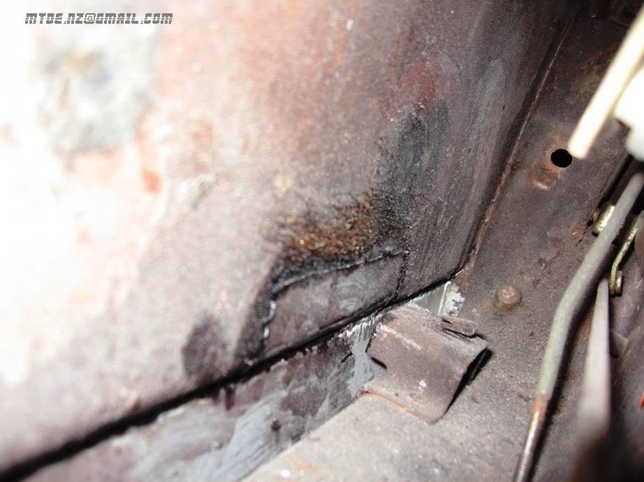

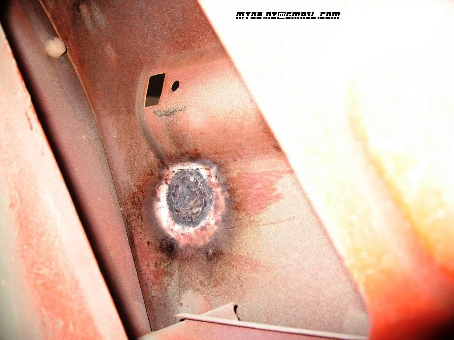

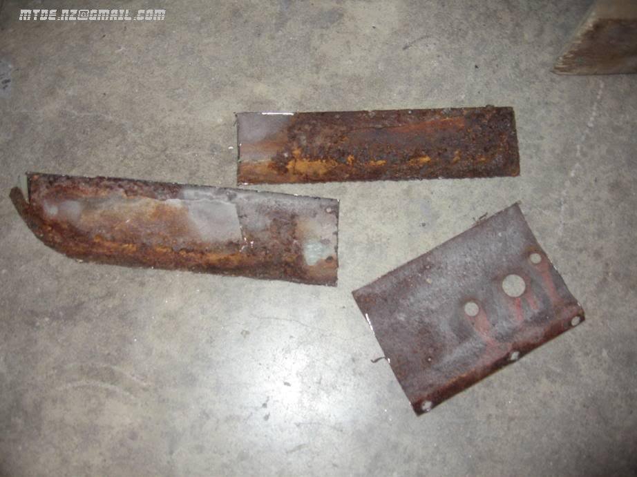

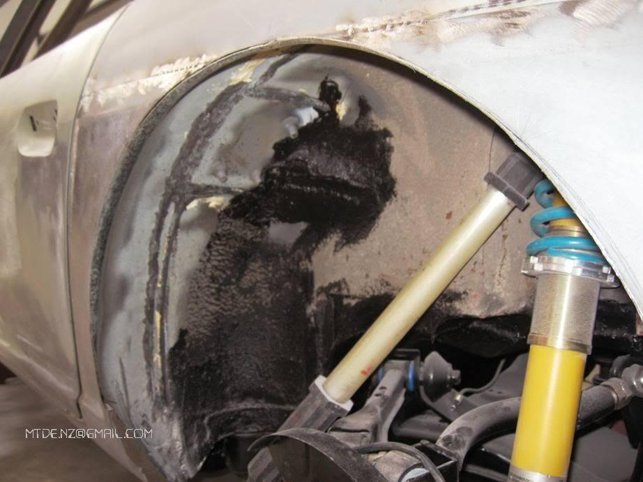

Car was treated with Tectyl?, spray on goo stuff to help minimise rust , from new.
It looks like rust , on the inside of panels, but its just this tectyl stuff. OK?
Welder could tell, weld bead wouldnt look like that,  welding to rust alright...already

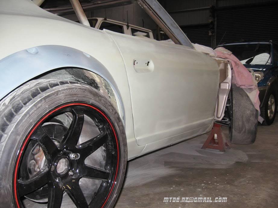

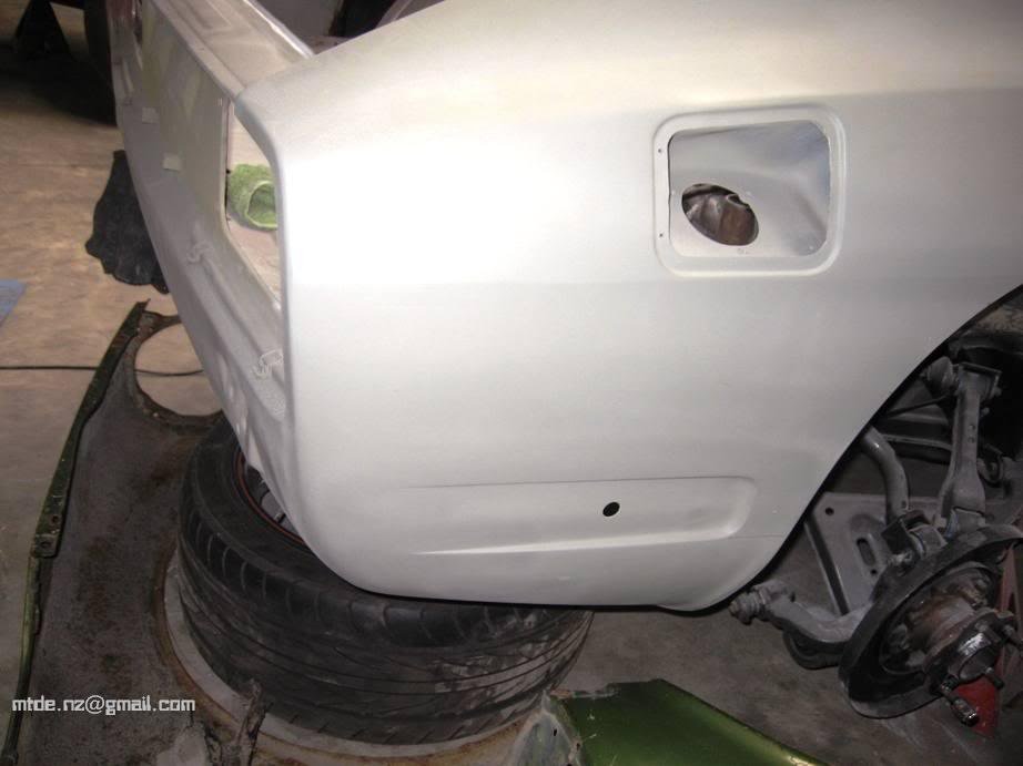

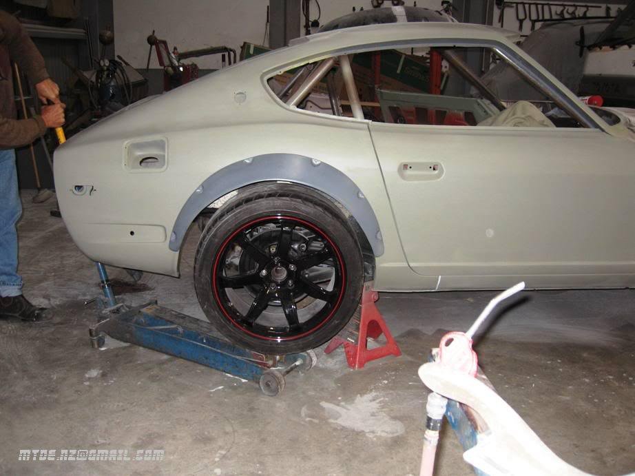

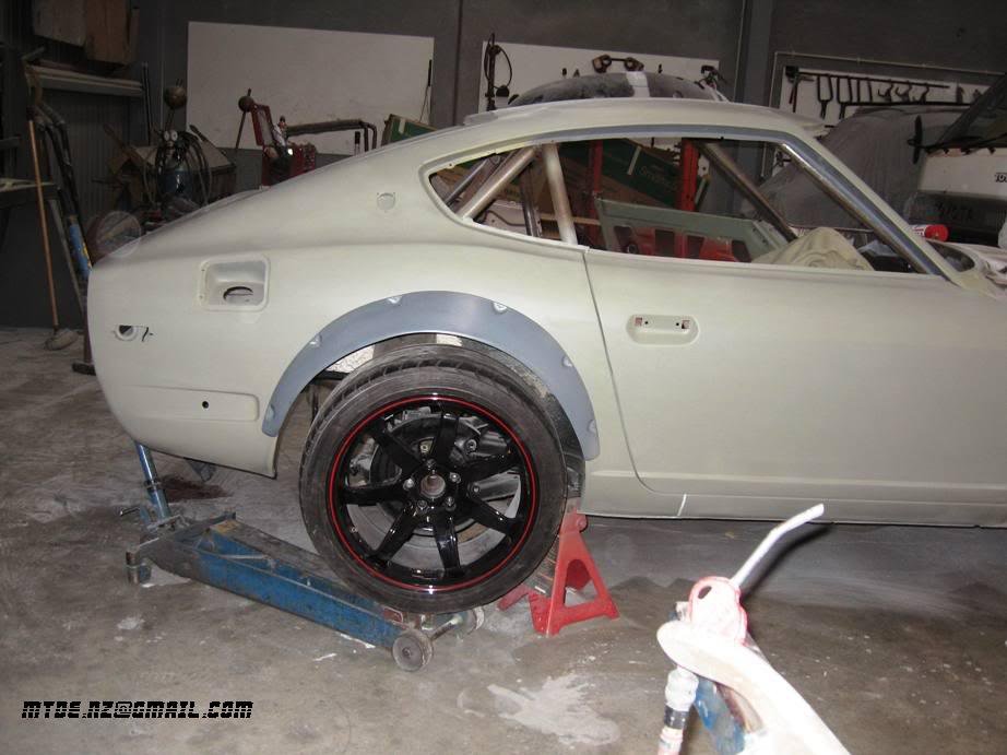

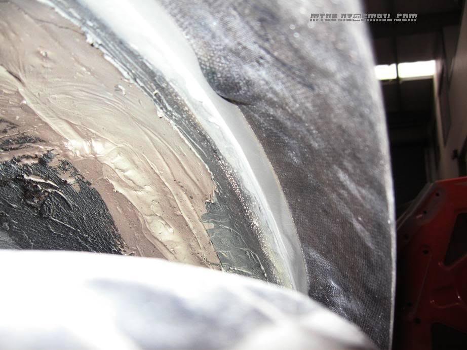

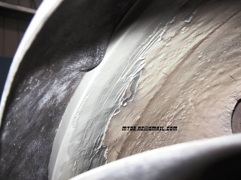

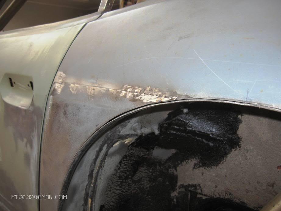

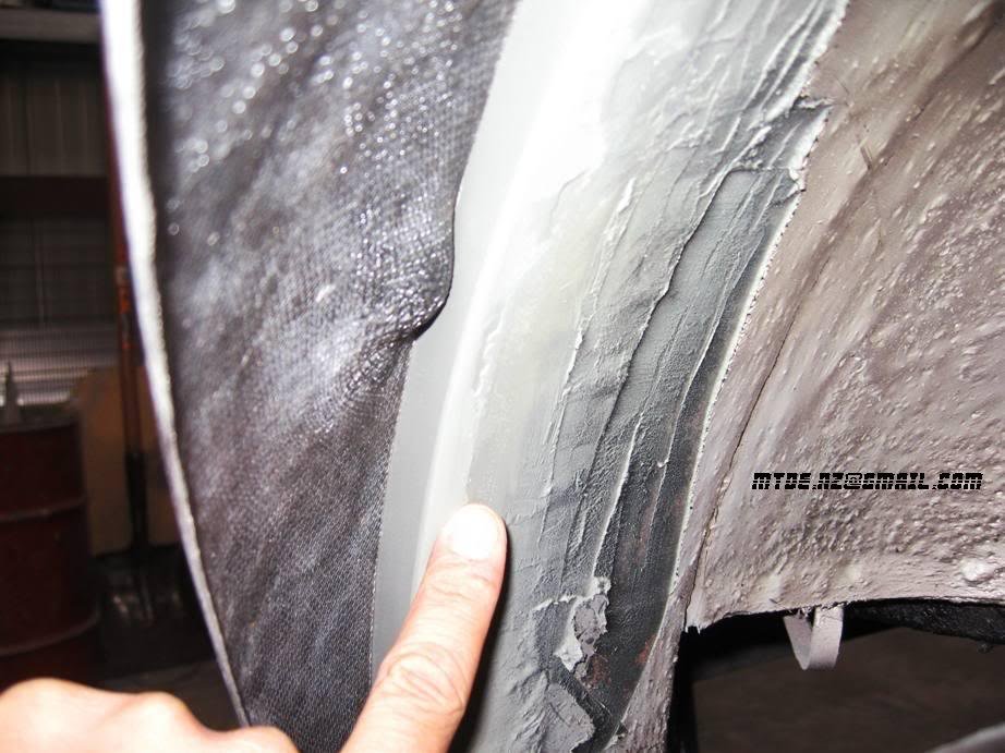

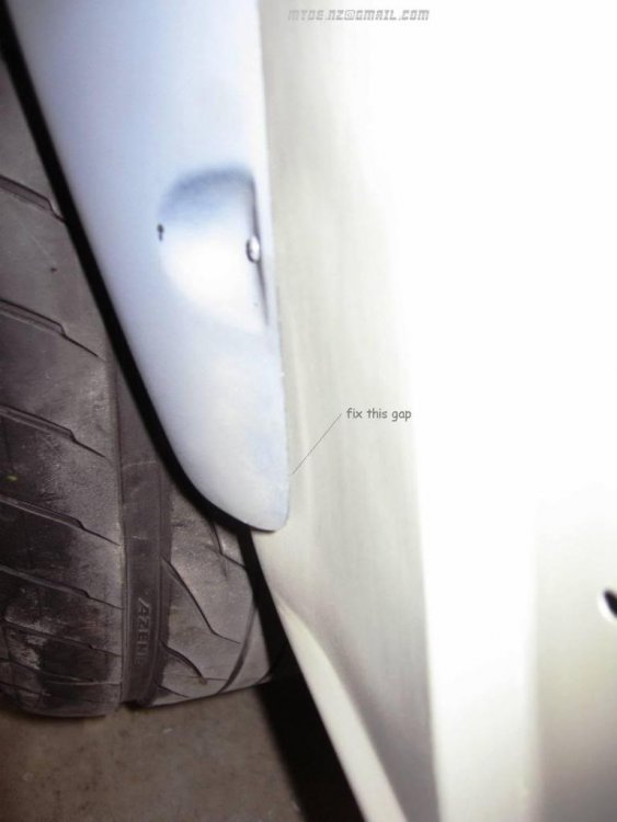

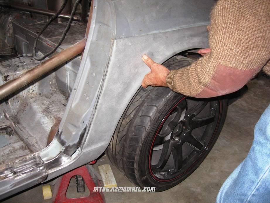

Arches at the rear. Folded lip flat, and butt welded again, so that the inner arch comes flat. gives the tire more clearance. if the chassis hits (not gonna due to bumpstops etc) the tire wont be hit with a sharp edge of the gaurd. ie. no crazy high speed blowouts  from this scenario.

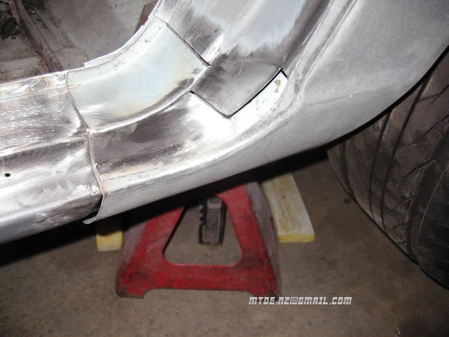

One side of the (metal) car almost complete,
The rear end is looking 50% done.
Ill get the sparky to wire up a solenoid for the hatch release/lock.

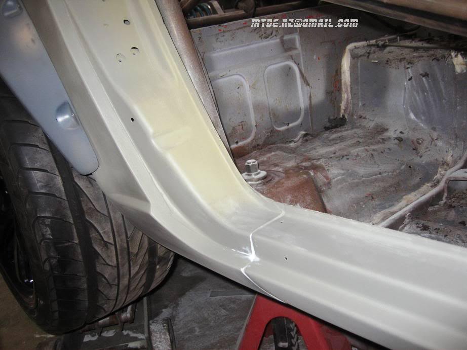

Left side has started, but requires the fundamentals.

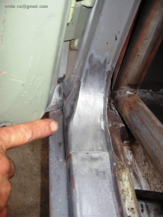

Nice section constructions around the pillar. Nice butt welding on the door.

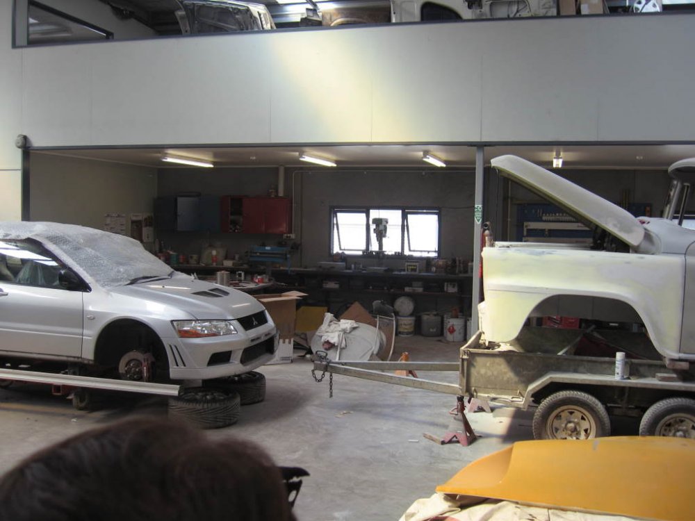

The panel beater fellow is a pushy bugger, so its off for another epic drive to hand over parts that are requried to help work on the next areas.

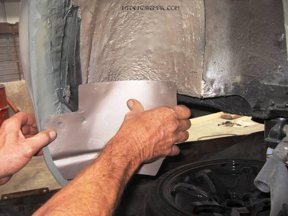

Thanks to Glenn for the gaurds, these will help take moulds for the front end work which will start next week. After a quick review today, it looks like as much time as the tin work has taken. ie. Quite a bit....

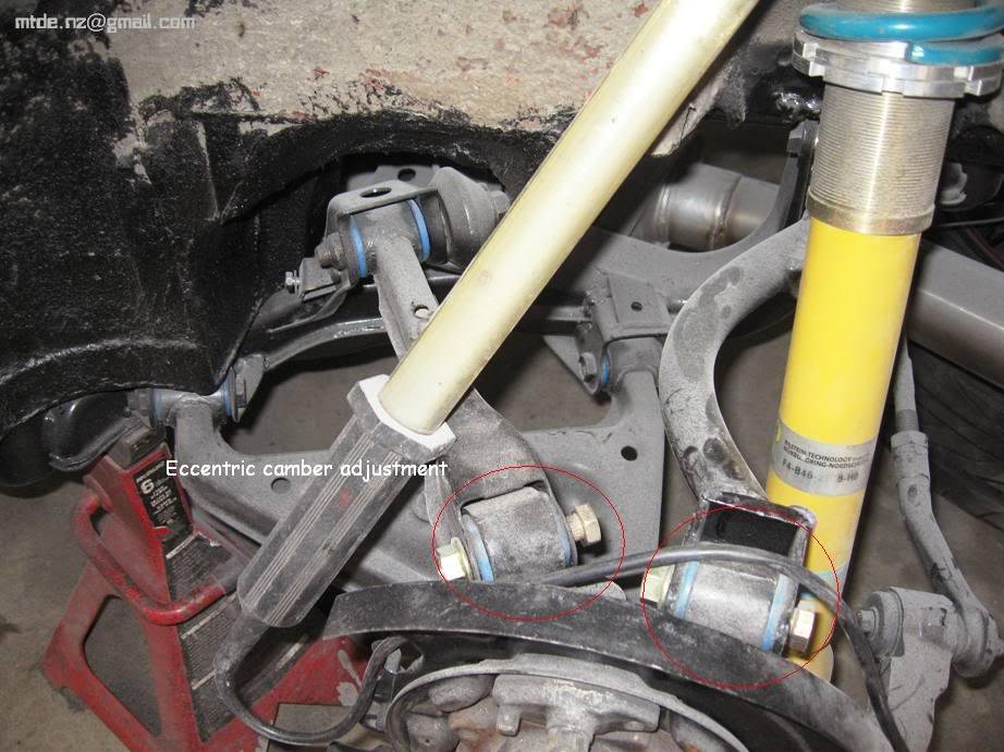

Here's a better pic of something I mentioned a while back talking suspension,
If the rear end still feels too mushy with softer tires at the track, the hard bushes you see may get replaced - rose jointed, etc.

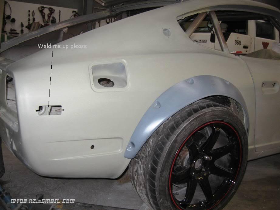

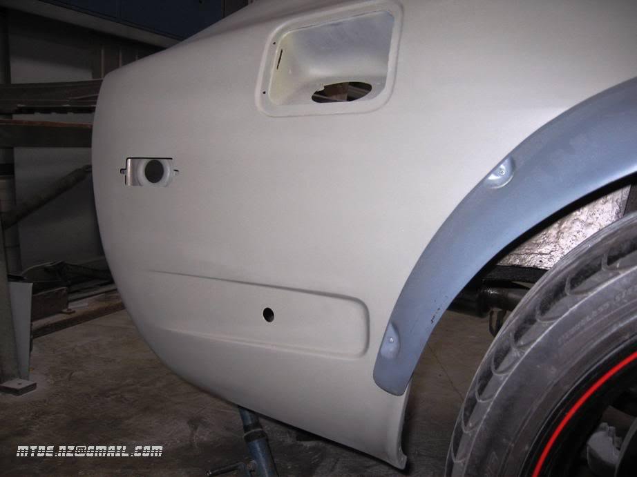

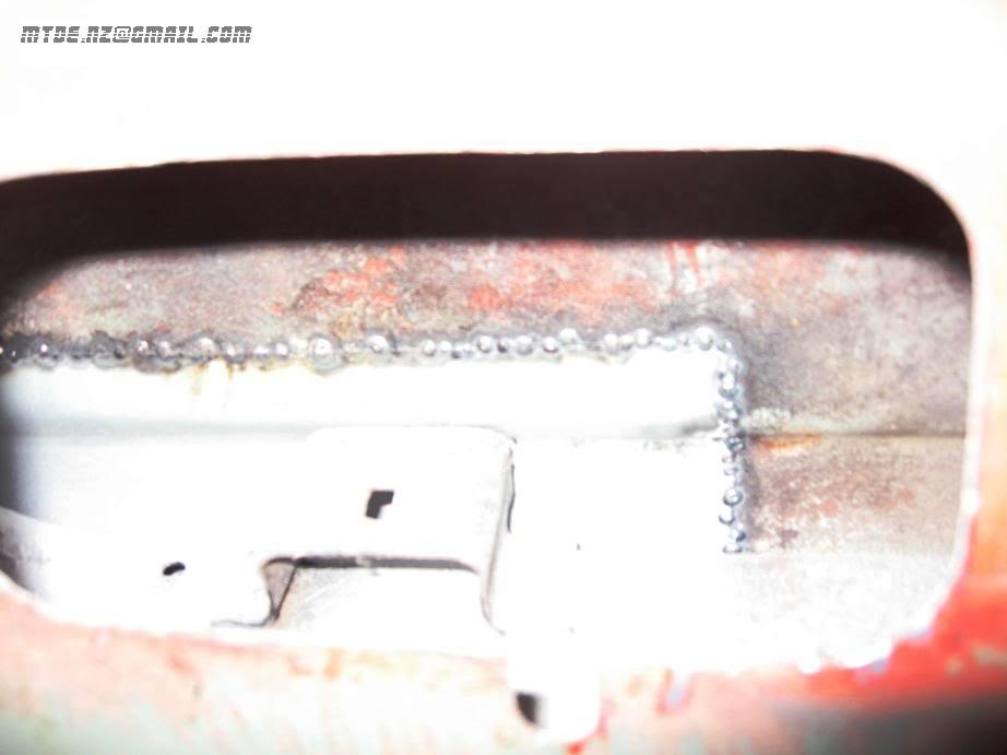

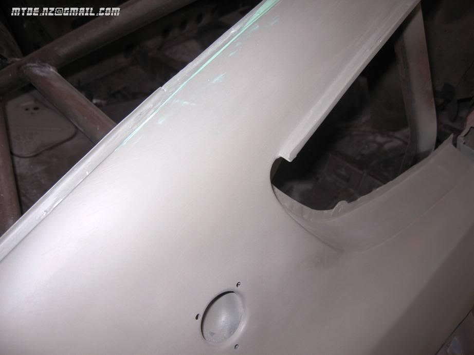

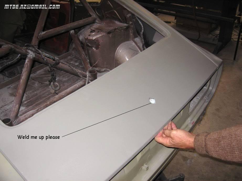

Indicator hole filled up. No warts here.
Hatch likewise with opening device.

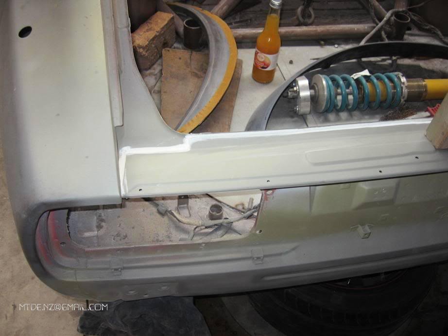

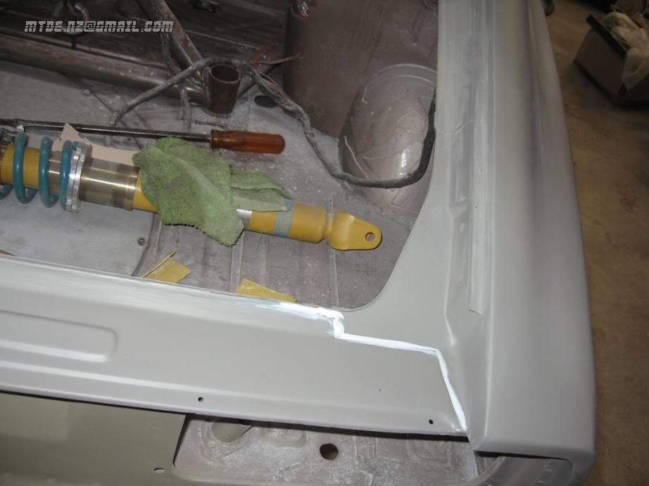

Dove tail hatch area all done & sealed

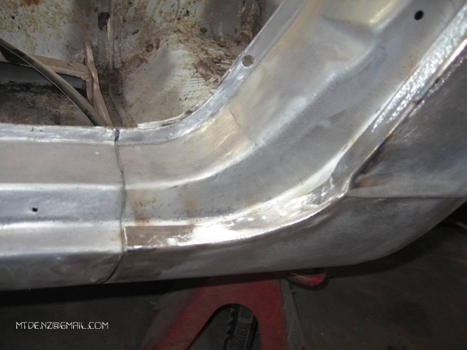

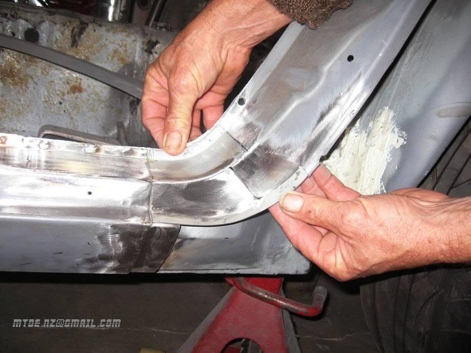

Left hand side continues, almost there. Rear quarter replacement panel originally from Tabco, some USA outit. Not much went back on the car.

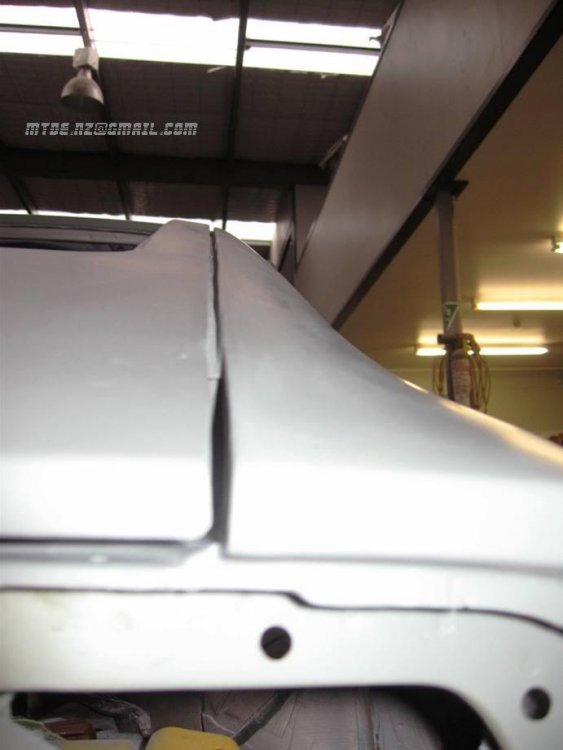

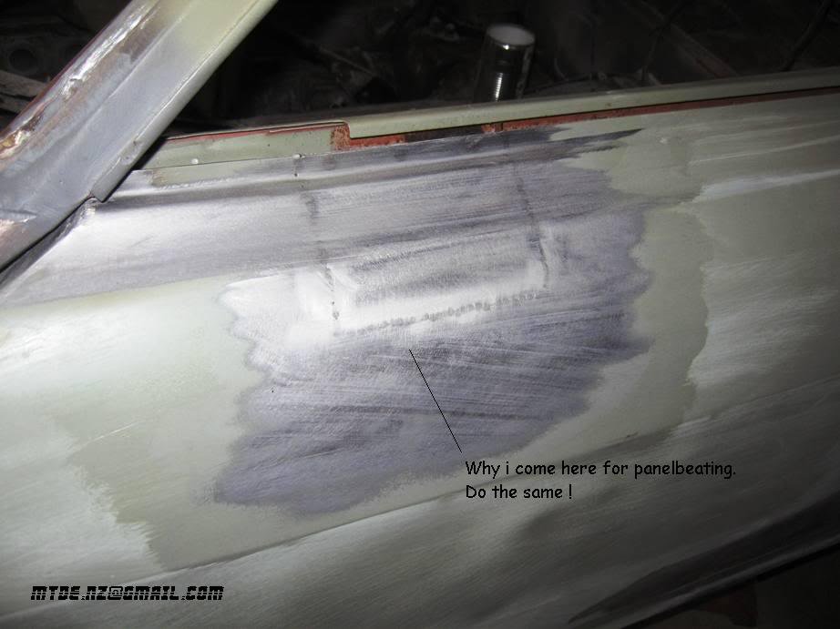

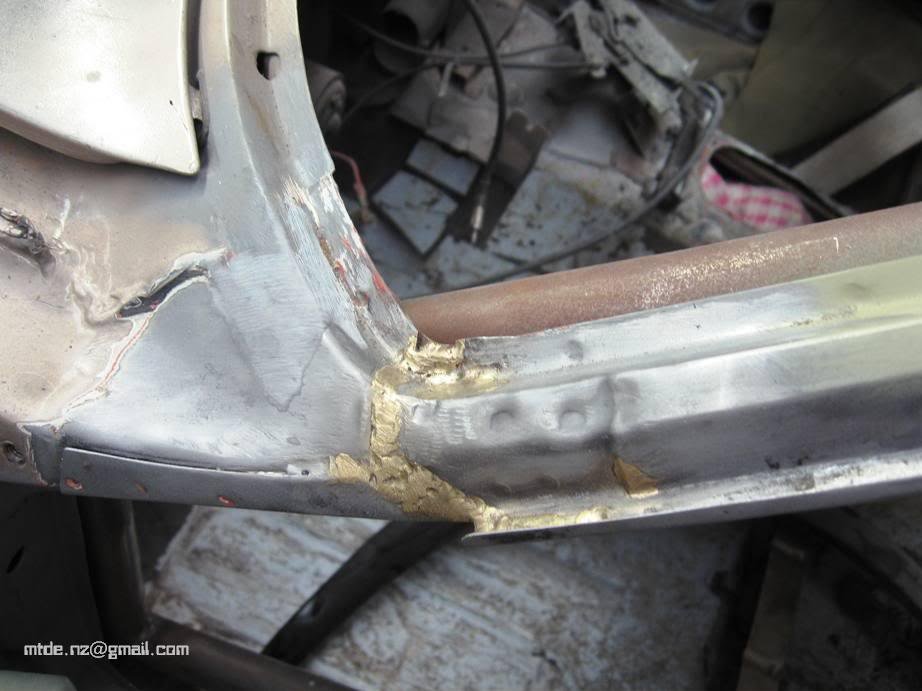

The front pillar needed a bit of love, so love applied.
Few other parts/areas furthered
That is about the 3rd zed I have seen in 09 that needs/is getting rust work on the front A pillar. Must be a water trape or just that cutter thing cracks and water gets in = rust :(
