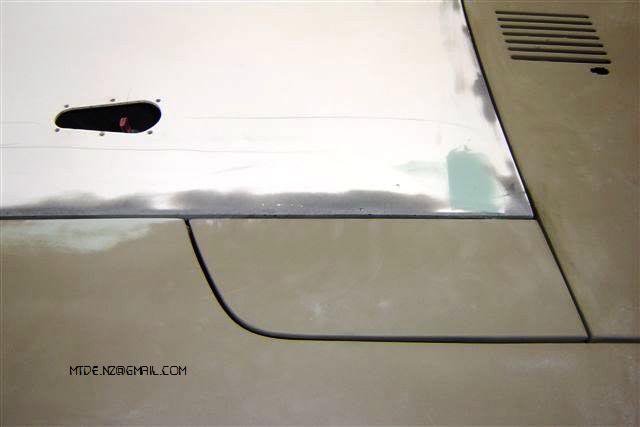

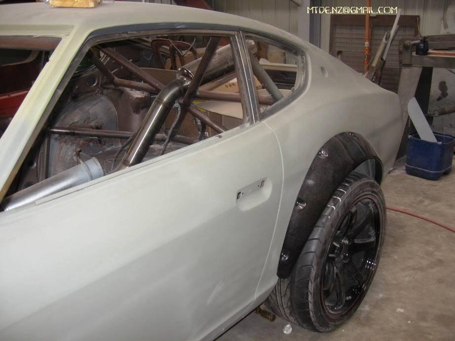

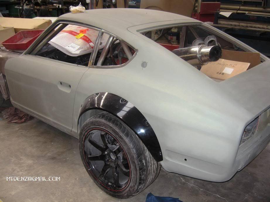

right side still ok, just needs the gas flap keyhole welded up
Note that window chrome & SS into position. Had to move a couple mounting holes for the rear quarter glass windows, as cage fouled chances of getting a screw in......unles your hooked up?    Save it.

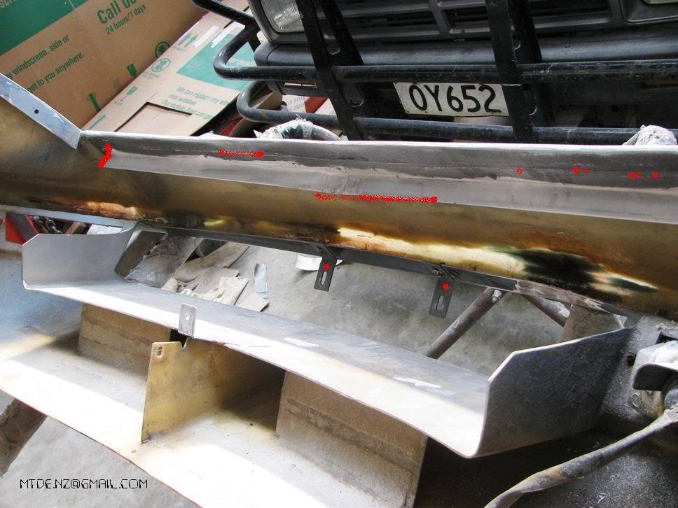

Few other issues at the rear.Did some costing of rear metal bar, take one dull but straight unit, de-chrome, weld up all exisitng holes and seams, straighten/smooth, re-chrome etc    =  $$$$
vs
buy new glass bar and paint a colour
and sell old dull bar.
no contest. Plus minus many kgs, pity its the wrong end eh.
I can break many glass bar before asking for mr dull chrome back.

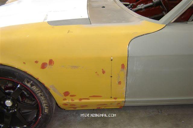

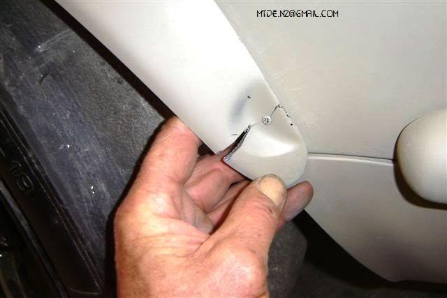

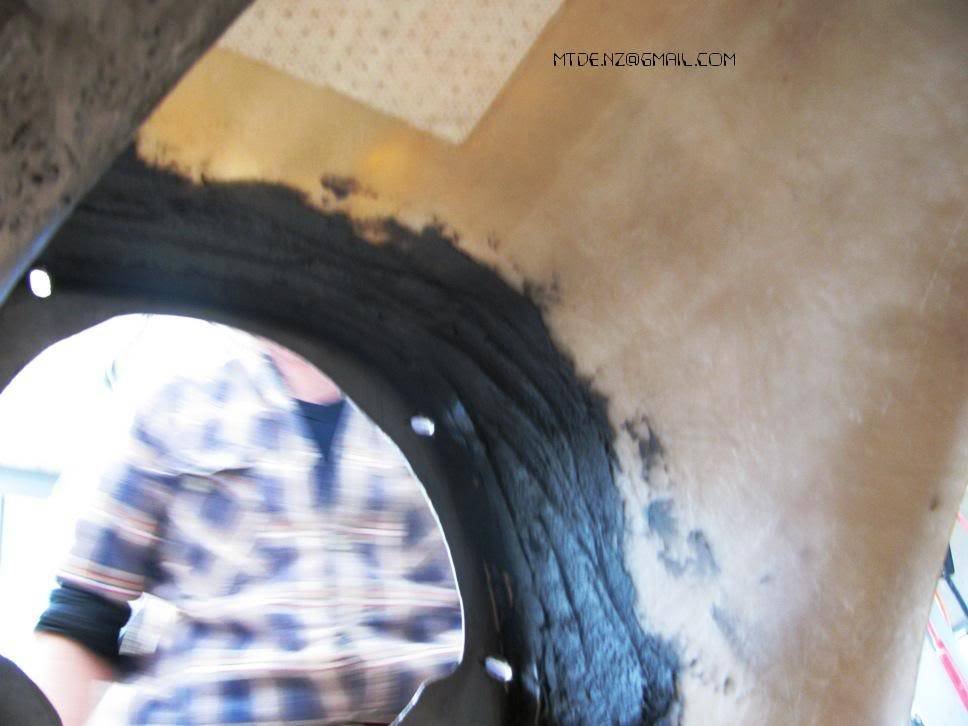

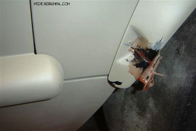

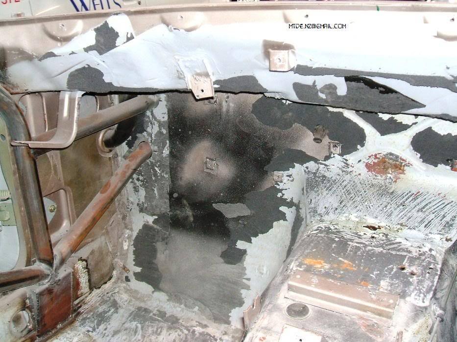

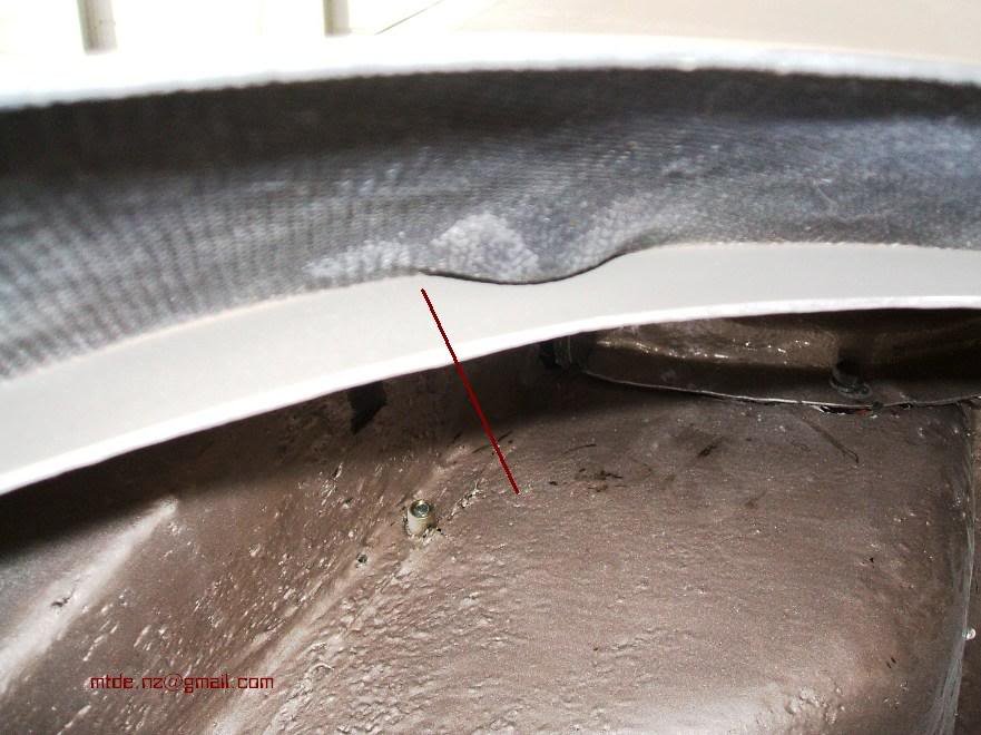

This pic is to note. What is going on here. Surley a clean body cant be painted with a skin looking like the close up of the moons surface?
BEADBLAST approaching. A new step added to the build. Argh well....I might get back 1/20th of it upon sale price.....

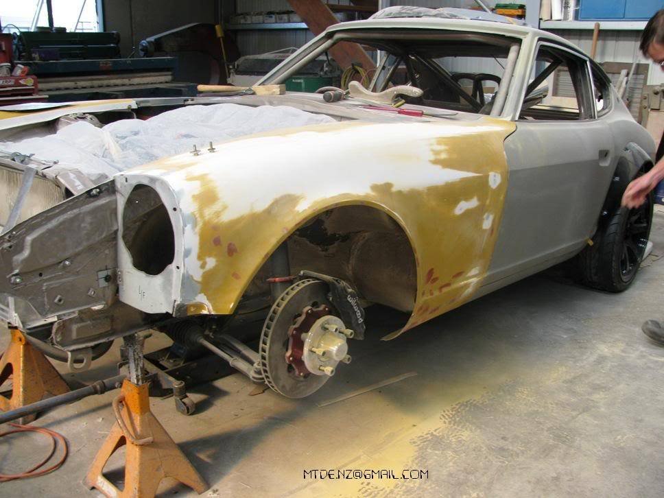

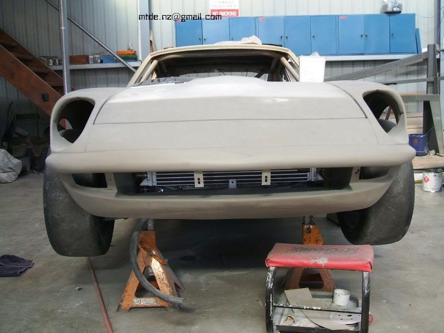

As mentioned, the chrome bumper has been axed in favour of a glass unit from japan. chopped for cheaper postage reasons. Still has bolts and seams molded into the glass version. Odd. They will be smoothed over.
Hard to see, but I borrowed Glenn MArtins front spare gaurds and copied the rearward support for the glass gaurds on mine, as they lacked sufficient support close to the door. Feels solid on the car now. The front wupport looks way out, but a little shaping and urethane will sort it.
I picked up a pair of racetech wide's in glass with Ally mounts from Mr Black in Chch, who has helped with a great price. Seats were fresh off the press and sent that day. They fit me well, but not the car well. We will remove all the exisiting seat mounts in the S30 chassis, and look to make a section of floor lower than the rest, so my head&helmet has clearance to the roof. Ill detail this next time. The steering wheel is close enough to me, probably not requiring movement rearward, or replacement with a dished wheel.
A sliding rail will sit below the alloy side mounts to give some fore/aft adjustment.

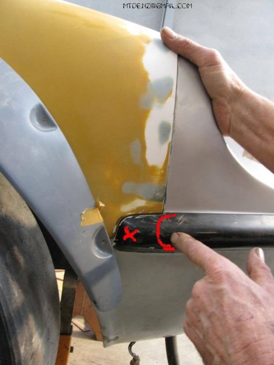

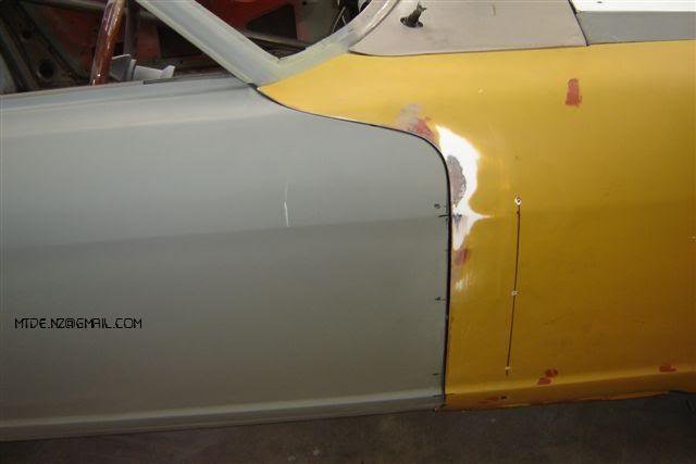

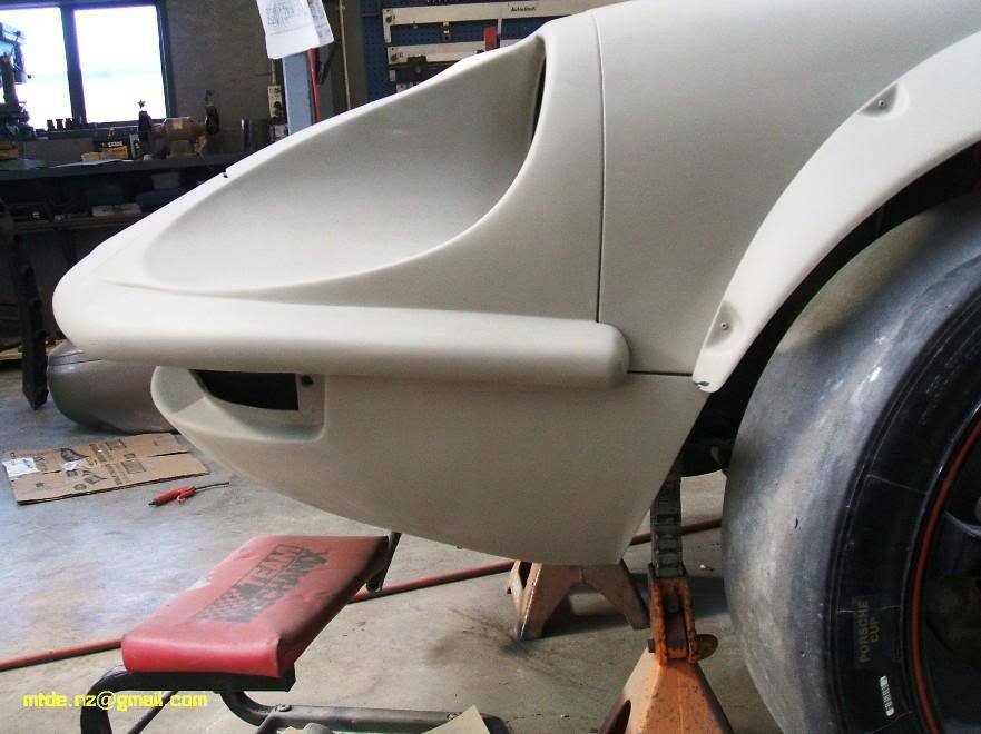

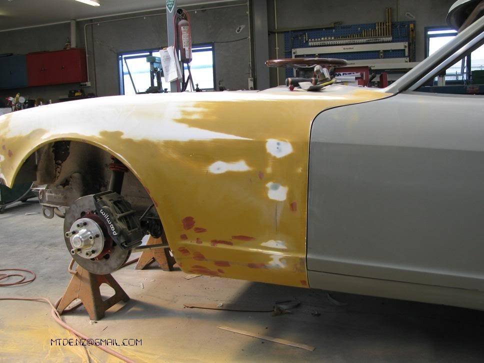

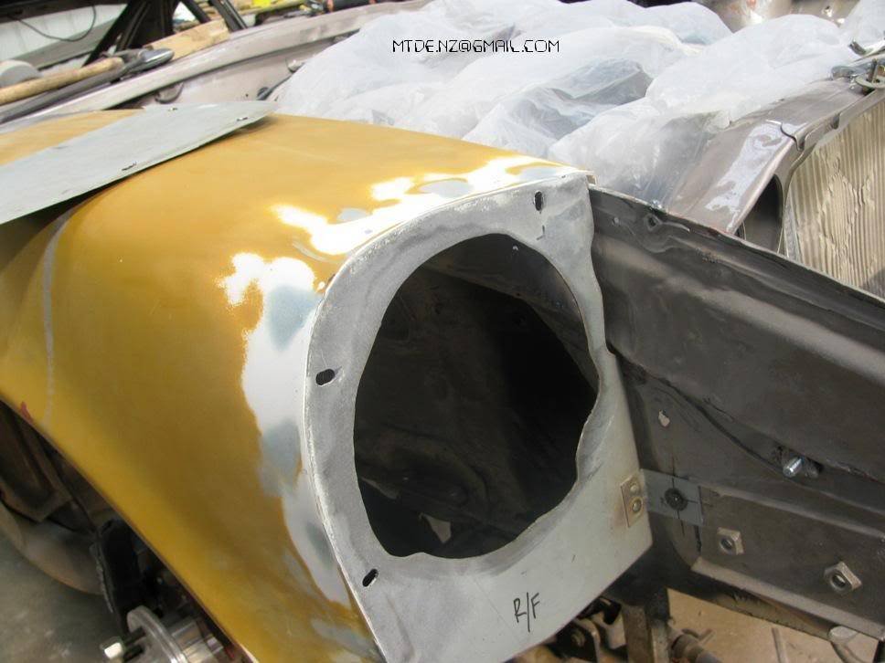

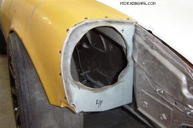

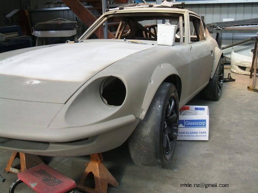

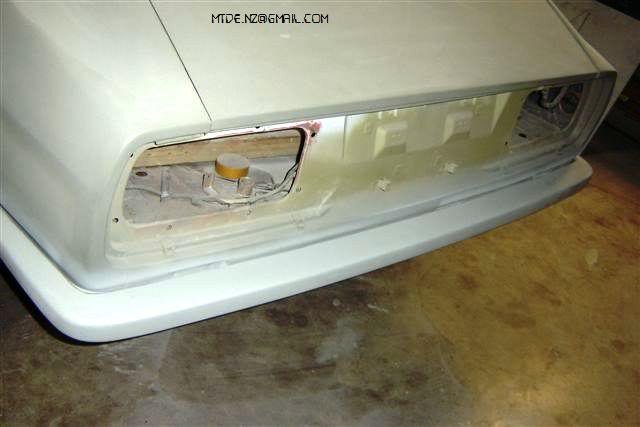

The front gaurds had no face to bolt the headlight buckets to, so a steel equivalent was made and joined to the gaurds, bogged over. This will allow me to run the stock lights, buckets, chrome rings for the factory look.

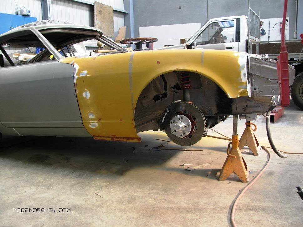

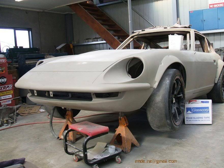

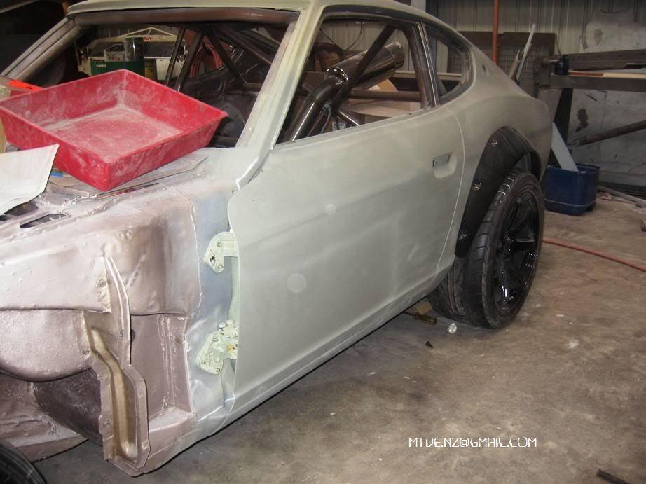

The gaurds are on and shaping work started. They need more work around the lower edges, but generally there.
What an effort tho, chopping up the steel units would have been easier. Need to move that front bumper edge away from the flare, its too close.

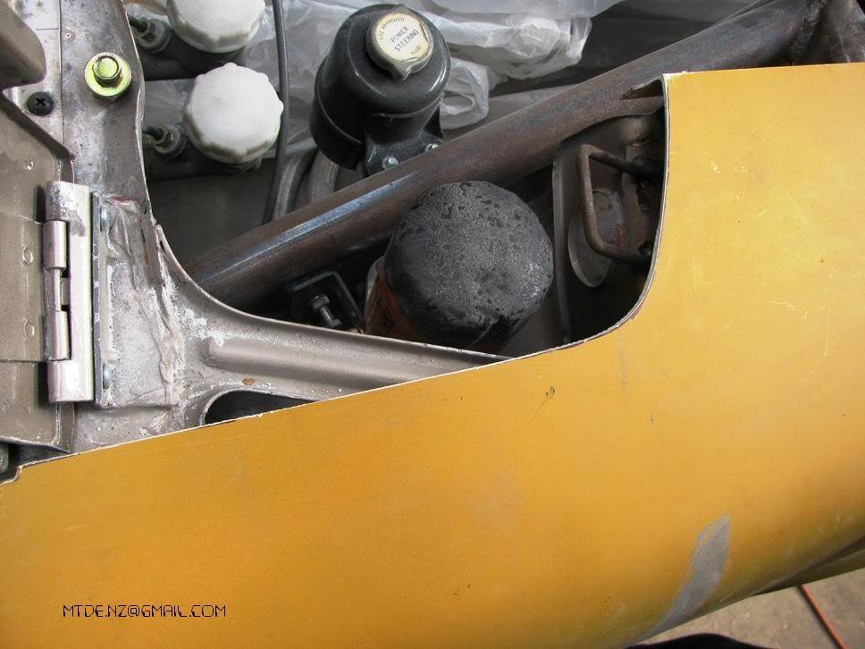

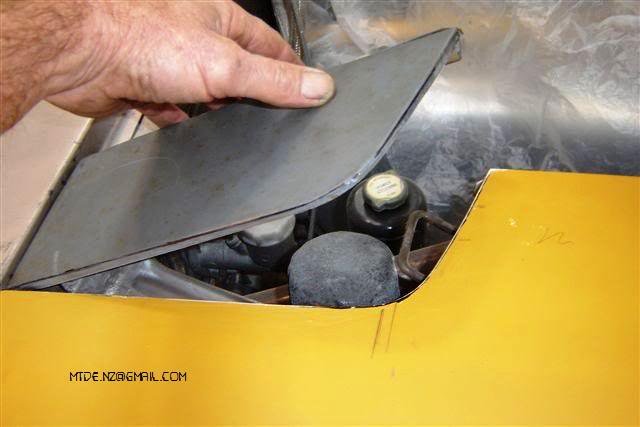

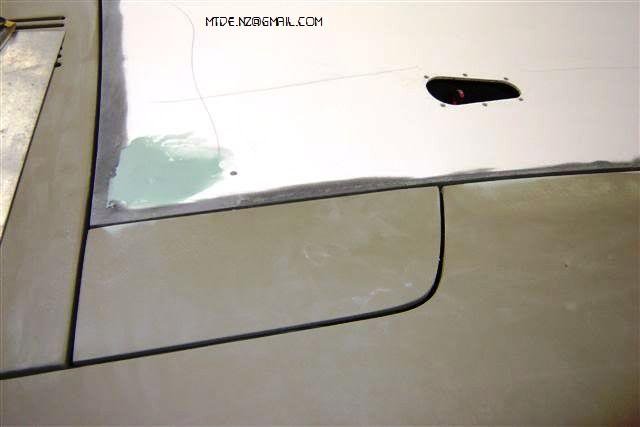

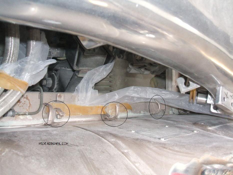

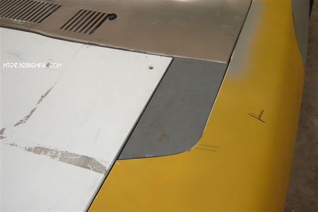

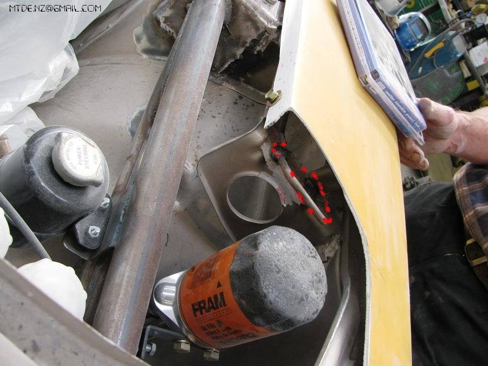

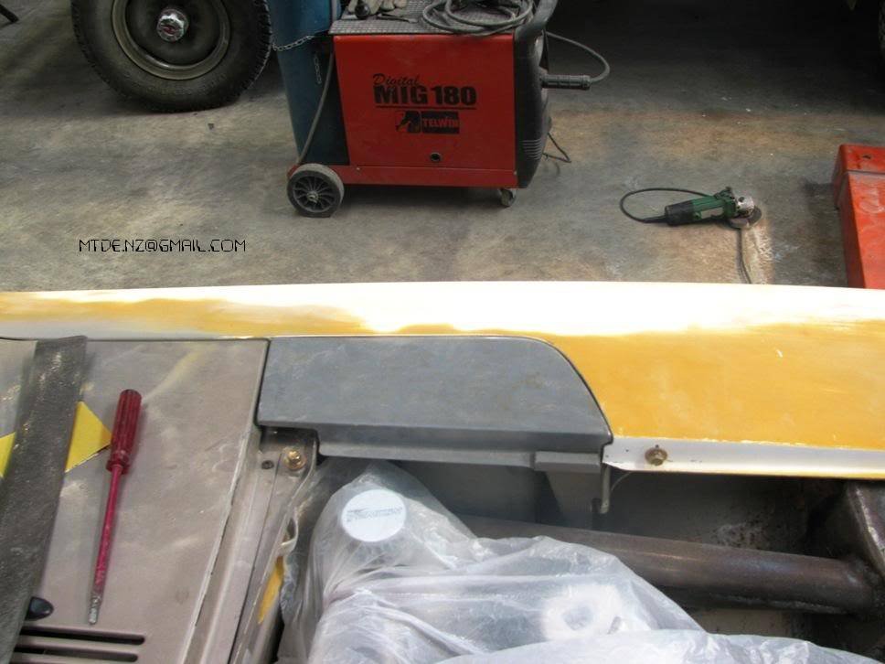

Inspection flaps cut back in. We had placed an oil filter and washer bottle accessible under them, so thought Id better get the flaps back in. Cut/place.
A new catch has been made - area in red in pic.

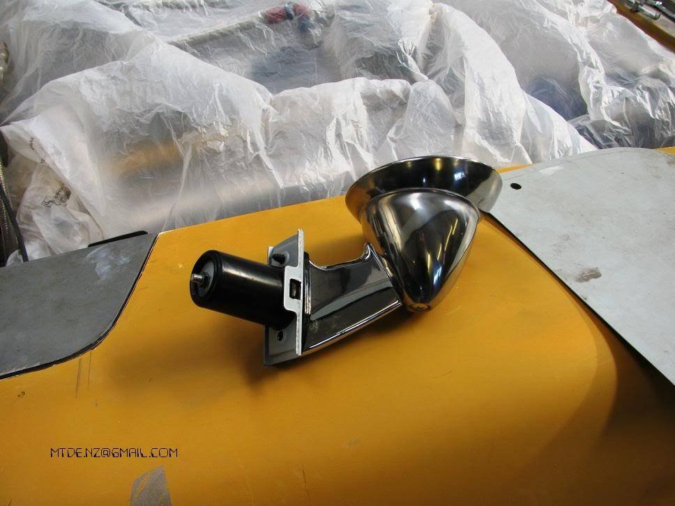

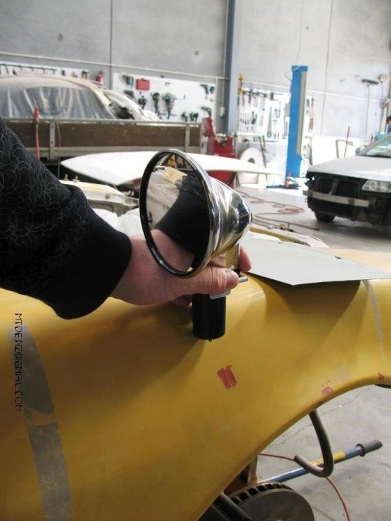

New old stock chrome S30 mirrors from Japan.

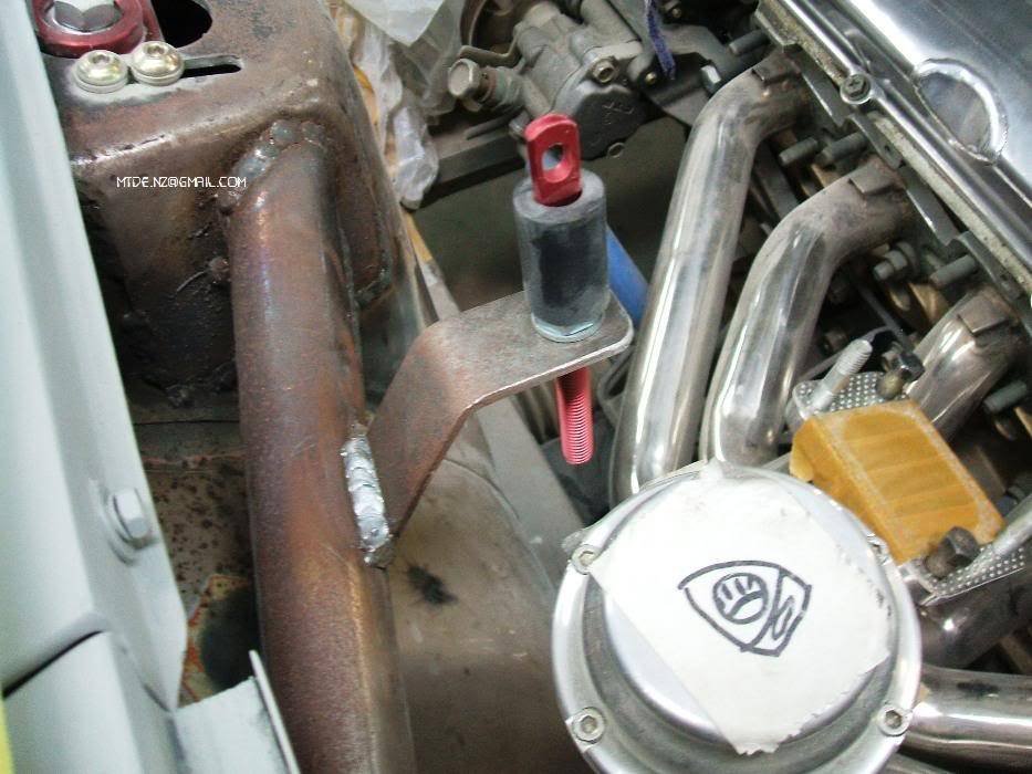

To avoid the bonnet pin crap look, aerocatch install planned. Since the bonnet has its structural rim on the underside that covers over where I was planning to put them, another catch will be made, similar to the inspection flaps closing mount. Thye are lockable, fit almost flush, and seem to look OK on other customs Ive looked at.

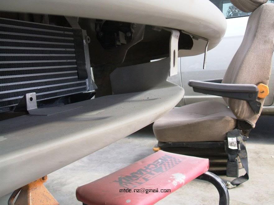

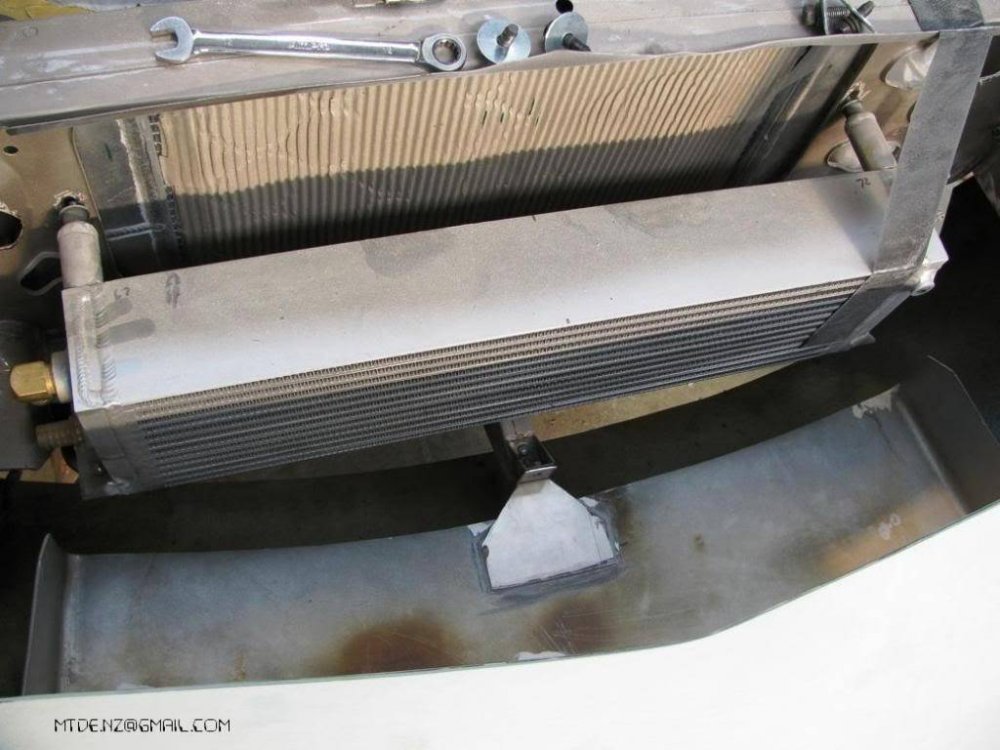

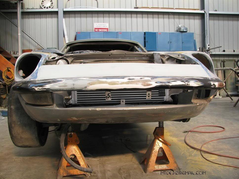

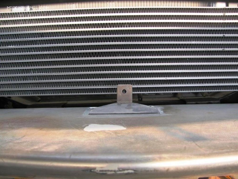

The front requires some 'air giudance equipment'. i.e. make sure we get sufficient airflow across the desired areas, its a pity the bonnet swings back into it all when opened....

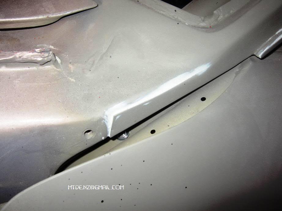

The front inner part of the nose has been strengthened up, as it wasnt able to support itself in the right shape. The numberplate mounts will go.

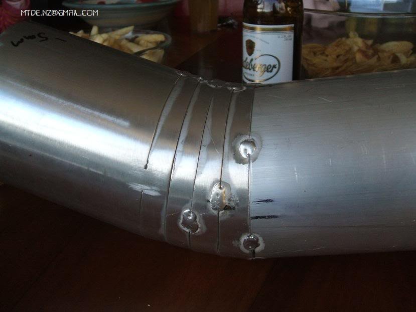

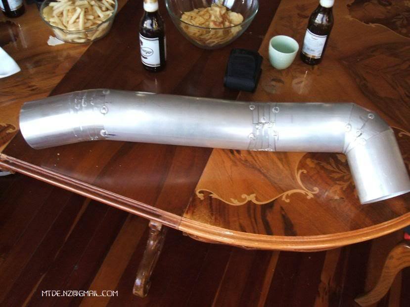

A mate came round and showed me what he's been doing in his spare time, over a beer and grub.

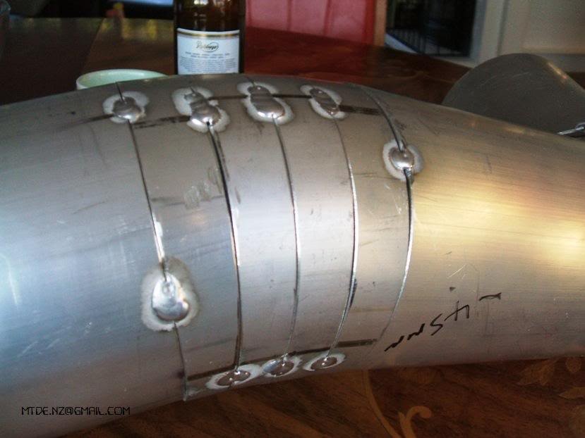

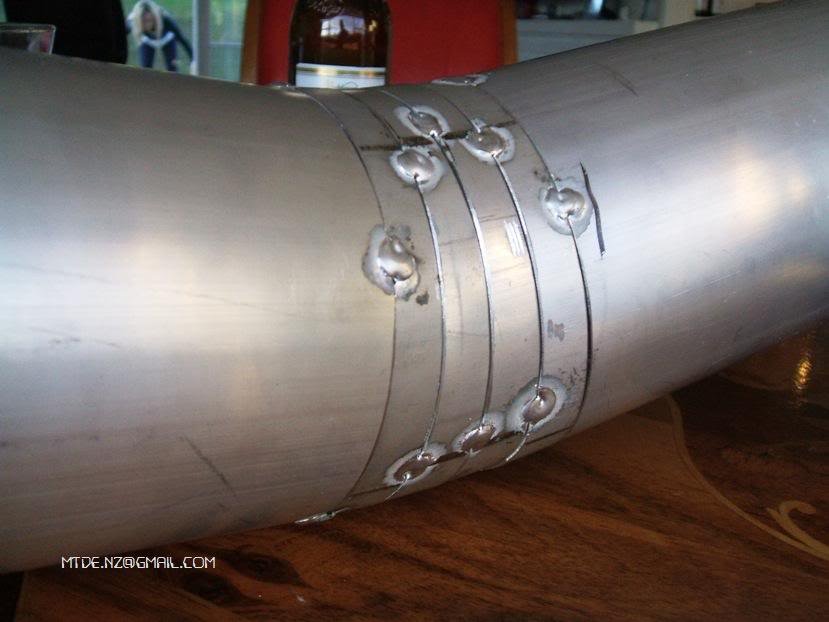

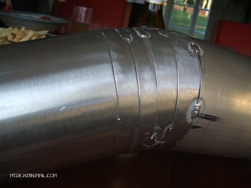

Its the intake pipe ( air filter to turbo intake) I wansnt 100% with, Im looking for the japan style many welds look It would do very little to airflow vs pressure drop over the original 'digital' version, 45 degree angle styles.
Looks smooth, and is a mock up. Test fit it today and works ok. We might swing the air filter horizontal, rather than up/down, being the only change.
this looks shizen
this looks ok

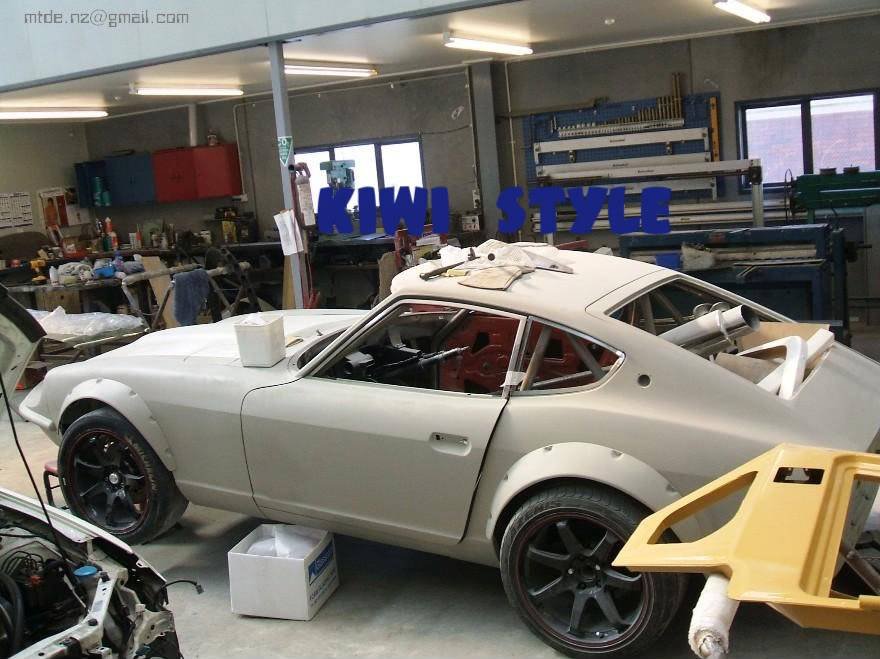

Let it be known that the reason that I went with the G-nose is that the misses reckons 'it looks classy' (compared to original front with spoiler).
The g-nose looks like a frogs face, its long and the overhang over the front wheels can look too much. With chrome headlight rings/covers and mirrors I'm hoping it balances out a little.
Ultimately I want someone who knows NOTHING about cars to look at it and say, 'beautiful car'. It'll happen more often with the G-nose, after some quick (mostly female) market research.

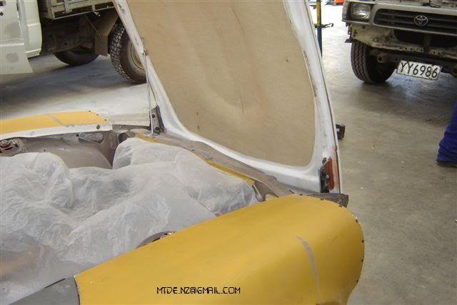

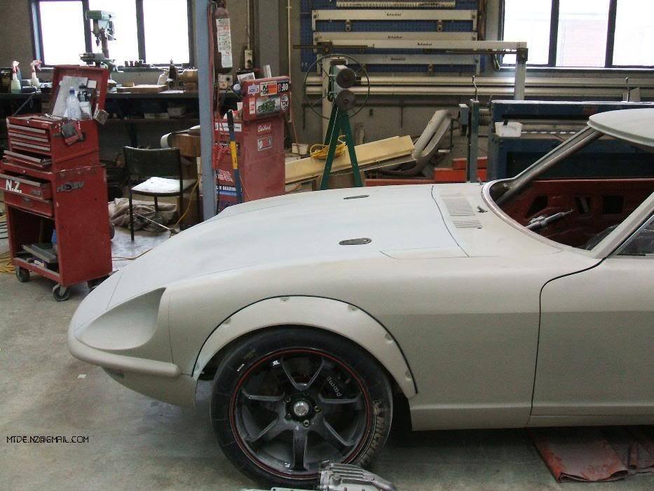

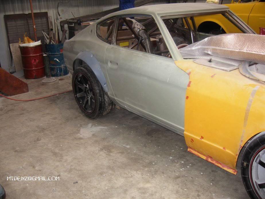

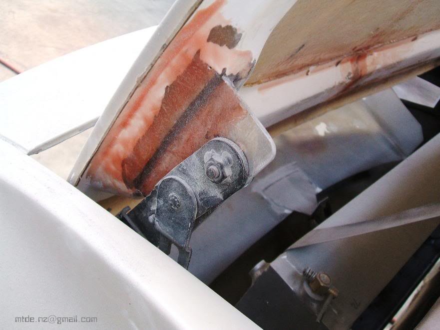

Bonnet is on and some cutting and repositioning of the frame has been done. It needs more work to straighten up the shut lines.

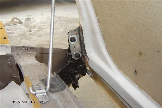

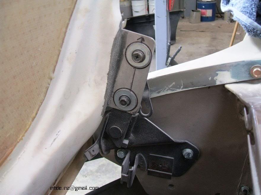

Catches are next. G-nose hinges were part of the G-nose deal from Kapiti Mike. Hinges are single pivot, not double like the standard ones.
Areas to further tidy up;
Gaps;
Some fat to trim, under front guard;

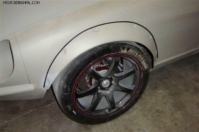

Arches looking the part, kiwi style
some more stuff to chop out, all the tabs gone please.

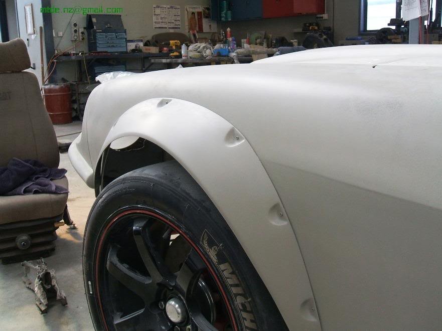

if by guards you mean flares, then i'm pretty sure the rear ones are wider than stock

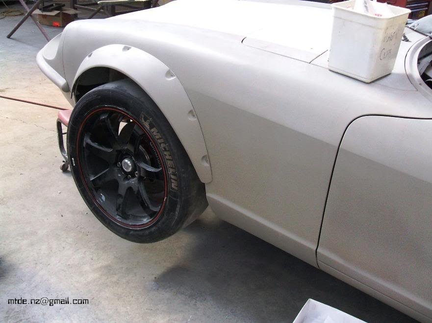

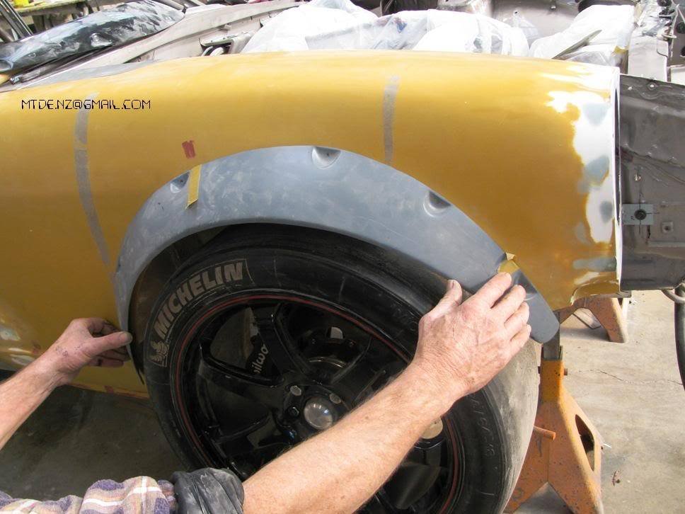

Ah yeah sure, the flares are wider than standard zg's.
These Super ZGs are approx. 3 5/8" wide flat on the ground laid out, compared to the normal rear ZG version of approx. 2 1/4” flare. That’s  1 3/8" more width.
  • 1 month later...
Both front and rear zg flares on this car are wider than typical off the shelf items.

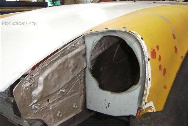

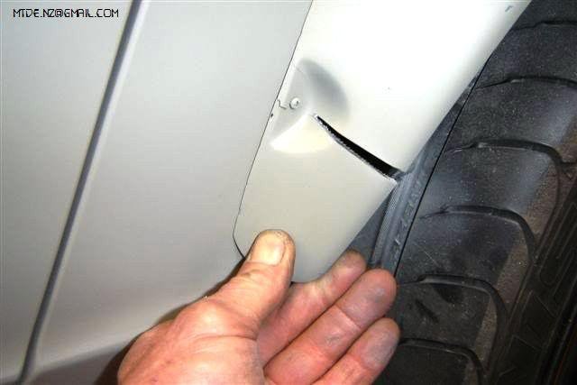

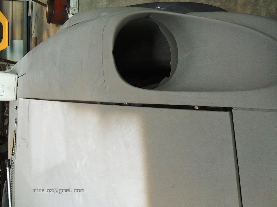

bullet proofing the headlight to gaurd area

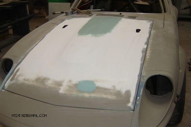

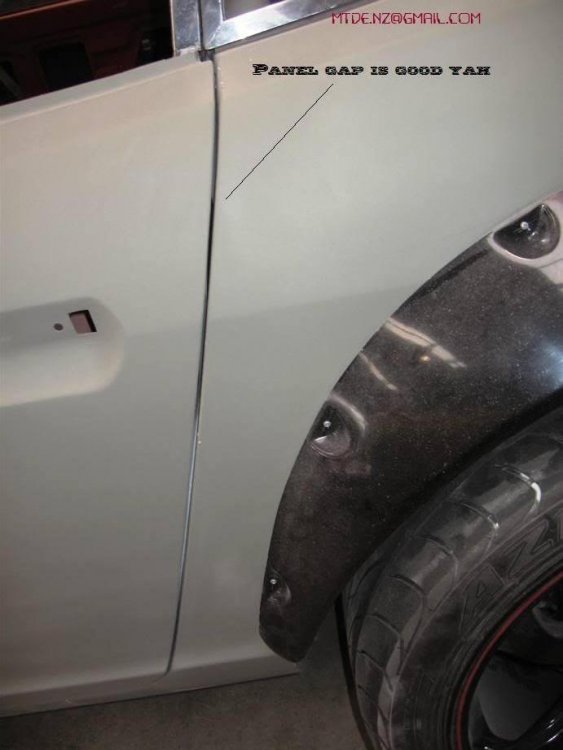

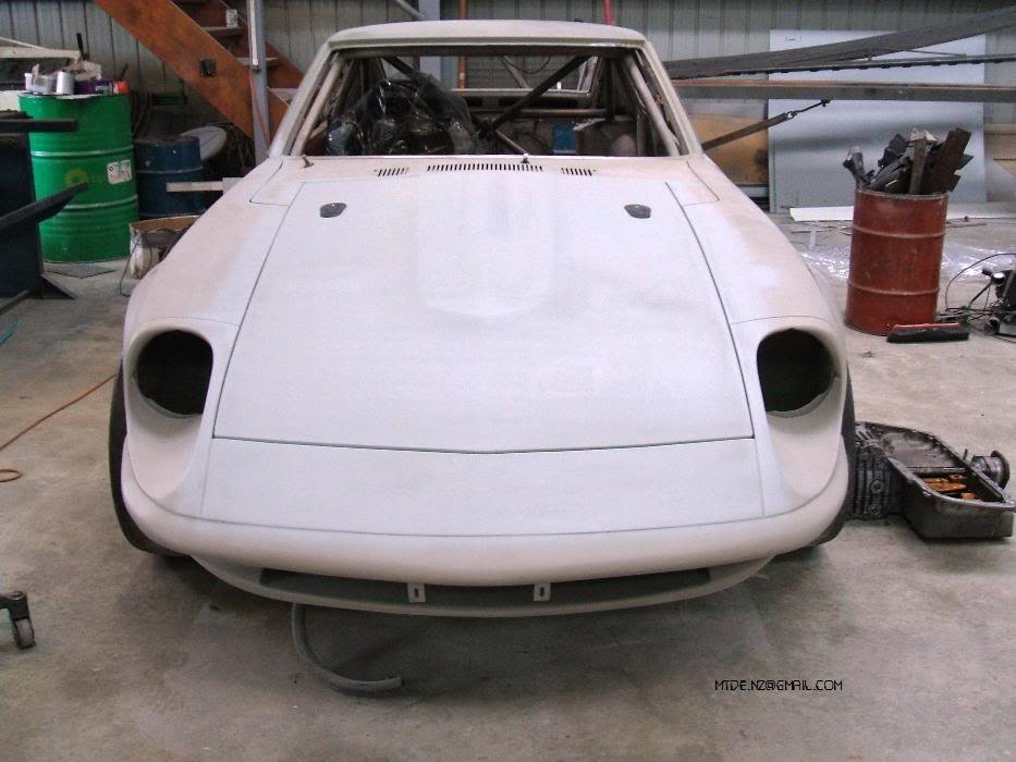

bonnet shut lines looking better

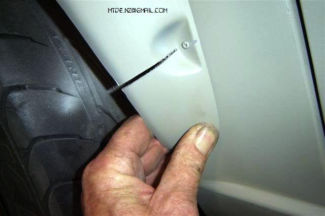

attach gaurd to inner support, more bullet proofing. Imagine this dodgy body kit peeling off on the motorway....

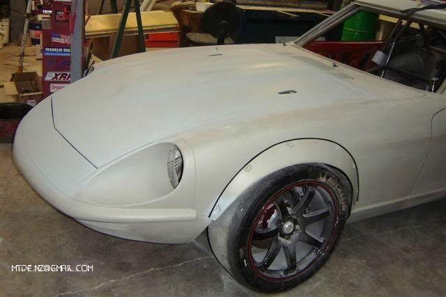

Bonnet looking smooth to the rest now

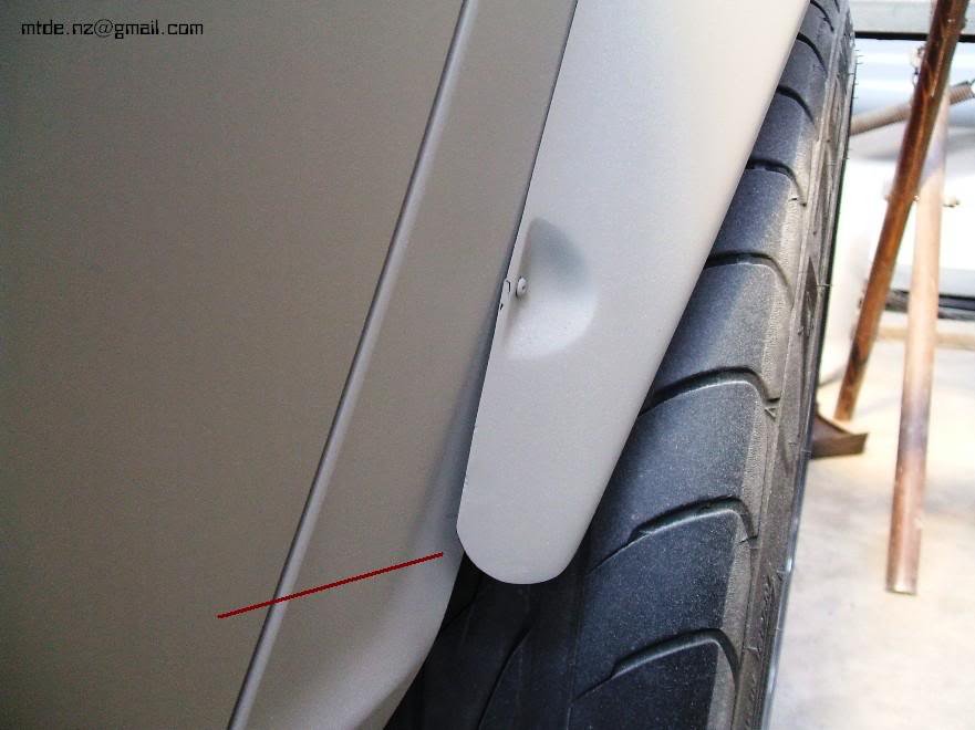

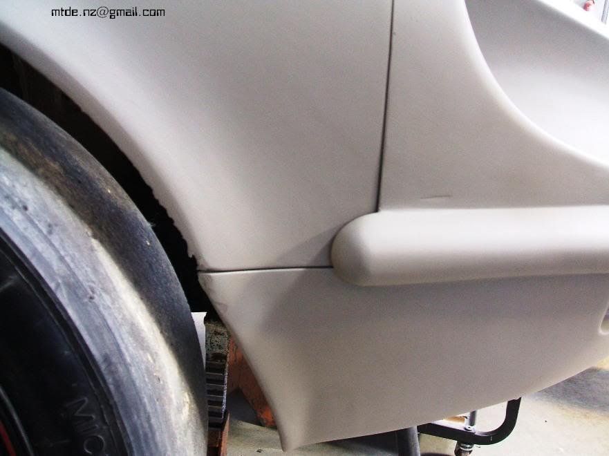

to fix the gaps at the end of the flares, we had to break a few eggs to bake the cake

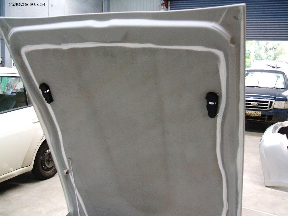

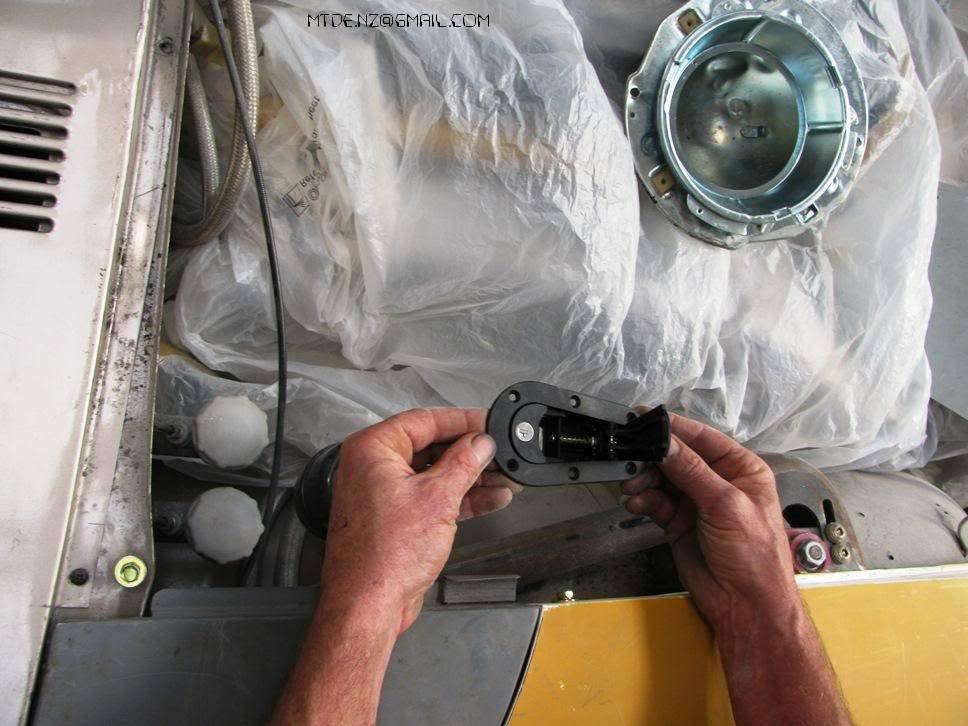

Bonnet catches in

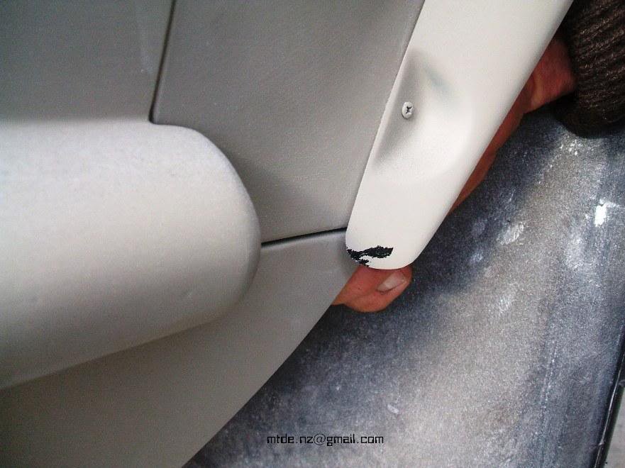

welting in for the front gaurd, looks kinda overkill, might look at some smaller profile stuff

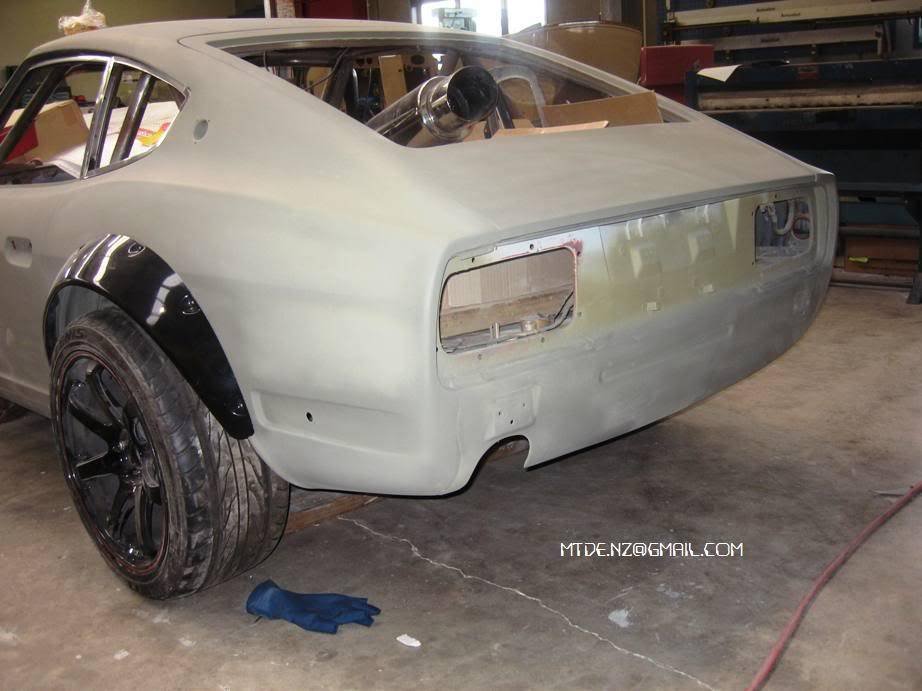

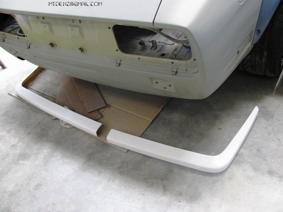

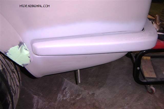

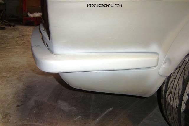

rear bumper in one peice and shaved of its lumps and bumps

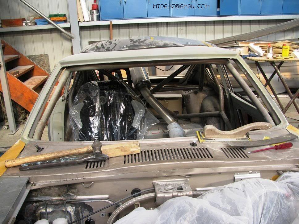

the panelbeater has finished the body now, the seat mounting is left, and a quick beating of frame rails under the floors and we are painting.

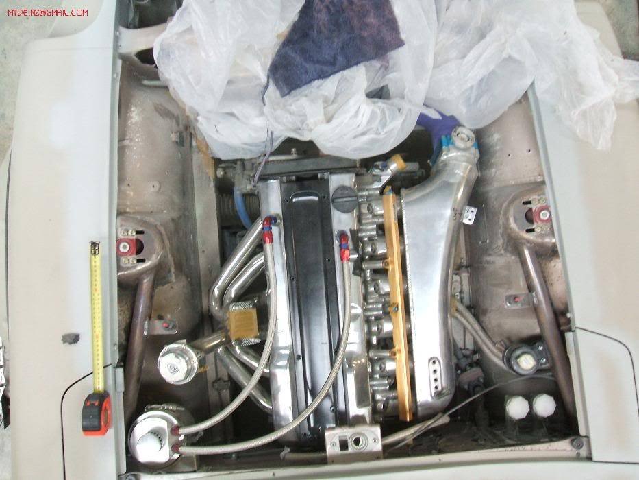

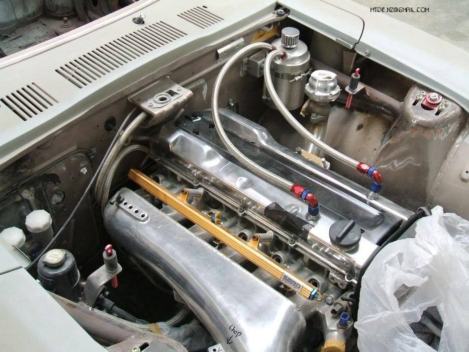

I will probably pull the engine out soon and get the engine bay tidied, since its had a lot of work done around there.
I think you'll probably find that looks much better once the colour coat has gone on the car - primer kind of makes it stand out a lot.

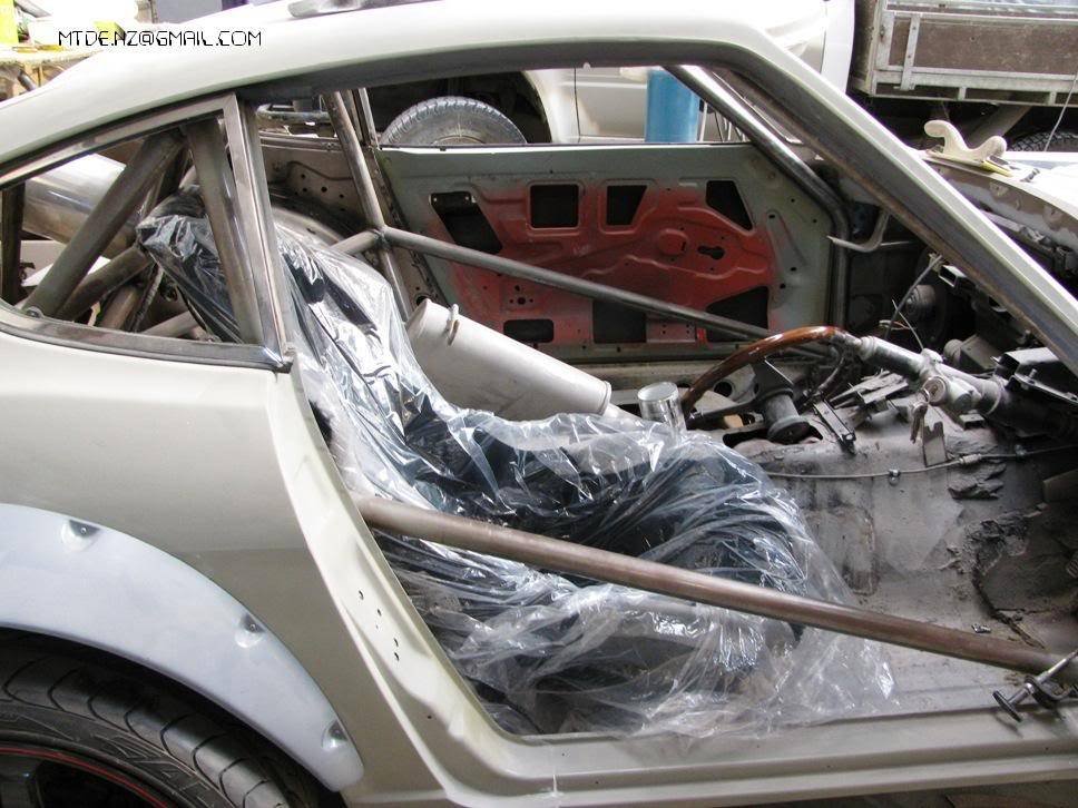

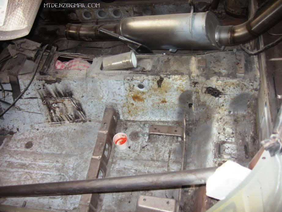

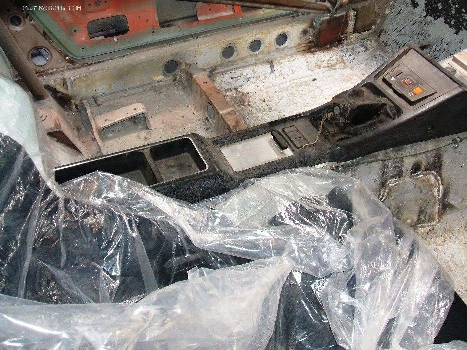

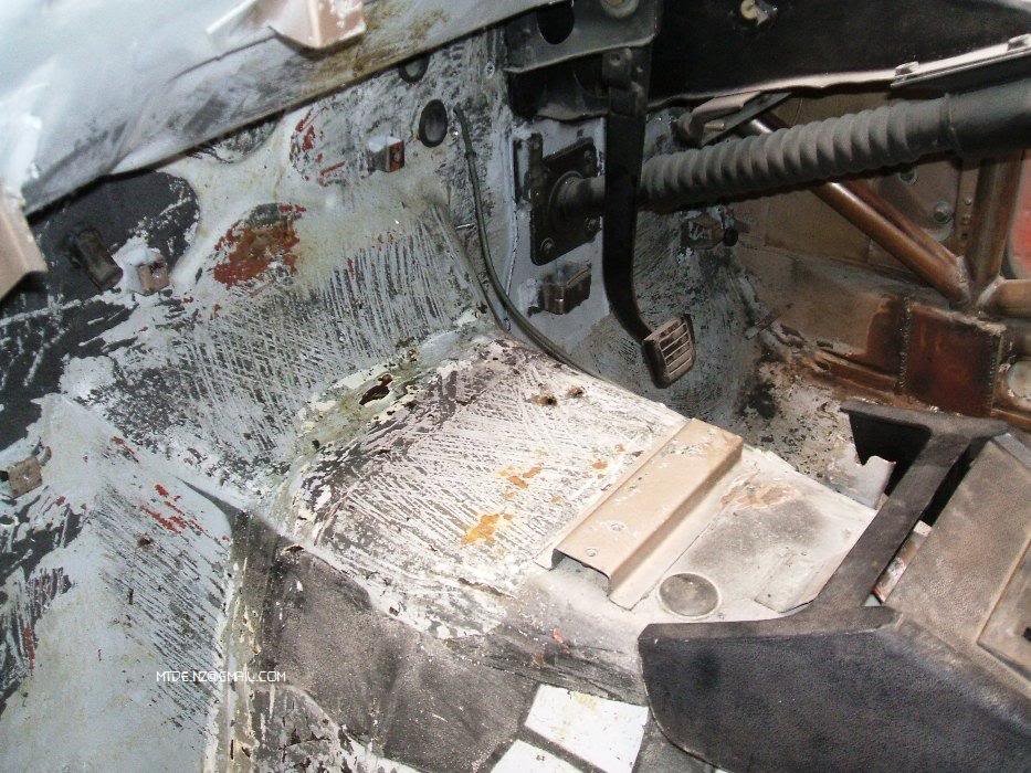

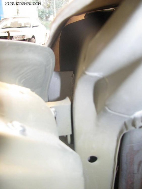

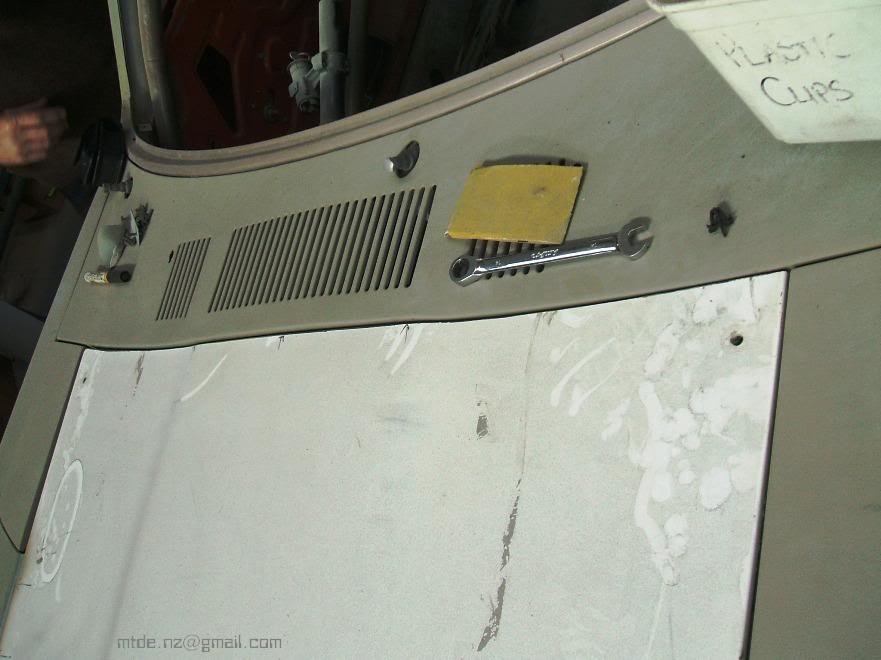

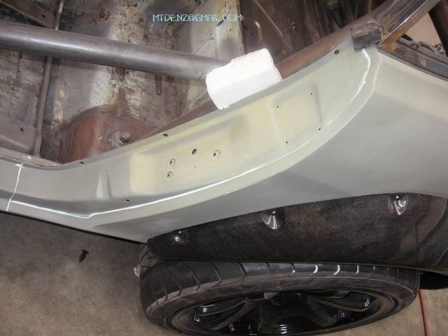

Spent a few hours tidying up the inside of the car, removing the 'not that old' sound deadening and foam stuff, so that the sandblaster can do its thing soon.
Gives us a chan ce to fill the multitudes of holes throught the firewall, tunnell, floors that have been made, and many not required.

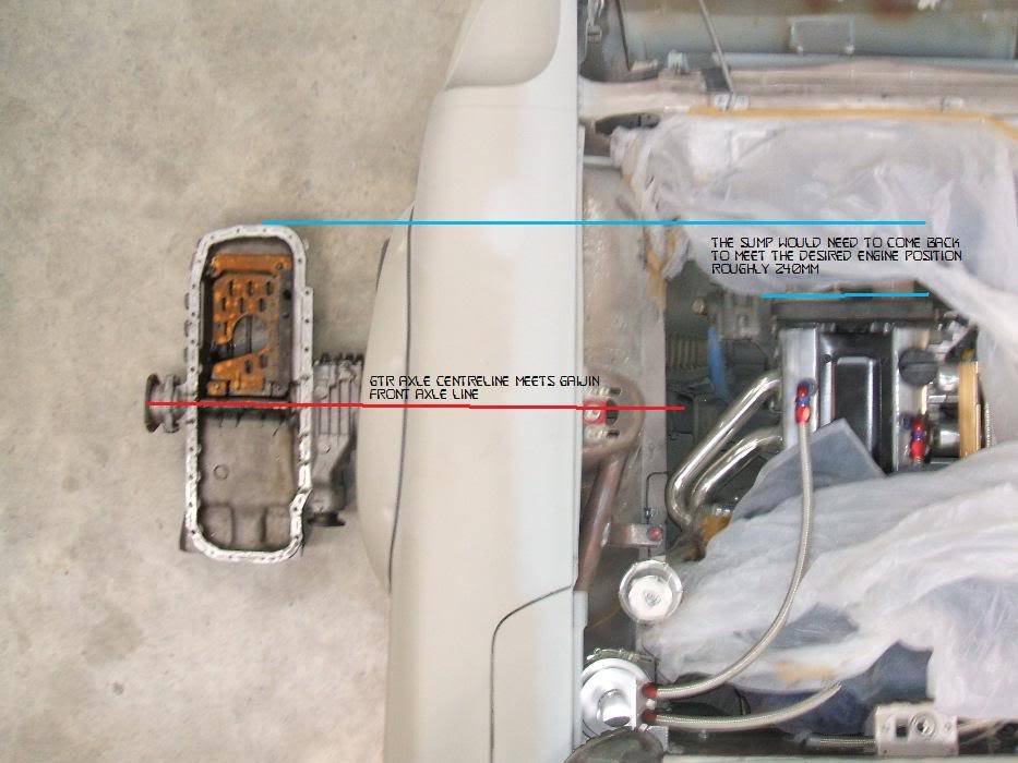

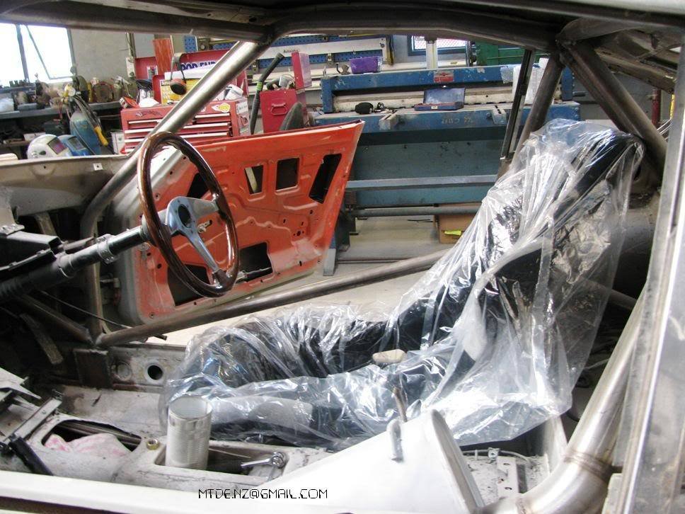

the next step for me is to get the engine and box out for a final fling at the engine bay, which requried some work, harness tabs, holes, weld splatter, its all there and needs to be sorted.

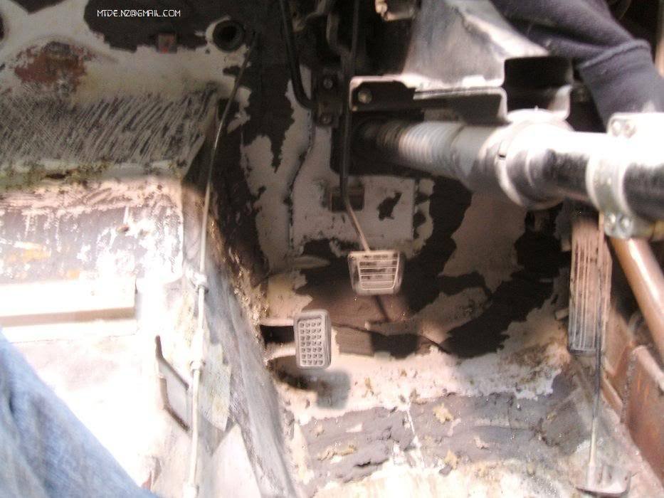

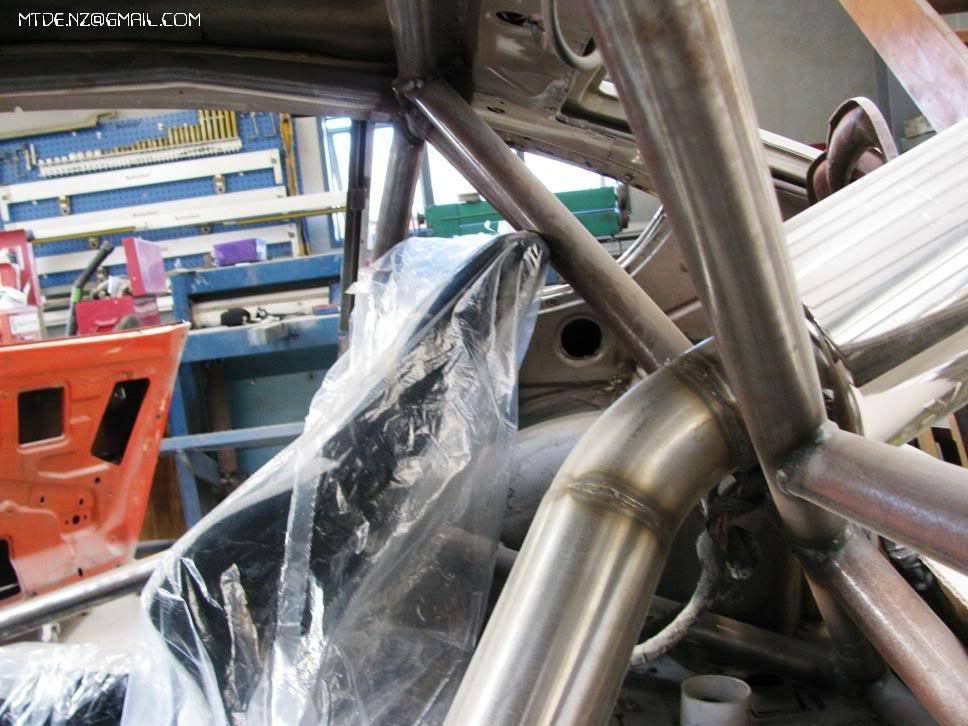

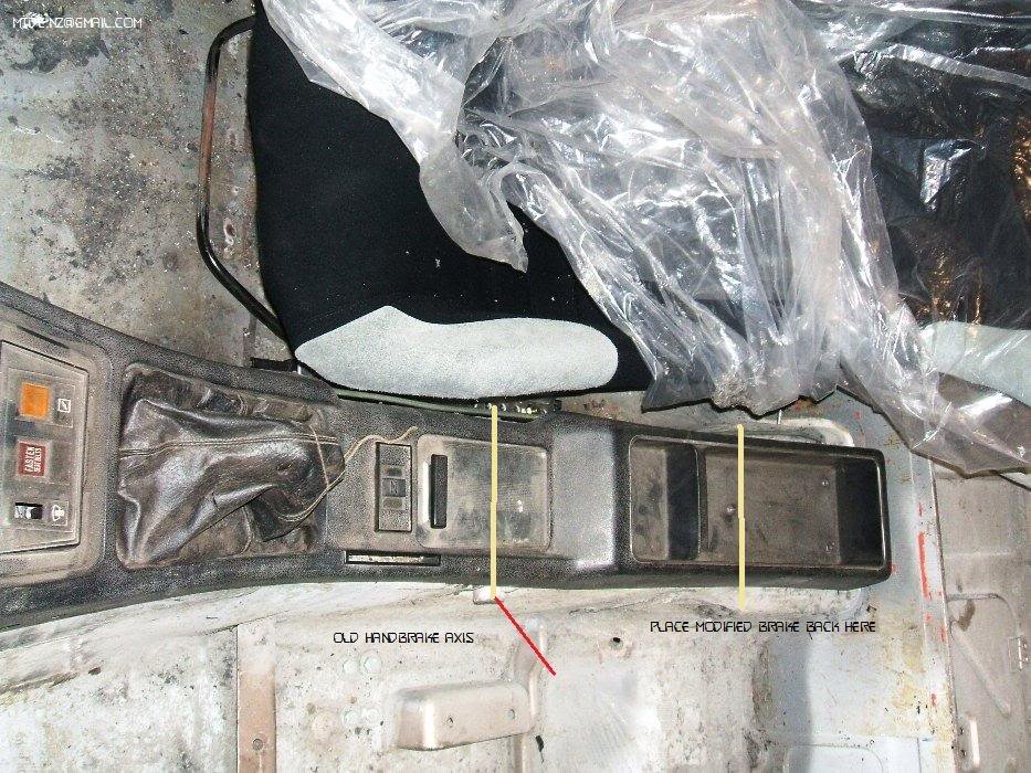

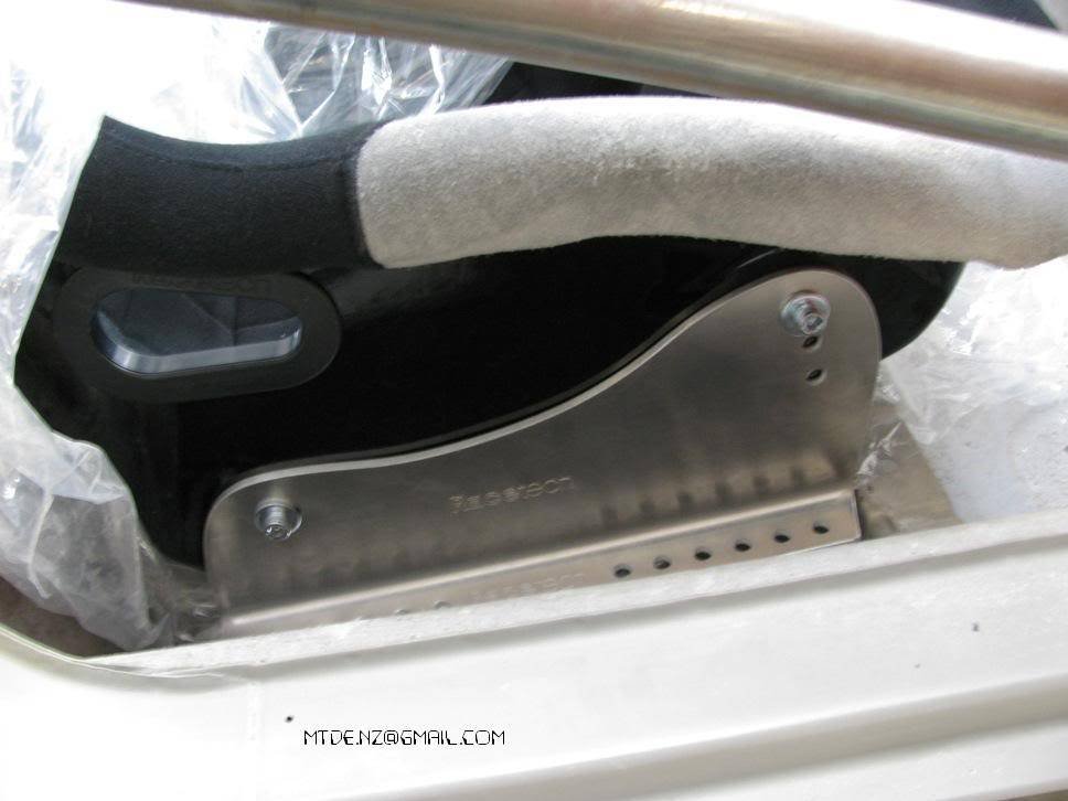

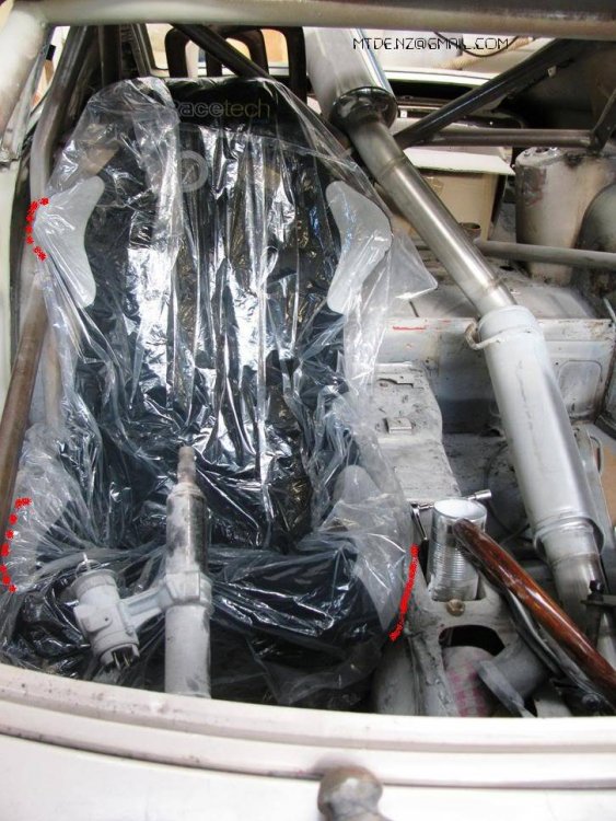

The stock seat mounts fouled the proposed seating rails, mounts and seat itself, so have been drilled out, leaving a smooth floor on the drivers side.
Im still sitting too high, so along the outside chassis section, there is a 45 degree angled floor section that joins the floor to the inner sill. The outside mount fouls this, so by dropping the 45, we can gain 3cm maybe. Ill try that, and if its not enough, the whole floor drops under the seat, to gain the head room for me - 191cm, + helmet, which is hitting the cage & hoop.
The handbrake also requires re-positioning, since the seats are wider than usual. On top of the tunnell, mounted further rearward will do fine. Could go for a floor mounted by the pedals, but a quick acting, accessible handbrake is important.
Bonnet catches are in, with mounts securely welded to the front cage bar. Catches are lockable, sit above bonnet just a touch, after a paint should blend in enough.
