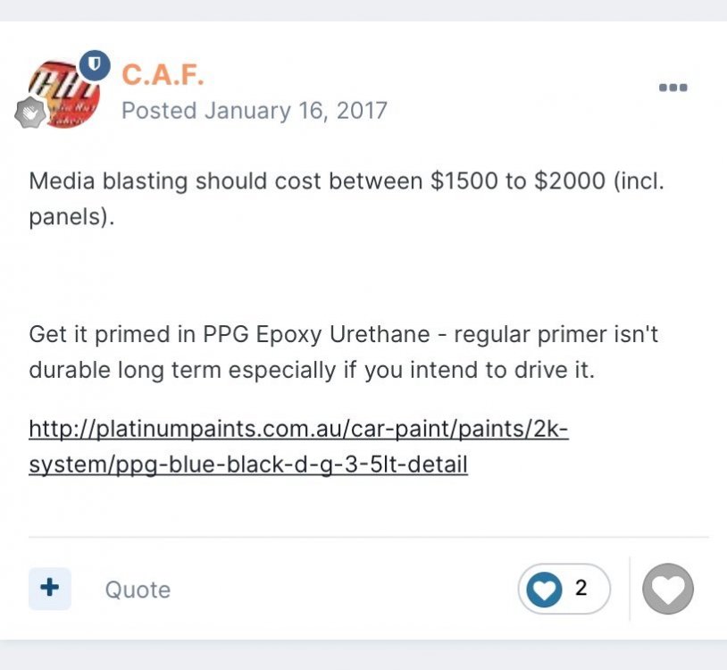

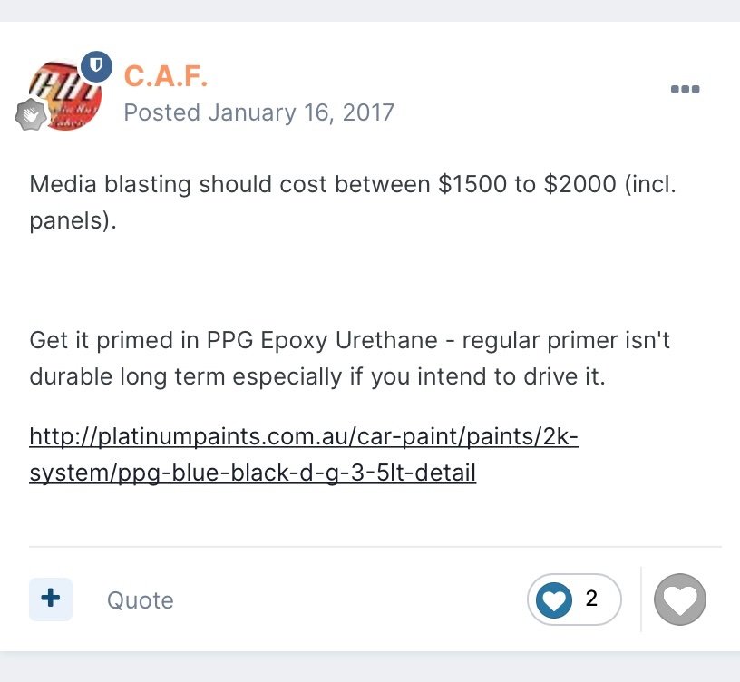

240ZBUILTBYME Posted July 7, 2021 Author Posted July 7, 2021 12 hours ago, RestoZ said: can just see Lauchlan/Locky/CAF sitting back with his bucket of pop corn with a massive grin across his face as this discussion develops. Lol me too. I know gav and Lurch are in the epoxy primer camp as most their recommendations on the forum have been for epoxy. Evidence: exhibit A this thread wasn’t meant to devolve into an etch vs epoxy war lol just wanted to know what specific products people used for each “job/phase” involved in rust repair/panel prep and their experience with said product. As there are so many different brands/products it’s enough to make your head spin! @C.A.F. Lurch, forum searches bring up results but they are scattered and often conflicting. Would it not be valuable to the forum for a sticky to be created for the bodywork section regarding best practice products and their use? I know you’re busy restoring z’s and takin names. But you would probably be the best person to do a write up, being the resident subject matter expert. Even just the exact products you use for each job and any important side notes on using the product? Though you may not want to release all your special tricks and secrets to the world.... there is sirpents sticky which is useful but incomplete. He also advocates for the use of polyester which from my research is unusual as a base bare metal coating. AndBir 1 Quote
