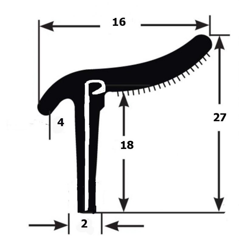

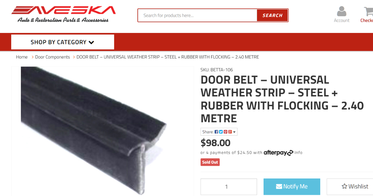

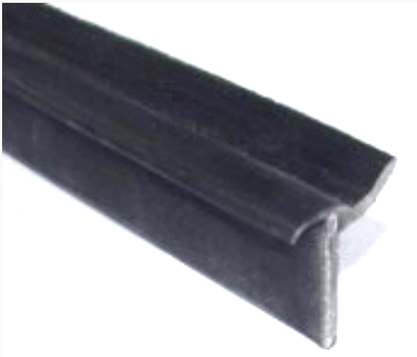

AndBir Posted June 24, 2021 Posted June 24, 2021 (edited) This may work : https://www.aveska.com.au/door-belt-extrusion-ma2-2.4-m-length Door Belt – Universal Weather Strip – Steel Re-inforced, with a Flock Coated Rubber Glass Lip, PLUS a Rubber Lip to Body of Vehicle, for improved water resistance. – 2.40 metre length Edited June 25, 2021 by AndBir added text & images Quote

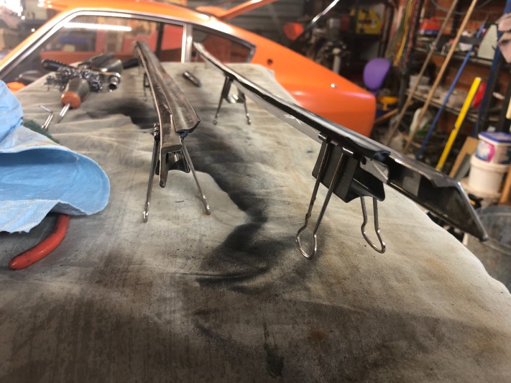

krizza Posted July 17, 2021 Posted July 17, 2021 Just wanted to post my results using the profile mentioned by AndBir to replace my rock hard window rubbers. I actually bought the length required from here for $60 - https://www.ebay.com.au/itm/233226011571?ssPageName=STRK%3AMEBIDX%3AIT&_trksid=p2060353.m2749.l2649 Looks very similar to the profile CBR Jeff got from zcarsource, and is nicely flocked on the window wiper. I ground off the staples holding my old rubbers to the stainless and used 3.2mm (4.8mm depth) aluminium rivets to install the new rubbers. I think they turned out really well, so many thanks to AndBir for the tip which spurred me on to finally do something about them. AndBir, gilltech and Dragonball240z 3 Quote

C.A.R. Posted February 16, 2022 Posted February 16, 2022 (edited) As I had to replace the squeegee's on Wag's 240Z, I did some digging and came across Skillards video: https://www.youtube.com/watch?v=YOhVwokT93w And I also looked on eBay and found them: https://tinyurl.com/2jj9byn6 We then fitted them up with new staples, making sure that the 'foot' of the rubber goes UNDER the securing strip. The only issue - if you can call it an issue - is that the squeegee is taller then the OEM squeegee. They cant be cut down as they wont touch the glass. Edited February 16, 2022 by C.A.R. hmd, gilltech and Dragonball240z 3 Quote
krizza Posted February 18, 2022 Posted February 18, 2022 (edited) On 2/16/2022 at 12:10 PM, C.A.R. said: We then fitted them up with new staples, making sure that the 'foot' of the rubber goes UNDER the securing strip. The Skillard style molding is a completely different profile to the one I used. There is no way that would fit under the chrome strip, plus I liked the idea that any water would run off the door instead of making it's way into the door skin via the ends of the rubber. It doesn't look as clean, but is functional and a similar design to the Commodore door belt setup. I didn't like the look of the Skillard type molding as the rubber looked very tall, although in your pic it doesn't look too bad Edited February 18, 2022 by krizza Quote
AndBir Posted February 20, 2022 Posted February 20, 2022 If you can find it, this seems to be the best replacement of the OEM external window belting : https://www.aveska.com.au/door-belt-extrusion-ma2-2.4-m-length Quote
