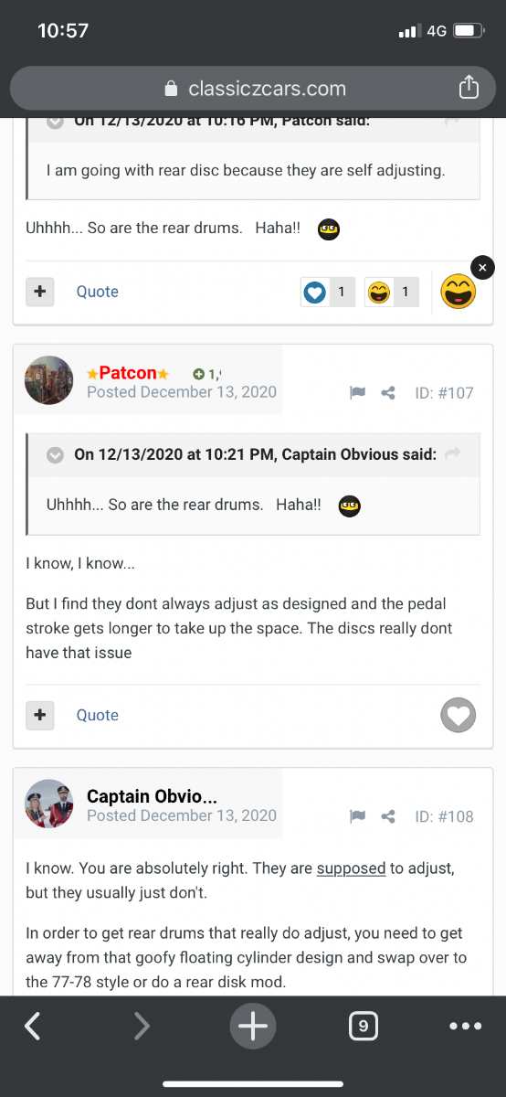

240ZBUILTBYME Posted April 7, 2021 Posted April 7, 2021 1 hour ago, gilltech said: The single set up does self adjust, via the handbrake. All works well IMO as long as it is all adjusted correctly, that none of the adjuster parts are damaged or missing, that an idiot PO hasn't dicked around with it, and the various surfaces that need lube have got lube and aren't sticking. Both the factory manual and the Haynes manual spell out what is required. @gilltech Yes single is designed to self adjust but more prone to failure based on what I’ve read. I have no personal experience nor have I owned a car with drums so I am only repeating what I have been told and read on other forums. double is supposed to be a better design, require less maintenance and less prone to failure. Is that incorrect? Has someone been selling me porky pies? I don’t see why they would have bothered changing the design if the single functioned equally as well. Quote

240ZBUILTBYME Posted April 7, 2021 Posted April 7, 2021 (edited) 33 minutes ago, gilltech said: Mmm, somewhat debateable I think. Double means there are more parts to go wrong, leak etc. Nothing personal, I just don't believe in rushing to modify stuff before the stock set up is properly installed using good quality parts, adjusted to optimum and assessed. But your call for whatever suits your needs. Nothing personal taken @gilltech! I agree with not rushing to modify. I am but a young padawan as @C.A.F. says. I know next to nothing of the force compared to all you guys. So I appreciate any attempt on your part to teach me something or share information. my impression was that the single is floating (can shift in slot) and double is bolted to the backing plate so cannot move. See the conversation that took place in my build thread on classiczcars. Edited April 7, 2021 by 240ZBUILTBYME Quote

gilltech Posted April 8, 2021 Posted April 8, 2021 Quote my impression was that the single is floating (can shift in slot) and double is bolted to the backing plate so cannot move. Correct. Which is why lubrication of the base plate to allow the single cylinder, and brake shoes, to react and slide as required is so important. All detailed in the manuals. But, look, if you've got a set of rear brakes off a '77/'78 car to hand then by all means use them, assuming you can recondition or renew the double cylinders. If you haven't, you may struggle to find some, as AFAIK there weren't many late 260Zs sold in Australia. Much easier for the enthusiasts in the USA with their much larger supply of late 280Zs and availability of parts. Unless you're hell bent on having rear discs then IMHO the KISS principle is best. Just get the stock set-up of rear drum brakes and handbrake well renovated, sorted and balanced using only quality components and all should be fine. 240ZBUILTBYME 1 Quote
240ZBUILTBYME Posted April 8, 2021 Posted April 8, 2021 1 hour ago, gilltech said: Correct. Which is why lubrication of the base plate to allow the single cylinder, and brake shoes, to react and slide as required is so important. All detailed in the manuals. Yes and I suppose the fact you have to be checking and lubricating more regularly is what makes the single more maintenance. Where as double only requires the wheel cylinders to be healthy. 1 hour ago, gilltech said: But, look, if you've got a set of rear brakes off a '77/'78 car to hand then by all means use them, assuming you can recondition or renew the double cylinders. If you haven't, you may struggle to find some, as AFAIK there weren't many late 260Zs sold in Australia. Much easier for the enthusiasts in the USA with their much larger supply of late 280Zs and availability of parts. I don’t have a set lying around but my Z man has some which should be relatively inexpensive, all you need to source is the -77-78 drum backing plate -77-78 park brake adjuster mechanism/arms - 77-78 rubber grommets for park brake adjuster The remaining gear is readily available and cheap from the US including wheel cylinders, shoes, hardware kits. Like you say due to the 280z. This mod to the drums obviously does not increase braking performance. But makes them easier to live with. my theory was that IF I decide to stick with drums (which I’m leaning towards) I have to replace/renew all my components anyway. So for the small extra outlay of getting the 77-78 back plates and brake adjuster, I figured it was worth upgrading to the better design. @Gtv240z I feel I have hijacked your thread and I will shutup now... gilltech 1 Quote
