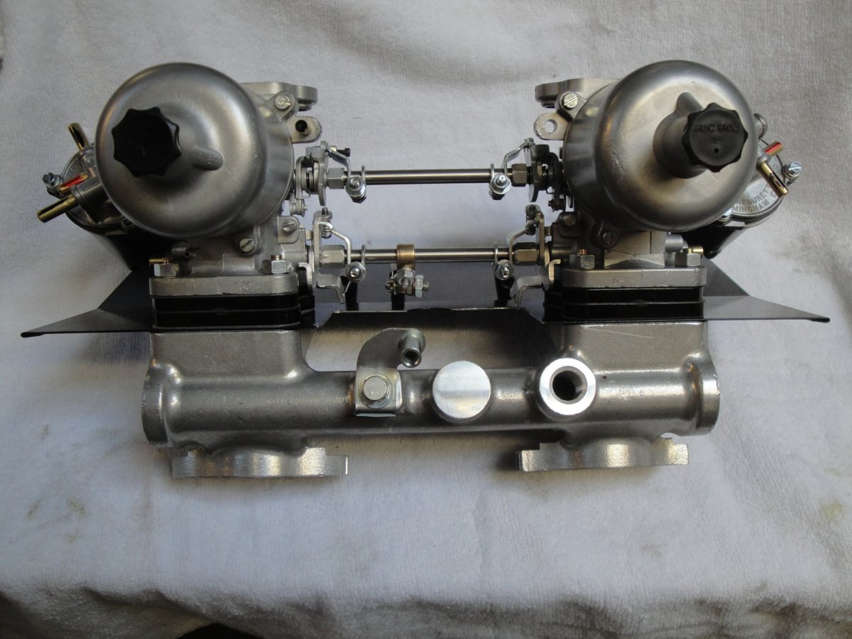

Enzo Posted July 21, 2020 Posted July 21, 2020 (edited) Welcome to the Forum. 6K is a great price for a 2 seater. I also have the 1976 RS30 model. The carbs are the desired 240z Hitachi/SU models as opposed to the flat top original 260z carbs. I noticed that the rear carb has the top fitted 90 degrees clockwise. The little bump should face the air cleaners like the front carb. When realigning make sure the piston moves up and down freely. Good luck with the build and have fun. ( opps! Sorry guys, I thought that they looked like the Hitachi/SU carbs of the 240z. I stand corrected). David. Edited July 22, 2020 by Enzo I supplied wrong information gav240z 1 Quote

AndBir Posted July 22, 2020 Posted July 22, 2020 2 hours ago, Enzo said: The carbs are the desired 240z Hitachi/SU models Just confirm that they are not the British SU carbs ( I think they are) before you buy any service kits etc. Quote
Administrators gav240z Posted July 22, 2020 Administrators Posted July 22, 2020 Looks like HS6 SUs. Quote
old and bold Posted July 22, 2020 Author Posted July 22, 2020 (edited) 4 hours ago, old and bold said: Thanks for that - it was probably me as I had the tops off cleaning them out and changing the damper oil..... Just checked re rear carb being 90 degrees wrong position. Due to the way the three attaching screws are offset ie not equidistant, that is the only way that carb top can be fitted, I cannot rotate it so the bump is facing the air cleaner Just looked on the internet, there are a few pics of dual HS6 SU that look like the same set up as mine, ie the offset bumps. Below is one pic off MGB found on the net Edited July 22, 2020 by old and bold attach pic Quote
1600dave Posted July 22, 2020 Posted July 22, 2020 3 hours ago, AndBir said: Just confirm that they are not the British SU carbs ( I think they are) before you buy any service kits etc. They are British ones. Quote
