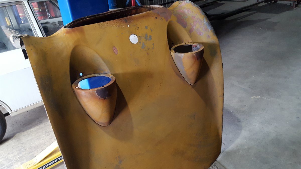

I'm helping my brother restore his Mk1 Austin Healey Sprite.
When he bought the Sprite as a disassembled project, it came with a repoduction fiberglass bonnet. Originally these cars came with a one piece steel bonnet and Brotato
wanted to restore the Sprite with an original steel item - problem being, these are now rare and good bonnets command silly prices.
He found a bonnet on Gumtree in Perth that was a bit sad in condition, but it was complete and fairly unmolested.

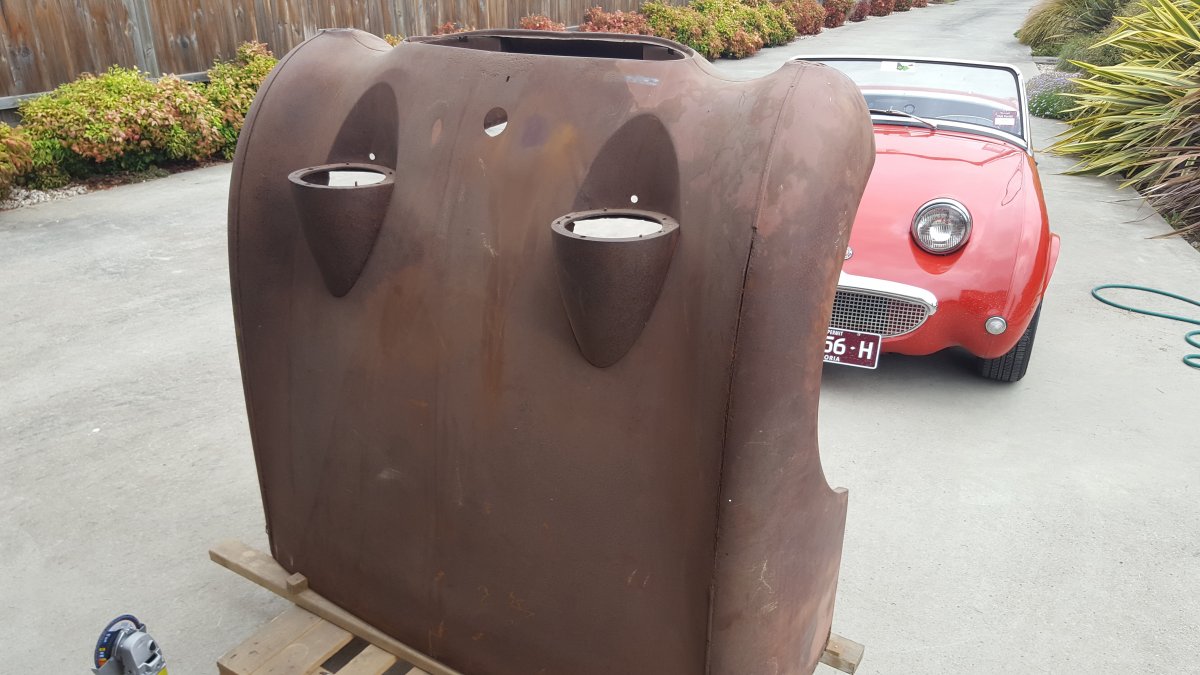

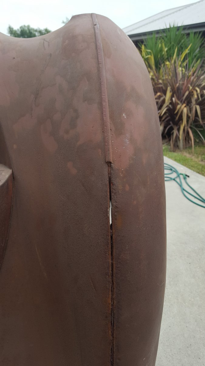

It had however been media blasted, given a light coat of Red Oxide then left to rust some 15+ years ago.
He bought it for a few hundred dollars and I had it shipped over.
Now I didn't want to have it Garnet blasted again to remove the rust and risk warping the already thin steel.

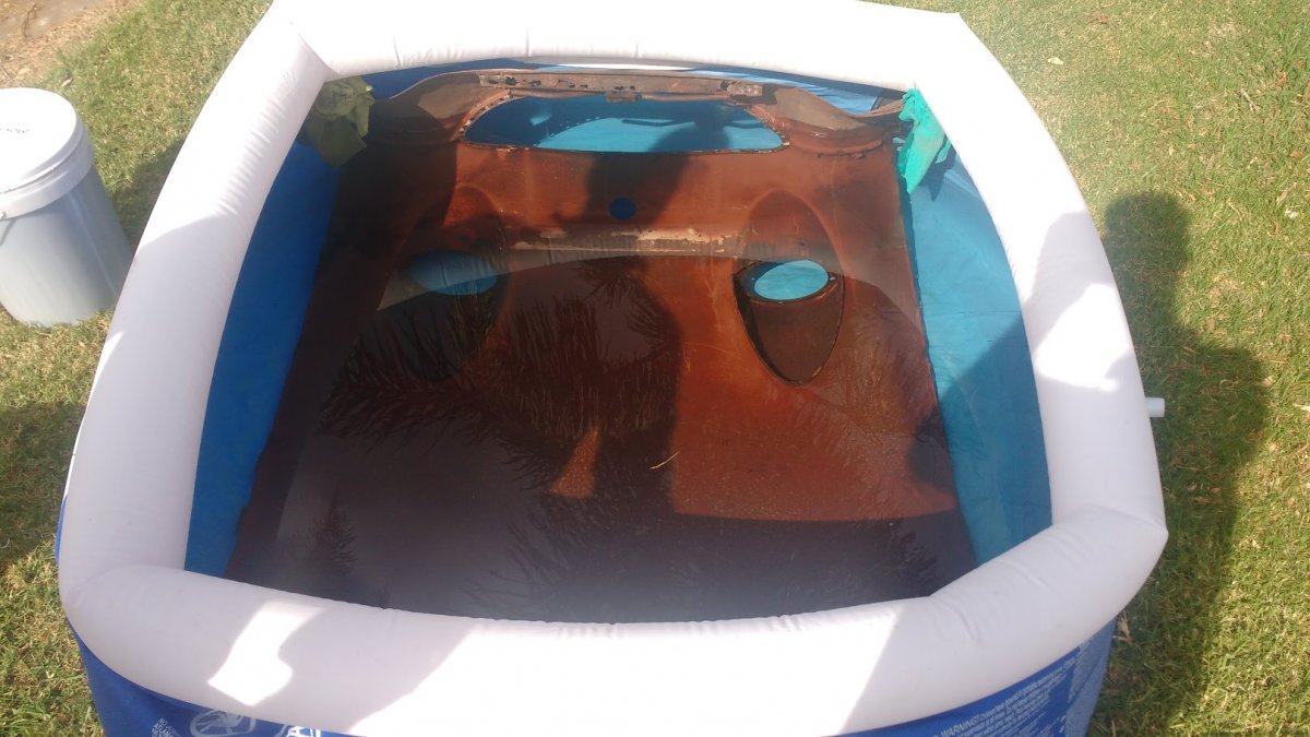

The Molasses bath seemed like the best solution as I had success with this technique before on engine tinware (rocker covers, timing covers etc).
So we unpicked the guards off the centre section of the bonnet - as the T-beading had rusted away and would have to be replaced - as well as the radiator intake ducting etc.

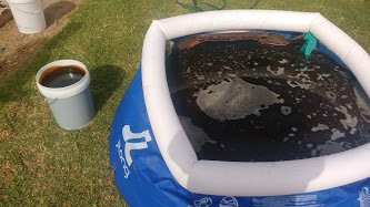

I then went on eBay and bought a cheap 800ltr inflatable pool for about $140, bought 40ltrs of stock feed Molasses, filled the pool up with water and immersed the bonnet in it:
We then mixed in the Molasses covering the part of the bonnet we wanted to de-rust (we are replacing the lower valance as it's beyond repair) :
Edited by Lurch
Posted (edited)

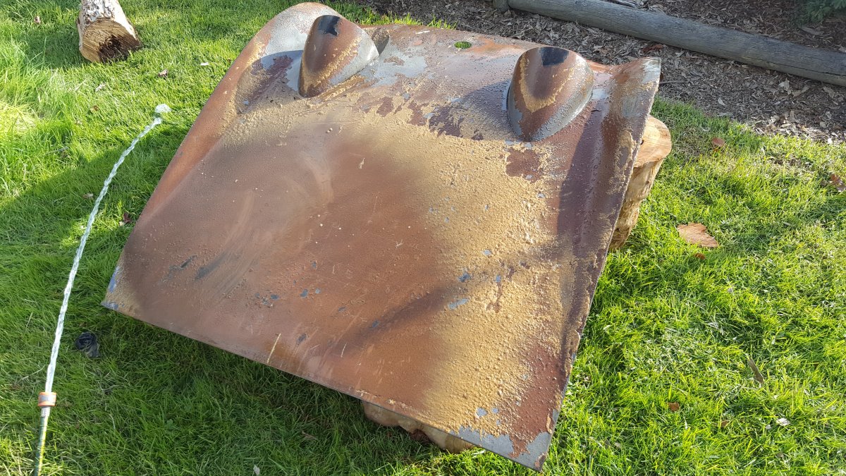

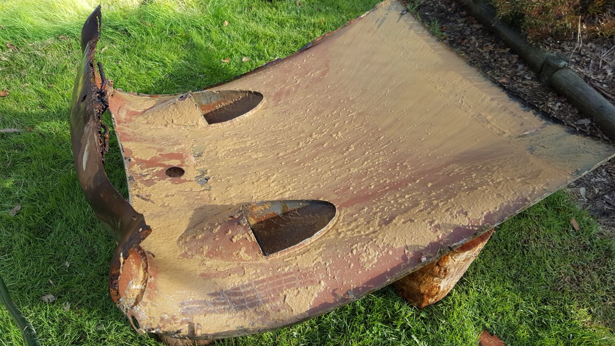

We then covered it over with a tarp and left it to do it's thing.

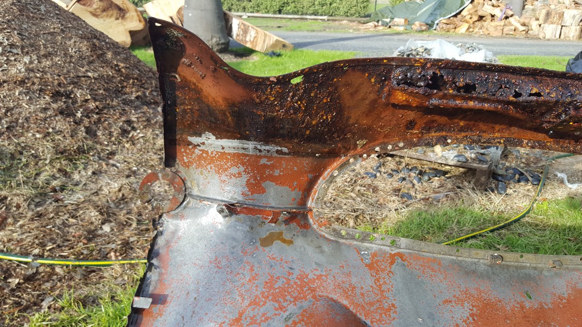

A few weeks later we exhumed it for the mix to find that the rust was totally eaten away:

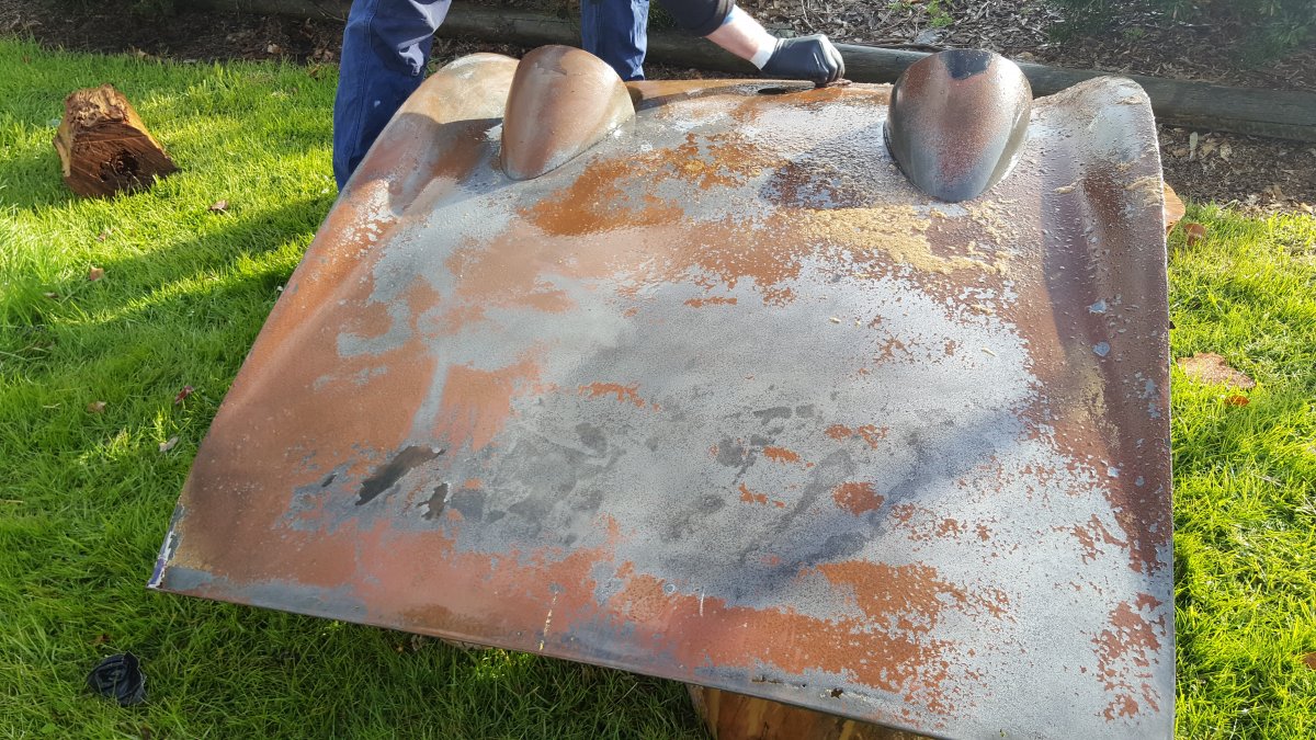

A scrub with a scotch brite pad and wire brush while hosing the Molasses goo and remaining scale off with water left us with a rust free bonnet:
Showing the line where the Molasses sat at:

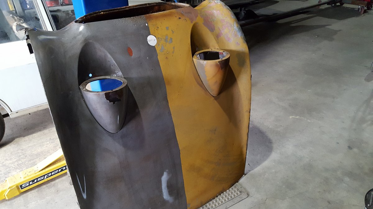

At this point the bonnet had flash rusted from being exposed to water and atmosphere, so I sat it in front of my Jetfire diesel heater to dry off.
Once dry I we gave it a coating of Phosphoric Acid to remove the flash rust and left it to dry:
The remaining red marks are painted lead & body filler which I have now removed.
I just haven't had a chance to take a photo of the bonnet as it sits now, but IMHO this is the cheapest (under $200) and easiest way to de-rust this panel.

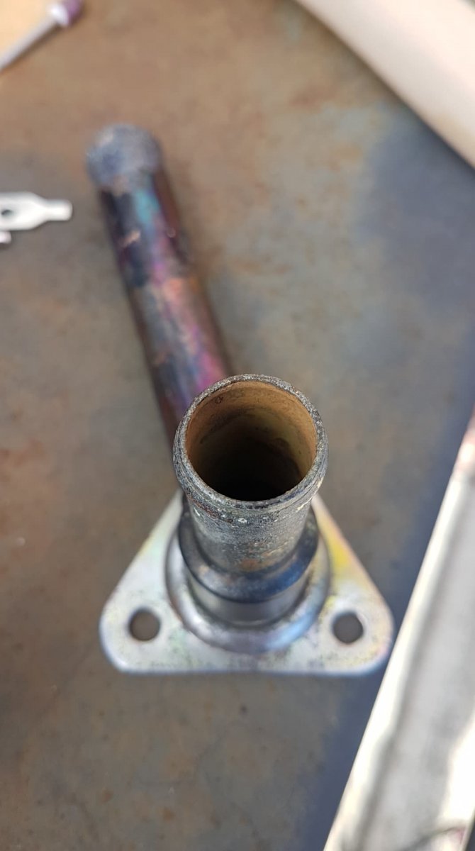

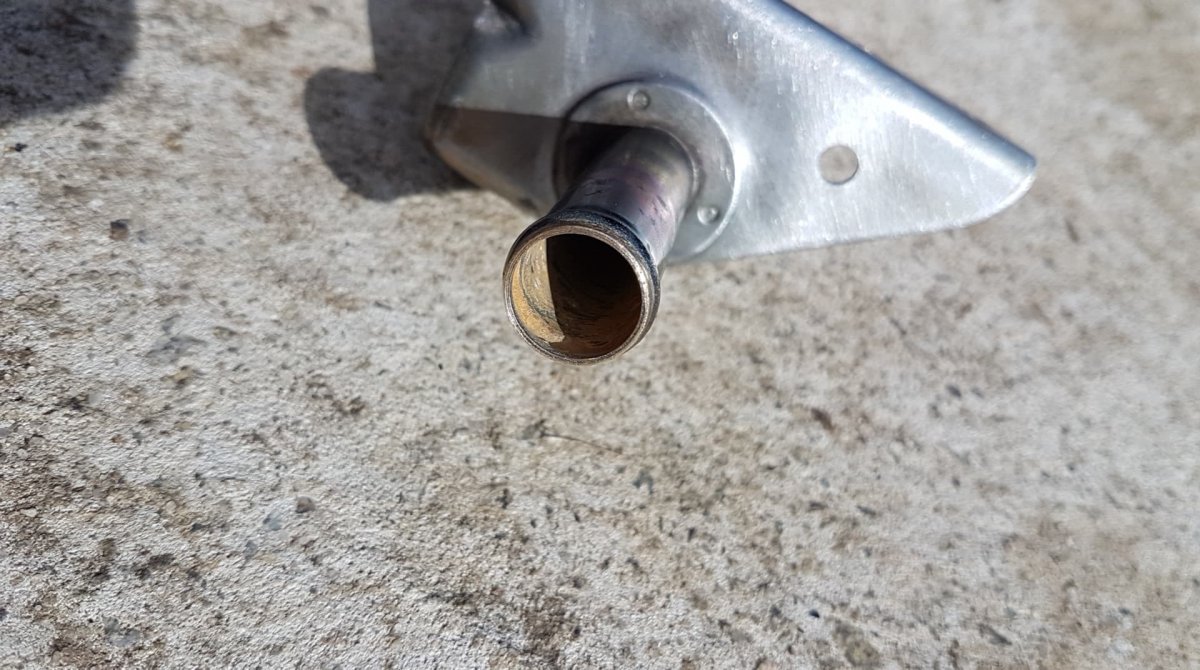

Hey mate, I forgot to ask you the other day, with the parts I am cleaning up, and figured here would be the best place to ask.
After I pull out these parts from Molasses bath, I am not sure how to treat the inside of this valve or if i should. And do you see any issues with spraying the outside with High Heat enamel on the parts where the coolant hose will clamp onto?
Cheers,
Ned
