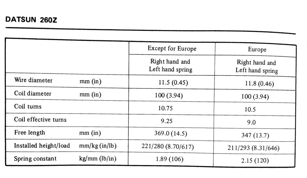

AndBir Posted October 27, 2017 Posted October 27, 2017 I bought some front struts from a young fellow in Sydney the other day and they came with standard springs(as a bonus) which we have checked and they are 115 lb/inch as the workshop manual says for "hard suspension" which what Australian cars must have come with. The workshop manual says normal front springs are 103 lb/inch..../ I see that the Nissan Service Bulletin Vol197 shows that the early 260Zs (1974s) had 106lb/in springs front and rear whilst the same models in Europe had 120lb/in springs fitted. Quote

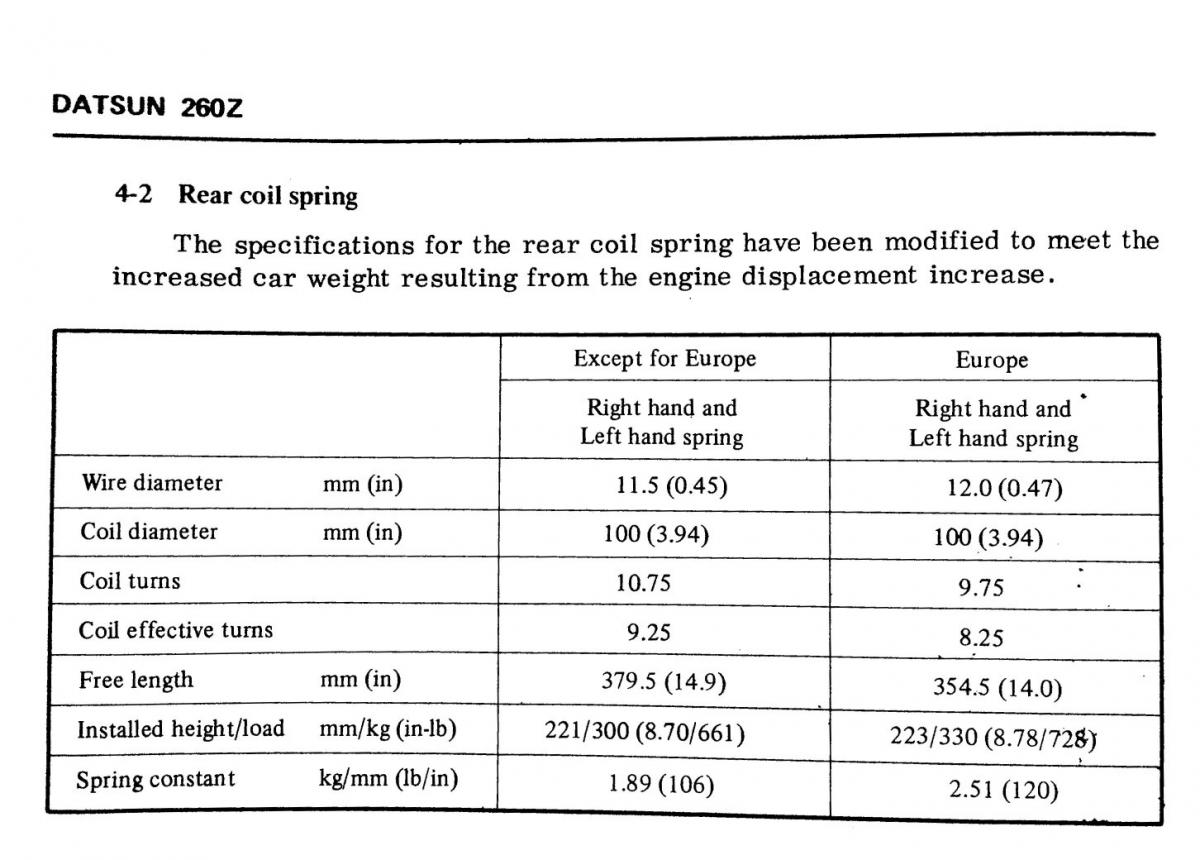

AndBir Posted October 27, 2017 Posted October 27, 2017 The problem I discovered is that the Kings 'lows' are too short to be captured by the spring retainers at full droop. And so stiff that the car barely settles under its own weight, meaning it sits at almost top of the travel. (Lord knows what the 'standards' would do). The end result was that the car sat noticeably up higher than originally. So much for 'lows'. So IMO the spring specs are quite wrong. Here are the 'full' specs I have for the 1974 model 260Z springs : Interesting to see the European ones are shorter and "firmer" but have similar loaded heights to non Europe variants. Quote
gilltech Posted October 27, 2017 Posted October 27, 2017 Exactly my point. The free lengths in those charts vary between, what, about 350 and 380mm. The KDFL-04 (for Zed front) I have here is 280mm free length. Way too short. That's why it isn't captured by the spring retainers. I also have the KDRS-09 (260Z rear) which is 310mm free length, on my car barely captured. (I suspect being intended for the 260Zs with the taller struts, but catalog was one-size-fits-all-260Zs). So make of that what you will. Quote
