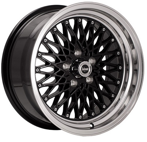

GregTas Posted September 19, 2017 Author Posted September 19, 2017 I have checked the performance website. My current second choice behind the Rota Rbs is the Formula Black. Available in 15", but not 16". My wheel choice will probably be a month or so off. My only concerns is how things sit with the lower arm and tie rod end. This will influence the offset. Quote
