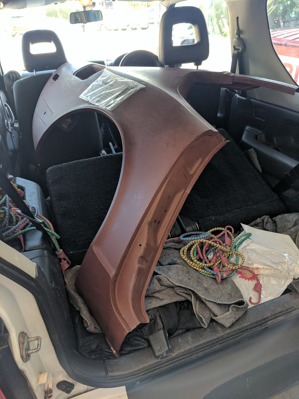

gilltech Posted September 9, 2017 Posted September 9, 2017 Impressive work, following with interest. I haven't been able to source (or afford) any NOS panels or full rear quarter replacement sections Are there any such things as rear quarters available anywhere except from another car? Quote
daretobedifferent Posted September 9, 2017 Author Posted September 9, 2017 (edited) -- Edited July 13, 2023 by daretobedifferent Quote
Administrators gav240z Posted September 9, 2017 Administrators Posted September 9, 2017 Yes Niles got that passenger side 1/4 panel.. (in Switzerland) and I got this driver side 1 recently. Cost a small fortune, but the 1/4 panel on HS30 00051 has had a bit of a hit and needs many hours spent on it to put right so this seemed like a better idea. They do come up for sale, but not often! I managed to also get a NOS hood/bonnet recently. Well at least I think it is, will find out when I collect it soon! Ponyo240z 1 Quote

gilltech Posted September 16, 2017 Posted September 16, 2017 I managed to also get a NOS hood/bonnet recently. Well at least I think it is, will find out when I collect it soon! Was that the hood for sale by Datsun Parts recently? I was wondering if it is a repro and if so whether Chris might have tapped into a panel source somewhere. However, if it's a one-off NOS Nissan part he dug up then that sinks that hope. Quote
Administrators gav240z Posted September 16, 2017 Administrators Posted September 16, 2017 It was from Japan, before the reproductions that appeared on eBay, so I am hoping it's a Nissan OEM part! Also may have found a NOS passenger side rear 1/4 panel for an early 240Z... they are still out there! Quote
