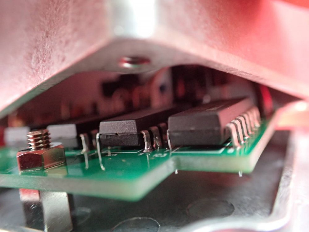

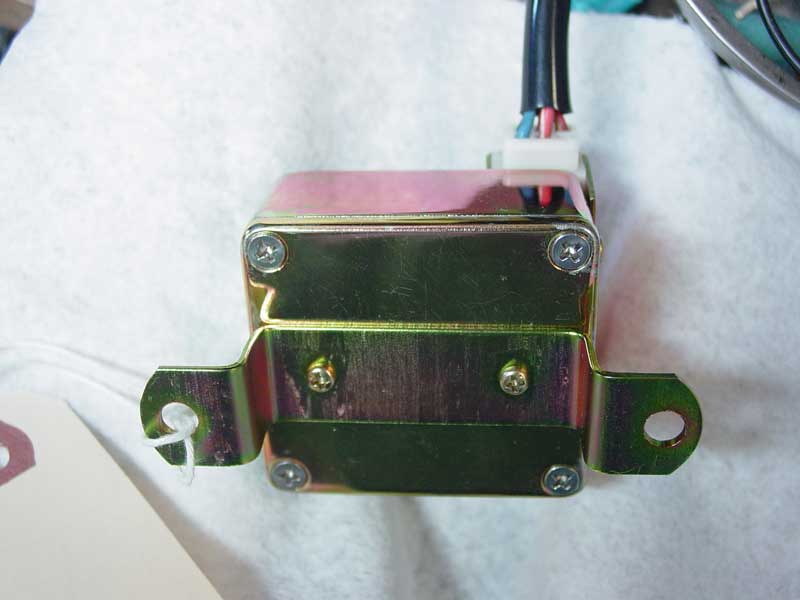

d3c0y Posted January 30, 2017 Author Posted January 30, 2017 (edited) That's the Jaycar box with some bits screwed too it. Nice work turned out very similar. Did he just make a few for you? Edited January 30, 2017 by d3c0y Quote
Administrators gav240z Posted March 16, 2017 Administrators Posted March 16, 2017 Turns out plating was harder than expected given it was an alloy type of box. But it looks great now (even with the pinkish hue in it). Quote
Moderators PB260Z Posted March 18, 2017 Moderators Posted March 18, 2017 Don't worry it looks fantastic. Quote

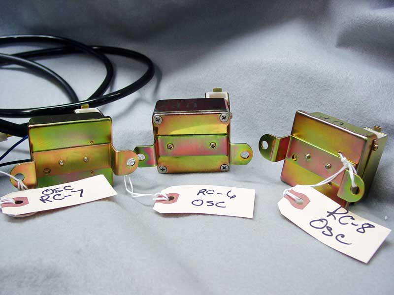

Administrators gav240z Posted March 30, 2017 Administrators Posted March 30, 2017 Spot the difference. Ponyo240z 1 Quote
d3c0y Posted March 30, 2017 Author Posted March 30, 2017 Nice work Gav, I still have some extra oscillator circuits if anyone is interested. Quote
Administrators gav240z Posted March 31, 2017 Administrators Posted March 31, 2017 Nice work Gav, I still have some extra oscillator circuits if anyone is interested. Not sure if Ron has reached out to you yet, but is there anyway you could implement some kind of variable resistor into your circuit so that fine adjustments can be made to speed up or slow down a clock? The Oscillator in the photo is actually using Greg's and (Monkey Man) Eric's board at the moment because their's has an adjustment feature that allows fine tuning. It's great to have multiple options, would be even better if both had an adjustable pot on them. Quote
d3c0y Posted March 31, 2017 Author Posted March 31, 2017 (edited) We can no problem. If you run a clock with the board and tell me how far out it is over 12 hours or whatever period you pick, happy to reprogram the board to suit free of charge. Edited March 31, 2017 by d3c0y gav240z 1 Quote

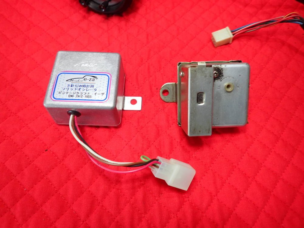

Administrators gav240z Posted April 4, 2017 Administrators Posted April 4, 2017 http://page.auctions.yahoo.co.jp/jp/auction/245163203 Famous now you can buy a Rally Clock repair kit ? Instructions here. https://drive.google.com/file/d/0B00jY3_rDdSsb0UzWXV4TFlIeVk/view Quote

Administrators gav240z Posted June 19, 2020 Administrators Posted June 19, 2020 Just saw another box on YAJ! https://buyee.jp/item/yahoo/auction/c830343618 Bad translation here: Quote Z432 S30Z S31Z 3 hands for watches with stopwatch Solid Oscillator High-tech alternative to genuine tuning fork oscillator Solid Oscillator for Watches with 3-Hand Stopwatch For watches with two newly developed control knobs. Both the front part of the watch and the middle type of the mid-term type and the band-fixing type are OK. Z432/S30Z/S31Z Three-handed watch oscillator with stopwatch The oscillator of this watch 50 years ago is a mechanical tuning fork , so it is safe to break it. If the oscillator breaks, the clock may not work, or even if it runs, it may be delayed by more than 10 minutes a day. This is a solid oscillator that uses modern parts to substitute functions. The coupler is on. - Since there is no dial tone that Boone indoor sound do not mind a small burden to the so-power consumption is low battery when the battery re-connection - Since start-up of the force is strong, watch immediately start moving worry about, the future of failure There are advantages such as few. The clock accuracy is not so meaningful with this type of clock, but the error with a clock on hand is 24 seconds a day for 5 seconds and 1 month for 150 seconds (two and a half minutes). https://www.vintagecraft-e-za.com/ Quote
