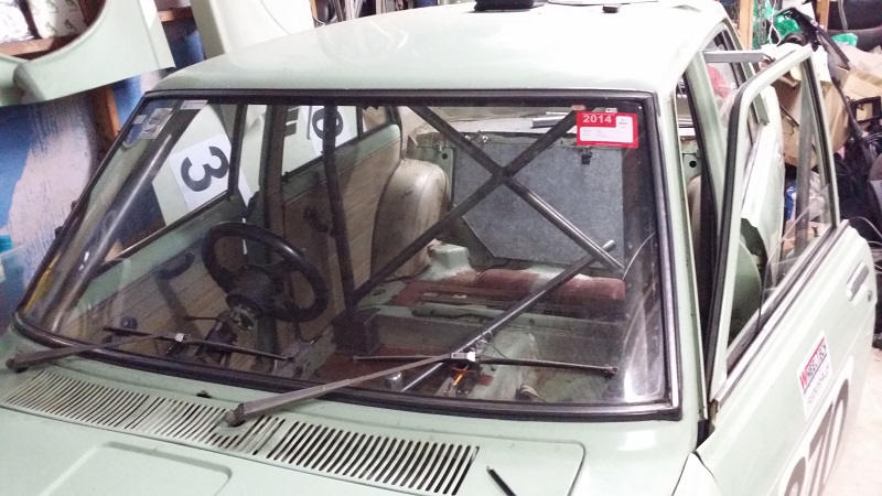

1600dave Posted October 19, 2016 Posted October 19, 2016 (edited) New CAMS-compliant cage is nearly done. Just need to put the dash back in, get a laminated screen, window net, battery cutoff switch and hopefully it will pass its logbook inspection in time to get the logbook back from CAMS. Otherwise I'll be flag marshaling for the whole 4 days rather than competing : At least it has an engine this time, I only started an engine rebuild about 2-3 weeks out from the 2010 Bathurst event..... My "trick" setup is 4.44 diff, 6 speed S15 box for the close ratios, and a mighty 102hp from the L18. Hopefully might crack 190 down conrod this time........ Edited October 19, 2016 by 1600dave Quote

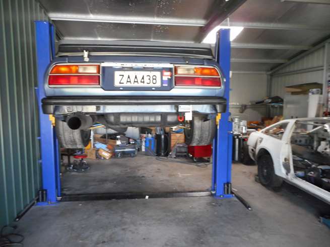

260DET Posted October 21, 2016 Posted October 21, 2016 On the hoist for a brake and suspension check, she's keen to go Quote
260DET Posted October 24, 2016 Posted October 24, 2016 With the new Hankooks it turns out that the suspension has too much droop in the front and not enough in the rear. It's early three way MCA and works very well but does not have separate length adjustment so I'm pretty well stuck with it and will have to drive accordingly. There is also quite a difference in ride height between the two fronts too so either the car has a significant right side weight bias, unlikely, or else the two King springs have developed different rates. Bugger. Quote
dat2kman Posted October 24, 2016 Posted October 24, 2016 You put different height tyres on! Screw up the sleeve, that'll lift it With your car, it aint gonna be critical Quote
260DET Posted October 24, 2016 Posted October 24, 2016 Only have spring height adjustment Jason and that is dictated by ride height requirements. Can live with a bit of extra front droop but with a Torsen type LSD a fair bit of rear droop is required to keep both wheels on the ground. Quote

260DET Posted October 24, 2016 Posted October 24, 2016 Although wider the new rear tyres are smaller in diameter than the previous tyres due to being a lower profile. I didn't realise that the difference would be so important. Quote

Cozza Posted October 24, 2016 Posted October 24, 2016 Although wider the new rear tyres are smaller in diameter than the previous tyres due to being a lower profile. I didn't realise that the difference would be so important. WTF. How does tyre sidewall height have any effect? As long as the tyres are the same side to side, the droop is still a function of suspension components (with a negligible portion due to tyre weight). Quote
RLY240 Posted October 24, 2016 Posted October 24, 2016 WTF. How does tyre sidewall height have any effect? As long as the tyres are the same side to side, the droop is still a function of suspension components (with a negligible portion due to tyre weight). I think he has had to raise the spring platforms to raise the body to the required ride height with the smaller tyre, hence less droop travel left in the shock. 260DET 1 Quote
Cozza Posted October 24, 2016 Posted October 24, 2016 ^^^^ So why is there now too much droop in the front??? Quote
260DET Posted October 24, 2016 Posted October 24, 2016 The coilovers are custom made by MCA to my specs but tyre sizes have changed a lot since they were specced years ago. That plus I've learnt a bit since then on suspension setup. Quote
260DET Posted October 24, 2016 Posted October 24, 2016 Good to see the book of excuses is also being well prepared and ready to go too....... Lol, realistically it should make bugger all difference in regularity, I wanted a bit more rake for high speed Bathurst but now will have to lose a bit to regain some droop. Quote
